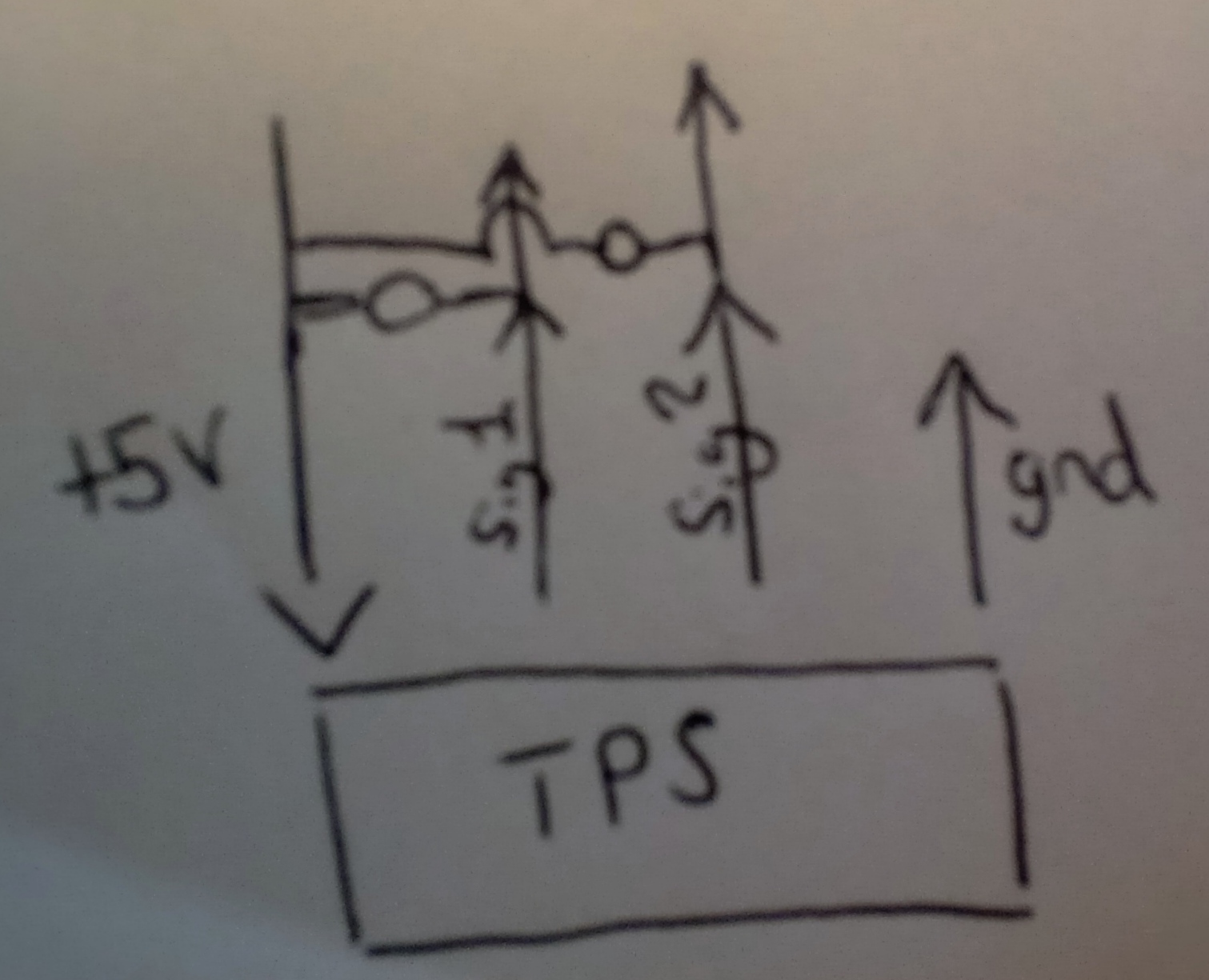

Frustratingly it seems the TPS I bought may be faulty. I got the same one as below as I'm converting from a cable drive and figured this would be flexible but when I give it 5V and grd to the below pins I get no signal from either wire. I do need to have a little play with it but unless the cables themselves are faulty I'm not sure what it could be. These do have a little PCB inside covered in glue so it's not possible to really see what's going on inside.
clanger9 wrote: Wed Mar 25, 2020 10:47 pm Been doing a bit of reverse engineering on a Peugeot throttle position sensor. These are cable operated, so ideal for a bike throttle. They're also cheap (only £16 new). Part number is 9643365680. Google for "Peugeot 306 HDi throttle position sensor"
Rather than a true potentiometer throttle, it appears these use a contactless sensor to output a pair of analogue signals.
Using a 5V supply and a 1kΩ pull-up resistor, I got the following readings:

Post by crasbe »
Did you add the 1k Pullup resistor to the signal wires as well? That is mandatory for the device to work as far as I remember.

crasbe wrote: Mon Dec 04, 2023 9:16 am Did you add the 1k Pullup resistor to the signal wires as well? That is mandatory for the device to work as far as I remember.
I didn't, it was something I thought might be necessary but kind of hoped I could skirt over it. So I need a 1k pull up resistor in series with each signal wire?
crasbe
Posts: 301
Location: Germany
Has thanked: 49 times
Been thanked: 150 times
Re: [WIP] Mercedes 310E (310D campervan) - GS450H/GS300H
Post by crasbe »
Jacobsmess wrote: Mon Dec 04, 2023 9:21 am I didn't, it was something I thought might be necessary but kind of hoped I could skirt over it. So I need a 1k pull up resistor in series with each signal wire?
No, if it would have to be in series, it would be called a "series resistor" :P
The Pullup has to go between the signal wire and +5V, it it used to pull up the signal to the high level. Hence the name. :D
Since the TPS has two signal outputs, I guess it needs two Pullups. One for each signal wire.

Thanks, electronic nomenclature is not my forte! So how would the zombie read the signal? Does the resistor just bridge between the signal wires and 5V and the zombie signal wires connect to the TPS signal wires the same?
See my perfect diagram for what I'm asking, as you can see electronics diagrams are also not my forte....
