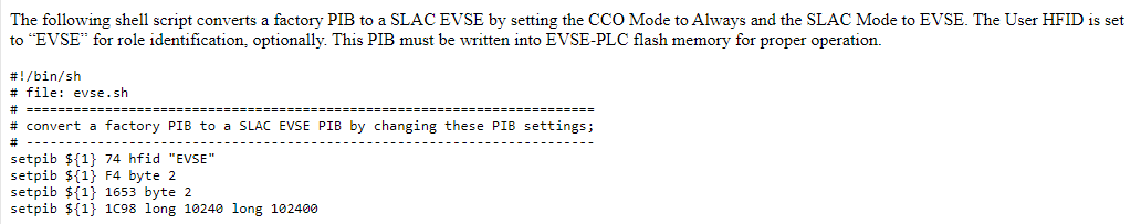

One thing I didn't find in uhis readme was the PIB config for EVSE so dumping it here (found here)
Everything else is identical to PEV config. Maybe worthwhile adding to readme? https://github.com/uhi22/pyPLC/blob/master/readme.md
setpib evse.pib 74 hfid "EVSE"
setpib evse.pib F4 byte 2
setpib evse.pib 1653 byte 2

Yeah, this documentation is "a little bit hidden": the readme of pyPLC mentions the https://github.com/qca/open-plc-utils/b ... 05s15.html, and here we find
[Edit] Added the description in the readme: https://github.com/uhi22/pyPLC#configur ... lc-adaptor

I made new tests and got new info:
1. I use 5V and sometimes 12V to power the AR4720 from a TPlink adaptor. I think it is hot all the time and maybe this wasn't the problem.
2. This original.pib was downloaded from the modem after some tests with it as EVSE (I must change its name when reading). I did a few tests with a BMW i3 and a XC40 VOLVO, and after some successful connections, the modem stopped communicating with cars. I suspect that was some HW problem, but reading the .PIB after this problem and rewriting it like an EVSE and making another "checkpib" I got this reading:
The difference is that now the CCo is "Always" and not "Auto". But now the question is: Did the car change "CCo" to Auto and why?
Is there some way of configuring CCo using the pyPLC?
PIB 0-0 8836 bytes
MAC 40:ED:00:9F:FD:BC
DAK A8:68:85:FA:9B:A3:D2:B1:24:6F:41:95:5E:D8:C8:E1
NMK 77:77:BC:B0:77:77:77:77:77:77:77:77:77:77:77:77
NID 01:02:03:04:05:06:07
Security level 0
NET Qualcomm Atheros Enabled Network
MFG tpver_401013_171025_901
USR EVSE
CCo Always
MDU N/A

No, the coordinator setting cannot be changed by the car, and also pyPLC does not touch this. It is only changed by writing a PIB. At least I see no other way.
"Always" is the correct CCo setting for the Evse.
