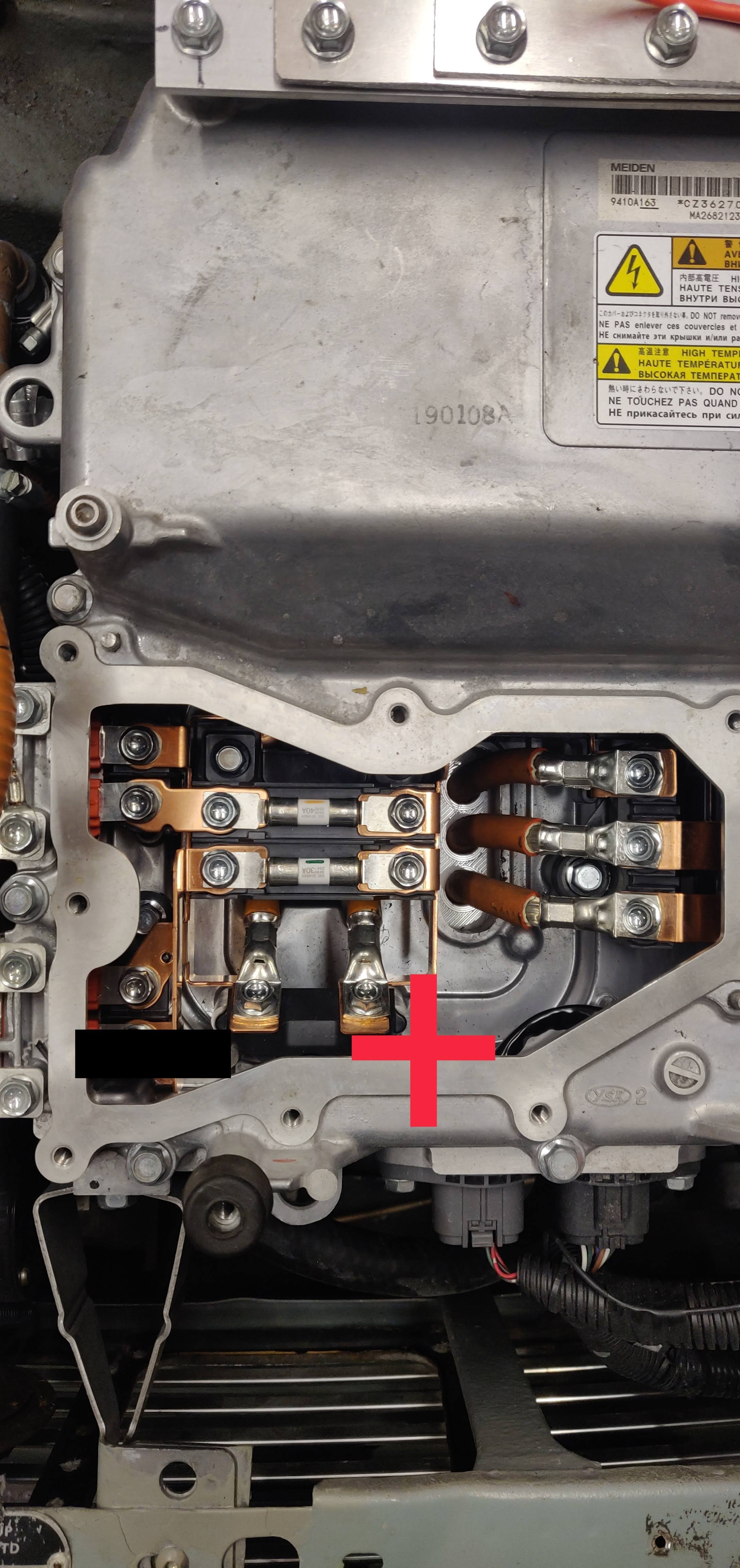

Hi
Just starting to power up the inverter, motor to go in a Grandin Dallas Jeep
can someone post a photo of the HV battery + and - screw terminals polarity ,please
Cheers
aot93
Posts: 213
Location: UK, West Sussex
Has thanked: 8 times
Been thanked: 49 times
Re: Mitsubishi Outlander rear motor invertor
Post by aot93 »
Positive is on the fuse side.
snelly
Posts: 74
Joined: Sun Dec 26, 2021 11:54 am
Been thanked: 12 times
Post by snelly »
many thanks

Hi
trying to get this to spin on 128v as a test. Is there a minimum as having no joy ?
What is the max voltage for the rear inverter also ?
Retired - (E46 touring, Phev rear motor, OEM inverter cabin heater and charger,BMW 9kwh & 12kwh packs)
[WIP] JImny & phev running gear
royhen99
Posts: 265
Location: N. Wiltshire. UK
Has thanked: 22 times
Been thanked: 134 times
Post by royhen99 »
Minimum 200V. Not sure of maximum, at least 395V possibly 420V.
LRBen
Posts: 608
Location: Somerset, UK
Has thanked: 121 times
Been thanked: 290 times
Post by LRBen »
Inverter shuts down over around 405v.
