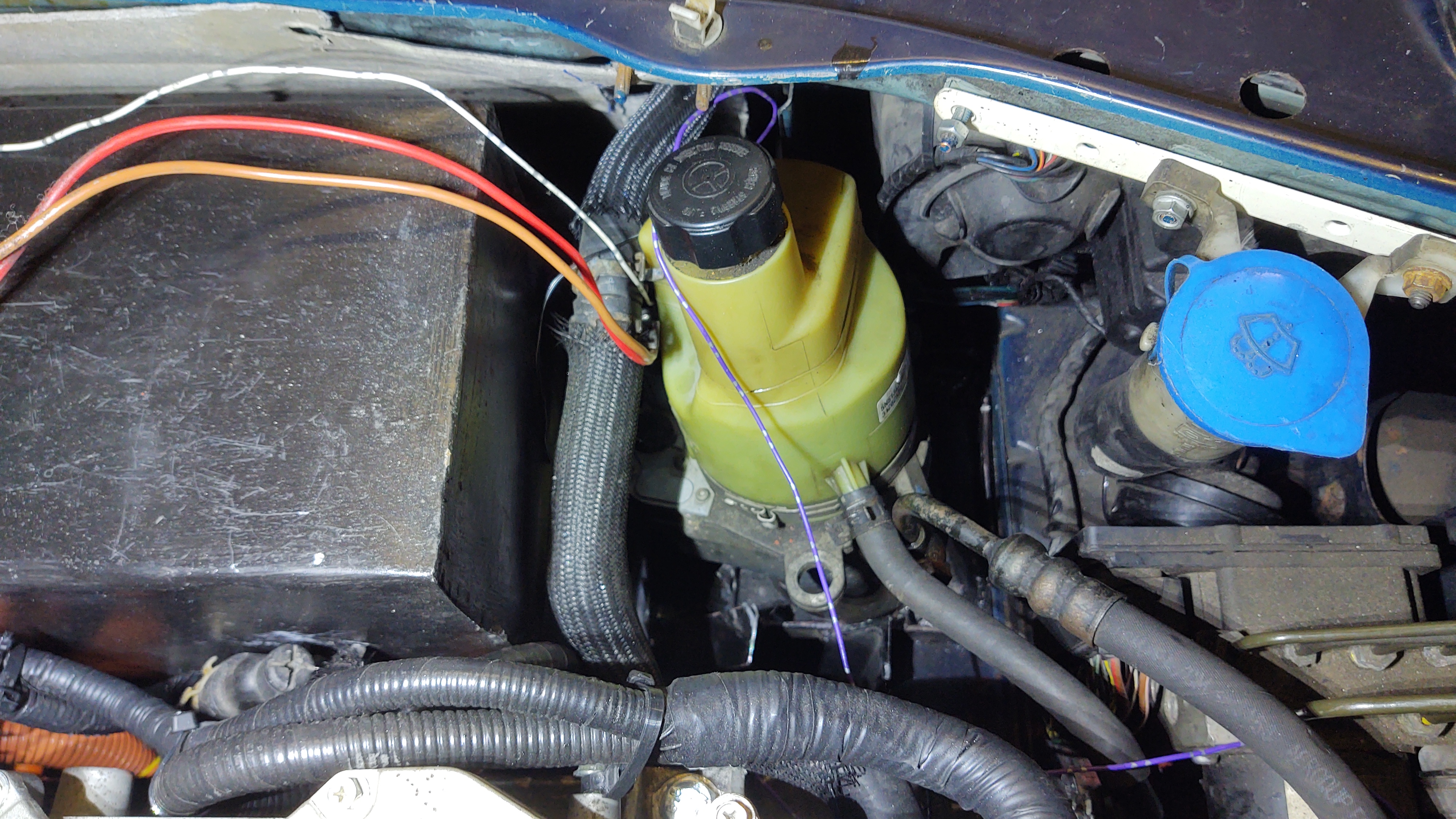

Big change happening.
The power steering solution I had come up with is not cutting the mustard so is currently being removed. It's a pity after all the work I put into it but when parking it wasn't giving enough assistance and lacked the torque needed when the end stop was reached so sometimes just cut out.
It was OK when first installed but a couple of months ago after completing the build I was charging the main battery and stupidly left the power steering turned on, low so it wasn't spinning but still on. I never figured out why but for some reason the DC motor controller that should have been feeding 7V to the rotor decided instead to pass through the full 40ish Volts. I had no idea this had happened until I noticed a funny smell and after several minutes trying to figure out where the smell was coming from saw smoke coming from under the bonnet.
As you can imagine there was some degree of panic before I figured out what the issue was but by then I think the alty motor had been irreparably damaged and hasn't been quite 100% since and might even be getting worse so now is being replaced.
It's a Volvo electric hydraulic power steering pump that can be controlled by CAN but works fine with only 12V.
I've tested it and it seems to be great so I'm going ahead and doing the swap.

Re: [Driving] Freelander EV With Gen1 Leaf electrics and EVBMW VCU
After a ball ache of a job involving spanner, grinder, dremel, crow bar, cold chisel, 4 pounder and engine hoist the altymotor is finally out and the old mount is cut down enough to get the Volvo pump in.
This is it as I almost finished winding out one side. Doing this released one corner but I basically smashed it out of the other three.
This is the Volvo pump in.situ, it fits well so shouldn't be too hard to secure and after a brief test drive is quiet enough it can only be heard when stationary but gives enough assistance for parking etc.
I also first tried to run the electric hydraulic booster on Mercedes W168, but then I installed an electric booster from KIA CEED. Energy consumption is much less, there is no noise at all, and it is controlled via the canbus perfectly.
