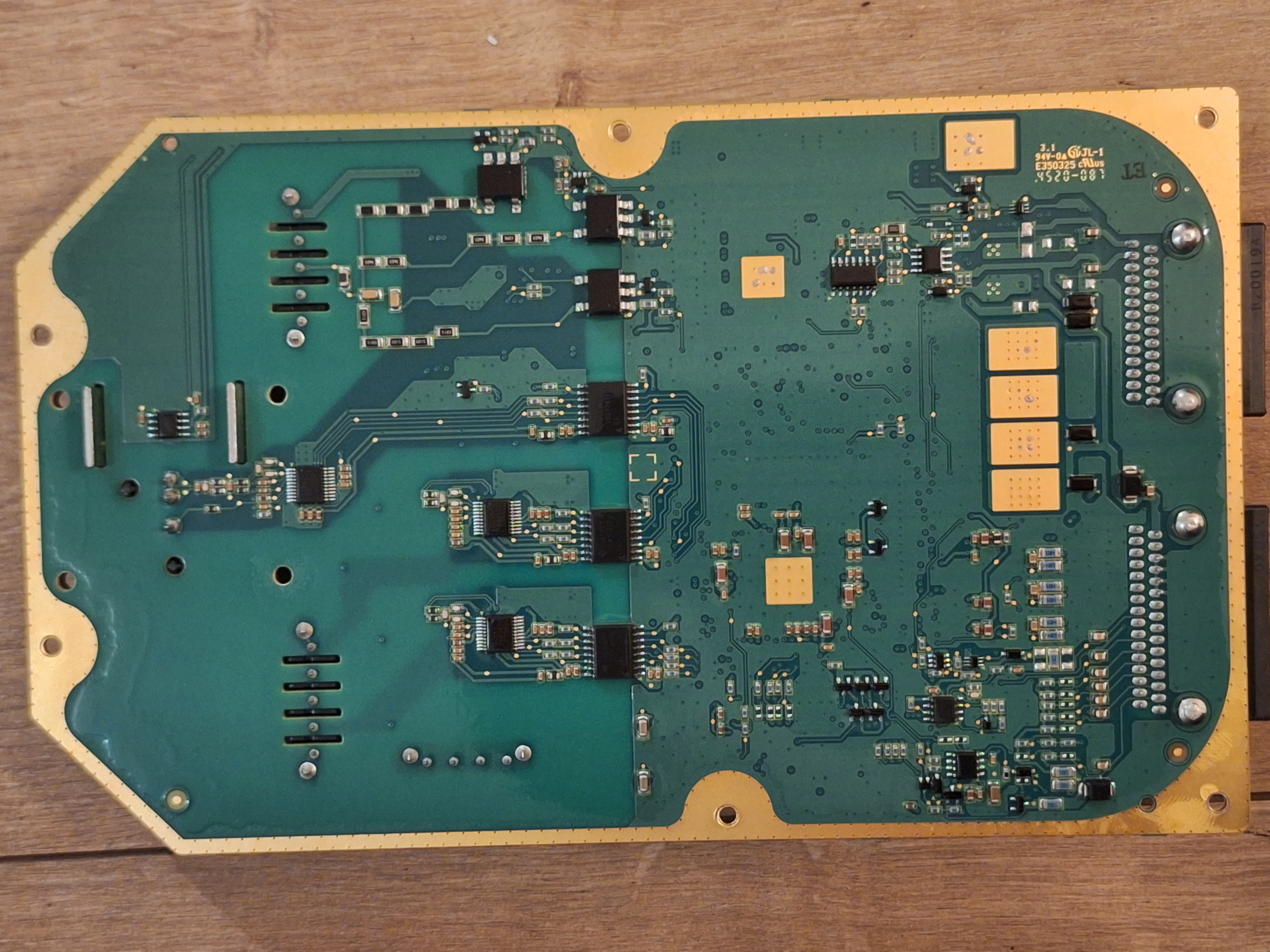

I bought a E 208 pack.
did not see a picture of the battery controller unit. so here it is
top side
top side
bottom side
bottom side
if someone is interested in some details let me know
Manny
