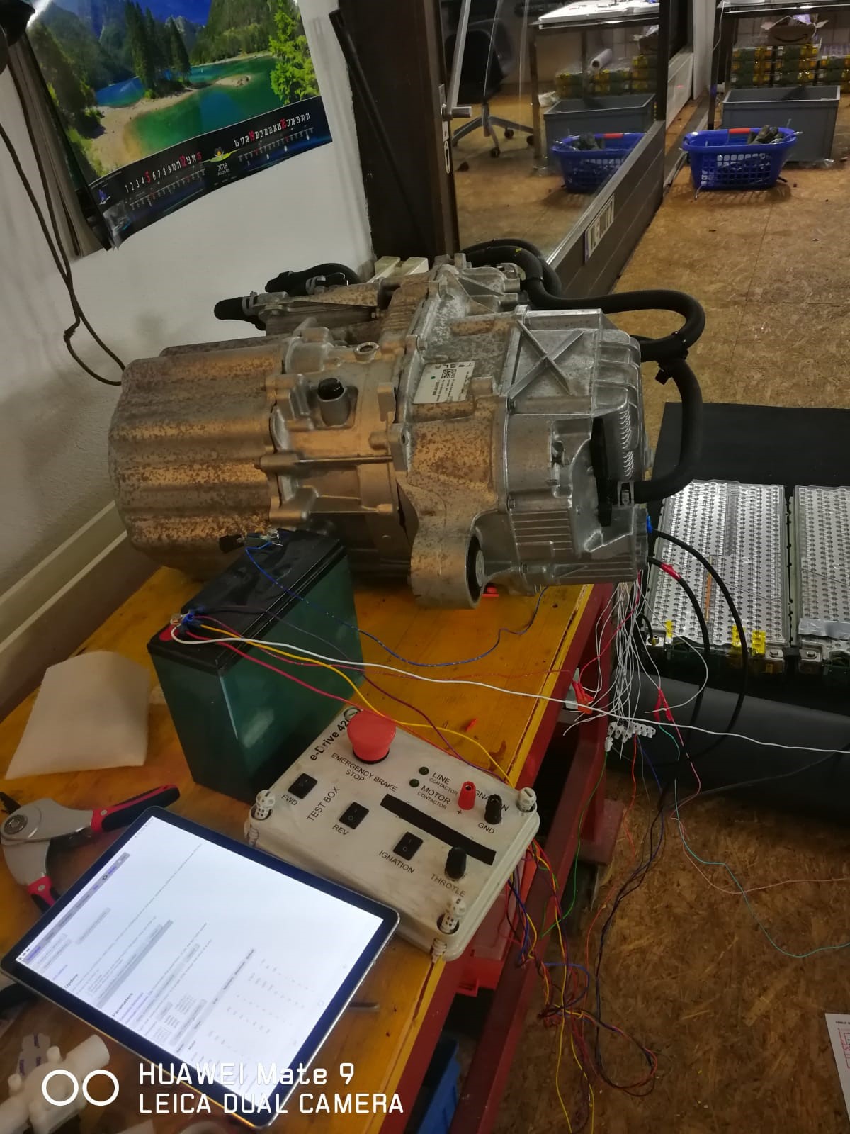

Re: Tesla Small Drive Unit Support Thread
Bad news from my side!
I changed resistor to 3k17 but dinocur still on error!
anyone with better results?
Can you repeat all the previous measurements and post the results with the changed resistor?
You would need to reload the parameters having changed the resistor.
Ok here my measures of today!
before resistor change:
C11 =3.31V to 3.31V
C14 =1.85V 1.19V
C5= 3.8V 2.65V
C8=3.8V 2.65V
R7=4.6V 2.58V
now will try to reload parameters:)
Update:
Parameters reloaded.
Error alive.
Messages: Clear
[1]: WARN - PWMSTUCK
[10]: WARN - HICUROFS1
[10]: WARN - HICUROFS2
Can we measure the voltages as before please?
Right, let's examine what these voltages mean.
C11 = 3.31V - upper current limit setting. IF the voltage from either current sensor exceeds this we trigger an ocurlim and shutdown.
C14 = 1.19V - lower current limit setting. IF the voltage from either current sensor drops below this we trigger an ocurlim and shutdown.
C5= 2.65V - output from current sensor 1
C8= 2.65V - output from current sensor 2
R7= 2.58V - midpont reference voltage for the current sensor amplifier. This decides the center point for zero amps.
Now in the above case I still suspect R7. If we pop 4k7 3k16 into a calculator such as here :
https://www.electronics2000.co.uk/calc/ ... ulator.php
We should see around 2v , not 2.58v.

Yeah,my SDU got first LV testing and is alive......many thanks to all who try helping!!
At the moment i have no shaft stumps for higher rpm or can i run it without??

You'll have no oil and I wouldn't recommend it. Also remember that you need cooling if running for anything other than a few seconds... the inverter has little thermal mass and no protection on the power stage
