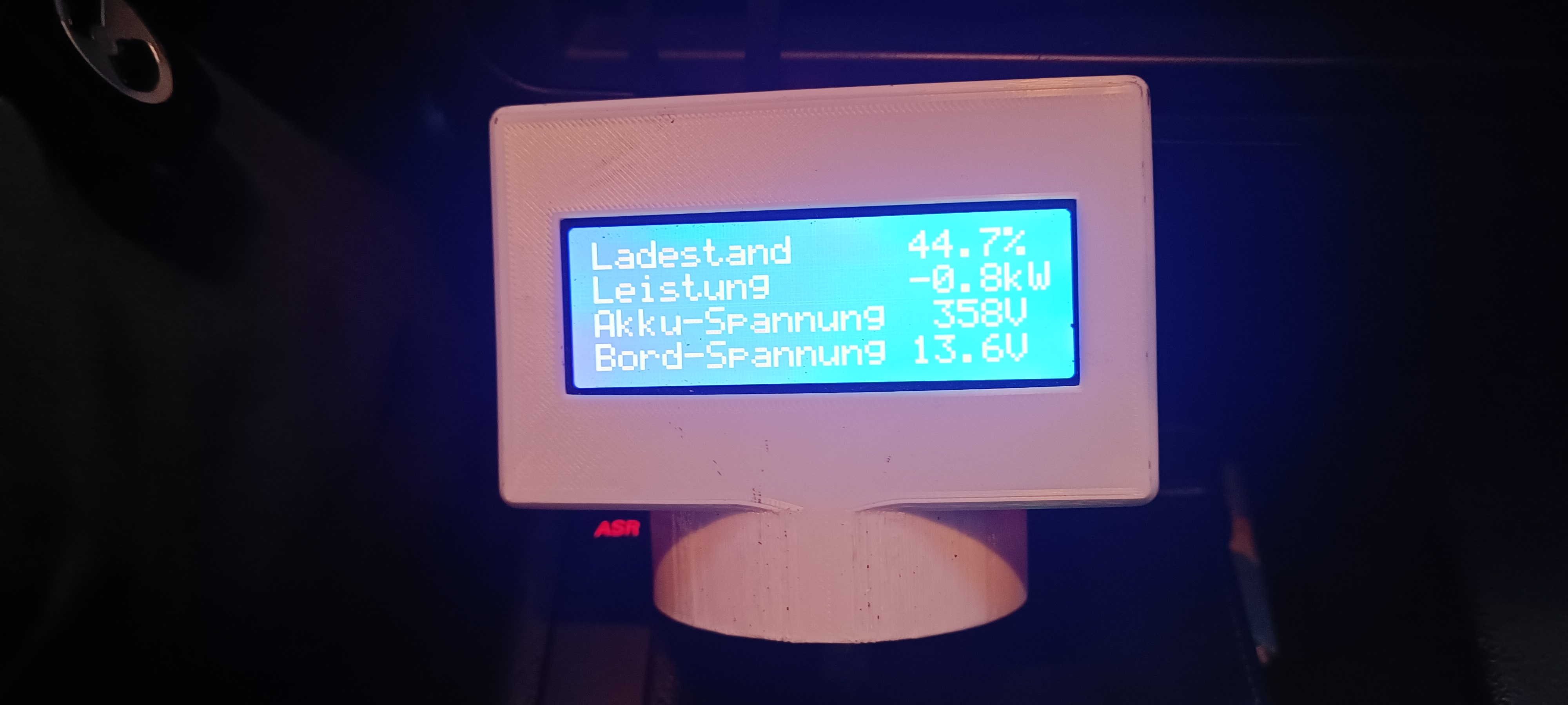

Re: Audi A2 /w Prius Gen2 Transaxle & Inverter
Audi is now delivered
It was a 350 km drive, 5 charge stops (not 6 as stated in the video), 45 kWh spent.
Makeshift CCS held up just long enough to make the trip except a short tow from my dad 10 km before we touched base
Early forum release
Early forum release
That is 4.8 mile/kw. Really good. with the electricity price here would be about $3.8

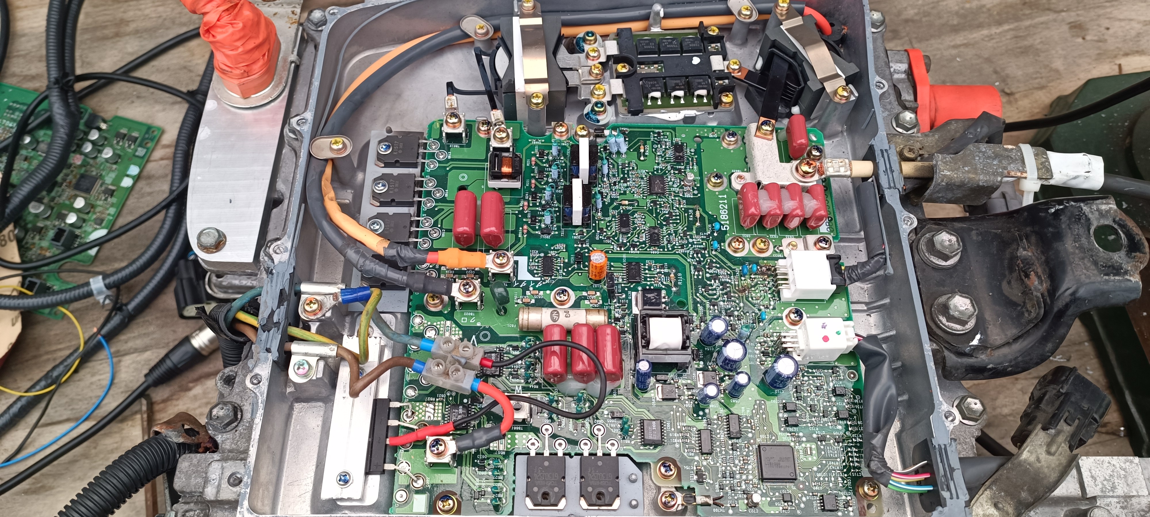

Re: [DRIVING] Audi A2 /w Prius Gen2 Transaxle & Inverter
Just found that I'd taken a picture of the modified A/C inverter, here it is
- Posts: 6759
- Has thanked: 383 times
- Been thanked: 1580 times

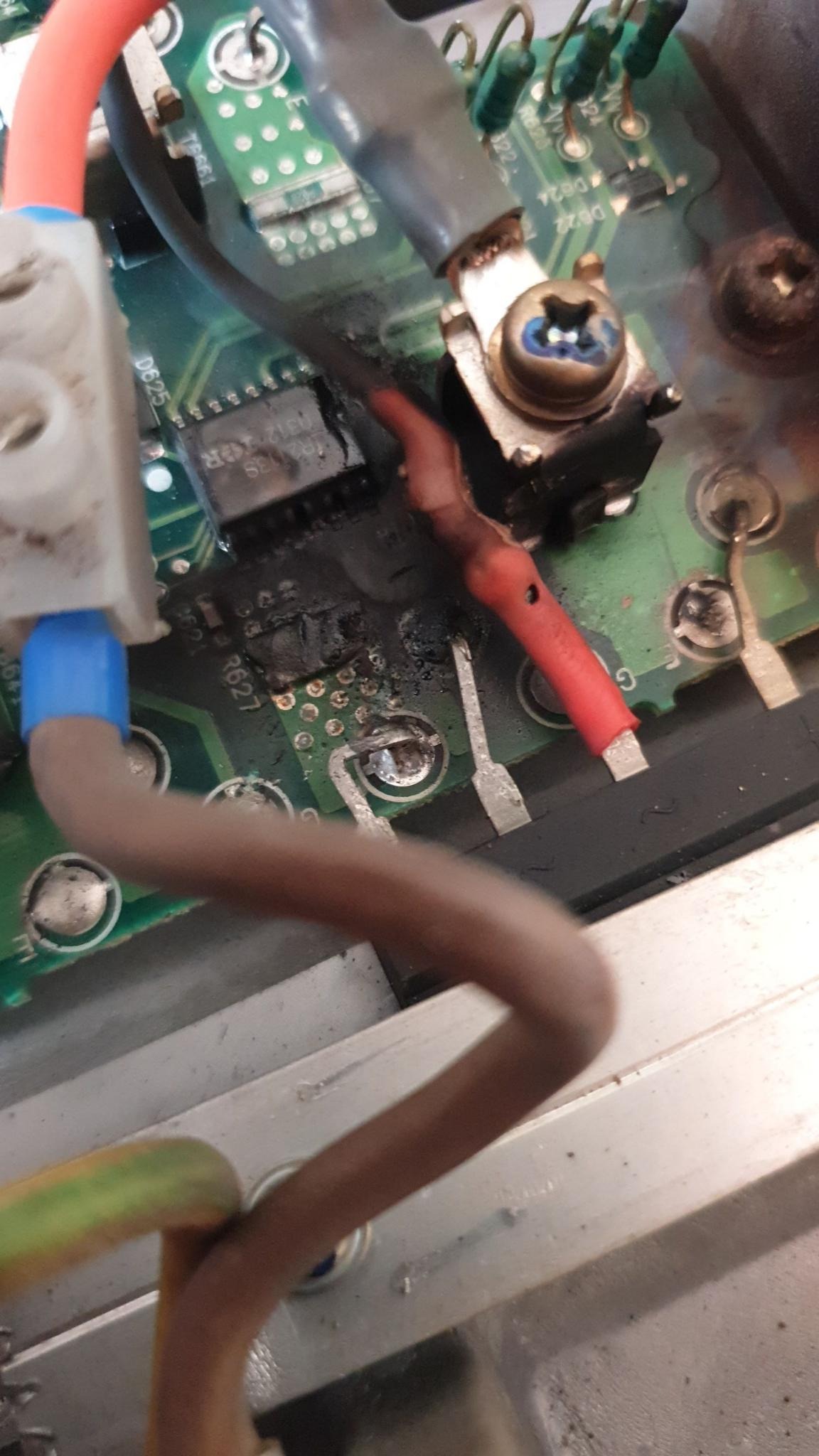

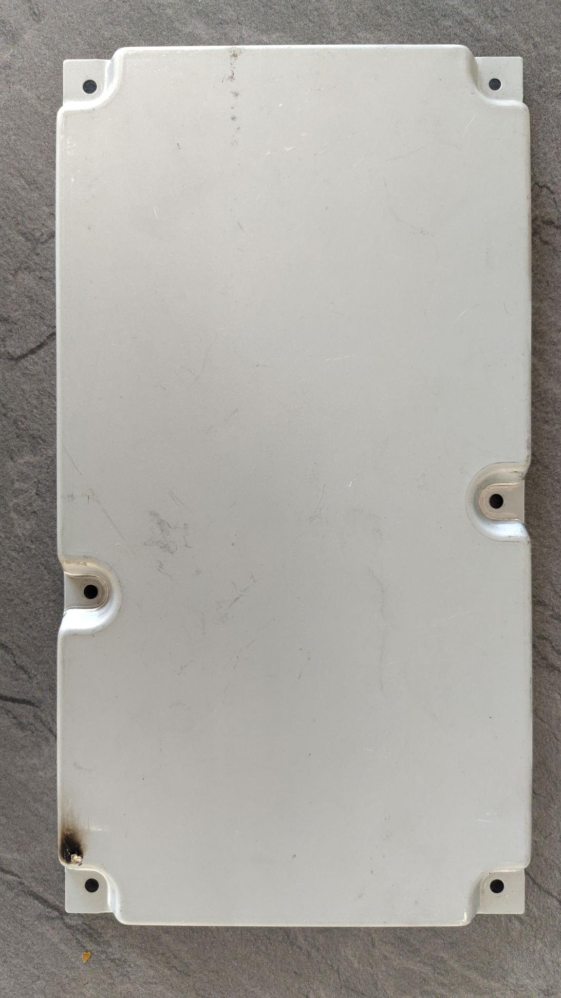

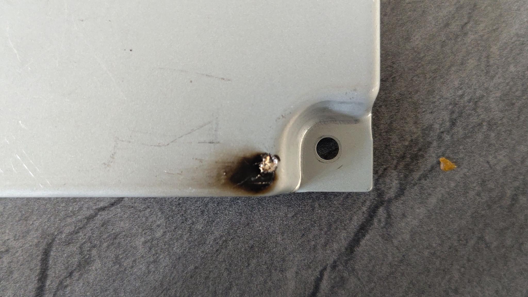

That connection wasn't up to the job
Which connection has died? The smaller gauge wire soldered to the rectifier leg?
- Posts: 6759
The connection with the heat shrink. It was actually crimped to the leg, not soldered. Maybe that was not so clever, I don't know.
I always charged at 2kW but before delivering the car I raised this to 2.8kW for more reasonable charging time. That must have killed it.

I visited Thomas yesterday and we worked on the various issues.
The most pressing one was GFCI or breaker trips when charging. Turned out the metal casing of the BMS made intermittent contact with one of the battery poles! Very noticeable burn marks. We swapped the metal LBC cover for the plastic one and added more layers of duct tape.
Thomas made a little ESP gadget that displays some data: He also had power cutouts in the past, we will have to see if that is also fixed now. We did a 100 km test drive and all was fine.
And here are the burn marks
