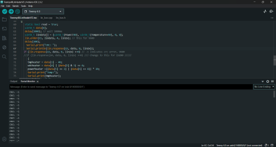

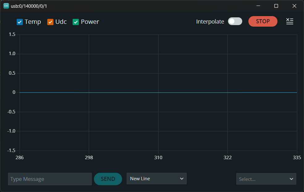

OK. So I solved the Serial Plotter issue by asking for help on the Teensy forum and after some troubleshooting, I just needed to move a set of braces and edit the serial print commands. Updated code attached.
Teensy_LIN_bus_heater_V2.ino
(2.05 KiB) Downloaded 427 times
So now I am seeing Power, Temp and UDC but they are staying static at ZERO so something is still off on the programming I assume. No feedback. I tried at both 9600 and 19200.

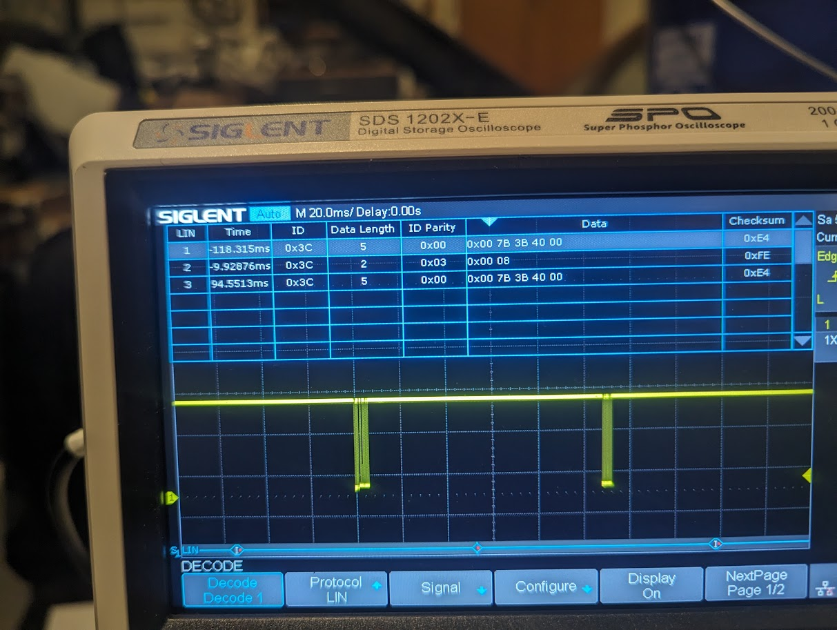

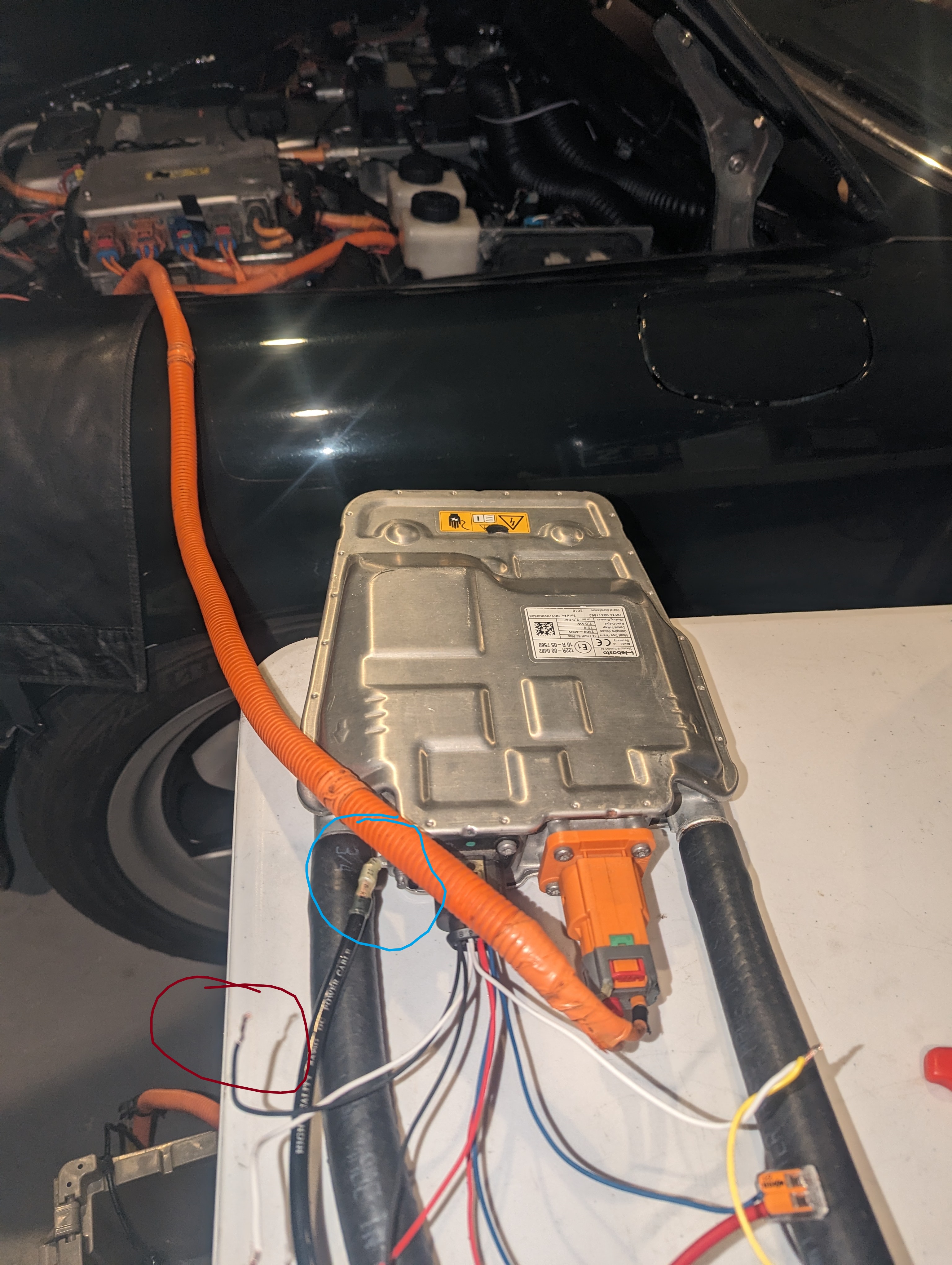

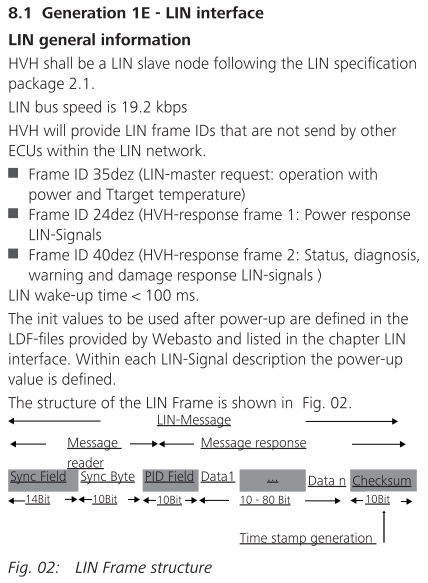

Hi guys. So I spent most of the day troubleshooting the heater with the help of one of the members of the Teensy forum (Paul). It was very helpful. Some things we learned today.

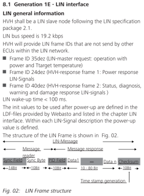

In the Webasto LIN document you attached in message #32, I see this:
HVH shall be a LIN slave node following the LIN specification package 2.1. Paul believed that this means that we have to tell the library to calculate the Enhanced Checksum by adding the "lin2x" parameter. So I updated the code with this information

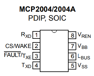

It seemed to get the board to open up the 3.3V on pins 2 and 4 on the MCP2004 chip.
STILL NO HOT WATER!

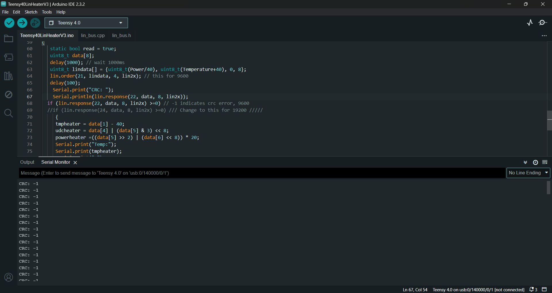

thanks for the response and explanation of the FFFFFFFF response. So if I am getting the -1 response, what are my options to troubleshoot?
I am trying both baud rates with the 22 @ 9600 and 24 @ 19200.
I will restore the lin.order command on your explanation of why it is needed.
I am glad your transceiver is working with the lin2x fix. Are you using the Teensy board or something else?
Are you getting heated water?
Is there a simpler program that would just tell me if I am getting connection to the heater?

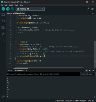

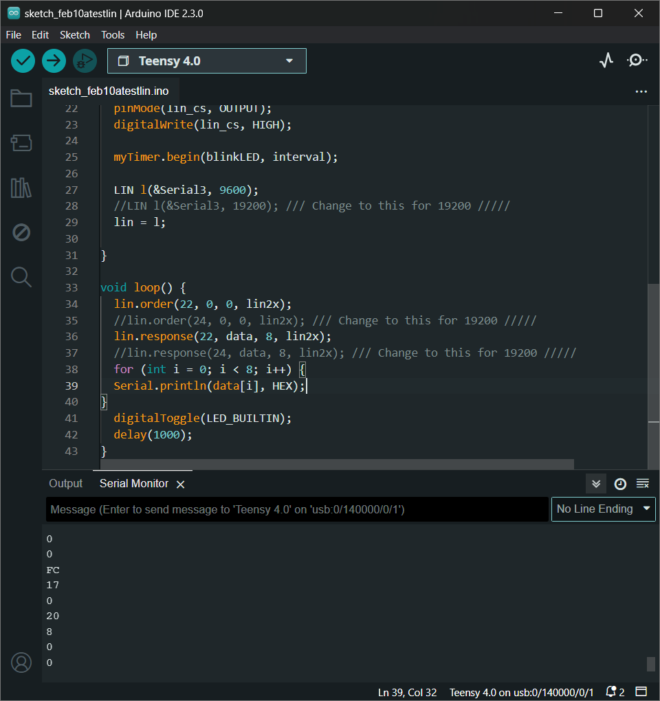

OK . . . so Paul suggested I revise the code as follows:
#include "lin_bus.h"
// Create an IntervalTimer object
IntervalTimer myTimer;
int ledState = LOW;                // ledState used to set the LED
unsigned long interval = 200000;   // interval at which to blinkLED to run every 0.2 seconds
LIN lin;
int lin_cs = 32; // cs and serial port set for skpang LIN / FDCAN board
uint8_t data[8];
void blinkLED() {
  ledState = !ledState;
  digitalWrite(LED_BUILTIN, ledState);
void setup() {
  pinMode(LED_BUILTIN, OUTPUT);
  pinMode(lin_cs, OUTPUT);
  digitalWrite(lin_cs, HIGH);
  myTimer.begin(blinkLED, interval);
  LIN l(&Serial3, 9600);
  //LIN l(&Serial3, 19200); /// Change to this for 19200 /////
  lin = l;
void loop() {
  lin.order(22, 0, 0, lin2x);
  //lin.order(24, 0, 0, lin2x); /// Change to this for 19200 /////
  lin.response(22, data, 8, lin2x);
  //lin.response(24, data, 8, lin2x); /// Change to this for 19200 /////

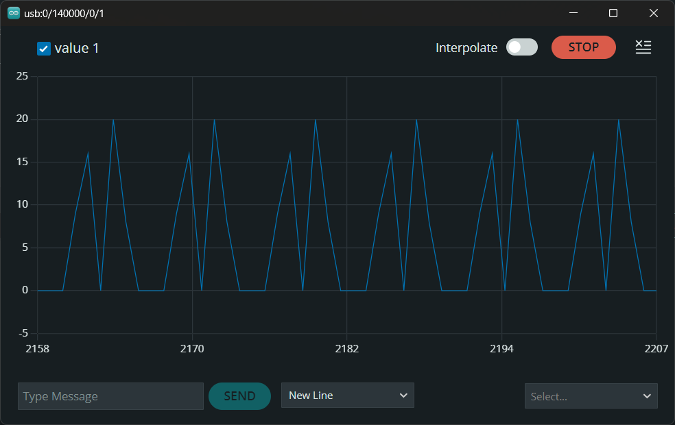

  for (int i = 0; i < 8; i++) {
  Serial.println(data[i], HEX);
  digitalToggle(LED_BUILTIN);
  delay(1000);

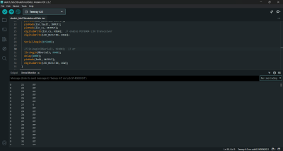

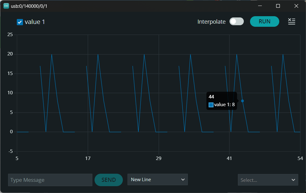

This yielded a different response from the FFFFFFFF
and the plotter shows this:
So I am wondering what this means to you. I got these same readings with and without the heater connected and powered on and off and same results in 9600 and 19200 modes.

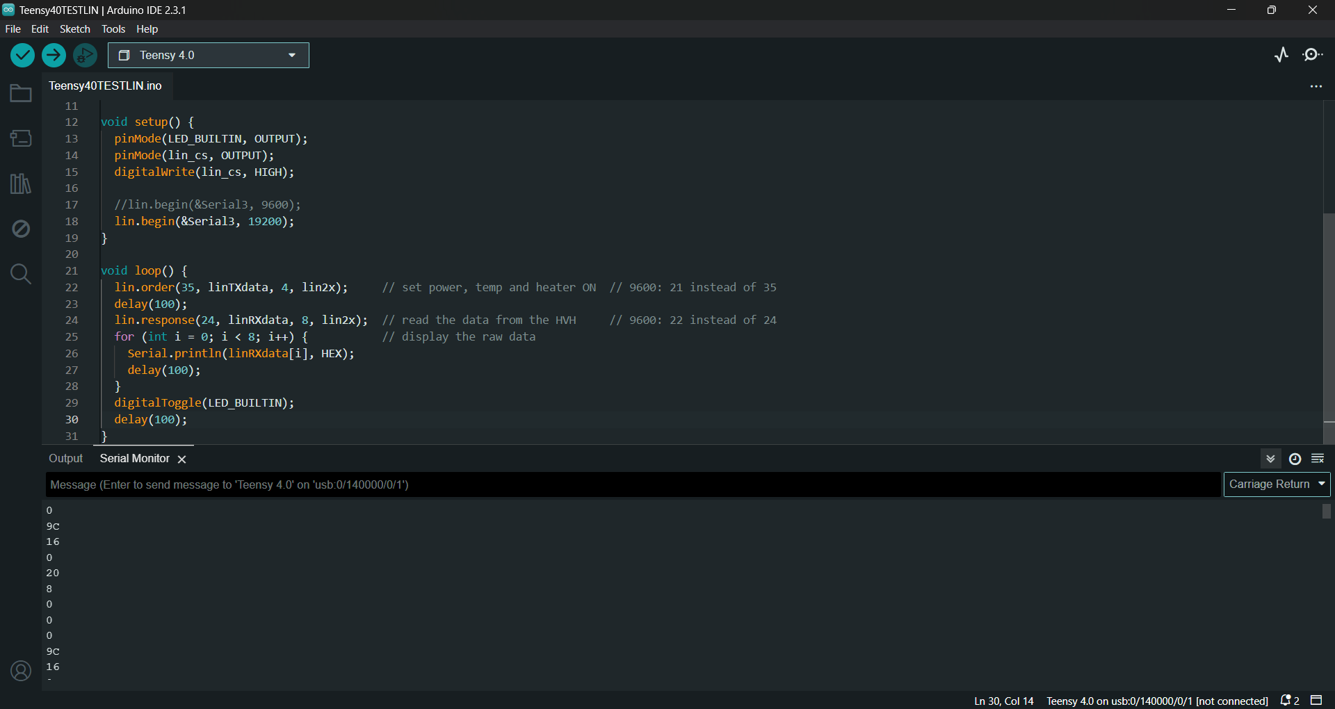

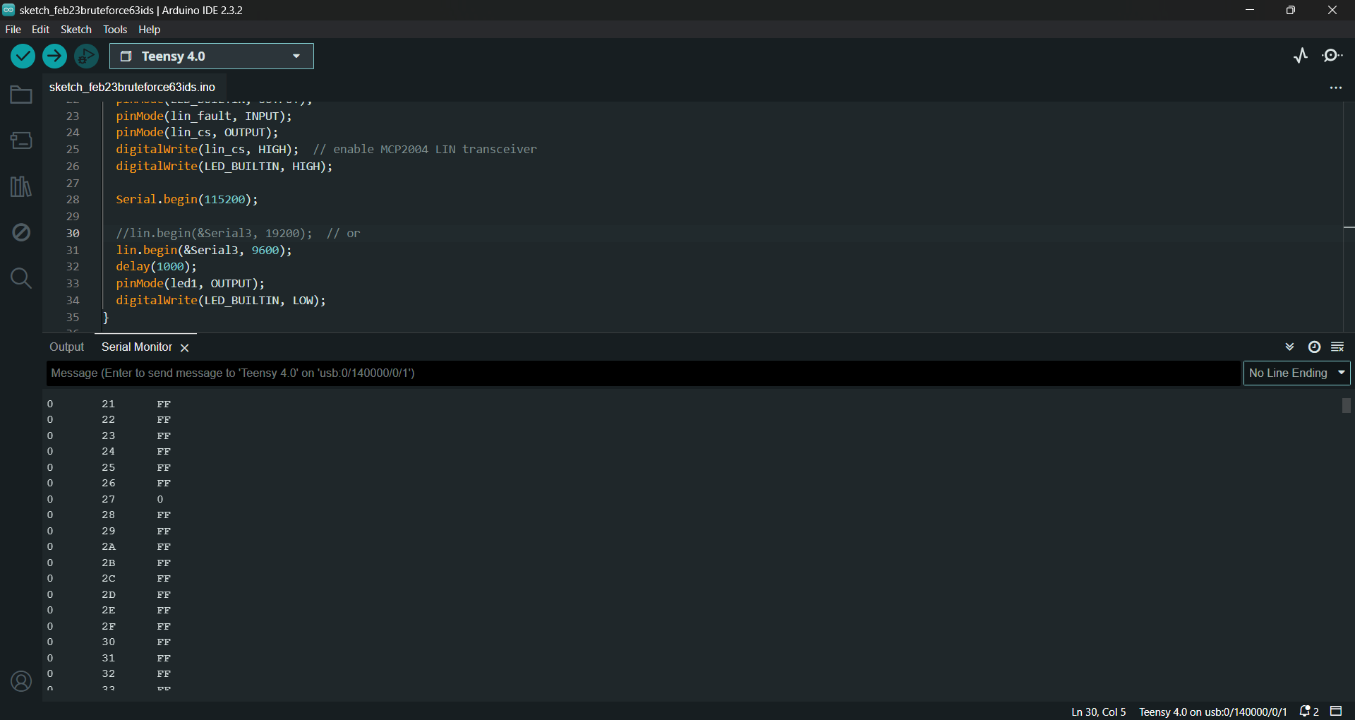

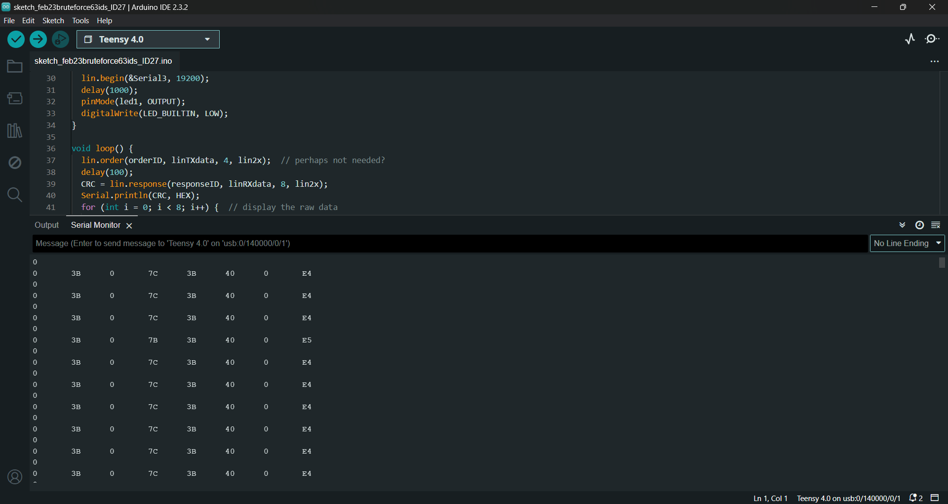

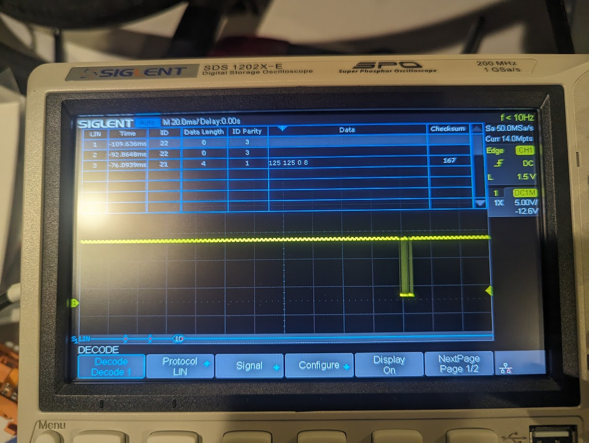

hello royhen99. I was hoping to pick this back up. I have now been able to test the teensy and breakout board with a slave RGB board and LIN is being transmitted to make the slave board LED go Green, Blue and Red. Here is that working code.

I am still not getting hot water from the heater, so I assume something in your coding is not telling the heater to turn on. I am trying to understand the If Else code below.
 if (lin.response(22, data, 8, lin2x) >=0) // -1 indicates crc error, 9600
  //if (lin.response(24, data, 8, lin2x) >=0) /// Change to this for 19200 /////
     tmpheater = data[1] - 40;
     udcheater = data[4] | (data[5] & 3) << 8;
     powerheater =((data[5] >> 2) | (data[6] << 8)) * 20;
     Serial.print("Temp:");
     Serial.print(tmpheater);
     Serial.print(",");
     Serial.print("Udc:");
     Serial.print(udcheater);
     Serial.print(",");
     Serial.print("Power:");
     Serial.println(powerheater);
   if (read)
      lin.order(22, 0, 0, lin2x); // 9600
   else
	    uint8_t lindata[] = {uint8_t(Power/40), uint8_t(Temperature+40), 0, 8};
		  lin.order(21, lindata, 4, lin2x); // this for 9600
      //lin.order(35, lindata, 4, lin2x); /// Change to this for 19200 /////
      //Serial.print("\n Sending power and temperature");
Can you help me understand the reason for the second IF command and also why there is no action to be taken if the statement is true?
Also, should we not be sending commands to ID 21 instead of ID 22 based on 21 being write power and 22 being read measure and 23 being read status?

So based on the work done over here by you and Johan, the guys at the Teensy Forum put together a sketch with a feedback loop to see if we could get a reaction from the HVH.
I compiled and ran the below code in both 9600 and 19200 baud on both of my HVH heaters. With and without power I only got a response of:
0
9C
16
0
20
8
0
0

  lin.order(21, linTXdata, 4, lin2x);     // set power, temp and heater ON  // 9600: 21 instead of 35
  delay(1);
  lin.response(22, linRXdata, 8, lin2x);  // read the data from the HVH     // 9600: 22 instead of 24
  for (int i = 0; i < 8; i++) {           // display the raw data
    Serial.println(linRXdata[i], HEX);
  delay(100);
I assume I am looking for a 4 in the first position. Any other thoughts from anyone on here about why the heater is not reacting to the lin commands?
I am not doing anything with the HV and LV interlocks.
Also, I am testing it with and without HV running. I assume with 12V and LIN (but no HV), I should still get a response of 4 to the heater being on, right?
Also, just to be sure, with an scaling factor of 40 on the POWER, if I set to 175, I should be getting 7000W available power right?

jsimonkeller wrote: Sat Feb 17, 2024 10:32 pm I assume I am looking for a 4 in the first position. Any other thoughts from anyone on here about why the heater is not reacting to the lin commands?
As far as I see you still haven't really confirmed that there is ANY communication going on, right? Can you scope the LIN signal?
BTW have you solidly grounded the HVA via the ground stud and also connected up the grounds of your Teensy and the HVH?

johu wrote: Sun Feb 18, 2024 6:14 pm BTW have you solidly grounded the HVA via the ground stud and also connected up the grounds of your Teensy and the HVH?
Yes, the post on the HVH is grounded as well as the teensy. Besides the outer grounding post on the HVH (circled in green), is there another ground wire you are referring to? When the post is grounded, I notice that wire 8 from the harness (circled in red) has a ground signal, so I assume that tells me the unit is grounded.

As way of an update, I got my Oscilloscope and was able to at least see the LIN command is going out to the HVH with no response.
Updated code for a CRC response and still getting -1
I assume it could not be something in the CPP file that is not working as it should, but here is that code:

  static void SendLin()
   static bool read = true;
   uint8_t data[8];
   delay(1000); // wait 1000ms
   delay(100);
    Serial.print("CRC: ");
    Serial.println(lin.response(22, data, 8, lin2x));
     Serial.print(",");
     Serial.print(",");
   else if (read)
   else
   read = !read;

Thanks Johan. I am still getting no response with 3 different heaters on the test bench... 300V . . . 12V and LIN connected . . . . grounded . . . I will certainly have extra to share when I finally crack this. :D
We wrote a shorter SKETCH to do what you suggested above. I know you said to take out the Order on 21 or 35, but don't we need to send something to get a response? I would be seriously surprised that the circuitry will react before sending a Power ON request first. That's how I would design it if I was a Webasto engineer...
LIN lin;
int lin_cs = 32;
int CRC = 0;
int led1 = 23;
int lin_fault = 28;
uint8_t linTXdata[4] = { 1, 85, 0, 8 };  // 40W, 45C, heater on
uint8_t linRXdata[8] = { 0, 0, 0, 0, 0, 0, 0, 0 };
void setup() {
  pinMode(lin_fault,INPUT);

Another update on my saga.
We ran the below code to brute force all IDs on request and all IDs on reponse.
LIN lin;
int lin_cs = 32;  // pin 23 for my LIN board
int led1 = 23;
int lin_fault = 28;
uint8_t CRC = 0;
uint8_t orderID = 0;
uint8_t responseID = 0;
void setup() {
  pinMode(lin_fault, INPUT);
  digitalWrite(lin_cs, HIGH);  // enable MCP2004 LIN transceiver
  digitalWrite(LED_BUILTIN, HIGH);
  Serial.begin(115200);
  //lin.begin(&Serial3, 19200);  // or
  lin.begin(&Serial3, 9600);
  delay(1000);
  pinMode(led1, OUTPUT);
  digitalWrite(LED_BUILTIN, LOW);
void loop() {
  for (orderID = 0; orderID < 64; orderID++) {
    for (responseID = 0; responseID < 64; responseID++) {
      lin.order(orderID, linTXdata, 4, lin2x);
      delay(100);
      CRC = lin.response(responseID, linRXdata, 8, lin2x);
      Serial.print(orderID, HEX);
      Serial.print("\t");
      Serial.print(responseID, HEX);
      Serial.print("\t");
      Serial.println(CRC, HEX);
      delay(100);
The result was a response at ID 39 on every ID that was ordered:
We modified the code to read out only ID 0x27
LIN lin;
int led1 = 23;
int lin_fault = 28;
uint8_t CRC = 0;
uint8_t orderID = 0x00;
uint8_t responseID = 0x27;
void setup() {
  delay(1000);
void loop() {
  lin.order(orderID, linTXdata, 4, lin2x);  // perhaps not needed?
  delay(100);
    Serial.print(linRXdata[i], HEX);
    Serial.print("\t");
  Serial.println();
  delay(100);
which resulted in this response:
Scope looked like this:
No responses on ox27, but mostly 0x3c and 0x3d which are the status IDs for the HVH in the manual:
8.5 UDS-Diagnosis
The standard LIN 2.1 Diagnosis frames (see LDF file Frame
ID 0x3C / 0x3D) will be used to map Universal Diagnosis
Services / Sub-Services and Data.
Not sure what to do with all of this information, but hoping someone has some thoughts on how to take what I have figured out today to the next step.
Thanks!

I tested all 3 of my HVH heaters and on all three of them at 19200 baud, at ID 27 (HEX), it finally popped some response when sending a brute force write to all of the IDs using 1,85, 0, 8. FF down the line on all other response ids, but
Heater one returned a 0 at ID 27(HEX)
Heater two returned a 21 (HEX) at ID 27(HEX)
Heater three returned a 28 (HEX) at ID 27(HEX)
Not sure where to go from here.
EV_Builder
Posts: 1205
Location: The Netherlands
Has thanked: 18 times
Been thanked: 37 times
Re: Webasto HVH50
Post by EV_Builder »
Time to fed it HV , 12Vdc and turn it on?
