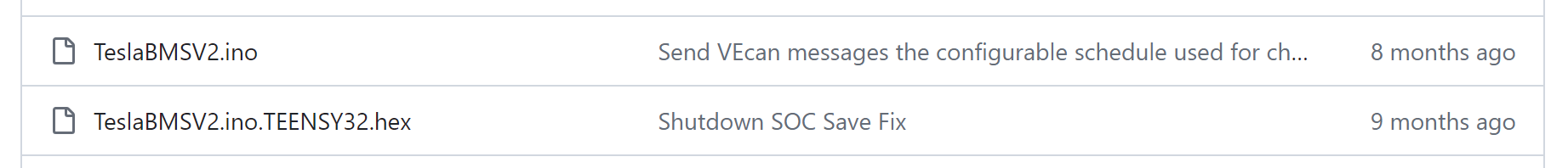

My first time upgrading the Tesla2BMSV2 firmware. Arduino IDE throws warning messages. Could somebody please confirm whether these can be disregarder? These look like mainly due converting\comparing variables of not matching types.

alexbeatle wrote: Thu Apr 04, 2024 2:42 am Hello.
Why are you compiling? There is a .hex you can upload. If you compile your own versions then giving support on any issues is not really possible due to library changes ect.
alexbeatle
Posts: 277
Has thanked: 71 times
Been thanked: 29 times
Re: Simp BMS
Post by alexbeatle »
tom91 wrote: Thu Apr 04, 2024 8:52 am Why are you compiling? There is a .hex you can upload. If you compile your own versions then giving support on any issues is not really possible due to library changes ect.
ok. Learned something new. I'll try the .hex file. Is it the most up-to-date? Shows a month difference between the project and the .hex.
