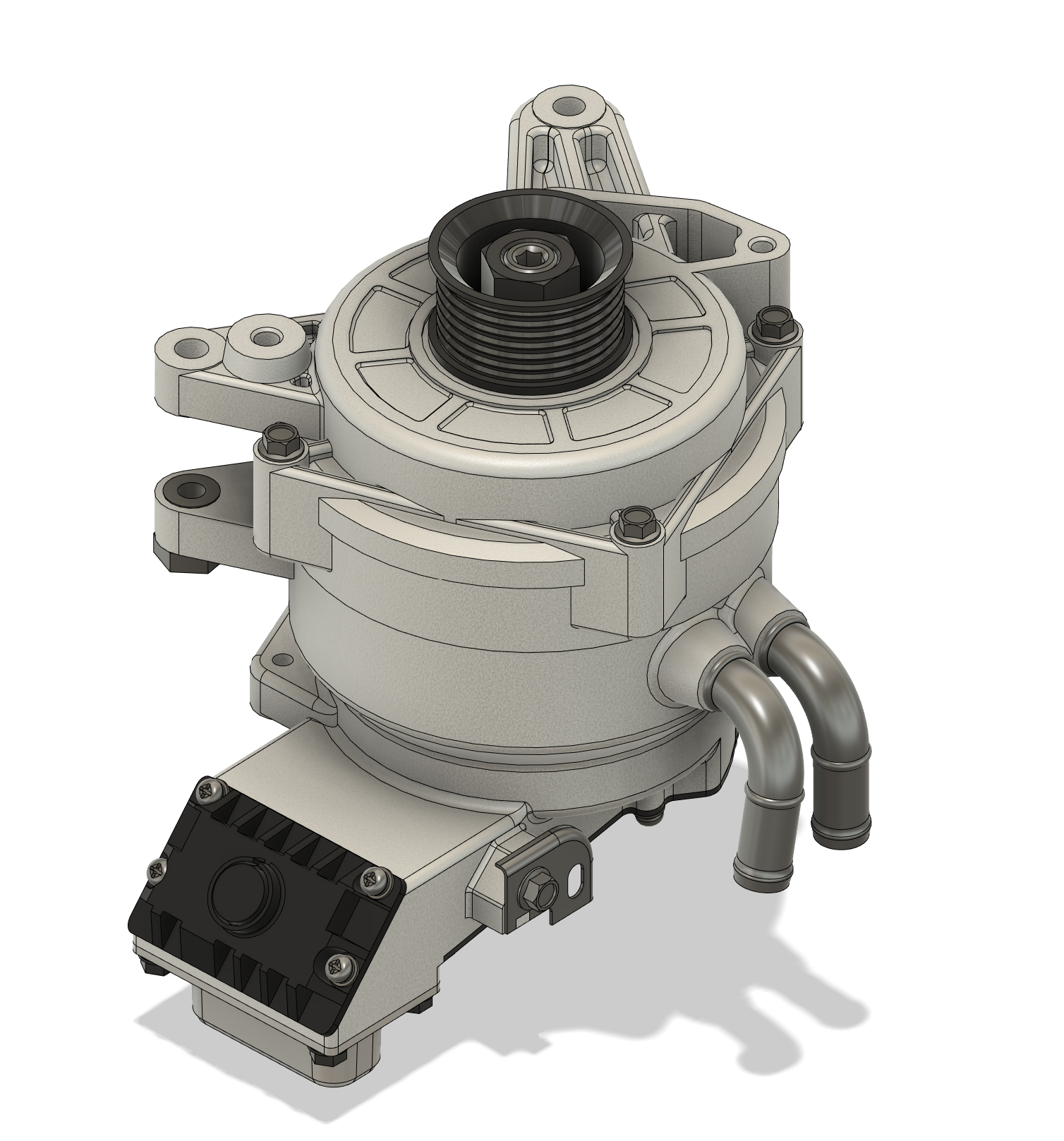

Picked up one of these for a project and threw together a rough CAD model. Just done using calipers in front of the CAD computer, not based on a laserscan or anything so double check the measurements before you use it.
Stepfile below:
https://drive.google.com/file/d/16VgBdF ... drive_link
