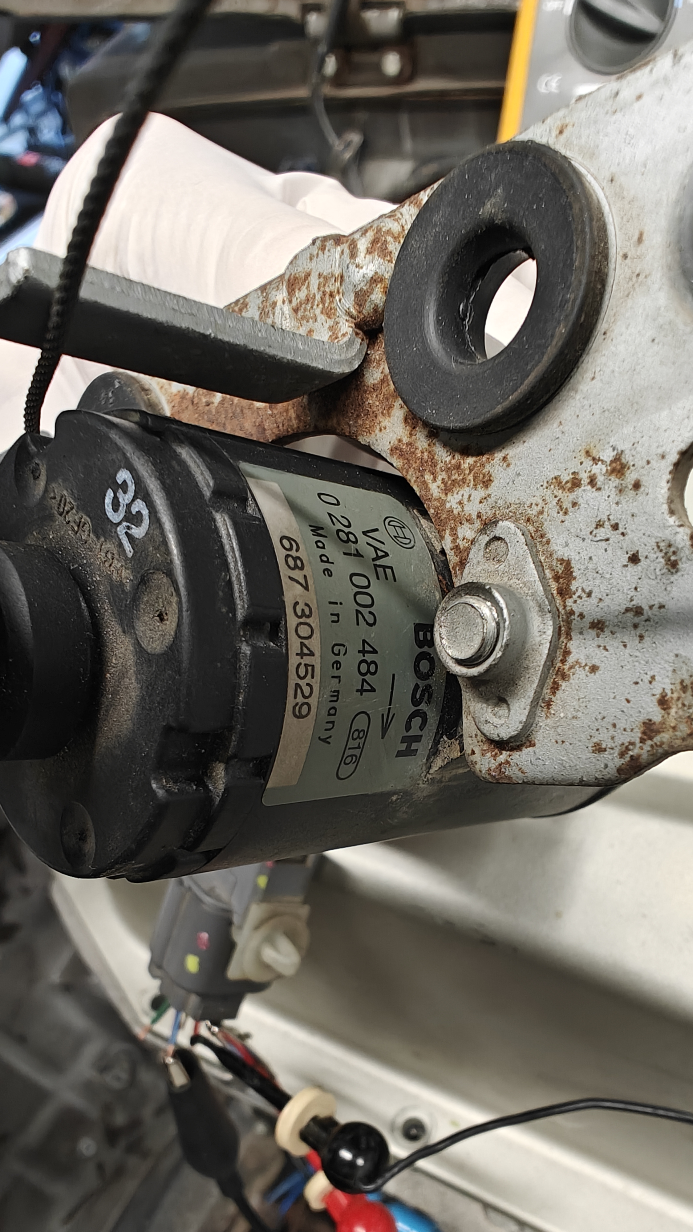

I just bought a throttle from a BMW E46, It's a Bosch 0 205 001 040.
Does anybody have the pinout for this? Or anybody who can tell me how to find out what color is what on the cables?
This is essentially a glorified potentiometer (hence the designator "R" for resistor). It has an angular range of 0-78° which corresponds to a voltage of 0-5V on Pin 1. Pin 2 is the +5V supply and Pin 4 is ground. The documentation does not state if 0° is 5V or 0° is 0V on Pin 1, you'll have to measure that.
On the left you can see an idle switch, which is open for less than 12% throttle and closed for more than 12% throttle. The switch connects the signal Pin 5 to ground on Pin 8. I don't think it would have much use for OpenInverter or ZombieVerter.
The cable colors are in German as well:
GR - Grau - Grey
WS - Weiß - White
GE - Gelb - Yellow
BR - Braun - Brown
BR/GN - Braun/Grün - Brown/Green
The pink cable seems to be unused in the BMW application.
