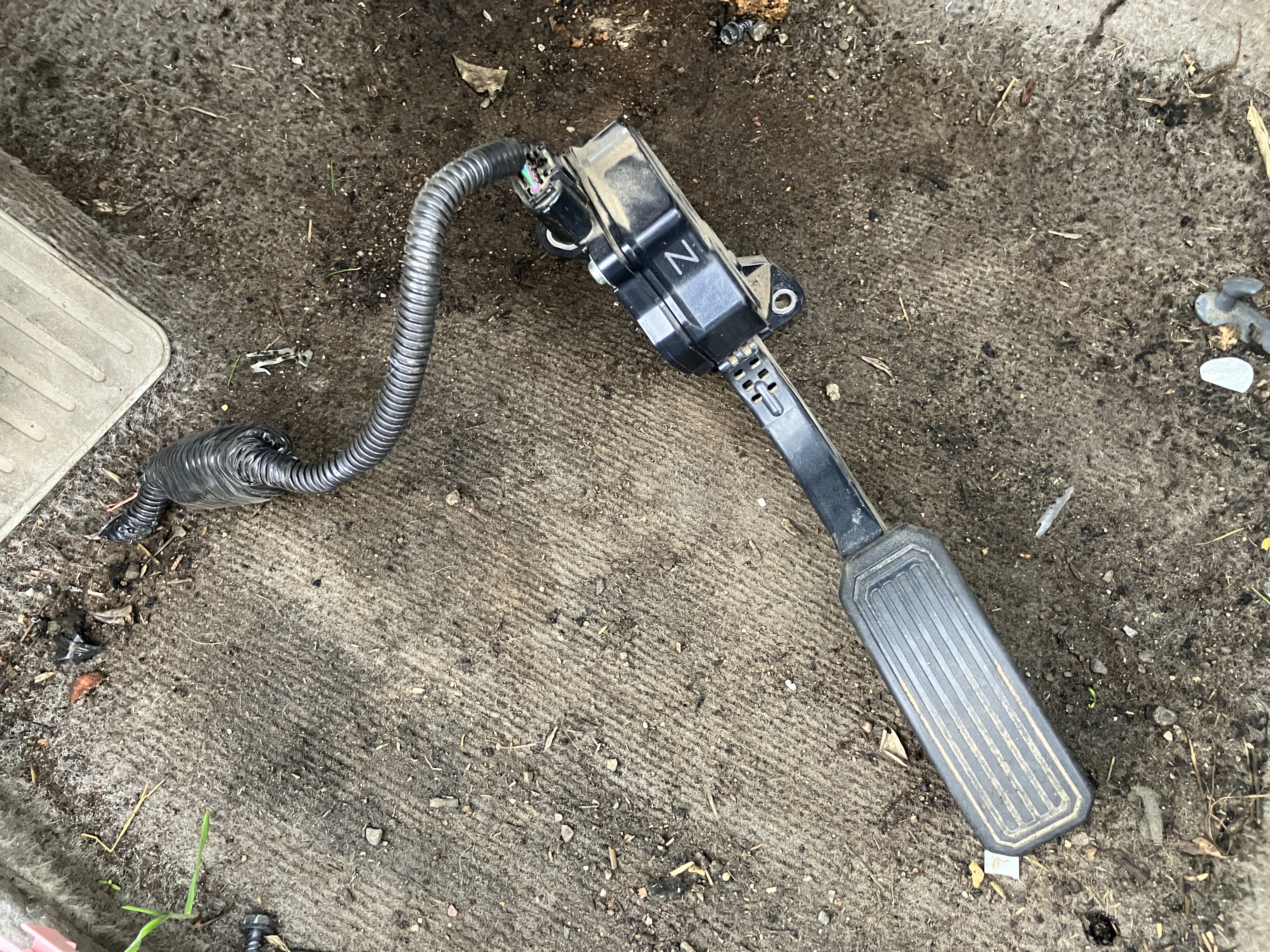

and this is the state I found that pedal in at the junk yard, nothing but a small scratch on that car, I'm certain it never was raced

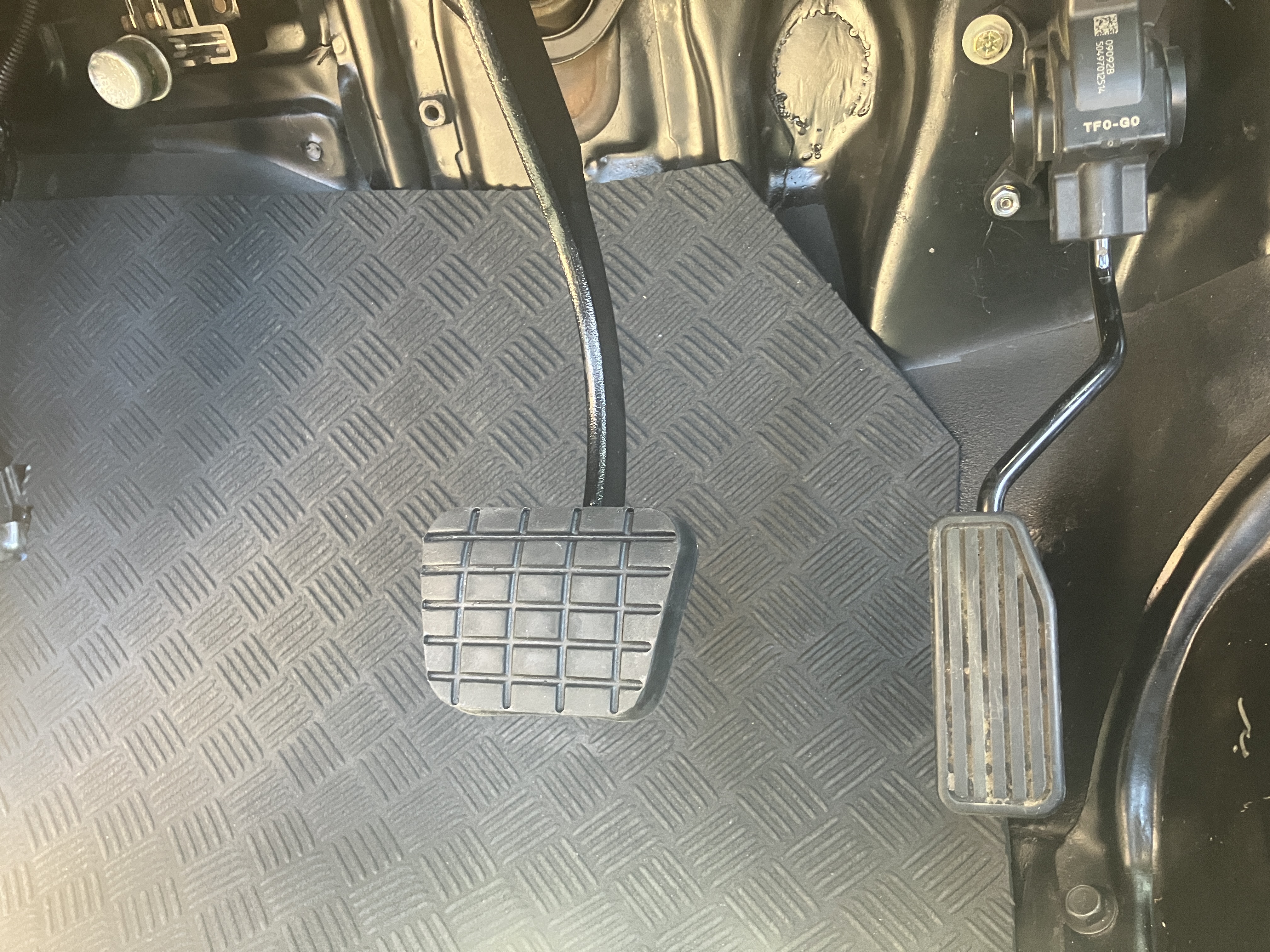

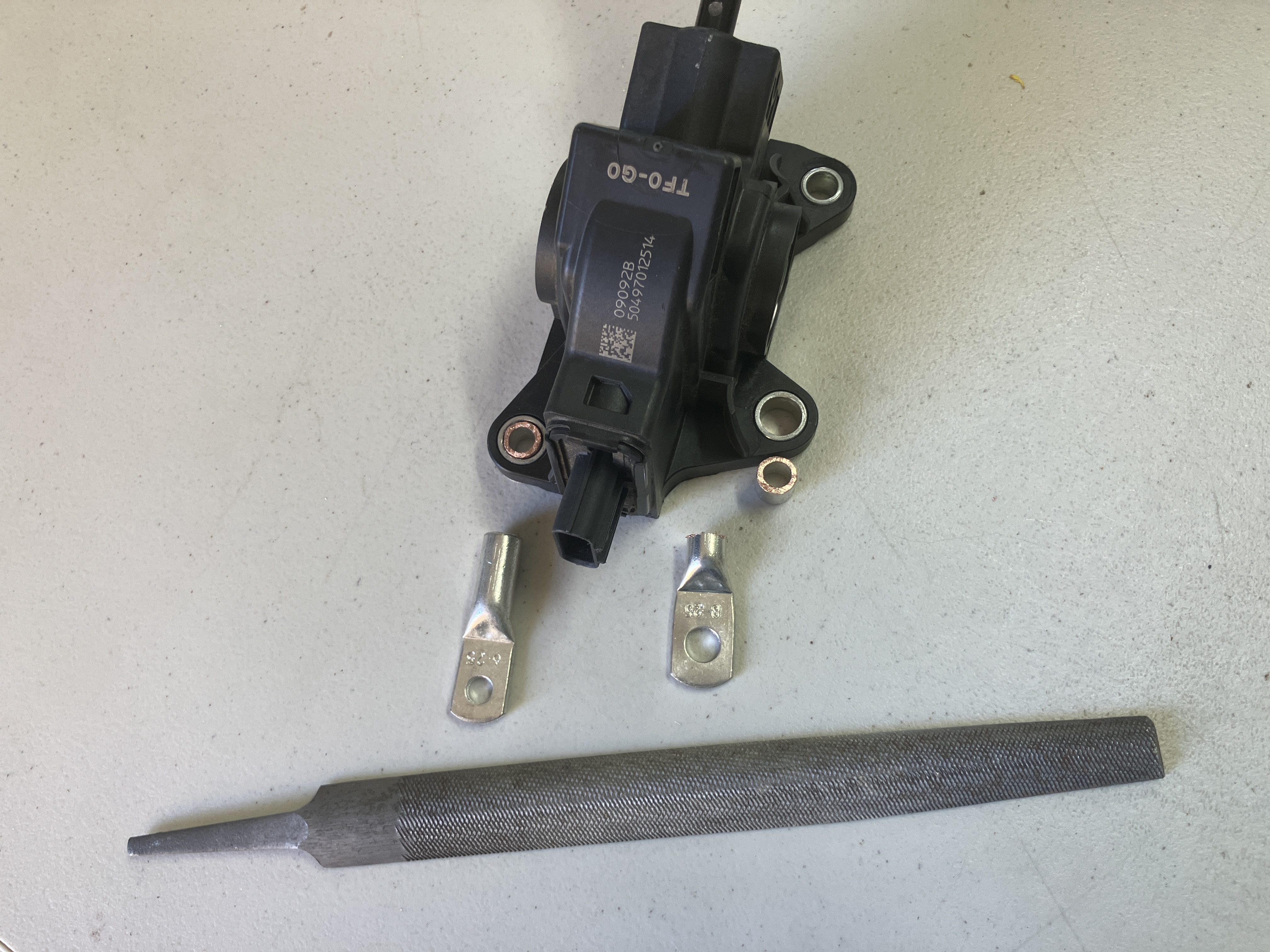

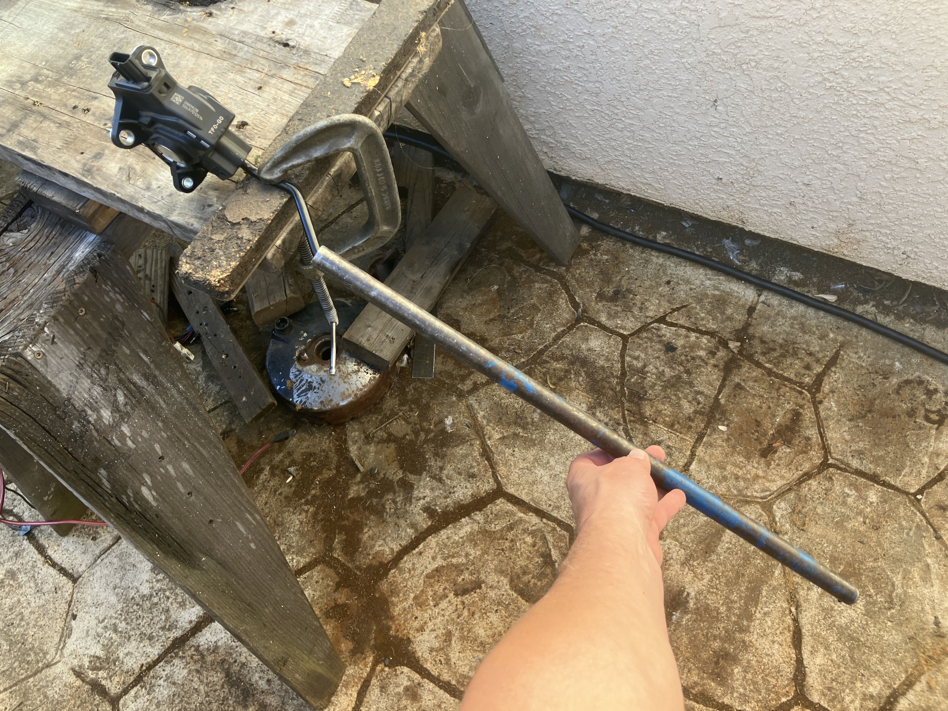

so finally got around to installing the 2010 Honda Fit throttle pedal in the truck
nice thing about this pedal is that it has a metal rod, which we can [ahem] persuade
here I am showing off my handrolic press
who knew these expensive cable lugs make cheap spacers
a lot of filing makes for perfect straight and even cuts each and every time
Gregski
Posts: 3161
Has thanked: 631 times
Been thanked: 1609 times
Post by Gregski »
and here it is, installized
the details belong to the devil
just to think, all this to be able to install a floor mat

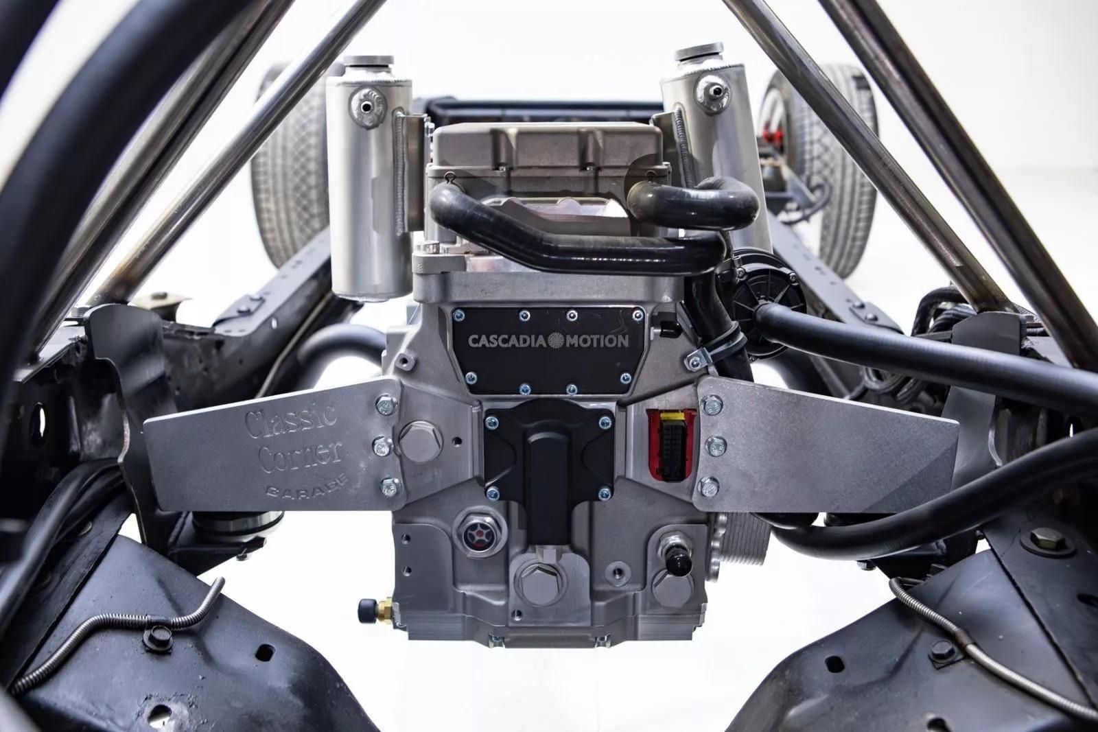

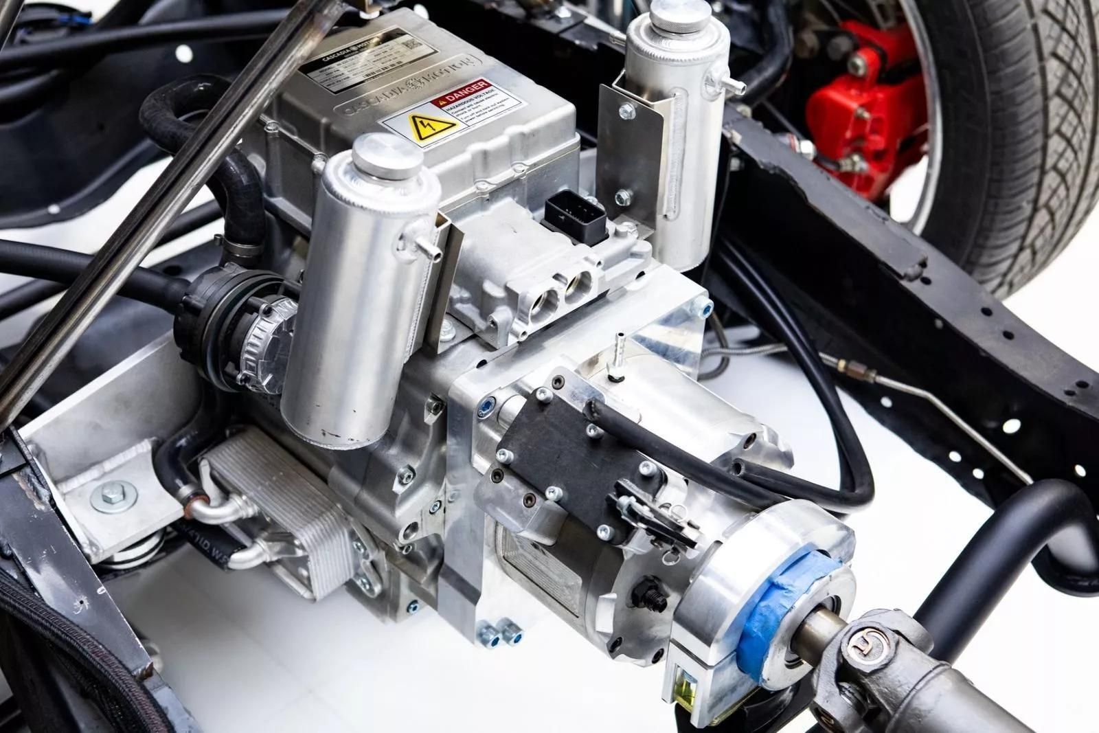

somebody posted this link for a 1972 Chevrolet C-10 EV Conversion Chassis kit I guess on eBay, to my truck build thread on the 67-72chevytrucks.com and I just wanted to share and hear your thoughts please
Upgrade your 1972 Chevy C10 (SWB) Chassis with the cutting-edge Complete Legacy EV Cascadia Motion Drive train package and accompanying batteries (chassis shown in pics is included). If you own a 67-72 C10 Short box, simply transfer your body parts onto this chassis. With a few final touches, you could be cruising in a unique EV-powered Classic Truck! This comprehensive package includes nearly $60,000 worth of drivetrain components and batteries. We've already assembled 90% of the chassis with the driveline, so all that's left is some minor assembly work to put together the truck on your own.
1972 Chevy C10 Chassis with Legacy EV Cascadia Motion Drive train package and accompanying batteries:

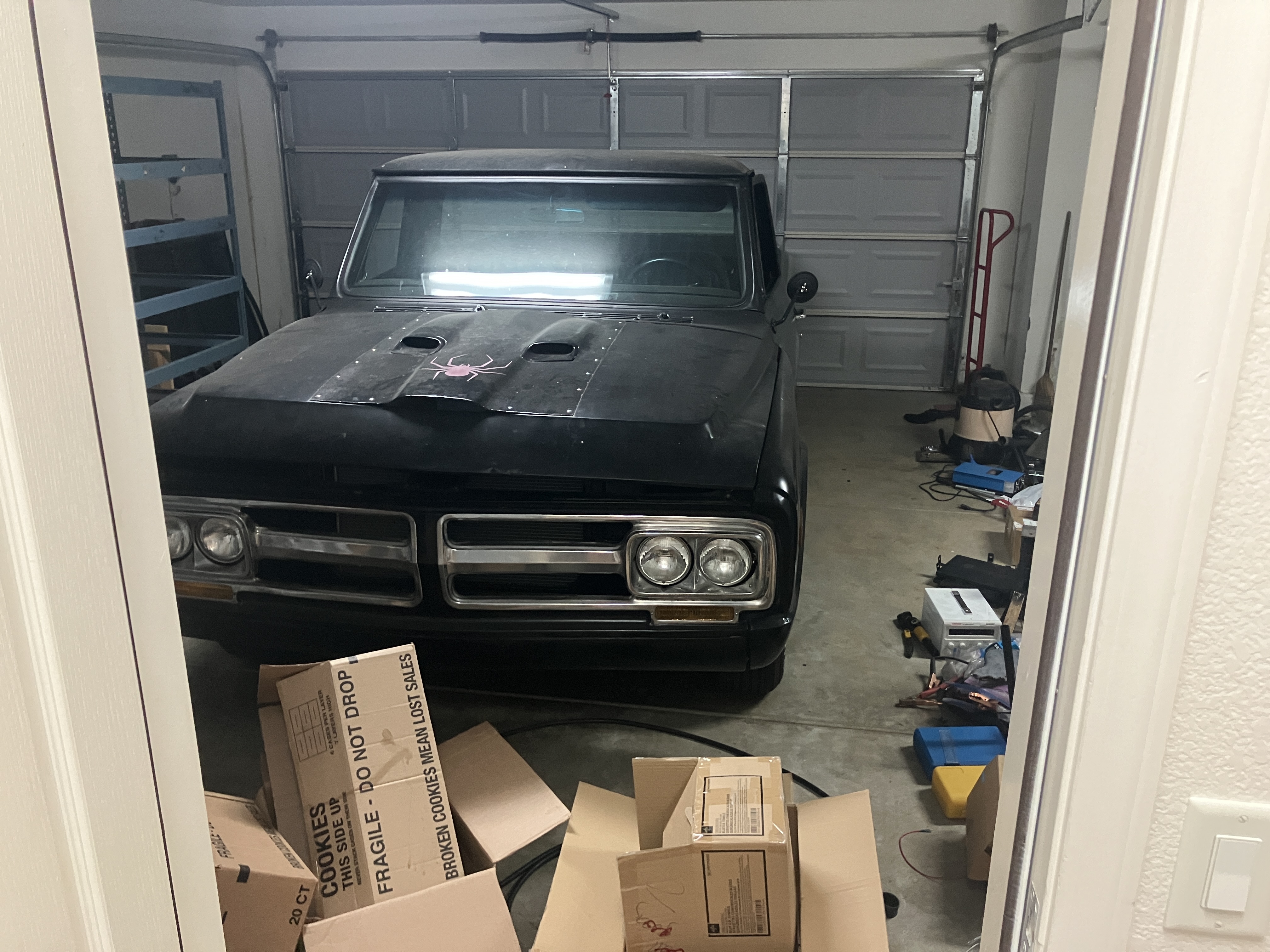

on this episode of I Want To Be Like Damien, I provide you with a little truck update. so as you know EV Conversions are super easy and get boring quickly, that's why I always like to sell my house, and pack up my shop and move into a new place, yes using the electric truck, like you know the Irish Cat Man did. so we pushed the 9 kWh baby battery pack limit making these 25 mile treks
and there she is, think outside the box
Posts: 1083
Has thanked: 479 times
Been thanked: 312 times
Post by MattsAwesomeStuff »
You moved? In 120'F weather? Why do you hate yourself?
Congrats/Condolences on the new place. It still has a garage, so, I'll take that as somewhat of a positive sign.
This answers why you've been so quiet.
Gregski
Posts: 3161
Post by Gregski »
MattsAwesomeStuff wrote: Fri Aug 02, 2024 7:21 pm You moved? In 120'F weather? Why do you hate yourself?
ha ha, this is a much bigger treeeee car garage, it doesn't look like that in the pic, also in this house EV parts can live inside, if you catch my drift
