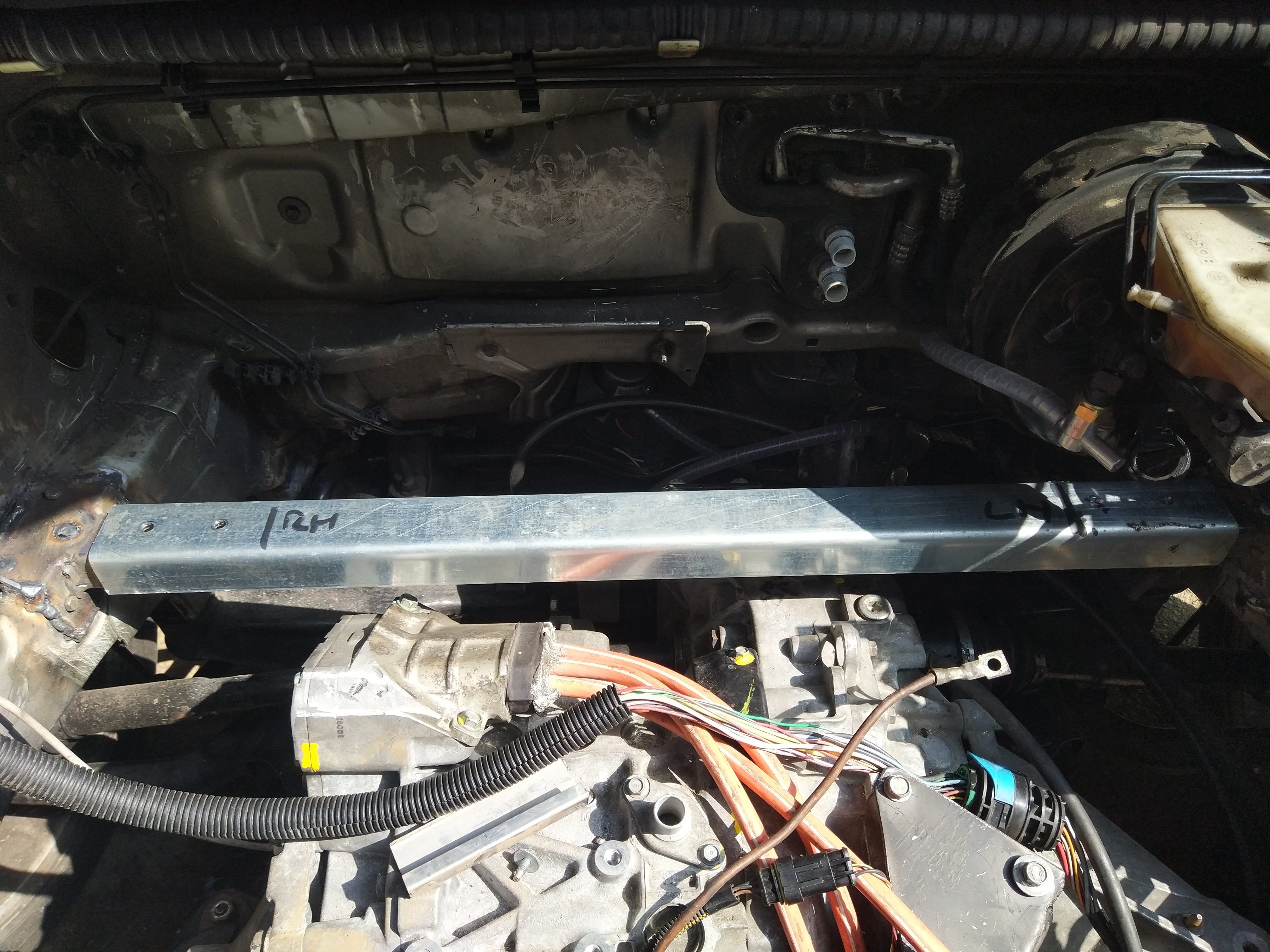

I finished the subframe mounts today. I painted it with epoxy paint and finished matte black.
The 3rd mount gave me some problems, but i solved it quickly.
https://leafdriveblog.wordpress.com/201 ... extension/

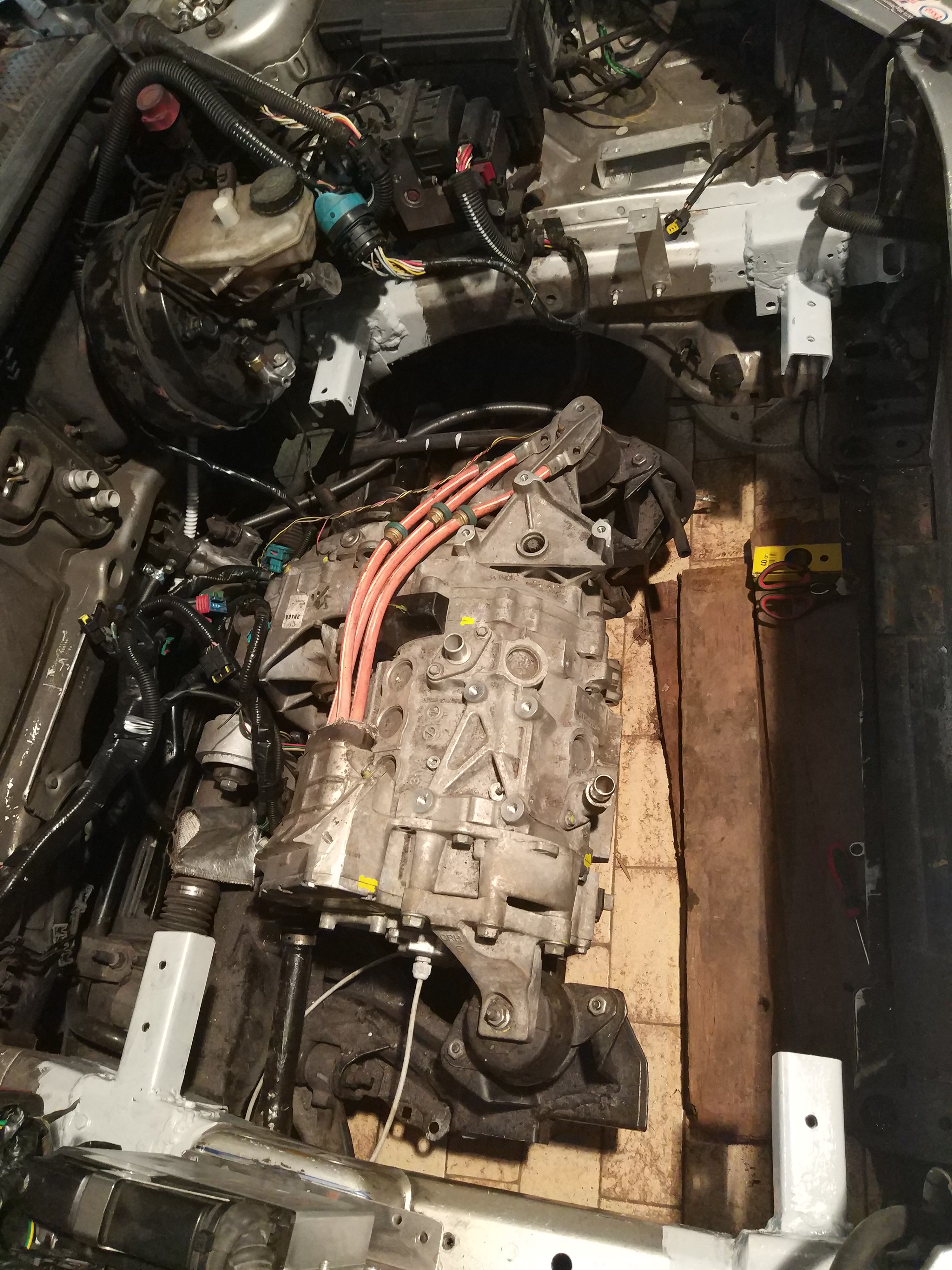

Subframe is in!
I have to say it looks great. There is so much space in front now that i am thinking if i am carefull, i wont need to cut the rear seats at all.
Only the trunk i will cut and weld a new box in. In front i will have to make some boxes to suspend cells.
What i am troubled with are the driveshafts, Now there is no more 200kg motor upfront car is sitting with its nose up and both shafts stick out of gearbox at quite an angle. Also you can feel the resistance if you want to turn the wheels. Maybe it will be better when i load a bunch of batteries in the hood. What do you think does it look to you odd that downward shaft angle?

The front suspension is unloaded? I would put the car down and load it similar weight as would be expected with batteries etc before going further with installation of the subframe.
In fact, would be best to make these ride height measurements before pulling the engine and transmission out.
The ride height can be adjusted with shorter/longer springs. Ideally you'd want the driveshaft angles to be close to original as possible. The driveshafts can tolerate some angle of course but straighter is better!
Posts: 3795
Been thanked: 411 times
Re: Peugeot 406 coupe Pininfarina with Leaf motor and Ampera inverter
Hah! Shafts or gearbox was not a problem.
When i was trying to move a car back and forth i felt some strange resistance from gearbox through shafts.
After much fussing about i realized all three phase cables were lying on gearbox alu housing! They were in contact. And of course when i tried to move the car forward that would short the windings and create resistance. When i took cables apart everything moved smooth.
I agree i will have to load the front with batteries. Now it looks like a speedboat...

Some progress update.
Rear and front boxes are in.
HPAS Pump is installed and hoses are connected.
Vacuum pump is fitted and hose is connected.
DCDC is now in and i choose 12V AGM 30Ah high drain battery to fit over the rear right wheel well.
Charger is installed under the central shaft.
I have to install inverter mount. I think i can fit it on the side. There is enough space to connect the phase cables and everything.
I need to install the control and CAN wires.
I have to decide how to connect the HV wiring.
I need to put a separate fuse/contactor box in front of the engine fuse box.
RPM indicator is till not responding. Also A/C clutch pin remains dead.
I managed to reduce DTIs down to a throttle position error and transmission computer error. BSM cand throw crankshaft error from time to time, but that is it. It seems ABS and airbags are working.

I measured space under the hood and made a model of front box cross section to give me a feel how high the box will sit under the hood.
I found out i have like 4cm of space above the engine space, since the hood is curved upwards a bit. So i decided to designed a box in full height 28cm. That will allow me to install the Volt batteries standing. This will take less space up front.
But in the end i had to account for the front curves. I must be able to replace the light bulb and service the connectors there. So i decided to take an edge off from the right side of the box. Material will be 3mm aluminum.
While i got the box made i designed the fittings and frame to install the box.
The simplest method was to simply weld an inverted U channel into motor space. I decided against that since it would restrict access to component dissassembly in case i should need to take something out.
What i decided on is the angle fittings welded on to car frame with a bit of console on both sides.
Console will accept U channel frame fastened by M8 bolts and that will carry the weight of the front battery.
On to the U channel and under the box i will adapt a straight brace to carry the weight and keep the box in correct (slightly canted forward) position.
The box will be fastened to the brace by M6 bolts with countersunk heads so the box will have a smooth surface inside.
Also i decided to bolt inverter to the battery box side. This will give me more space for cable routing.
The front fittings will carry another U channel, but box will lie on it directly. I welded that with my new MIG inverter welder with flux wire. I consider the process rather easy. The device is easy to setup. 0.8mm wire is elegant and good for most sheet metal. The only real problem is flux emits a lot of smoke that shields the arc. This remains on the weld as ash that has to be cleaned off after. Otherwise the welds are strong and good looking.
To fit the box onto carrying members i used countersunk 6mm bolts. They are now hidden and surface of the box is almost smooth. Good enough to place the batteries inside on a 3mm rubber matt.
In the end i painted the parts.
