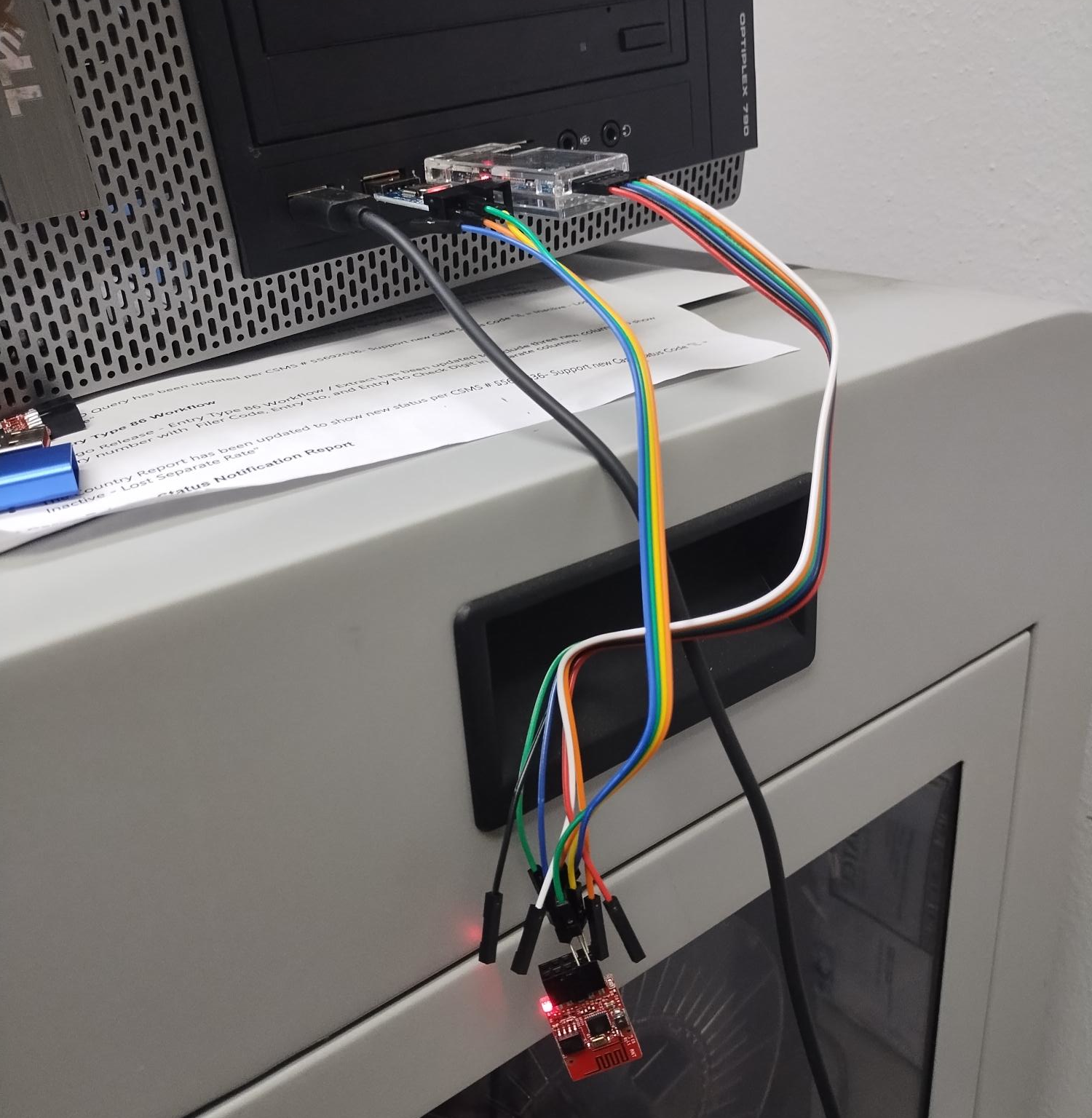

The next step was to get the computer to see the ESP8266 board.
First, I thought it would plug in to the ST-Link adapter... That doesn't work.
That's when I found my FTDI adapter, plugged the 3.3v pin on the FTDI into into pin 1 on the Olimex, and the FTDI ground pin into pin 2 on the Olimex. I plugged the FTDI into a usb port and it lit up.
Problem: I fired up Arduino IDE, went to Tools>Port and it was showing /dev/ttyS0, which was not correct.
If I only plugged in the FTDI adapter without the Olimex plugged into that, Arduino IDE showed port /dev/ttyUSB0 available.
When I plugged the Olimex in, it went away.
After some research, I saw some people said their ESP8266 pulled more power than their FTDI adapter could supply.
I ended up using the ST-link adapter that came with the STM32 Blue Pill and connecting the 3.3v power and ground from that to the Olimex.
So with the TX and RX from the ESP8266 plugged into the FTDI, and Arduino IDE showing the /dev/ttyUSB0 port, I plugged in the ST-link to another usb port and the ESP8266 turned on and Arduino IDE was still able to see /dev/ttyUSB0.
After a while, I figured out I could go to the Arduino/libraries/ folder that I copied over and click on the .ino file and it would launch Arduino IDE with the correct sketch.
When I hit the right arrow to flash the ESP8266, it wouldn't connect.
After some trial and error, I got it to connect by unplugging power from the ESP8266, holding down the tiny little button on the ESP8266, then plugging it back in and while continuing to hold down the button, I then hit the right arrow in Arduino IDE to start the flash. It finally connected after compiling the sketch, then I could let go of the button.
