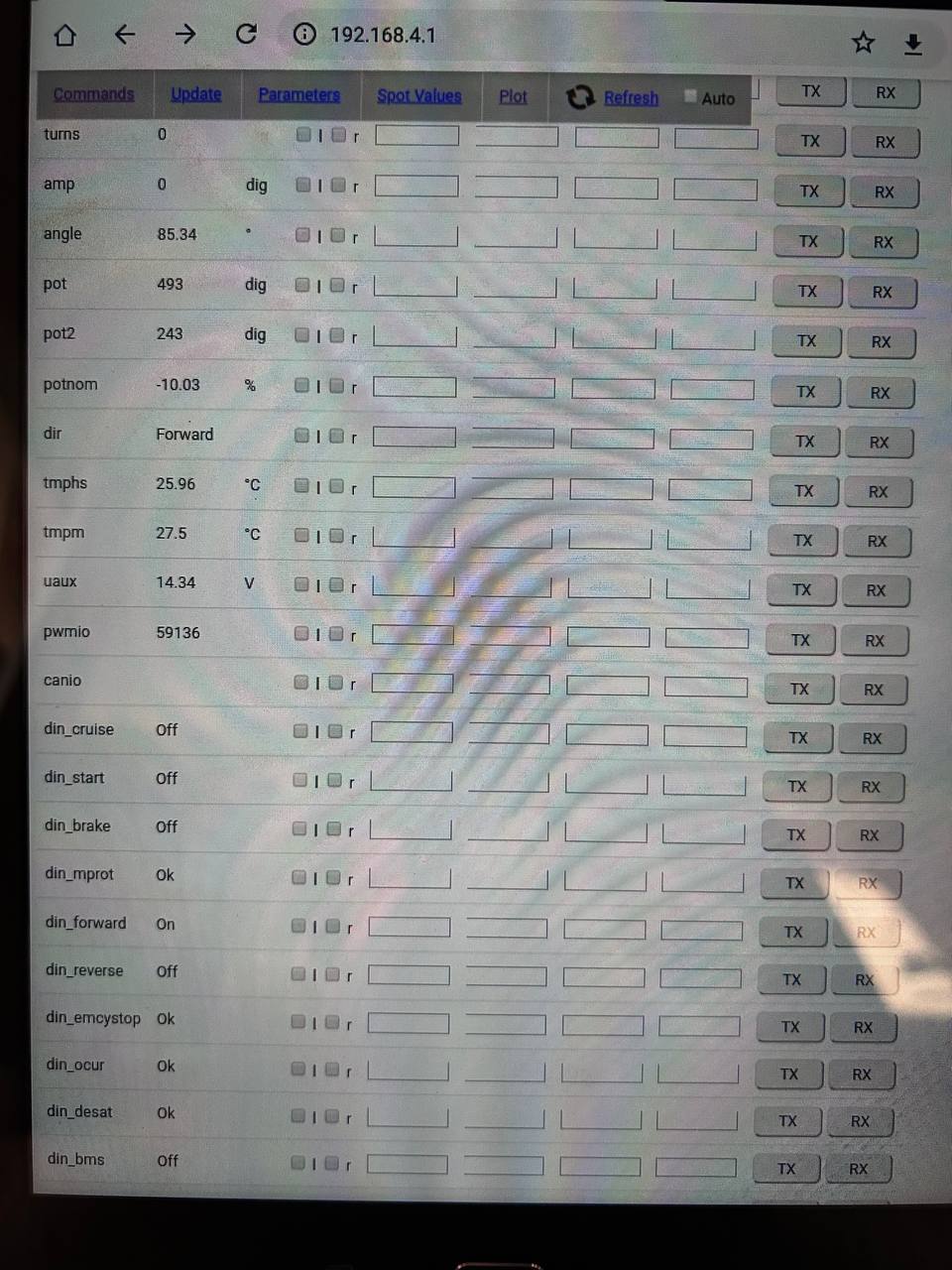

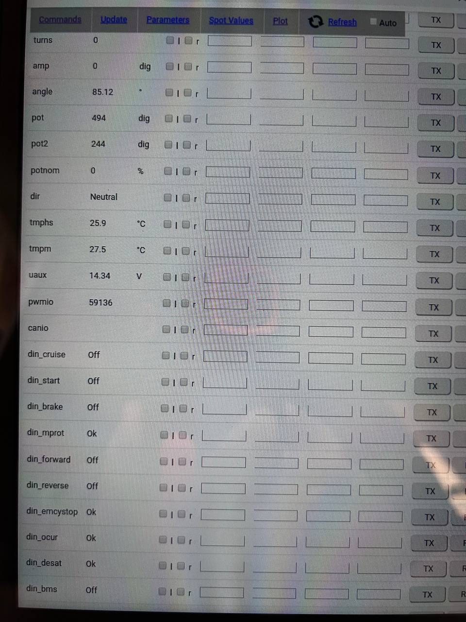

(C): The dir follows your direction switch. This means, the switch is correctly configured, but the software does not consider dir for the motor actuation.
(D) The dir always shows the same direction. This means, your direction switch is not correctly evaluated.
Which case do you see?
trataritatatata
Posts: 11
Joined: Wed Apr 17, 2024 7:04 am
Re: The motor turns in the opposite direction
Post by trataritatatata »
uhi22 wrote: Tue May 28, 2024 10:34 am In the description of the parameters and spot values https://openinverter.org/wiki/Parameters
we find "dir", with the explanation Rotation direction. -1=REV, 0=Neutral, 1=FWD
This could help, to split the search range into two two smaller search ranges. There are two possibilies:
C
When you switch the 3-position toggle switch, the parameters change.
