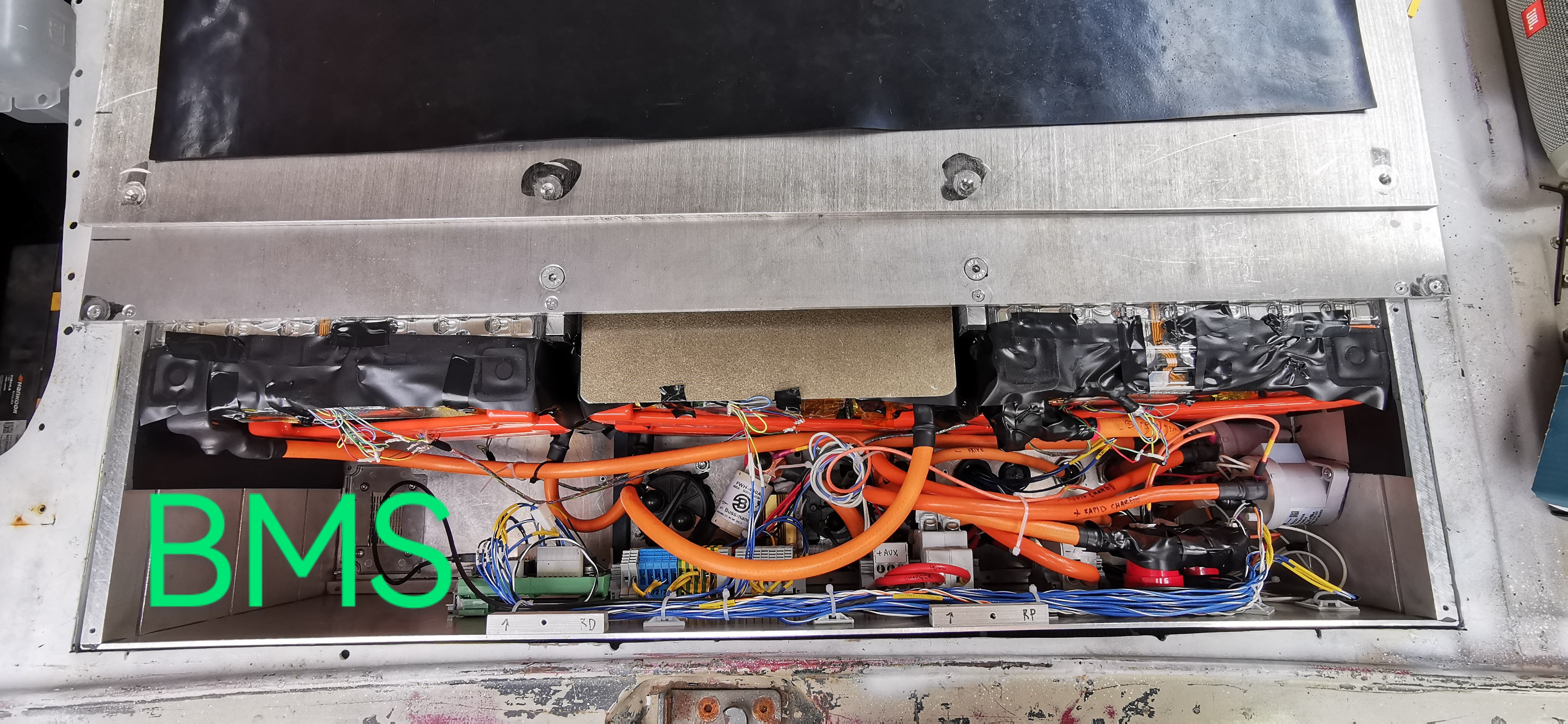

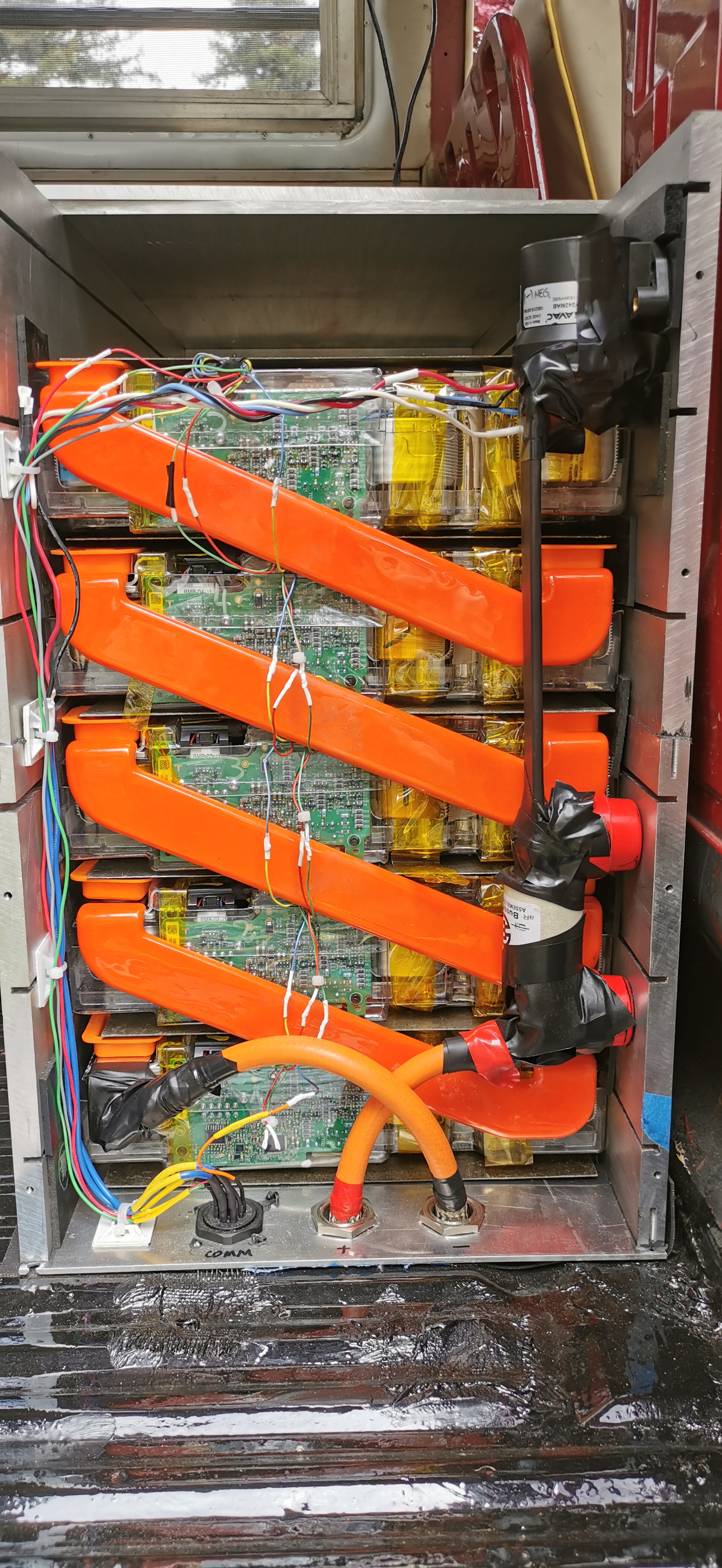

So clearly EMI from the HV. Your wiring twisted as per OEM tesla? are the runs as short as possible? Are the runs not parallel with HV cables/busbars?

tom91 wrote: Fri May 24, 2024 9:08 am So clearly EMI from the HV. Your wiring twisted as per OEM tesla? are the runs as short as possible? Are the runs not parallel with HV cables/busbars?

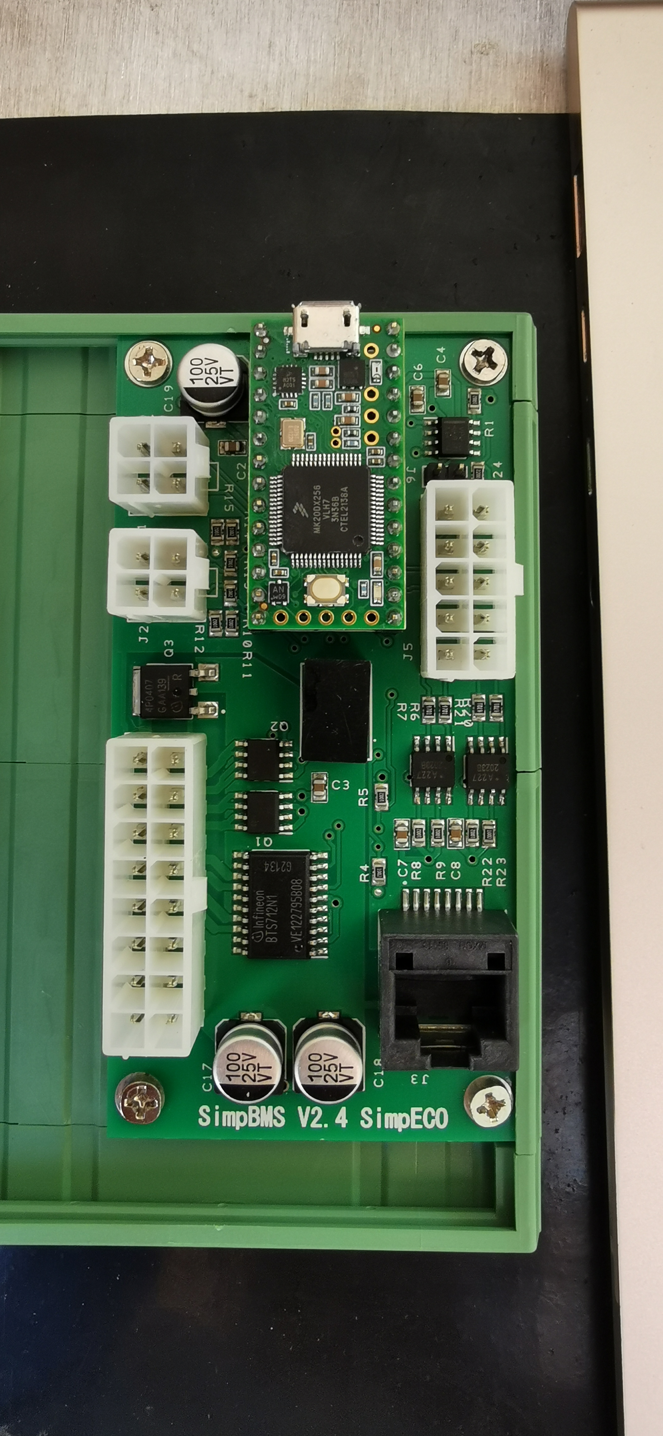

Hmm. Sometimes BMS turns on with the following in the log (HV disconnected) and stays like that unless I restart via R command - doesn't work with the power cycle.
14:40:38.103 -> Starting up!
14:40:38.103 -> SimpBMS V2 Tesla
14:40:38.103 ->
14:40:38.103 -> Reason for last Reset:
14:40:38.103 -> Power-on Reset
14:40:38.103 -> Low-voltage Detect Reset
14:40:38.103 ->
14:40:38.103 -> Started serial interface to BMS.
14:40:39.884 -> Recovery SOC:
14:40:39.884 -> 100
14:40:40.065 ->
14:40:40.065 -> 0
14:40:40.065 -> BMS Status : 5 Error     0
14:40:40.065 -> Out:0000 Cont:0000 In:0000 Charge Current Limit : 0 A DisCharge Current Limit : 0 A
14:40:40.065 ->
14:40:40.065 ->
14:40:40.065 -> Modules: 0 Cells: 0 Strings: 1  Voltage: 0.000V   Avg Cell Voltage: nanV  Low Cell Voltage: 5.000V   High Cell Voltage: 0.000V Delta Voltage: -5000mV   Avg Temp: nanC
14:40:40.065 ->
14:40:40.065 -> CANbus   0.00mA  100% SOC 210000.00mAh
14:40:40.065 ->    !!! Series Cells Fault !!!
14:40:40.601 ->
14:40:40.601 ->
14:40:40.601 -> 0
14:40:40.601 -> BMS Status : 5 Error     0
14:40:40.601 -> Out:0000 Cont:0000 In:0000 Charge Current Limit : 0 A DisCharge Current Limit : 0 A
14:40:40.601 ->
14:40:40.601 ->
14:40:40.601 -> Modules: 0 Cells: 0 Strings: 1  Voltage: 0.000V   Avg Cell Voltage: nanV  Low Cell Voltage: 5.000V   High Cell Voltage: 0.000V Delta Voltage: -5000mV   Avg Temp: nanC
14:40:40.601 ->
14:40:40.601 -> CANbus   0.00mA  100% SOC 210000.00mAh
14:40:40.601 ->    !!! Series Cells Fault !!!

Here's my wiring setup. I know it ain't pretty, but HV and LV are mostly perpendicular or away from each other. HV connection between two boxes are shielded to the boxes, while LV is twisted pair cable.

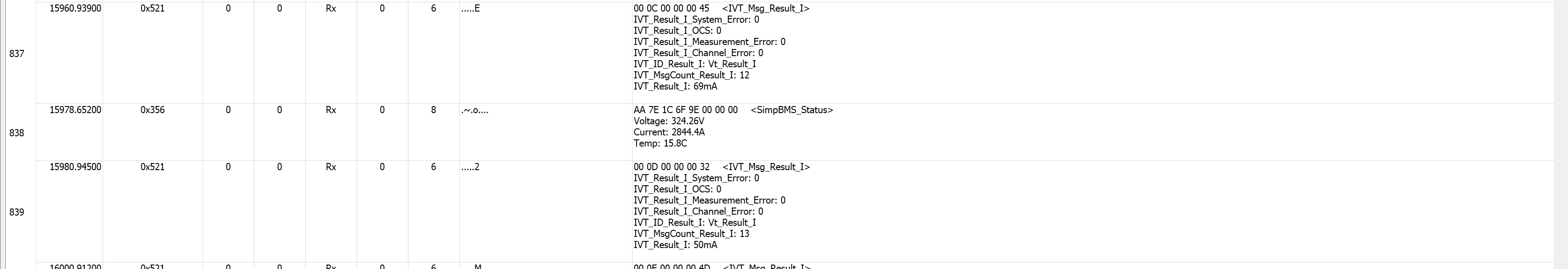

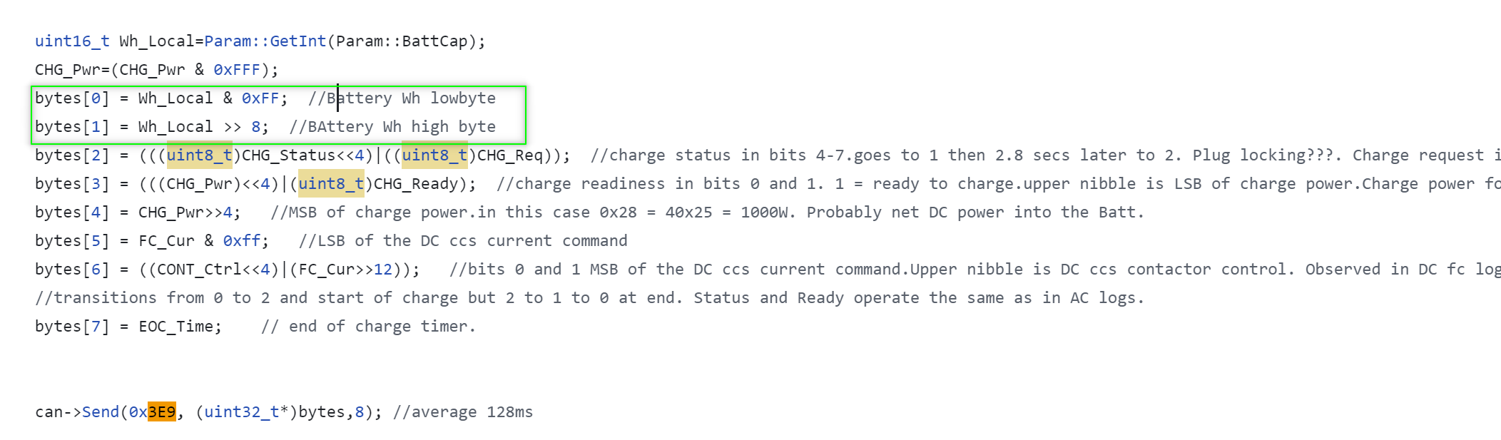

This is probably unrelated, but as I was troubleshooting I also noticed that BMS is showing some odd spikes of current here and there when reading from ISA shunt (also inside of the same battery box and is actually closer to the HV components). SavvyCAN doesn't see these and neither does my Teensy VCU. The spikes are visible on the CAN that BMS sends out via 0x356 as seen below, as well as, when I monitor via Serial interface. Everything else that BMS sends out - temp, SOC, Status, voltage etc. - is steady.
The only difference in my VCU code from the BMS is that I don't use LPF for filtering ISA values.
readingISAamps = (long)((incoming.buf[2] << 24) | (incoming.buf[3] << 16) | (incoming.buf[4] << 8) | (incoming.buf[5]));
Also my VCU is outside of the battery box. Maybe BMS needs to be moved out of the battery box!?
(no load, everything is idle, yet a spike..)
Edit:
Regarding the comm issues BMS<->batteries. I've noticed that the BMS looses the comms with the batteries not when I'm turning the motor, but randomly after, at no load - no EMI. That is, if I boot BMS and don't use the motor it works fine. Switch BMS to drive - works fine. But after running the motor and leaving everything idle for some time - BMS Error. I noticed that when this happens the LED on each battery board turns off also - normally blinking. That's why no comms! Now, if I pull out the J1 connector on the BMS that connects the batterers to the BMS, the LEDs on the batteries start blinking again. If I plug J1 connection back into the BMS - LEDs on Tesla boards turn brightly on for a sec and then back to blinking and BMS sees all of the modules again!
As if either the Tesla boards or BMS-Teensy UART go into sleep mode under whatever conditions.
The serial interface between the BMS and computer continues to work - can enter menu and change parameters.

I went back to the firmware revision with which my BMS arrived - grabbed .hex from the history of https://github.com/Tom-evnut/TeslaBMSV2
And all my comm problems disappeared! Both BMS to battery and ISA shunt current are steady! Anybody knows how can I get new firmware to work?
I tried the newest .hex and I tried to compile the newest project file - .ino, same result firmware gives comm issues.
I need to use the newest firmware since I've build my VCU and dashboard around the CAN messages that BMS sends in the newest rev.
This is my BMS board.

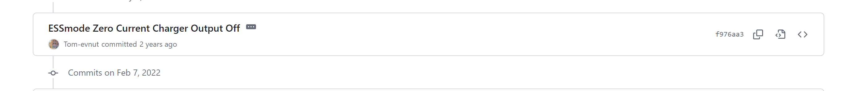

Doesn't make sense to me either. I looked through the commits too.
Here's a short video of BMS running on Feb2022 commit, ISA shunt CAN comms no value spikes:
Here's the latest commit, ISA shunt CAN comms has value spikes...
Later on the newest commit lost comms to the batteries and went into error, while the Feb2022 no error - waited way longer than that.

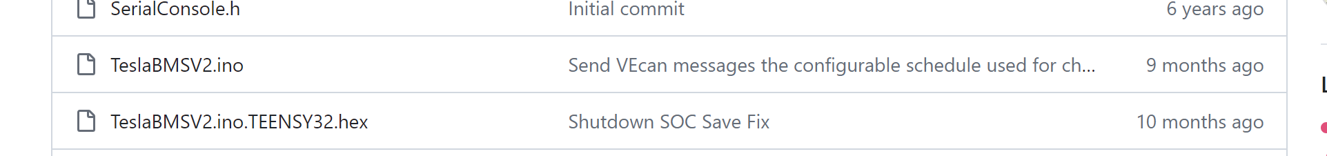

tom91 wrote: Mon May 27, 2024 10:22 am Please give me the exact firmware number you are using. I have not heard of this issue from anyone else so this sounds quite like a specific problem to you and your setup. You are using the provided .hex to flash the firmware right?
This hex gives me issues...
https://github.com/Tom-evnut/TeslaBMSV2 ... ENSY32.hex
Also compiled .ino, but same problem...
https://github.com/Tom-evnut/TeslaBMSV2 ... aBMSV2.ino
This hex works for me..

I factory reset the Teensy (or the closes thing - restored all default bms parameter, erased the flash) on the BMS and then compiled and uploaded the latest revision - so far no issues with comms with the batteries... <confused>

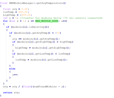

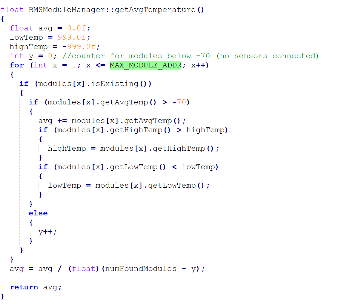

Regarding the ISA shunt spikes in current readings. Looks like there was a commit to accommodate for the Jaguar Ipace ISA shunt, which reads 0x3c3 ID for current reading. As it turned out my LIM module is transmitting some cyclical data on the same ID (can add if interested). I don't see it documented, nor used in the i3 LIM code for Zombie, nor defined in dbc. The firmware revision which was working for me, was from before this change. Removing the option from the code fixed the current readings for me. Just FYI for those working with the LIMs.
Small note. Looks like the getcurrent(); function only gets called when new data arrives. My ISA shunt is powered on ignition (to save 12vdc battery), while bms always stays powered. So when Ignition switches off and the ISA shunt stops sending data, bms retains the last value from the ISA and doesn't reset to 0 or NA. I suppose it's debatable whether the ISA should be powered on all the time or not.
What I'm trying to troubleshoot now is unstable battery temp readings on the CAN messages sent from the BMS. The readings are steady on the serial, but on the CAN bus they reset to 0 here and there - both on SavvyCAN and on my VCU. Don't see any clash of IDs like in the case of the aforementioned current readings. As a matter of fact temp low and temp high are part of the 0x373 message, while temp average is part of 0x356 message - issue affecting different messages. Both of these messages report other values (pack voltage, cell voltage, etc.) and those are stable! Trying to see whether it's due to the way temps are getting requested from the BMSModuleManager. Any advice is appreciated.
