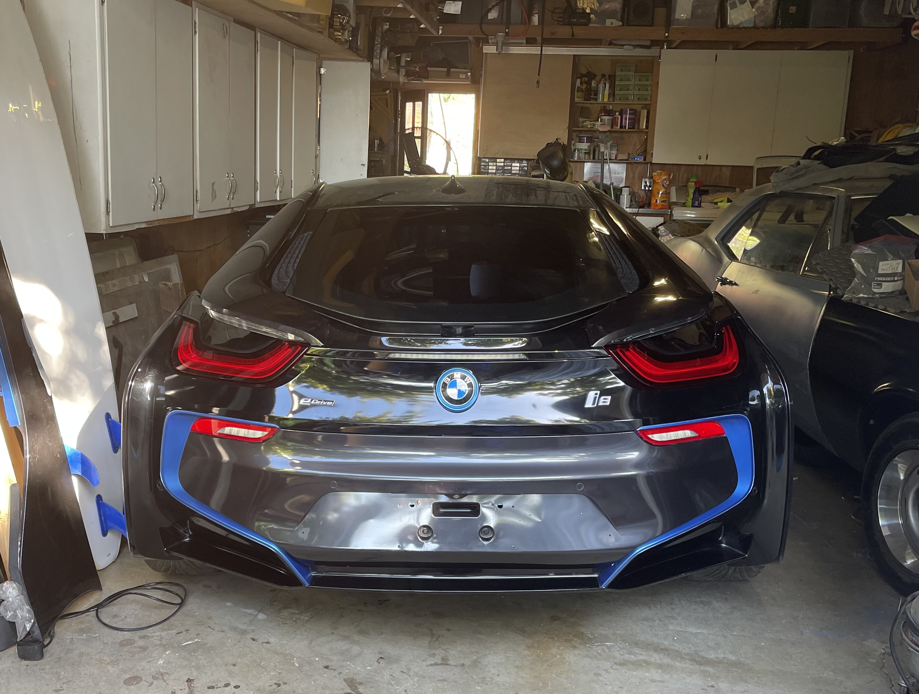

Hi, I have a 2016 I8 that I’m doing a front end collision repair on. The car is mostly put back together with both mechanical and structural parts but I can’t get it to charge. There is a message on the dash that says “unable to charge.” When I run diagnostics on ISTA there is no communication with the LIM module. I took apart the LIM and it looks fine to me. Wiring appears undamaged. My question is, should there be communication with the LIM module no matter what if it’s working properly or can some safety shutdown system (possibly from the collision) be blocking the power to the LIM? I replaced the pyro fuse on low voltage battery terminal and also shorted the secondary shut down connection in the terminal.

Ok, it was a fuse… The LIM seems to be communicating. Took me forever to find. The fuse block on the i8 is in a ridiculously awkward spot. Still won’t charge though. I’ll keep at it.

So basically, what I'm being told is that the reason my car wont start or charge, is after the car has been in a crash the battery contacts open to disconnect the high voltage battery for safety. I need the EOS test to check the integrity of the battery to make sure when its reactivated it wont blow up or short out. I have everything disconnected right now while I send out the SRS to delete the crash data, but I should be able to see what state the battery is in thought ISTA, once I have it back. Has anyone here been able to get the EOS 12 digit code outside of the hardware at BMW?

The latest is, I was told that the HV system isnt locked. The new EME has to be reset in order to be coded to the vehicle. Thats proving to be quite the challenge. I have someone working on it. Im paying him. He's reset (virginized) an EME before so well see...

The I8 will start and charge but not shift out of park. Common problem with the i3’s with used EME’s. Most fix it by swapping the main board but mine was damaged beyond repair. The EME was reset but still getting the EWS code 222CO2. “Electronic immobilizer expected response implausible.”

I make sure to close the door before I attempt to shift. The 222C02 error code is a EWS code. The EME and the DME have to have a matching code to allow the car to shift. This is a known issue with the I3. The control board in the EME has some sort of EWS immobilizer chip that lets you start the car but not shift. Most i3 owners that have an EME fail, swap out the EME control board to get their car to shift again. My control board was damaged so I didn't have that option.Bmw101 wrote: ↑Sun May 11, 2025 5:13 am If door is open, and car detect “tilt”, it automatically disengage any gear and forcefully be put in parking.

Anyway. The battery will have an SME. I would open the battery and check the contact status of the SME. Mine had airbag deployment but wasn't locked.
