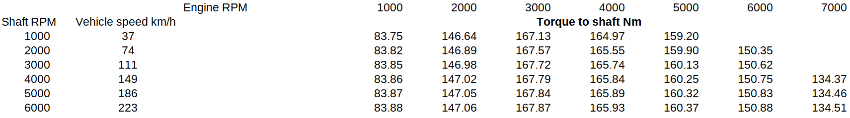

Re: Feasibility of conversion to PHEV with L110 transmission
I did some calculations to see how power splitting would behave with my engine and final drive
Table showing maximum power MG1 and Engine can deliver to wheels and percentage of that power relative to total engine power.
At higher speeds and low engine RPM are those percentages over 100% because MG1 acts as a motor. And output torque of combined MG1 and Engine It did surprise me a little but it makes sense to be optimized to transfer the majority of power when ICE RPM is at peak efficiency around 3000-4000 RPM
It behaves as a constant torque device and it is very nice. I did not realize that.
It also simplifies control algorithms as the stock inverter takes commands in torque.
Acceleration is then just setting constant torque to MG1 and the engine throttle shall also remain stationary.
When I look at the RPM limitations and consider MG1 will have a 10,000 RPM limit then ICE can rew 1000-3000 RPM from stationary to max speed, this is nice.
High ICE RPMs will be available only at really high vehicle speeds, as ICE at 6000RPM will cause 10,600RPM at MG1 even at 149 km/h, and for 5000RPM the speed has to be at least 105 km/h to be in the limit of MG1.
