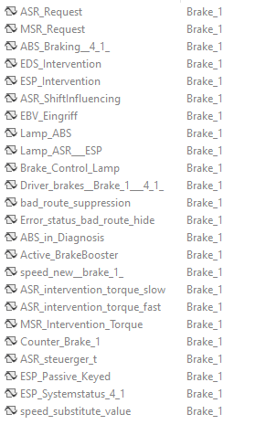

I do have ESP, but I'm sending the RPM, I think I might be missing the torque though. Thanks for the log, will have a look
I notice on your log for 0x288 Which I'm not replicating, I need to navigate the german in the DBC and experiment when we get ice again.

as far as i remember the ABS works without many additional canbus messages,(defiantly standalone on the mk3 golfs) the ESP sends out max torque request to the ECU which you don't have so just getting ignored. i cant remembered if it looks for a reply from the ECU.
so your abs should work, your ASR might and ESP probably not doing anything. would be a nice add on to the inverter to read the signal and reduce max torque at the wheels when needed.
