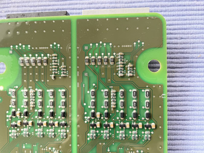

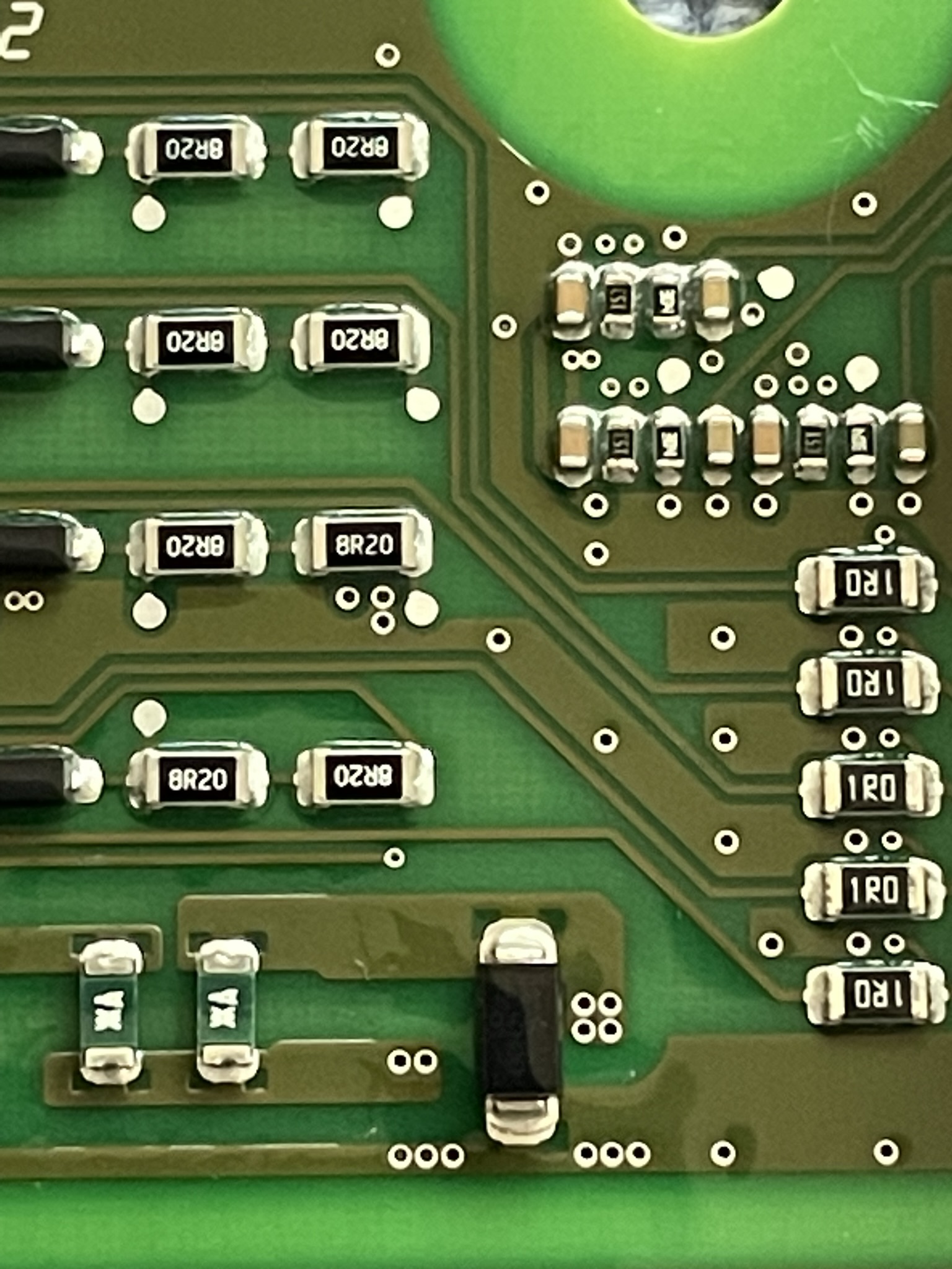

Thanks Arber333, this info on the fuses is very usefull.
I have reverse engineerd the cell balancing hardware. My finding are these:
The balancing is passive with resistors, starting from the negative, there is a 1 ohm resister inseries with 2 resistors of 8.2ohm a diode, a mosfet, then a 1 ohm resistor leading to the positive lead of the cell, so the total resistance is 1+8.2+8.2+diode+1= 18.4 ohm’ the max voltage for balancing is normaly 4.2V, this gives a current of (4.2-0.6)/18.2=197mA as a max balancing current.

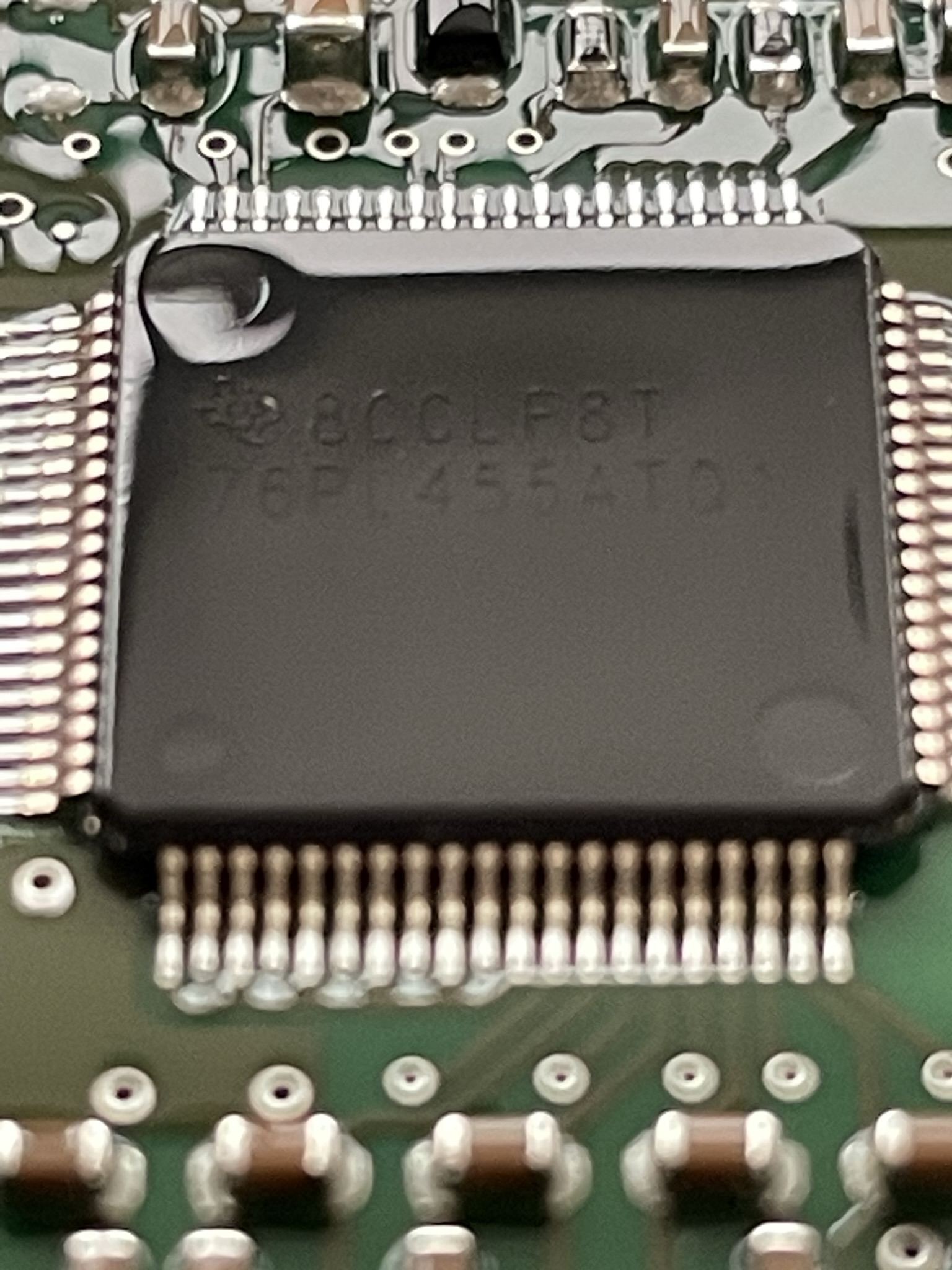

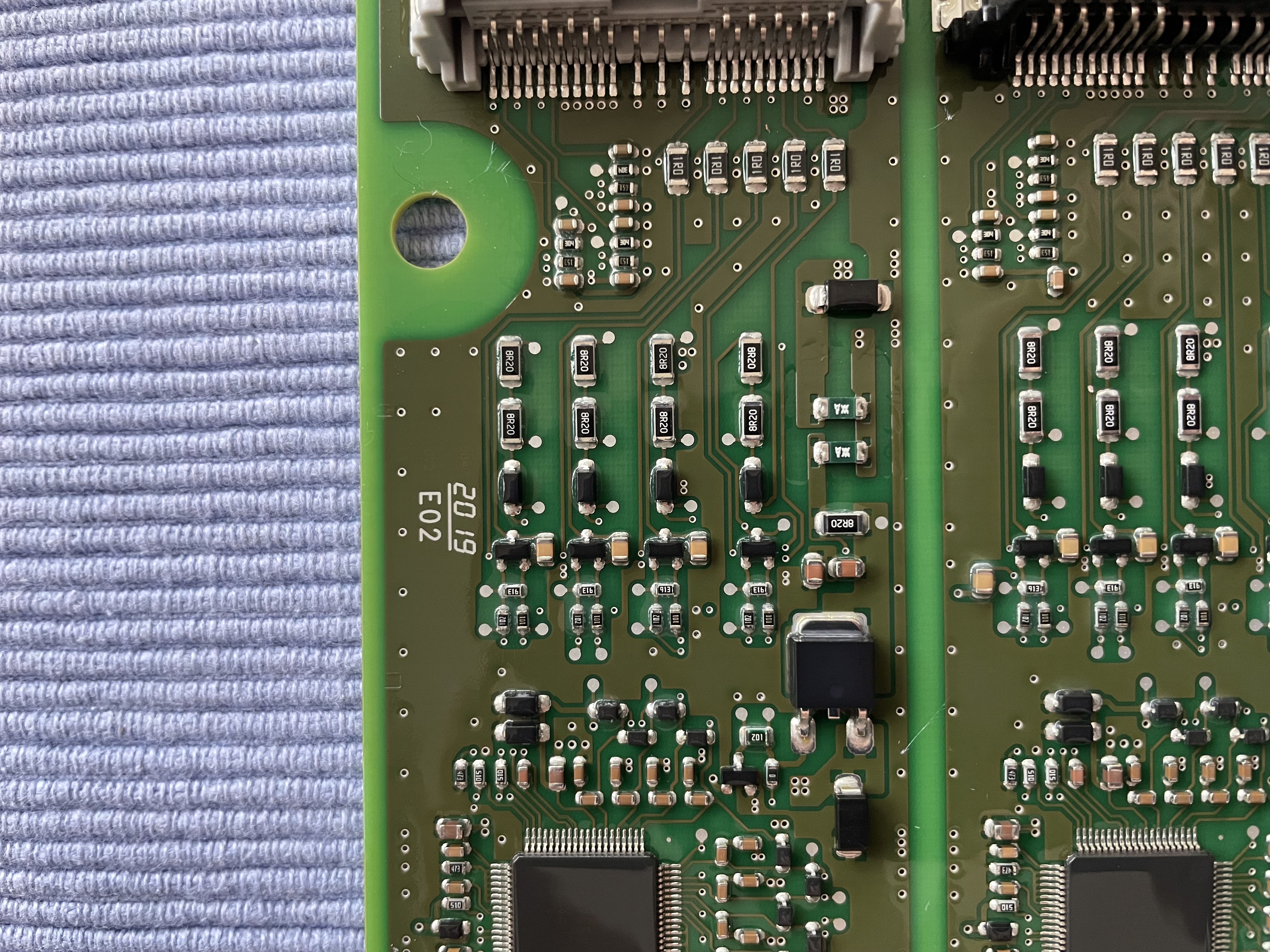

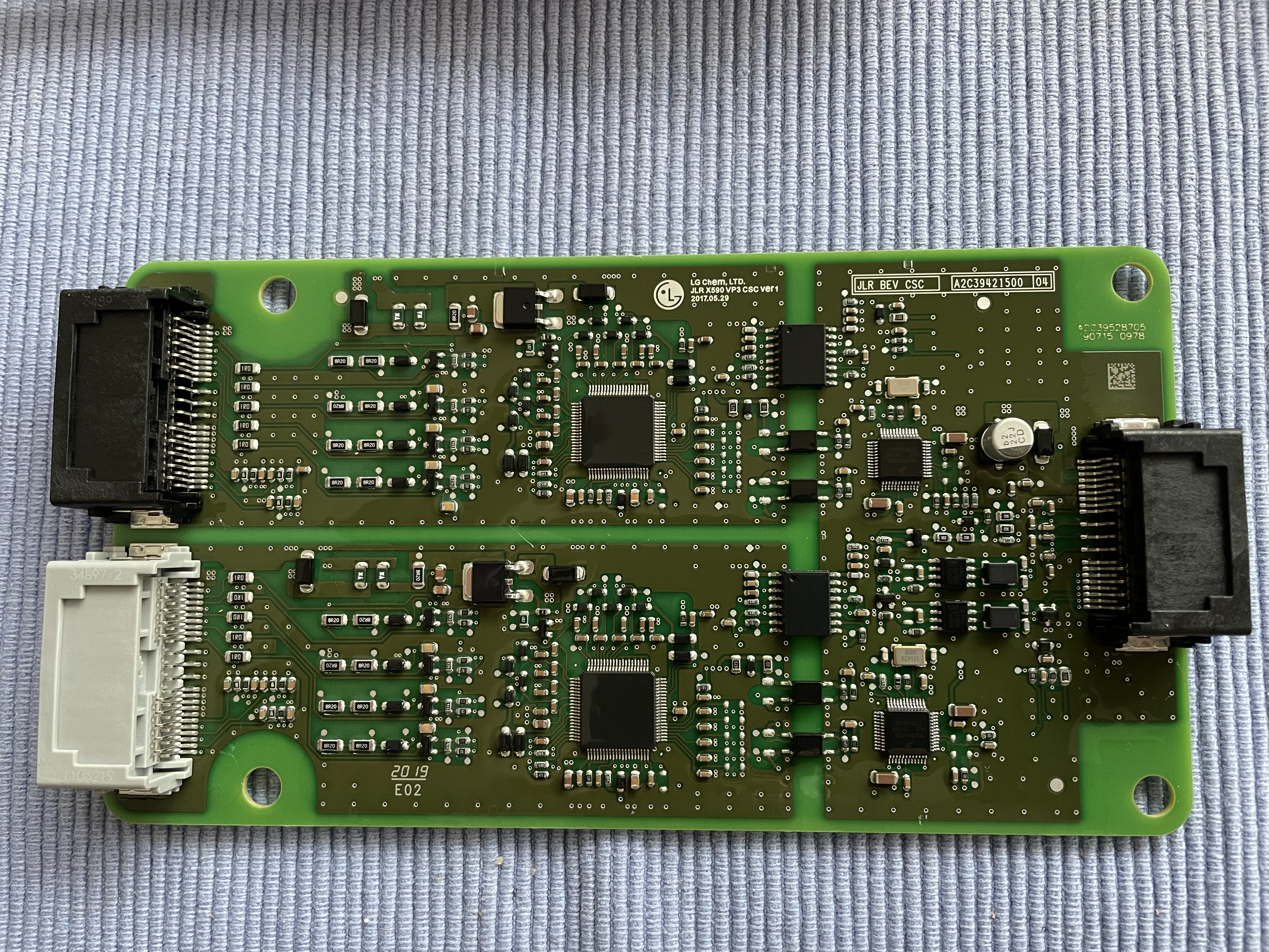

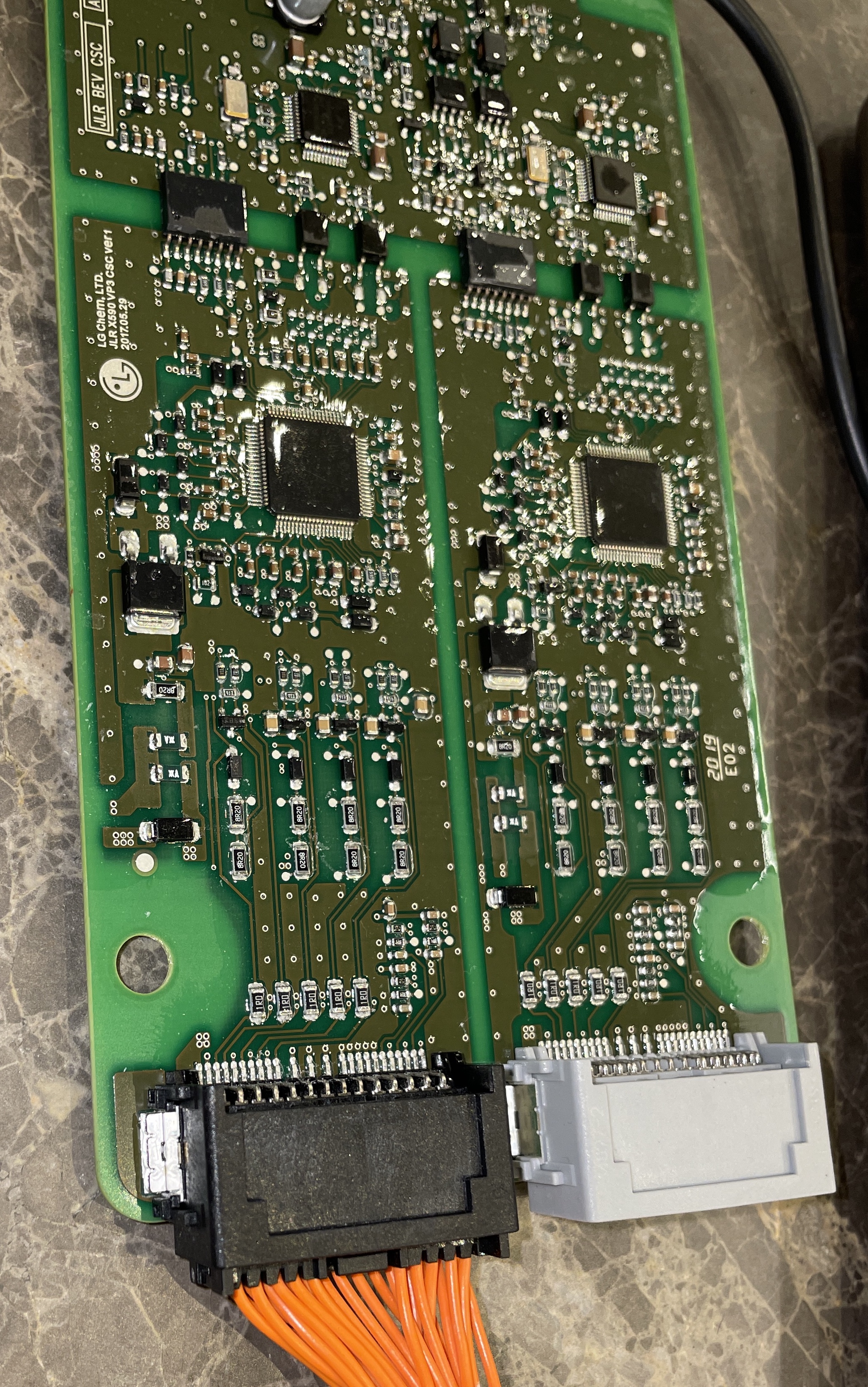

I'm in the same boat, having an i-pace battery (disassembled) for the ESS project. I want to reuse the BMS and start gathering information about it.
What I found so far:
* The configuration of the BMS is one master and six slave modules, and communication between them is CAN-based.
* Each slave module has two sections (seen in the pictures above). Each is based on TI 76PL455ATQ (cell monitoring) and NXP processor for communication. So there are 12 CAN nodes, each monitoring 9S cells (3 blocks x 3S)
* I have found schematics that give me some information for a starting point. I also identified most of the connector types used in the BMS.
* I have ordered some needed connectors for BMS hacking and will start experiments soon. I am still planning a strategy. It will probably be best to wire again the whole battery, but now I don't have enough space for that.

You need to wire it all up and get a CAN bus capture of the information being sent "to" and "from" each slave for further analysis and decoding.

Re: Jaguar battery porn XXX
I agree that the best option is to restore the original wiring of the battery and then start analyzing.
But now, I have started exploring one of the slave modules, and the results are good so far.
It sends CAN data without any request, and I think the data contains the cell voltages and temperatures.
I need to recheck it, and I will share the result in the new topic.

Share any raw logs you have.
The biggest challenge will be balancing requests and other things that will get directed from the Master controller.
