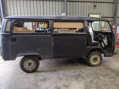

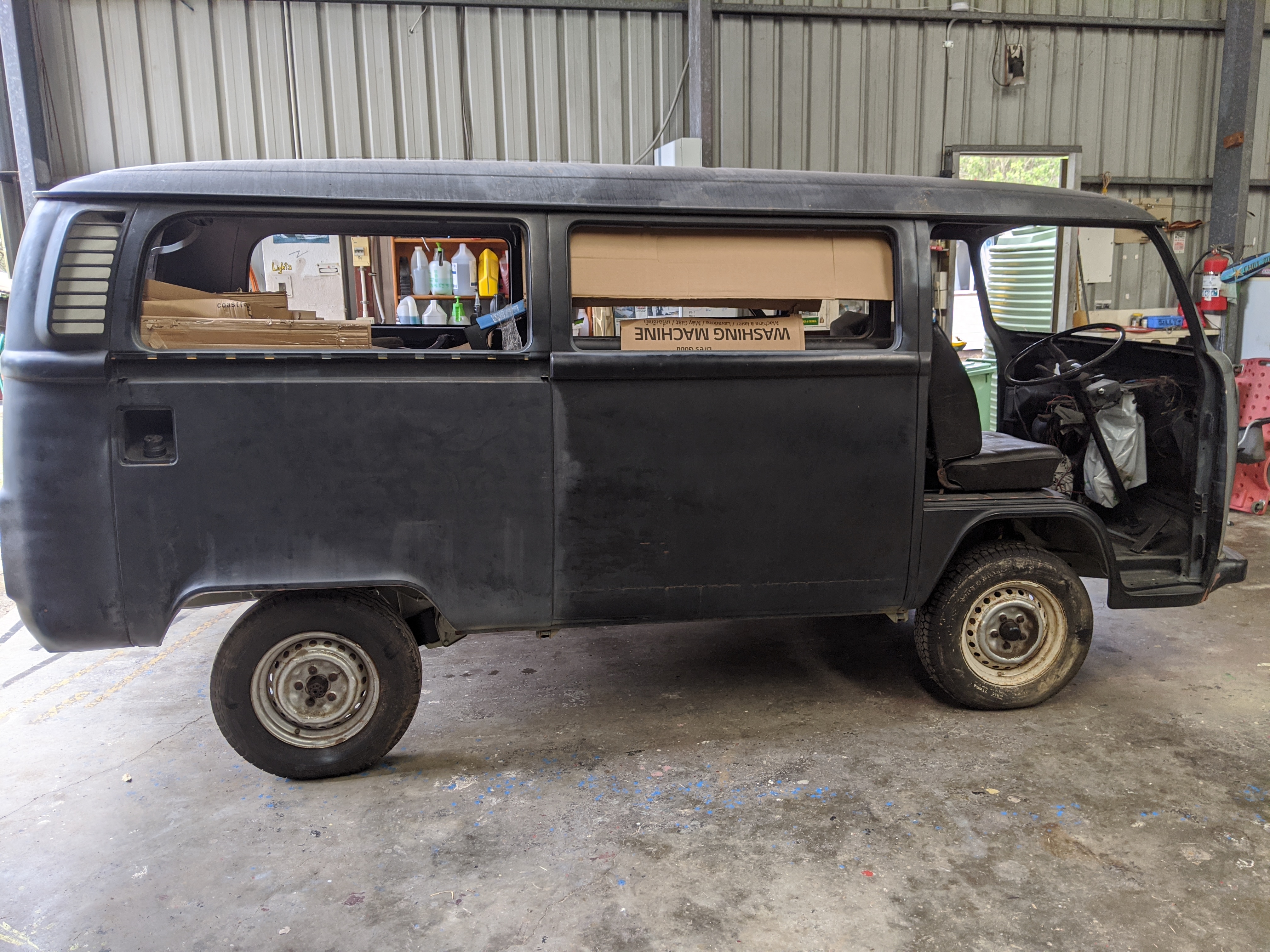

Hi all,
I currently drive a '65 Ford Mk1 Cortina with Hyper9 and 30kWh Tesla batteries, CHAdeMO charging (via Orion BMS2), air conditioning etc.

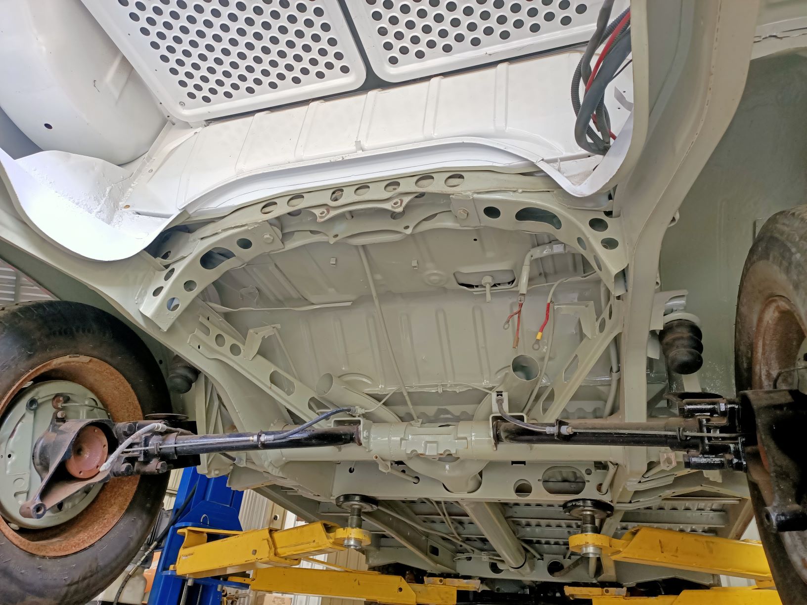

Underway is a '73 Kombi VW bus, full resto and Tesla swap.
I've stripped out a couple of Model X wrecks over the years, this time I want to make more use of the Tesla parts in the VW.
So we have mounted the SDU and are currently fitting 3 battery boxes for 14 Tesla modules. Again using Orion BMS2 as I need DC fast charging.
Still haven't decided on the controller for the SDU - Damien's board, ZeroEV or even the Polykup solution. Each very different I know, and am weighing all the options up.
I want to use the following Tesla parts that I have on hand but need to do some research:
- Gen 3 18.5kW charger from the Model X (will buy Damien's board - but will it work well with the Orion BMS2?)
- A/C compressor (needs to be hacked/controlled, someone has done it here in Australia, has anyone else?)
- DC-DC converter (I see there are some threads about it on here/DIY).
Thanks.

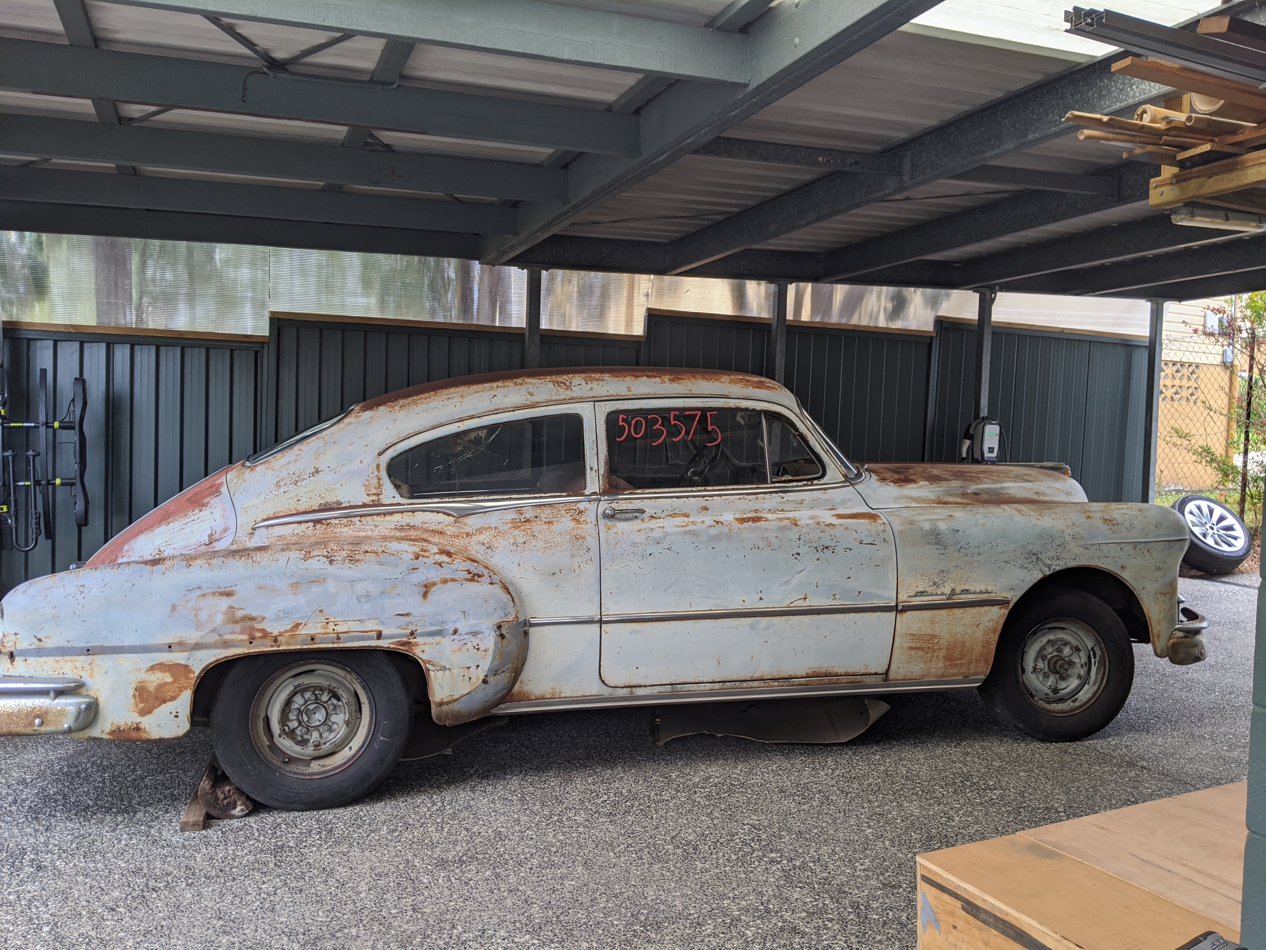

and waiting the wings for a conversion sometime down the track is my long term restoration project - '49 Pontiac fastback.

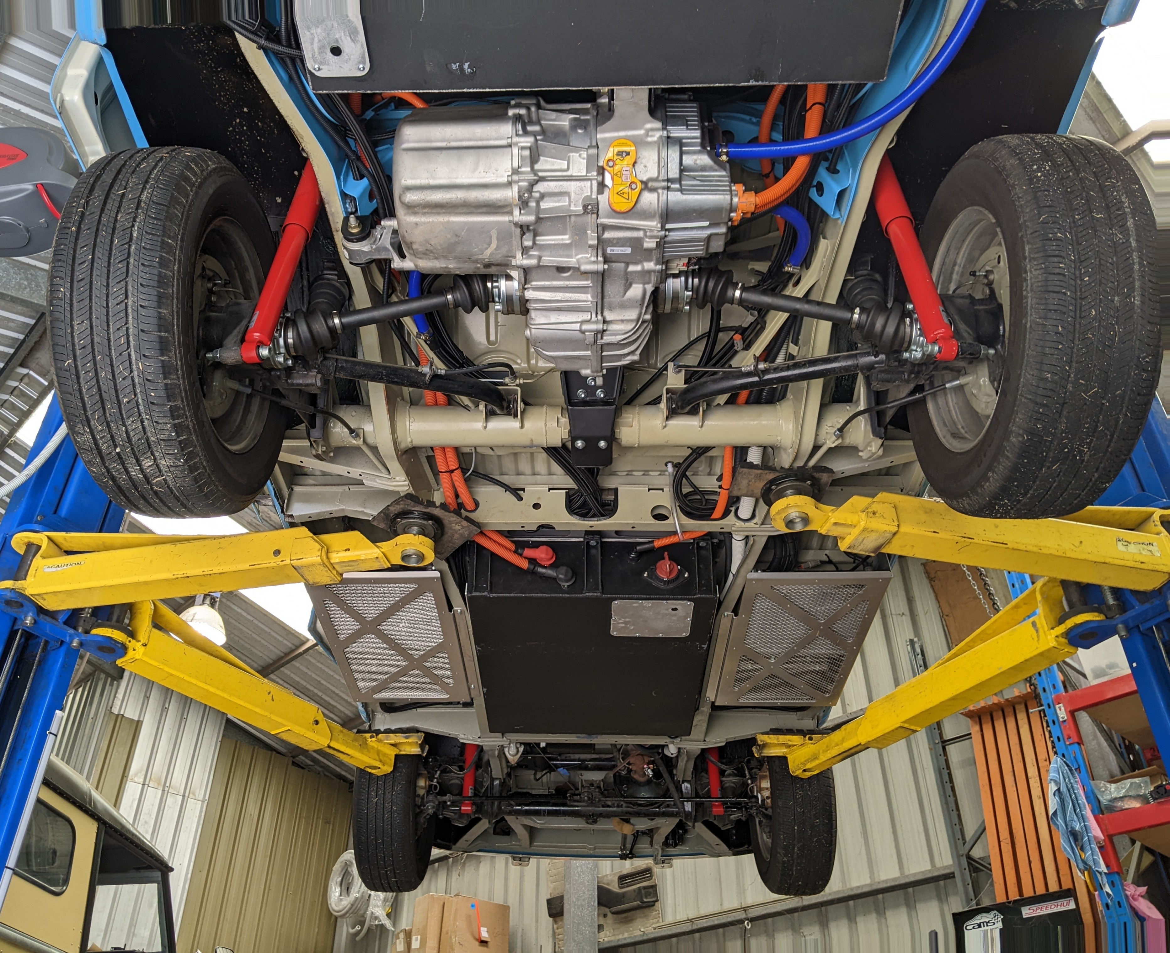

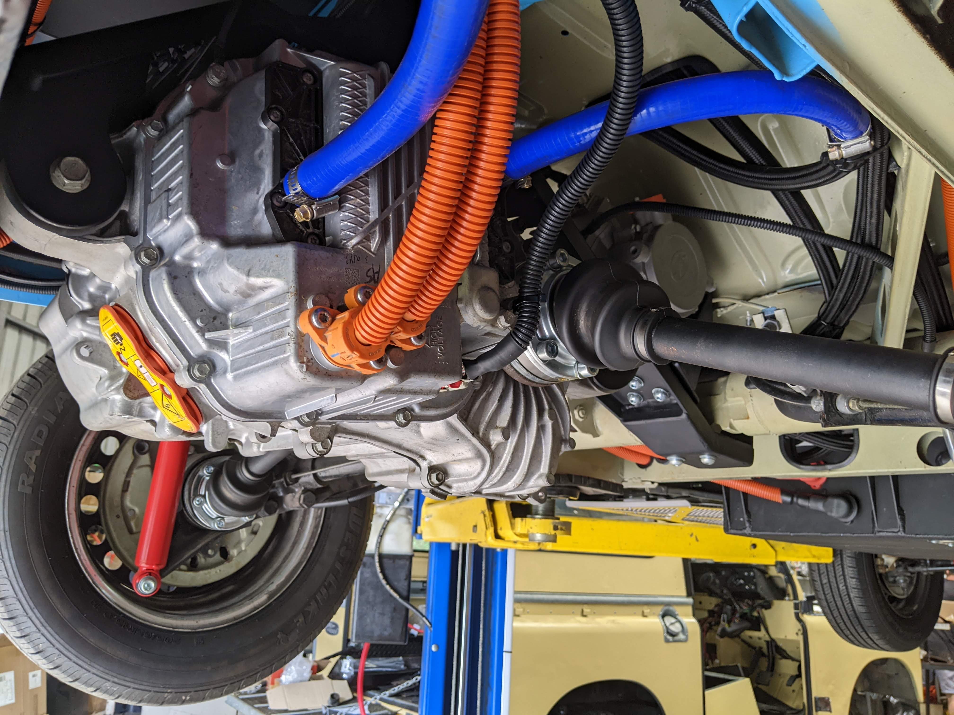

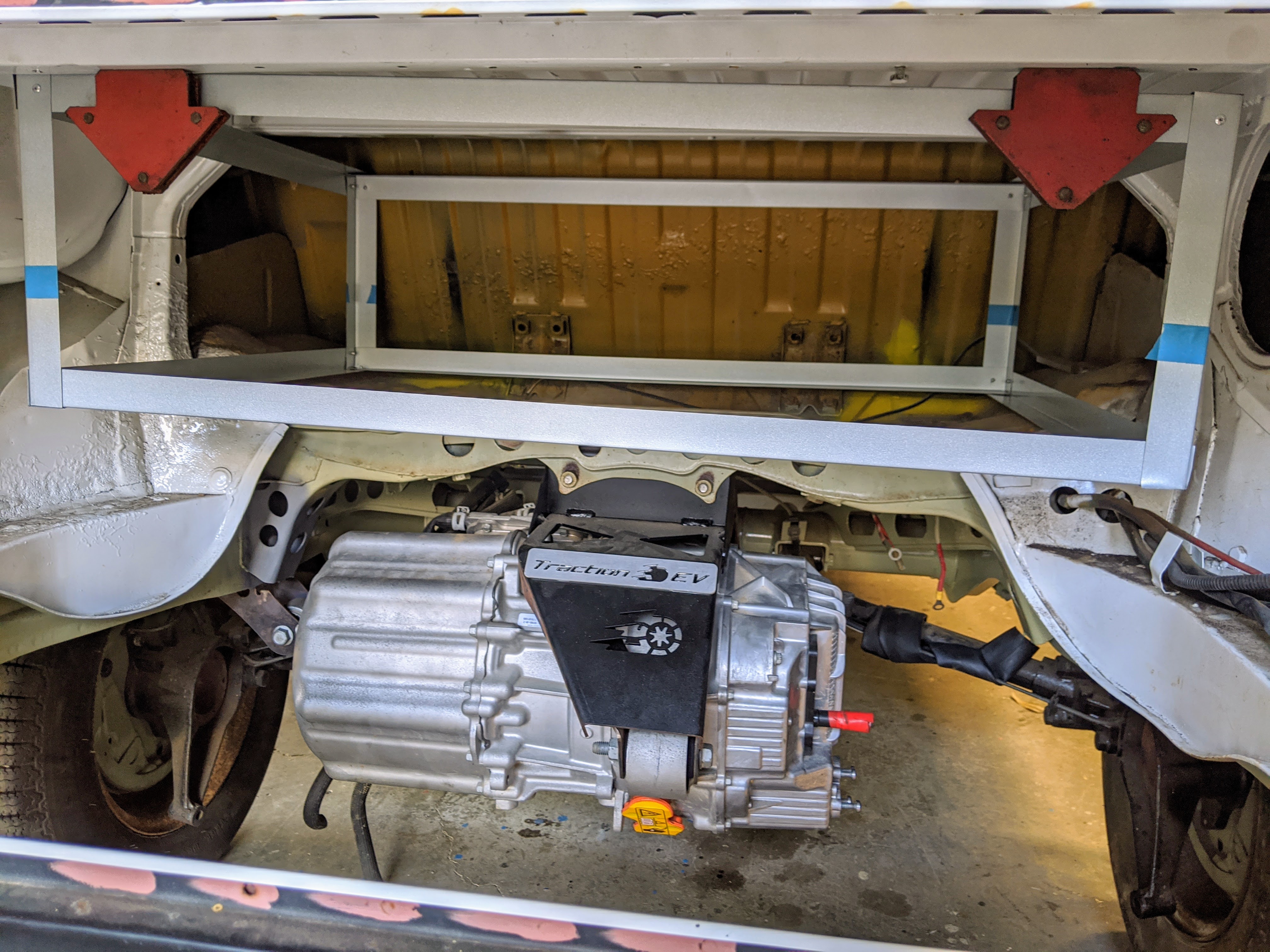

Very nice. Can you share some more details about the SDU mount? Is it your own design? Does it just hang on the transaxle mountings or is there something else as well?
- Posts: 33
- Joined: Thu Oct 08, 2020 3:32 pm
- Location: Brisbane, Australia
Re: '73 VW Tesla Bus and '49 Pontiac
It's a custom design by Traction EV, it hangs off the original mountings. It helps to leave as much room as possible for battery boxes.

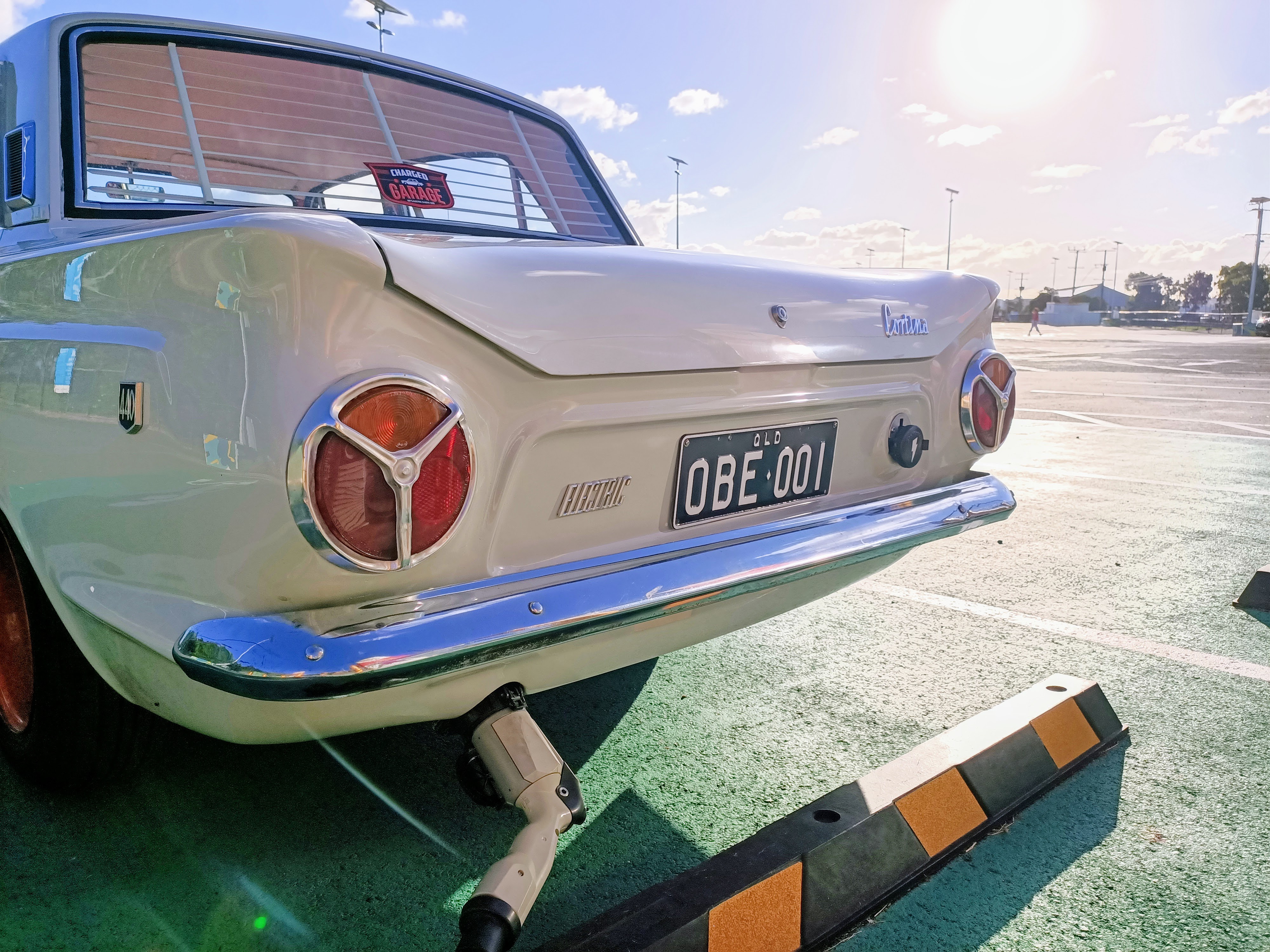

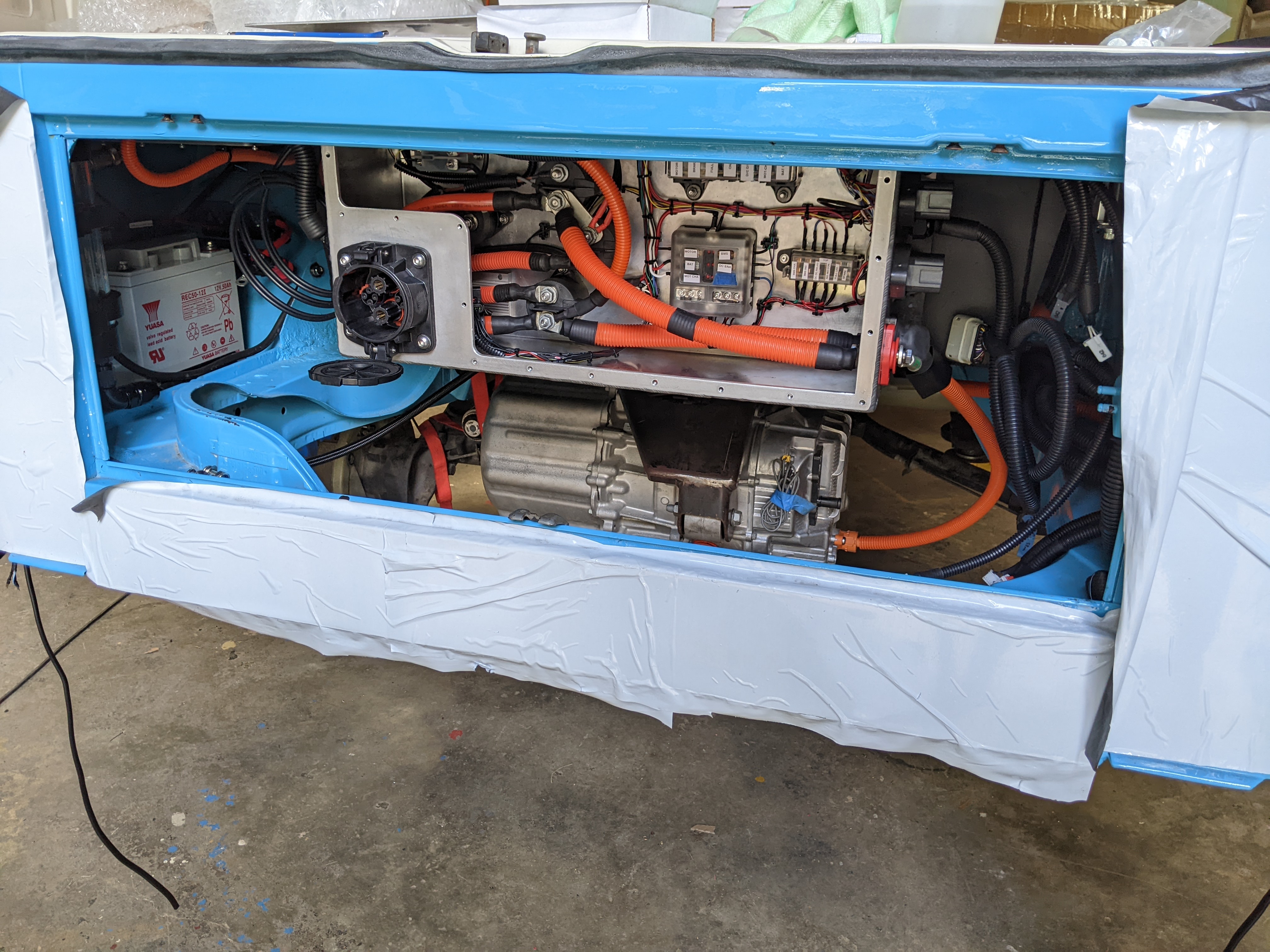

Yes, I can't remember if we were influenced by your Chademo exhaust or we just realised there was no other spot for it as the JB was right there in the fuel tank and the AC port was already using the old fuel filler position...

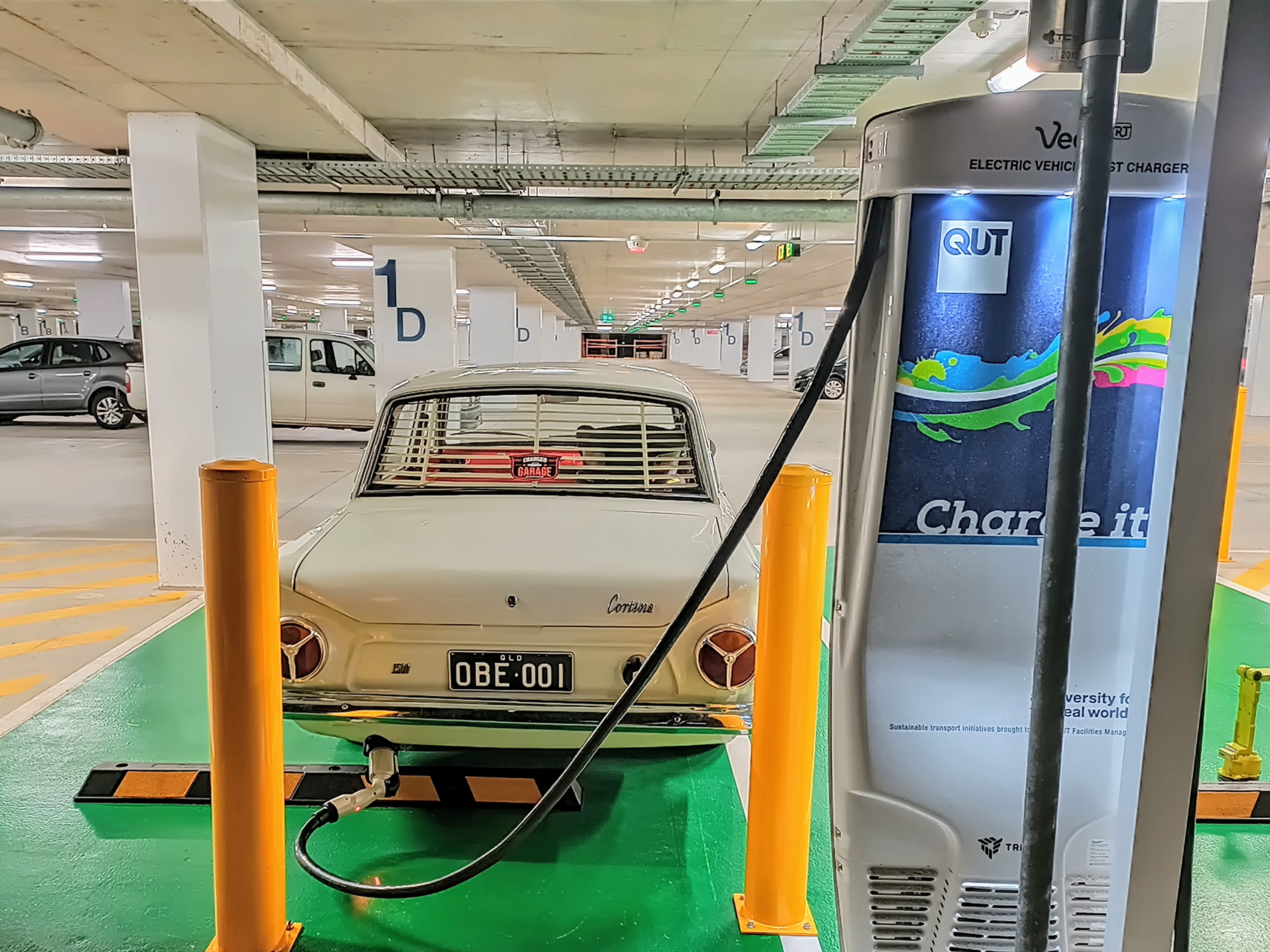

- celeron55
- Posts: 804
- Has thanked: 38 times
- Been thanked: 136 times
All I can think when I see those exhaust charge ports is how bad an idea it would be around here...
I mean, just imagine a charge port anywhere in this photo:
- Posts: 33
Luckily we don't see any of that white stuff anywhere near here in sub-tropical Queensland... Just that hard white stuff (hail) that damaged my Cortina body panels a couple of weeks ago!

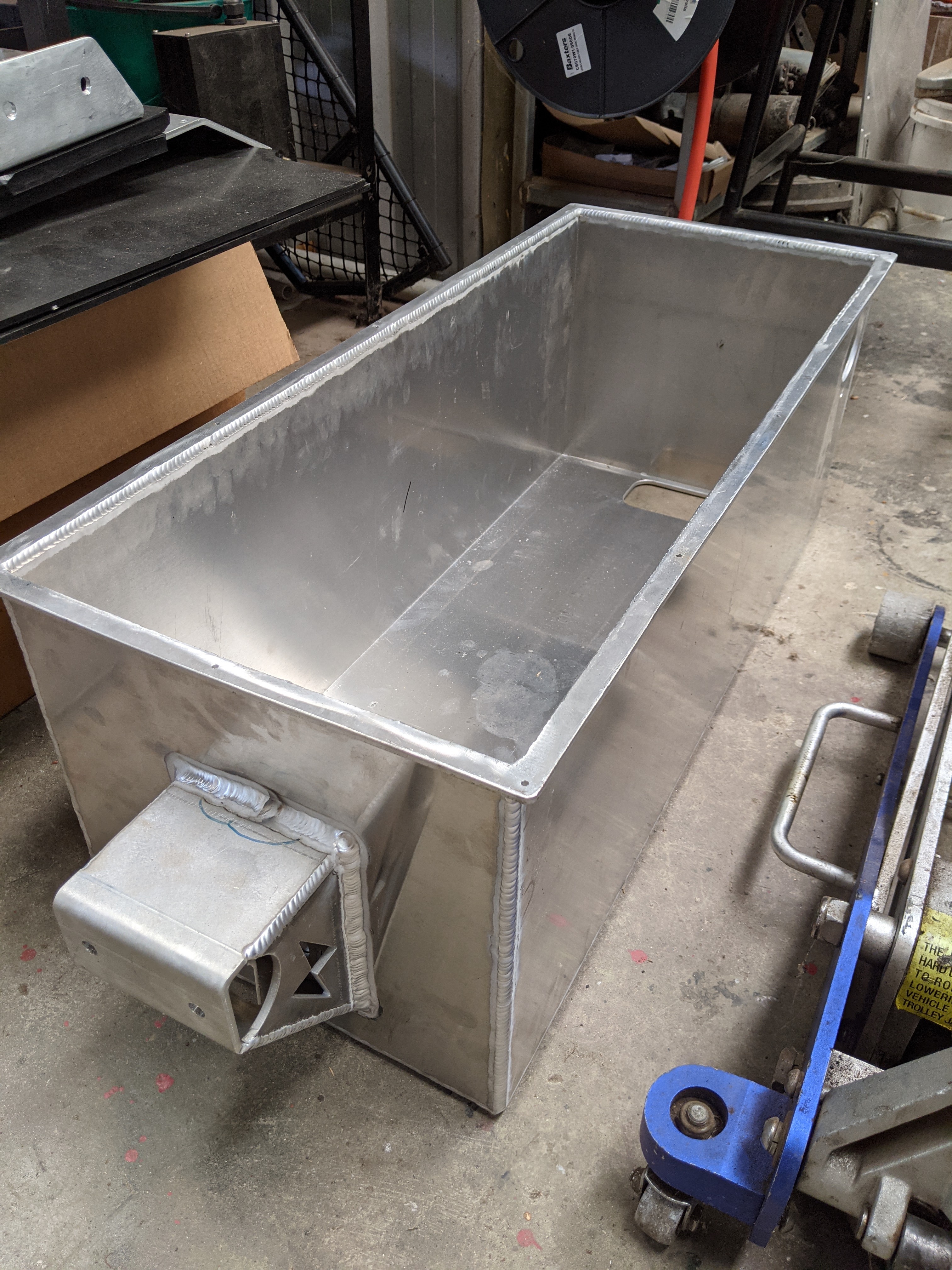

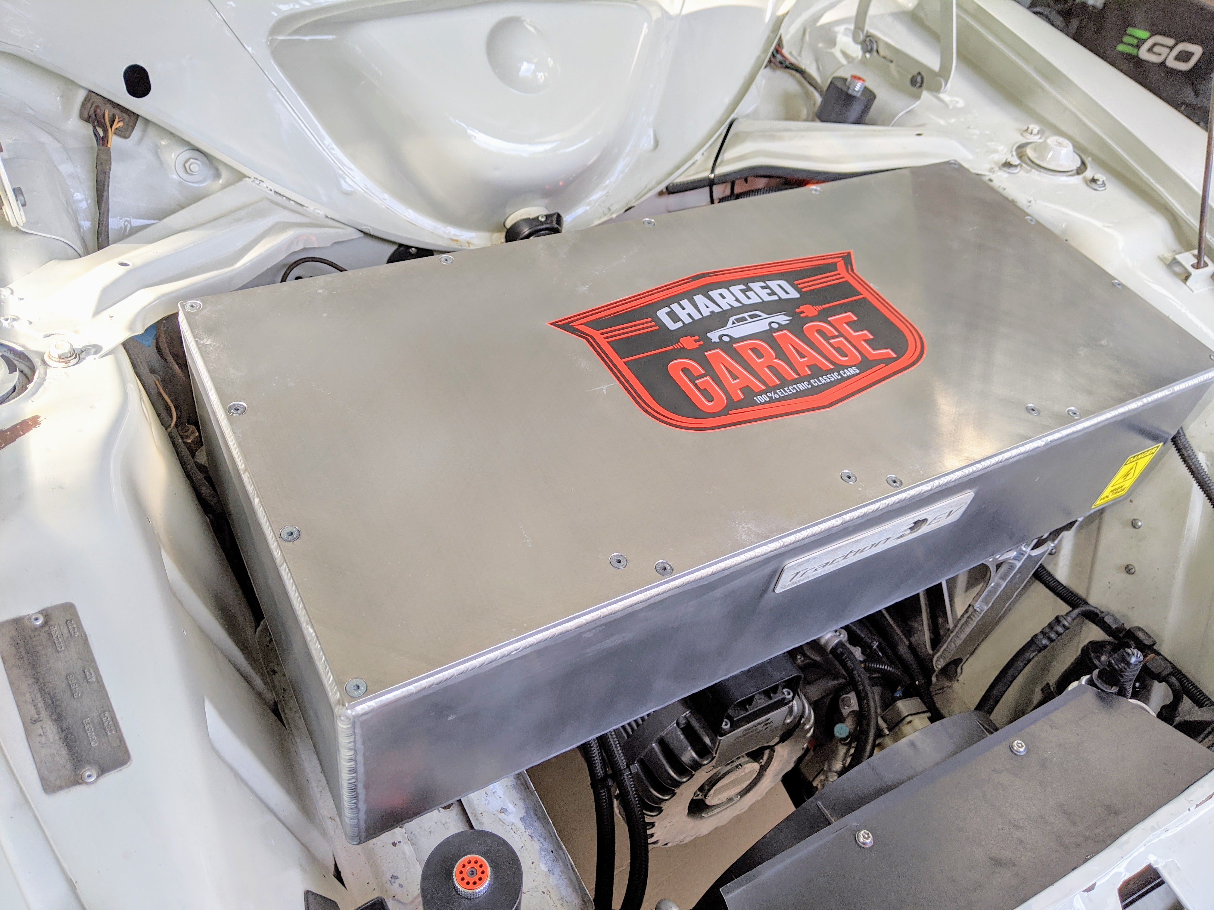

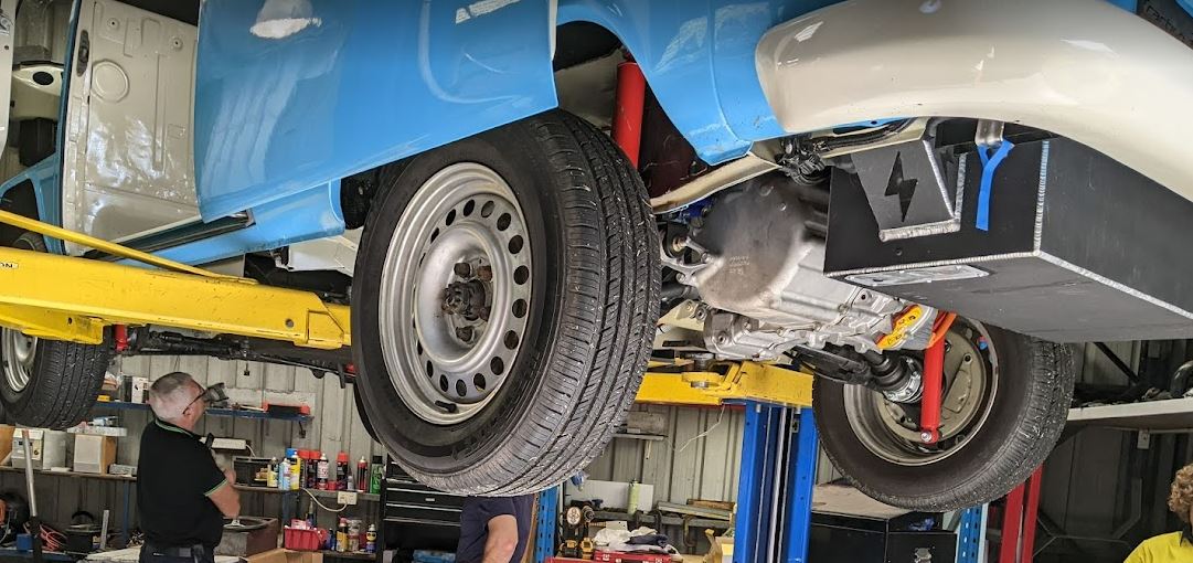

Yes, the 3 battery boxes have been designed and fabricated to accommodate the 14 tesla modules - one under the belly and two in the rear engine bay. No loss of internal space for batteries. they've been test-fitted but now removed to allow the bus to be restored.alexbeatle wrote: ↑Wed Jan 27, 2021 7:53 am Looks great looking forward to following this.
Have you any plans already for the battery box(s)?
The bus is now waiting for paint and glass etc before the conversion work continues.

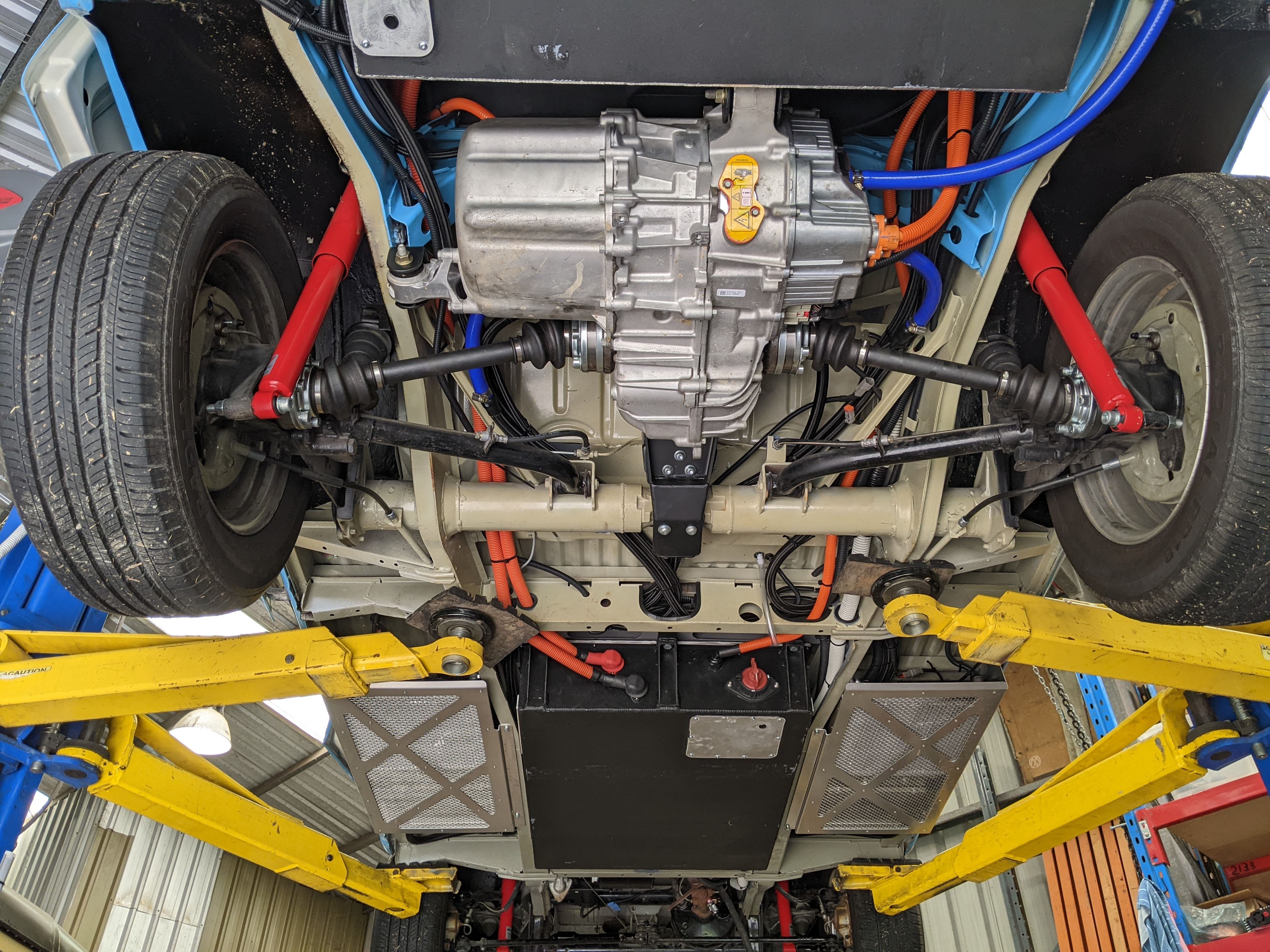

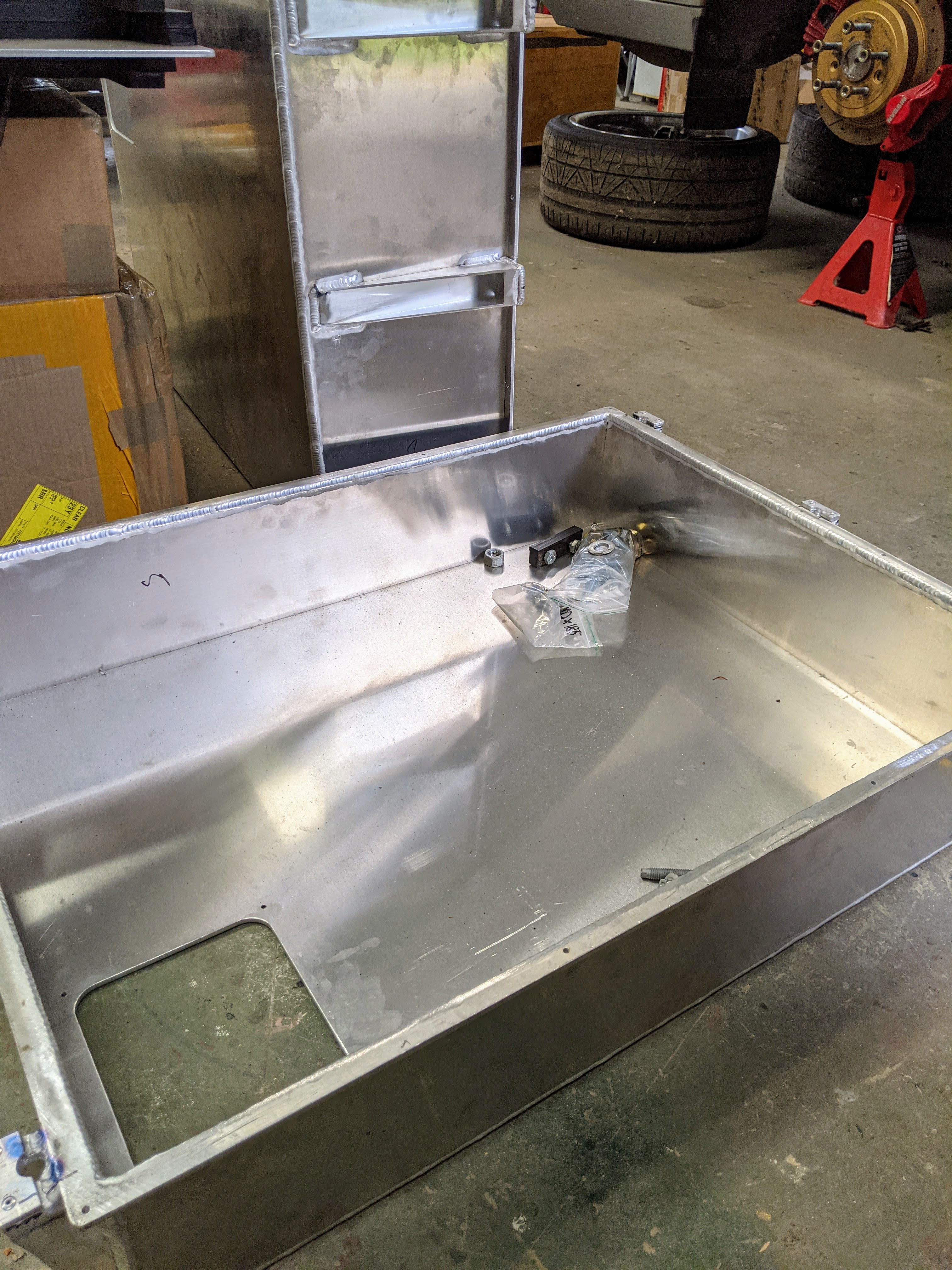

Mind sharing the pictures of the boxes? Looking for inspirations for my own conversion.
- Posts: 33
Here you go. Might be a bit hard to picture out of the bus.alexbeatle wrote: ↑Thu Jan 28, 2021 12:43 am Mind sharing the pictures of the boxes? Looking for inspirations for my own conversion.![]()

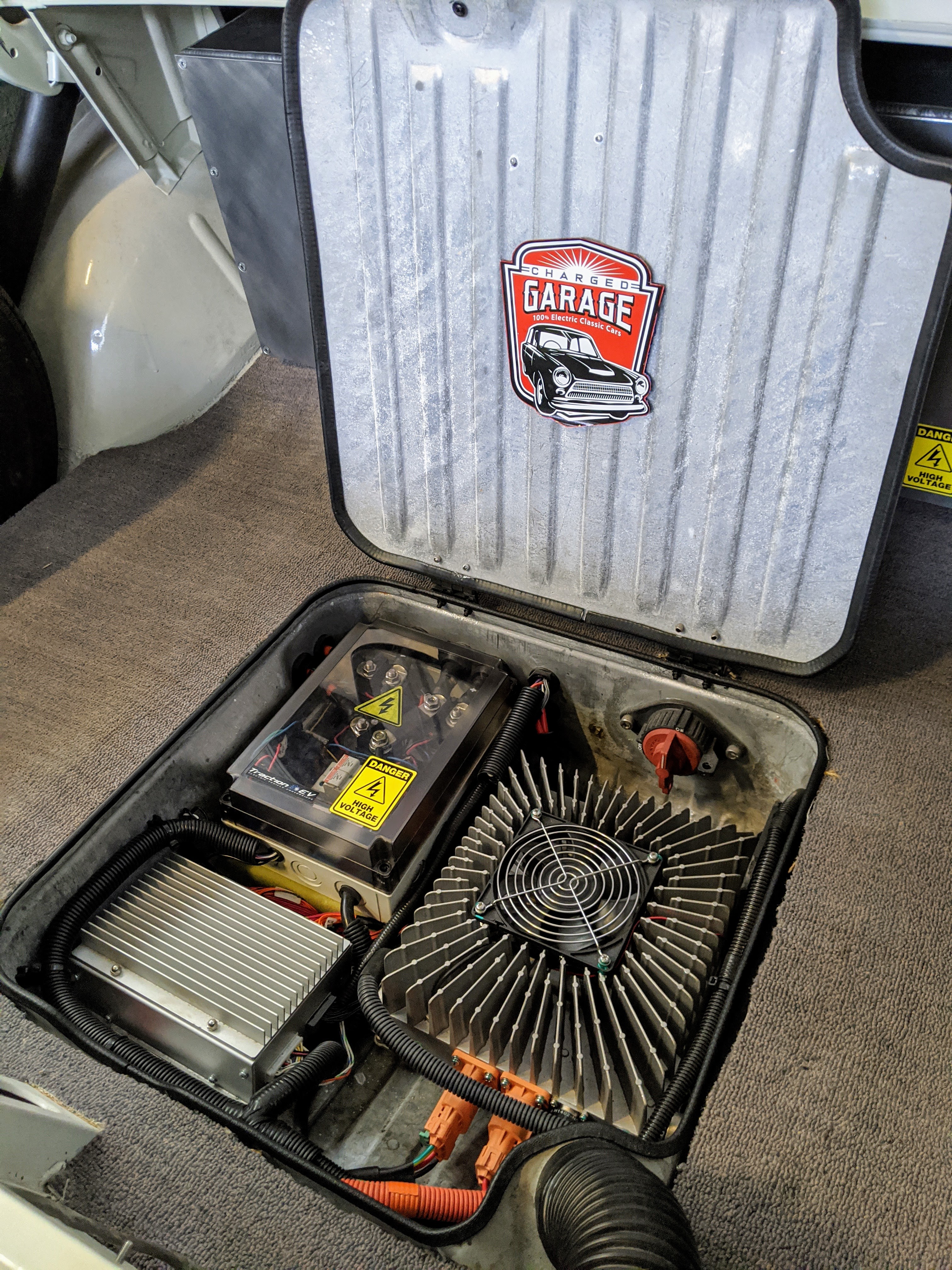

Looking good! Does the belly one drop the bus's bottom clearance significantly? Looks like it would house 2 rows of batteries.deadsled wrote: ↑Thu Jan 28, 2021 4:40 amHere you go. Might be a bit hard to picture out of the bus.alexbeatle wrote: ↑Thu Jan 28, 2021 12:43 am Mind sharing the pictures of the boxes? Looking for inspirations for my own conversion.![]()
We're starting to solder in the Openinverter board into the Tesla SDU now... exciting times.
I'm done with my OpenInverter board soldering and it's working very well. Getting ready to mount my SDU. My bus is '72.

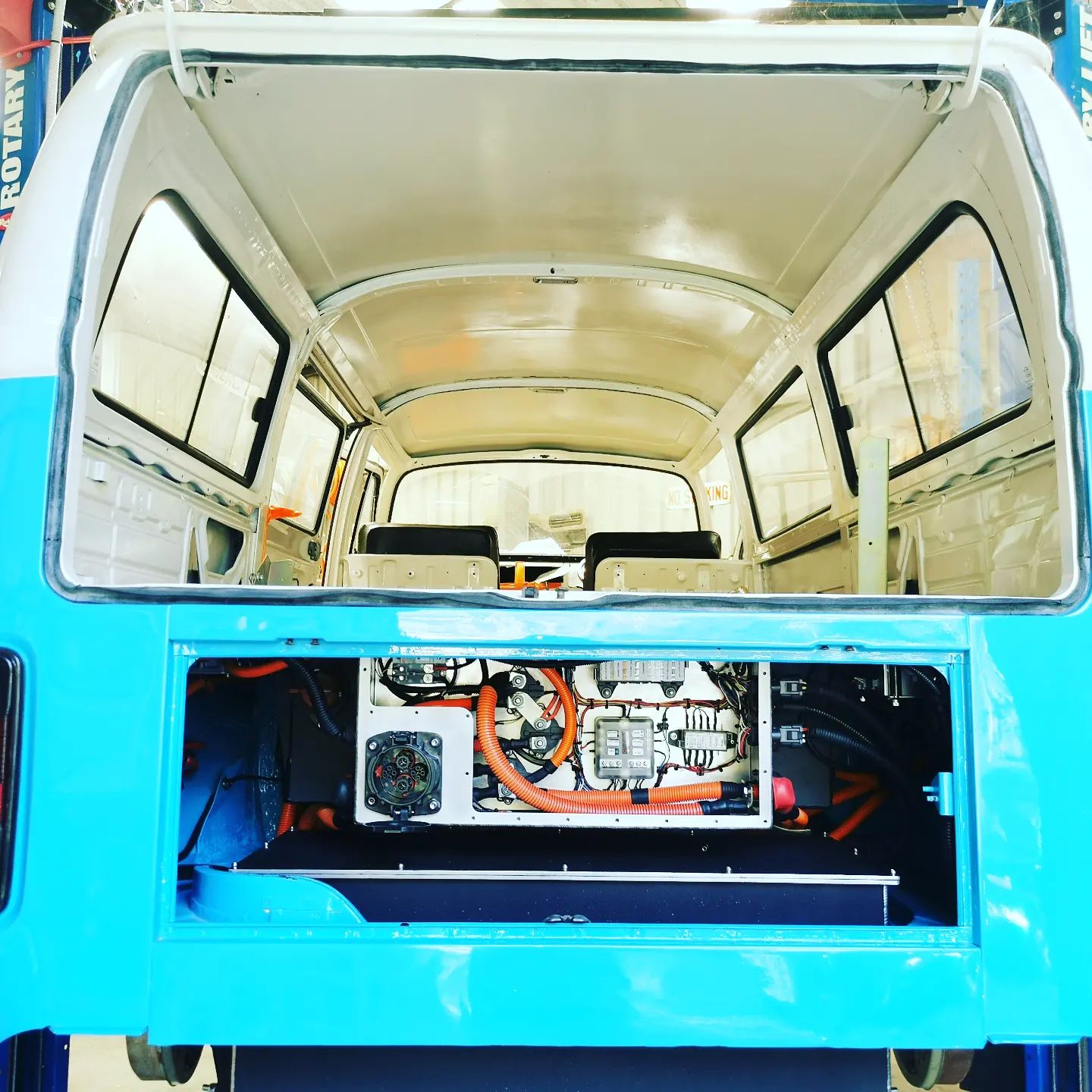

It's been a long time since I updated this thread. The restoration of the '73 VW has been continuing alongside the Tesla swap conversion by Traction EV workshop here in Brisbane, Australia. It's been a long, expensive journey but I'm sure everyone is familiar with that.
Fitting 14 Tesla modules, SDU motor, twin air conditioning condensers, HV air con compressor and twin cooling systems all underneath the bus has been a challenge, but it has been done. No modifications at all to the interior except the installation of front and rear air con evaporator / fan boxes.
It has been fully engineered and signed off as being fit for use on Australian roads, which was quite a significant milestone. We couldn't make any amendments to the chassis / body at all so all battery boxes and motor mounts come off stock mounting points. The rear suspension torsion bars have been upgraded to heavier duty given there is a bit more weight at the back now. Overall total weight was 1594kg (without the interior fully trimmed).
We are still trying to find the right parameter settings on the Openinverter SDU board. I have an expert programmer friend to handle that side of it and so far it is technically working but lacking some power during acceleration. He's also got the custom Speedhut CAN gauges working with a Teensy but still trying to get the power kW gauge to work.
I think I need to get my head around the Openinverter parameters so I will have to trawl through some of the threads on here.
Enjoy some progress photos...
