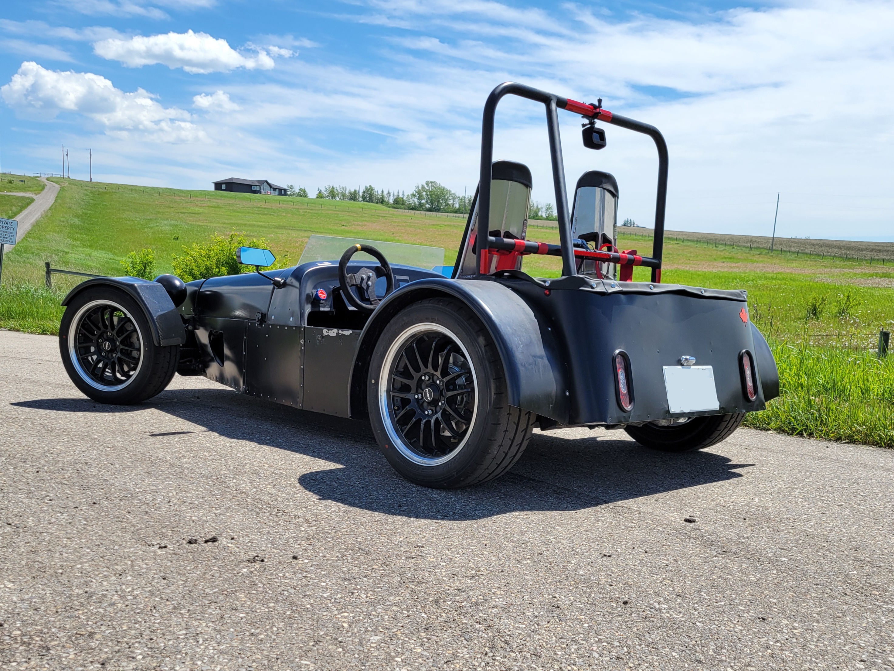

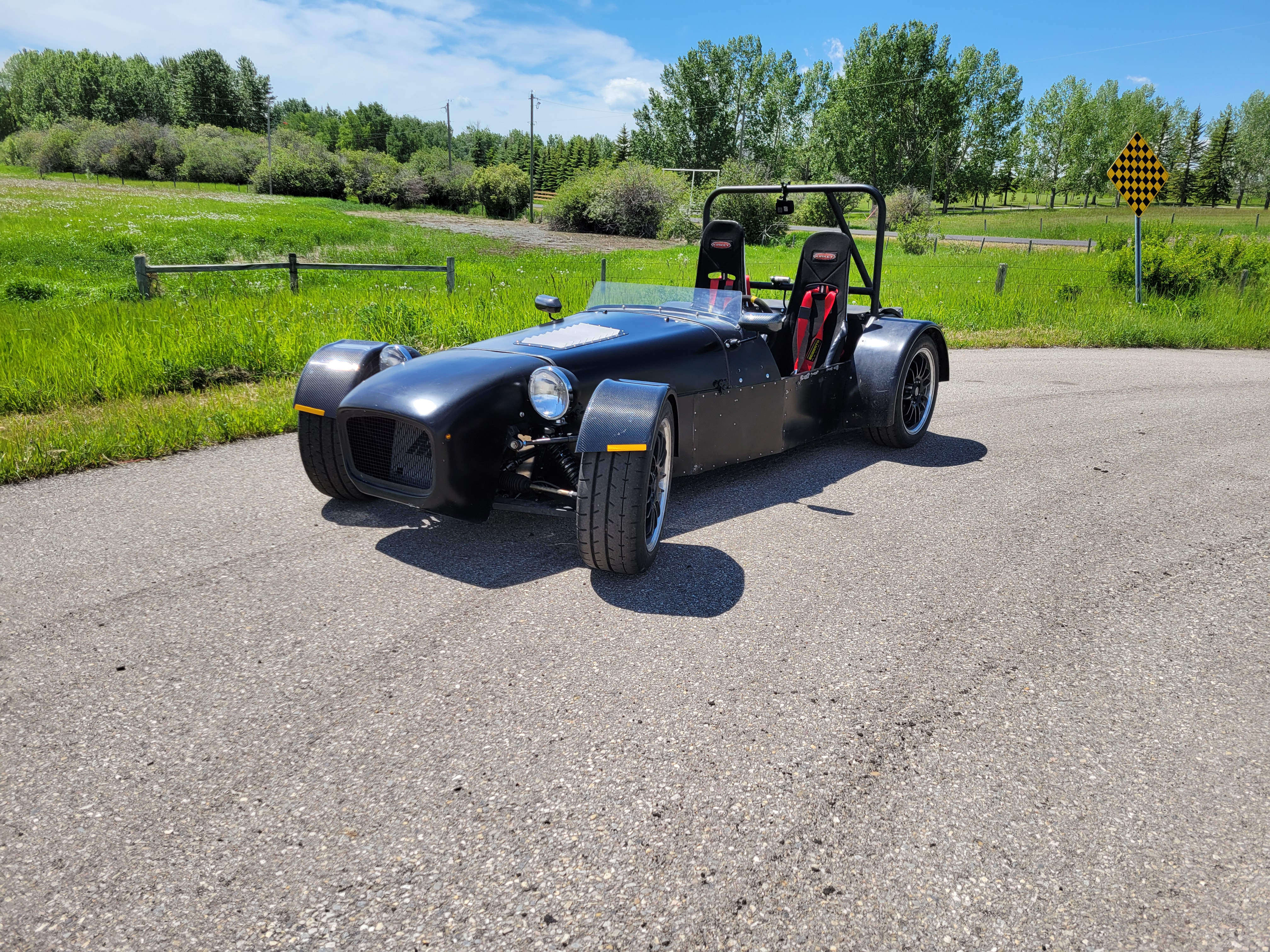

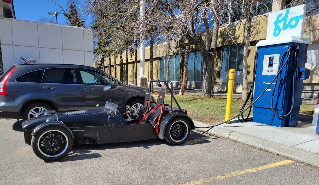

Finally got the car out for more testing today. Now that I had the correct springs in place and new front shock mounting points, I really took my time with a proper wheel alignment. That turned out to be quite tedious, but it tracks straight and feels way more stable at speed so I'm happy. I 3d printed a handful of jigs and tools to help, and now that I've got a process figured out it should be faster next time.

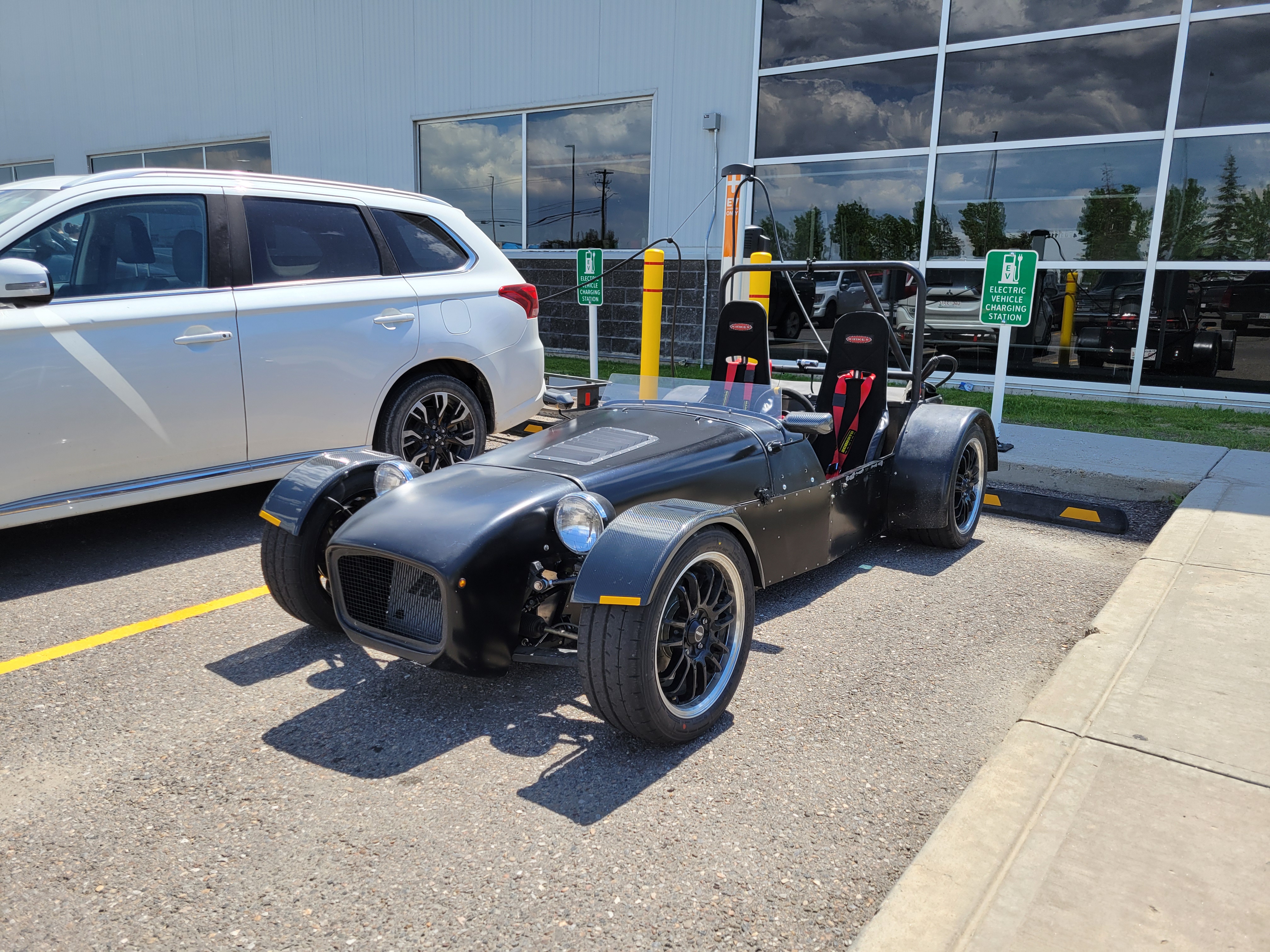

I also decided to try a public charging station just to make sure it works. This one was free, but I still had to download the app. Thankfully it was pretty simple and worked as expected! I went inside long enough to buy a drink and when I came out the car had drawn a crowd, lol. So I spent the next 30 minutes answering questions, which was neat.
I still don't have a proper acceleration test on a full charge, but I did a quick test at 380v and noticed the car hooked up a lot better. I still rolled into it from a stop but didn't get wheel spin. It was also a much warmer day today (25c and full sun) so the tires and pavement were hotter. There's going to be a special 1/8 mile drag racing event held on a nearby runway later in the summer and I'd really like to get a few passes in if they'll let me. It's supposed to be 'heads up' racing with no timing, but if I'm able to run I'll probably buy a gps/accelerometer performance meter to see what my 0-60 is. I also have a 10hz gps and some accelerometer from an abandoned diy data logger project, maybe I'll see if I can get that finished too...
Edit: My gopro turned off for it but I was able to pull the dash cam footage of my 380v acceleration test. The dashcam GPS is slow to update and seems to do some averaging with the last reading, but at steady speed it does agree with the speedometer. It was recording at 29.97 fps and the speedometer seems to update every 10 frames. By counting frames from the first movement to 5 frames after the display refreshed to 99kph, I get 4.5 seconds exactly. The built in accelerometer registered about 1.3g up to 40kph which I think is around where field weakening starts. If this is all pretty close to correct then I'm going to be very happy. I have no idea what my 0-100kph was with the bike engine but I'm certain it wasn't even close, especially with how much I had to slip the clutch.

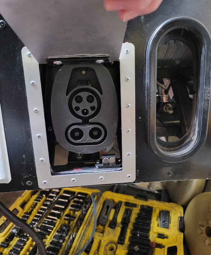

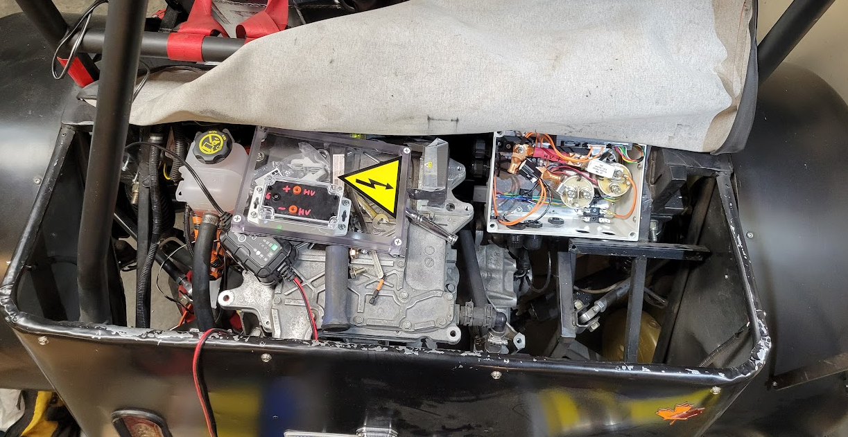

Over the winter I'm going to take a few things apart and ensure the car is fully compliant with the SCCA EV rulebook so that next year I could take it to Montana or British Columbia to run in some of their events.
I'll have to go through the rules with a fine toothed comb, but I already know I have to replace the HV wiring to the inverter with shielded wire, which I already have. I'll also need to replace the wiring to the charger and DCDC for the same reason. I also need an isolation monitor, which is purchased but not installed yet.

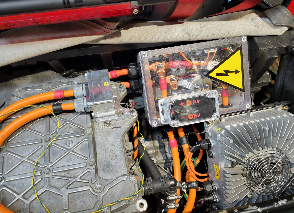

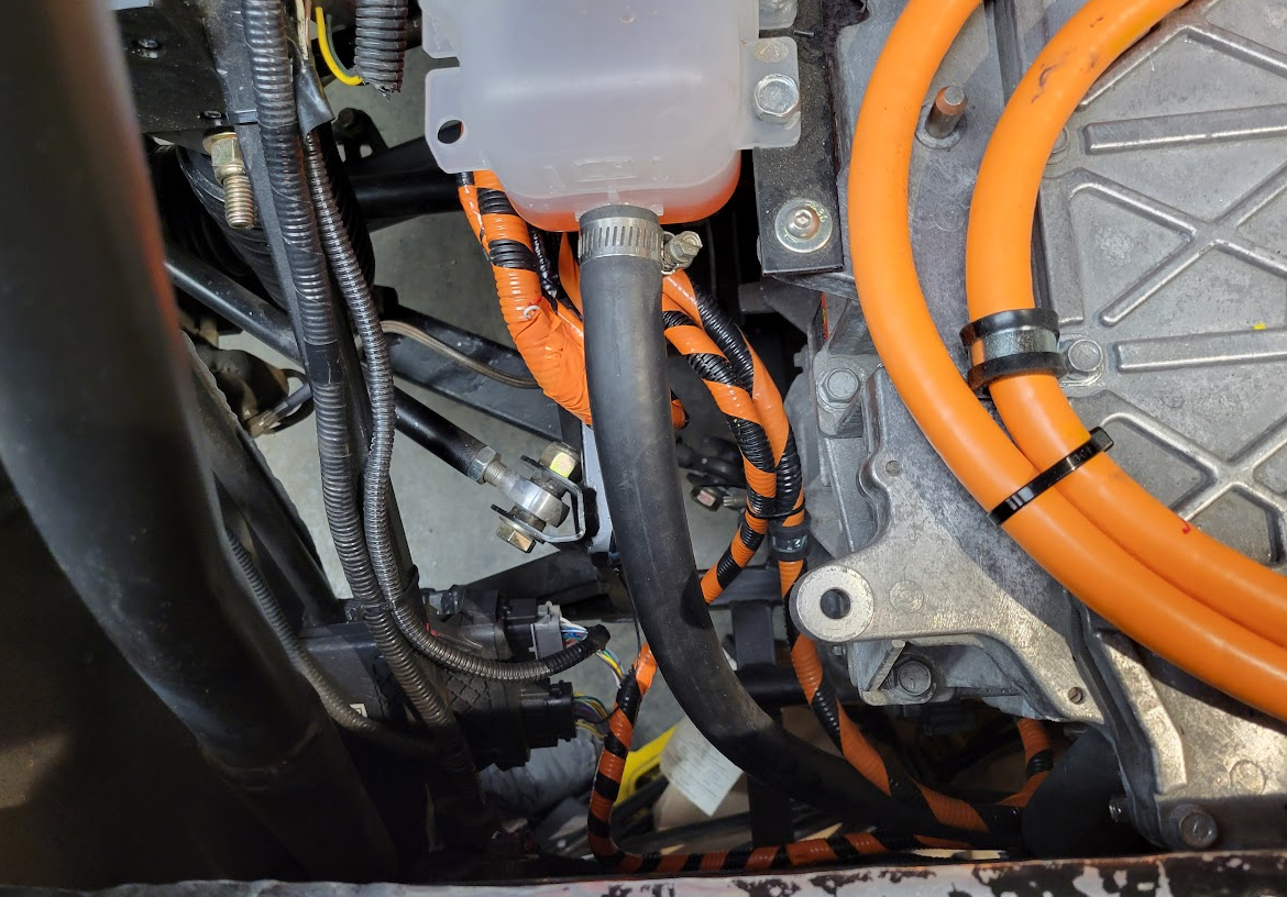

The funny thing about the dcdc wiring is that since I used 14 ga wire, it has to be shielded. But it's only got a 10 amp fuse so I could just replace it with 16 ga wire and then it wouldn't need to be shielded. Lol.

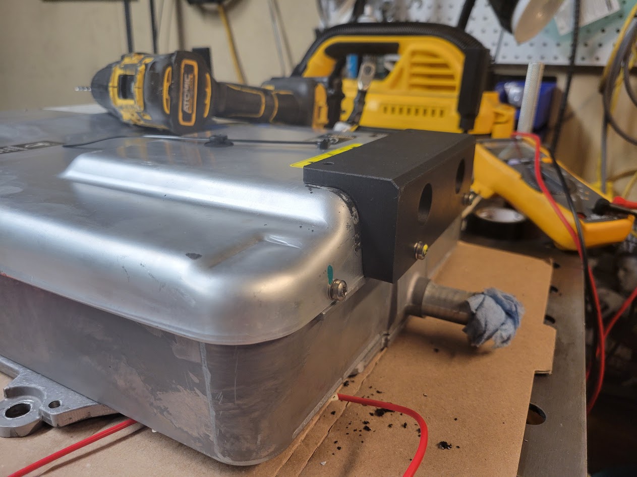

The charger is a little more complicated. Looks like I'd have to disassemble it to replace its wiring. But it's only 3kW and I'd been wanting to upgrade anyway, so I got my hands on a 10kW Tesla gen2 unit. I'm not exactly sure how I'm going to install it yet, but I'm toying with the idea of using it for offboard charging so I'm not carrying the extra weight on track.

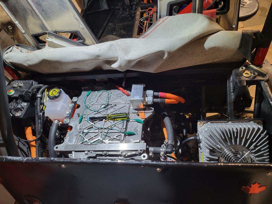

So far I've installed the new control board and printed an adapter that will allow me to use 20mm cord grips in place of the old connectors which wouldn't be allowed. It would be kind of neat to give it its own small, self contained coolant loop, so all I'd have to do is connect an HV plug and a LV plug for 12v power and BMS communication. Any suggestions for a small water pump and radiator? I'm wondering if a PC water cooling system would be enough?
Adapter: Untested beyond checking the fitment
And this is the only wire I have found that seems compliant: https://www.iewc.com/catalog/wire-and-c ... 0032129622
I tried to register for a drag racing event happening in September, but they told me they can't allow EVs because of insurance. Sigh.

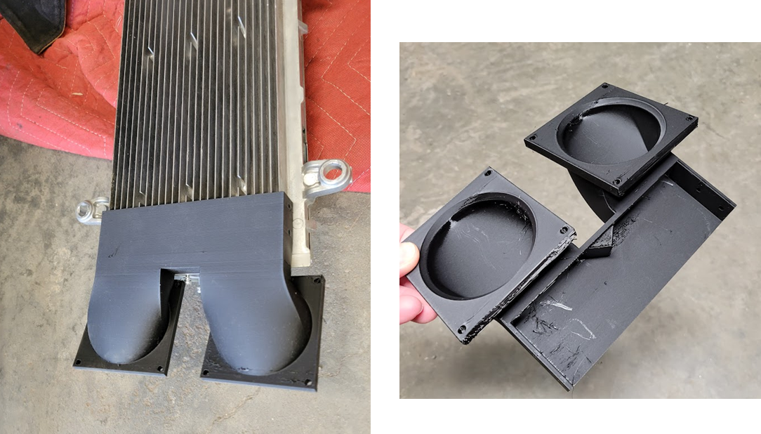

What's the efficiency of the Tesla charger? What's left to 100% is the heat the cooling system would have to deal with. I started making a peltier cooler with a large PC water cooled radiator that had 3 120mm fans. It had no problem keeping up with 200 watts of heat. It was limited to 8mm barbs from the small pump I was using. I'd guess you'll have to deal with 500-1000 watts of heat though for this.
You could likely use a heater core or 2 along with a variable Tesla / VW water pump and a 10-12" radiator fan to keep it cool.
Some of these onboard Tesla chargers were used in their standalone chargers too, no? I wonder how much info you could find as a reference from those?

- Install CCS/Foccci

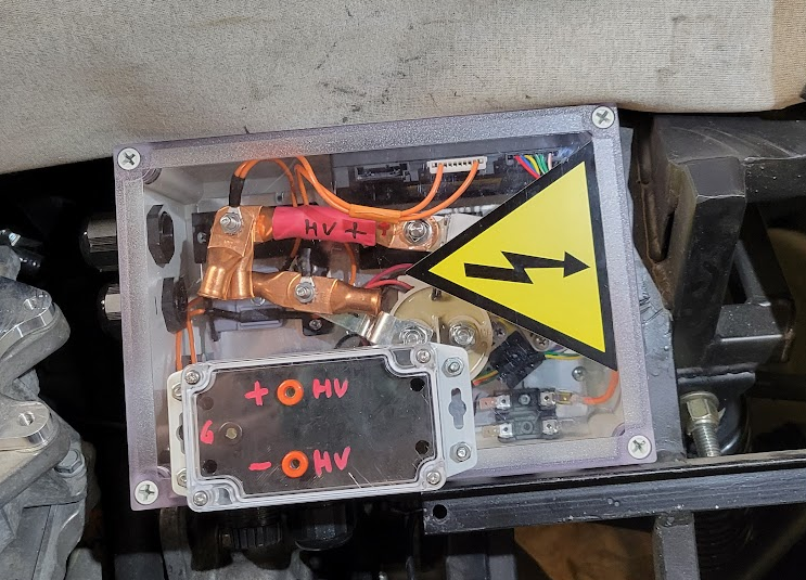

- Install insulation monitor (for SCCA compliance)

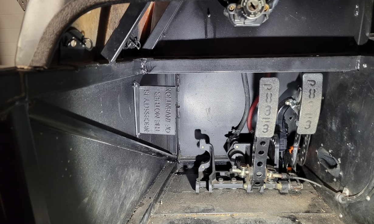

- Modify dead pedal for better comfort since I don't have to allow clearance for a clutch pedal anymore

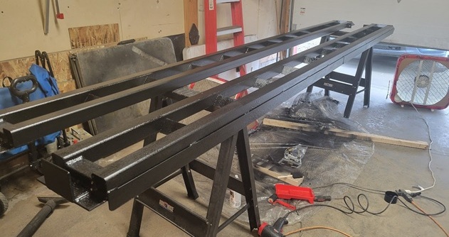

- Reinforce or replace ramps used to load the car into the hauler with something more sturdy

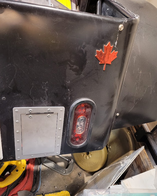

- Figure out why headlights and tail lights have a slight flicker when the DC/DC converter is running

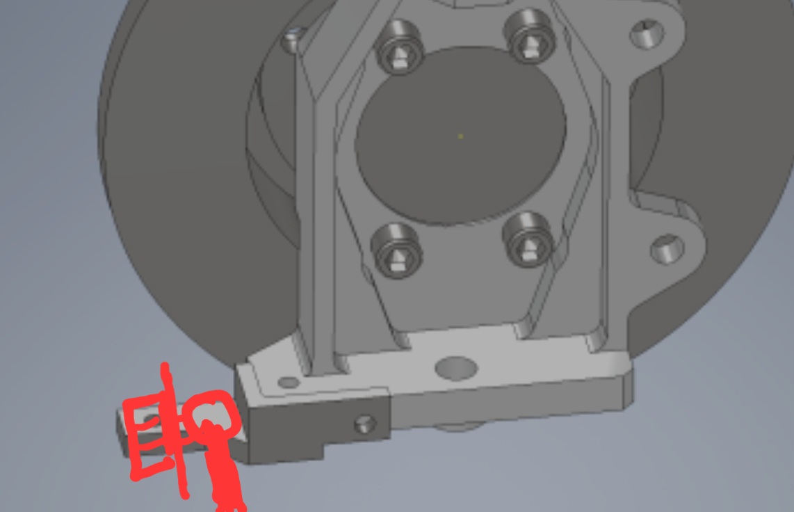

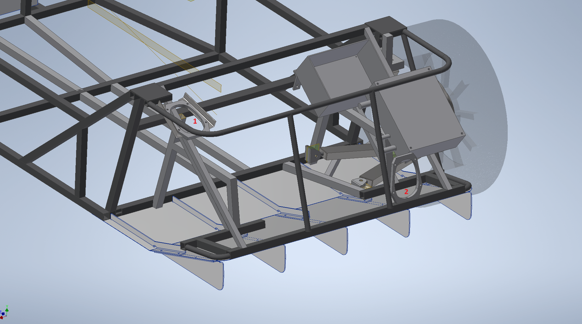

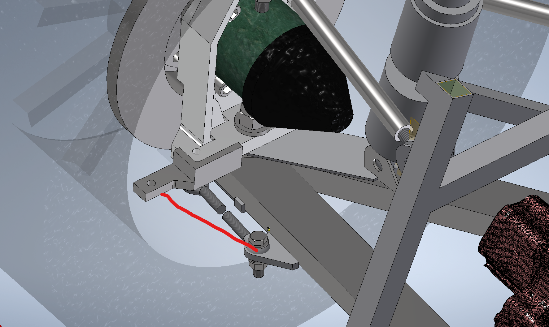

Okay, winter work has started. I got sick right at the end of the driving season so the car just sat for a bit, but now I've started taking things apart and planning all the winter work. First order of business was to get the tires into the house so the rubber won't be damaged by the incoming cold temperatures. Last year leaving the thing on jackstands was a bit annoying because I couldn't move it around, so this year I built a giant furniture dolley so I can move it around as needed and push it right against the wall when not working on it. I know Greg recently mentioned wanting to move his truck around for the same reason, although I don't think this is exactly what he had in mind.

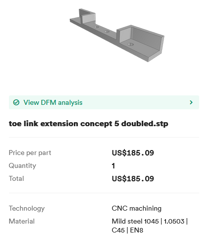

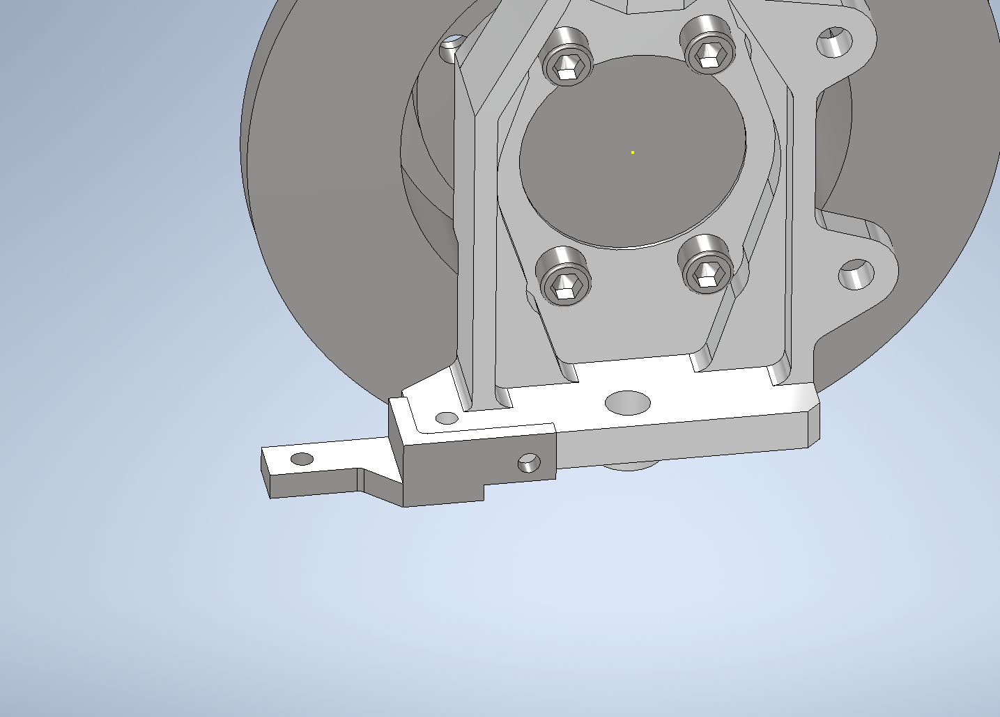

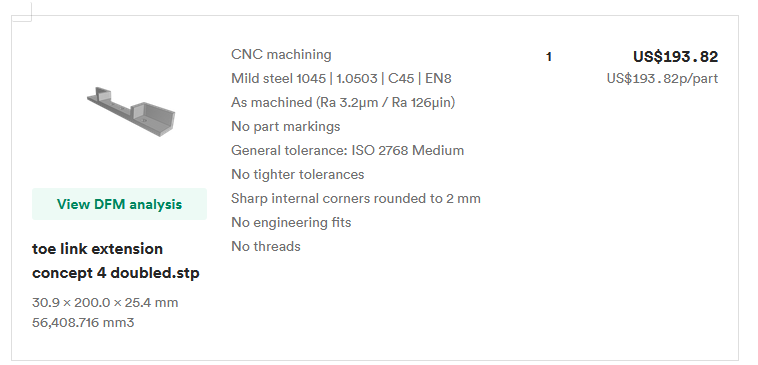

For some reason I decided to work on the toe link extension first. This is the least critical and I'm not even sure I'll bother with it, but I wanted to get the design finished. The purpose of this part is to move the connection point further away from the lower ball joint, which will allow more precise adjustment when setting the rear toe angle. What I have is workable, just somewhat tedious and I was going for perfect. Originally I didn't make the mounting point further away because the uprights were already expensive and extending the tab further out would just add to the cost (larger stock size to start with, more time machining away all the unused material).
So this is what I'm thinking about doing. It will use the original toe link bolt hole as well as one more hole I will need to drill and tap. Thinking steel for the material - more strength and the weight is negligible.

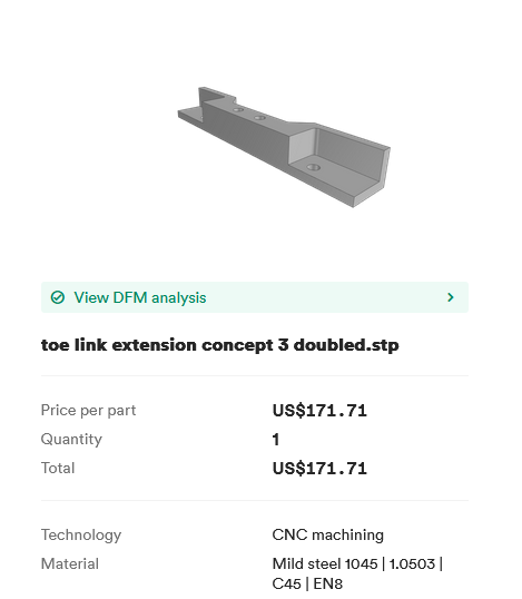

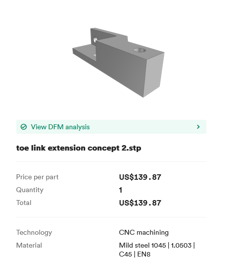

Still iterating on the design, but now I also need to find a way to make it cost effective. One way to do that is to remove certain features that I know I can mill myself on my manual machine. I hate hogging out tons of material but if the savings are significant then it may be worth it. Also, maintaining a flat bottom surface and designing it such that the features can all be machined from above on a 3-axis mill can help, so I removed the hole that is perpendicular to the rest of the part - I can drill that myself.
Yikes - this is going to be expensive! Here, I left that perpendicular hole in, and left out some of the less precise cuts that I can hog out myself. Since the parts are mirror image though, no discount for quantity. Going to end up paying double this for both sides.
Okay, suppress that perpendicular hole, and what if I mirror the part myself so it's one long 'stick'. Add a bit in the middle for the saw kerf and I can order 'one' part and cut it in half. Okay, not double the price! Great!
Now, hogging out the middle is not going to be fun. Maybe I will replace that feature and see how much it goes up. Sorry this one is formatted differently, I had to go back to my history to screenshot it.
After that I noticed the height of the part is exactly 1". Width is just under 1.25", nothing I can do about that. But the height doesn't NEED to be exactly 1". They may think they need to start with a taller piece of stock so they can machine it DOWN to exactly 1", which adds material costs and the extra machining time to remove all that excess material. I can change it to be 0.985" tall with no impact to me, and that tells them they can start with a 1" bar and skim it down. Not a huge change, but a slight price drop.
That's where I am at now. Next step is to do some stress analysis and determine if it actually needs to be steel or if aluminum will do. Aluminum will be cheaper and easier for me to machine. The reason steel is more expensive it because it takes longer in the machine and is harder on tooling. So not a super consequential update but I home someone finds it interesting. It gives a small insight into the process of designing something like this for easy/cheap manufacturing.

Re: [Driving] Homebuilt Locost 7 - from Motorcycle engine to Leaf power!

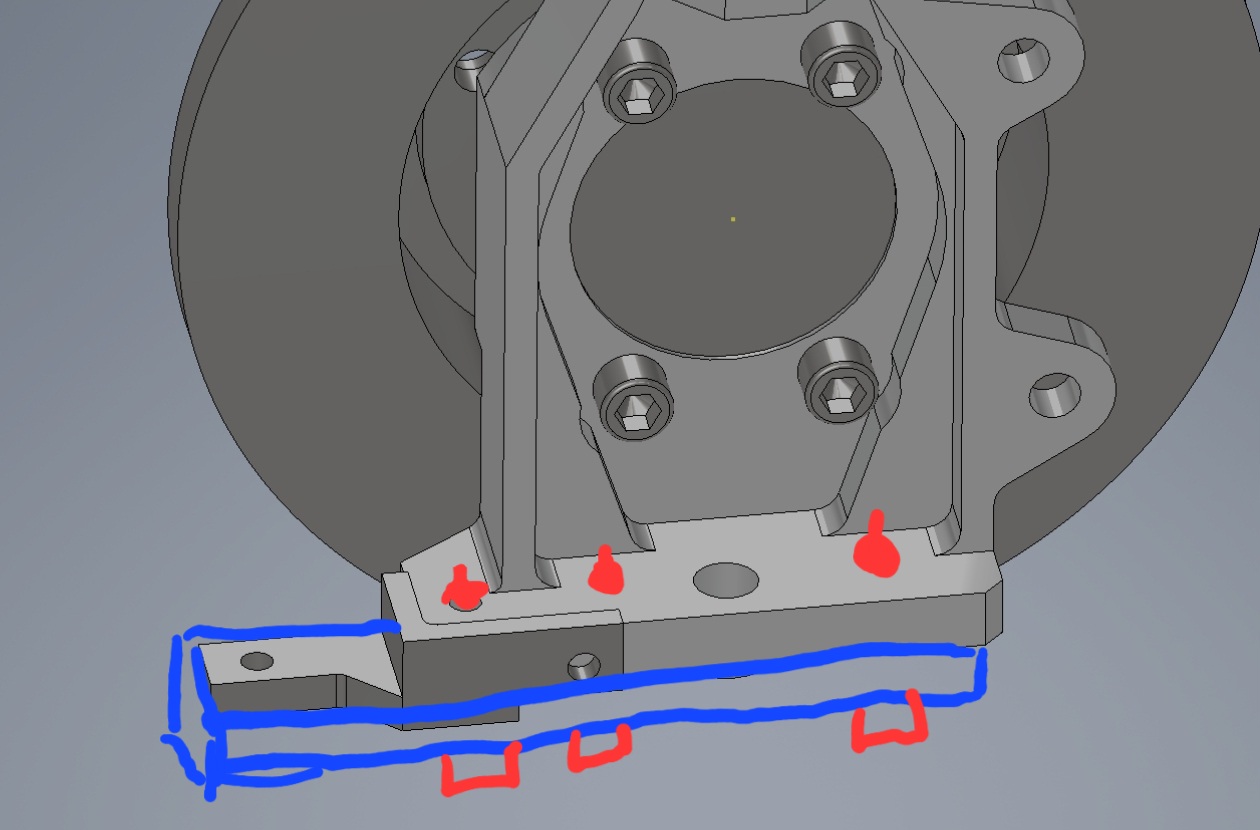

Do you have room in the lower ball joint area to do something like this?
It might need to flare around the ball joint for clearance / strength.
It could likely be the same for both sides. Looks like there's a lower ball joint boss to align on, can use the old ball joint hole too. This would require drilling your upright but I think those spots could handle it. Might be able to angle the tail section and angle the ball joint or flip it so it's aligned with the lower ball joint. Just an idea.
**Edit** might be able to use a single shear bolt with a safety washer in the tail section. C7 corvettes are like this. Where's the quote from? Have you tried JLC's machining services yet? They made a couple intricate polypropylene parts for me with orings and BSP threads that run at 250psi. They did a great job.
Ah, yeah no room to run it under the upright unfortunately, very little clearance to the control arm. I could probably run it on the top though. Still won't likely be symmetrical but I can try. I'll also have to jog it down or use a spacer where the link connects - gotta keep it on the same horizontal plane as the ball joint centerline or else it'll have bump steer. I'll put some more thought into going across the top though, thanks for the idea. Added benefit would be not having to take it all apart to drill that extra mounting hole in the bottom edge!
These quotes are from Protolabs, same place I got the uprights made. I haven't tried JLC but I will check it out, thanks.

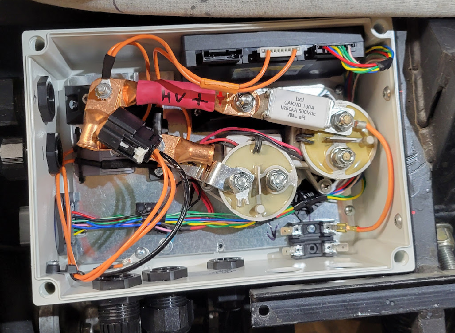

Been working on the junction box I need to add to the rear of the car, while also pulling out the old HV cable to replace it with shielded cable (required by the SCCA rulebook). I think I could use some opinions on where to locate my new CCS charge port. I think I have it narrowed down to two options but I'm not thrilled about either.
First, here's the new junction box. Basically the wires from the contactor box come in from the left side, terminate at the posts (which are at different heights), then exit through the bottom of the picture to go to the inverter. The contactors in this box are for the CCS port. The black box in the upper right is the insulation monitor. The cable from the OBC will enter through the cable gland at the bottom middle, where one leg will go through the fuse block and the other leg goes to the live side of the negative CCS contactor.
The random loose plug you see in the above image is for the insulation testing system. The regulations state that you need to bring your HV+ and HV- through some 10k resistors and terminate at a pair of 4mm banana jacks which have a separate cover over them. To test the system you need to connect a cable with one more resistor that will bridge either the HV +/- together or to chassis ground, and the insulation monitor must detect the fault and open the main contactors within a few seconds. Here you can see how I added those ports. I am thinking about 3d printing a cover that looks like a household electrical socket and then making the test cable look like a fork.
And here's a zoomed out photo of the whole boot, showing where the junction box is. The OBC gets mounted to the bracket just below it.
Now for the tricky part, where to mount my CCS port? I had the old J1772 port mounted at the base of the roll bar on the left (see old photo below) but I'm not sure I can fit the CCS port there. If I do, I will need to bring all the wiring across the back of the car and that would be a bit tight, but doable. I would also need to relocate the 12v battery, more work but totally doable. I'm also a bit worried about whether a big CCS plug would clear the roll bar brace. I may have to mount it at an odd angle.
So the other option I can think of is cutting a hole in the back of the car and mounting the port there (marked as option 2 below). The benefit to this is that both the OBC and the junction box are right beside it so wiring would be simple. The CCS port does have rubber plugs and I don't drive the car in the rain, but I still don't really like the idea of the port being visible all the time. I thought about maybe mouting it in the middle behind the license plate, but there's not enough space behind the motor. Also included in this shot is a sneak peek of the splitter I am designing, should help a lot to reduce drag.
Any suggestions would be welcome!

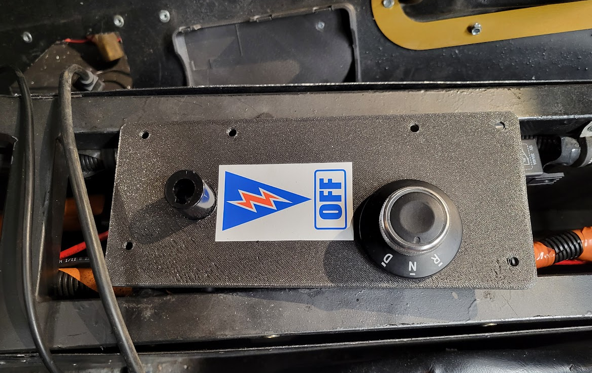

I suppose I can post another update. The car is still apart for the winter but getting close to being drivable again.
For comfort, I removed the aluminum dead pedal and replaced it with a 3d printed one, which is a little wider and sits further back while re-using the same mounting holes. The old one was closer to me than I would have liked due to the position of the clutch pedal, but now that it's gone I am free to position it how I want. I also replaced the DCDC converter due to the flickering output voltage from the old one. I suspect it overheated. I probably never had it over 20% of its rated load, but it also had no airflow. This shroud fits 2x 80mm fans and just barely clears the cable gland I had to install for the HV inlet (since I would need an HVIL on the plug if I had kept it). STL on request. And here's what I decided on for the new CCS charge port. This was nice because the CCS contactors AND the OBC are right behind it, so very short wiring runs. Not sure if I should paint or leave it bare. Probably going to paint it... later. Just about done with the wiring in the back. The loose twisted pair is canbus to the insulation monitor, but I'm not sure if I need to connect it to the network. Depends on whether I can leave it running while fast charging. The OBC is now hardwired on the HV side due to rules compliance. Lucky for me the aluminum housing had holes that were perfect to tap 1/2" NPT for cable glands. Here you can also see the insulation monitor test points (the smaller enclosure bolted to the lid of the big one). To fully comply with the rules I need to machine some custom, captive thumbscrews so you can open the lid without tools. Sigh. And Foccci is hiding down here, where the 12v battery used to be... ..Which meant I had to move the battery back to the front of the car. It's ok though, actually helps with weight distribution. Bit tough to get it in there but thankfully I still haven't patched the hole in the body where the exhaust came out, so it's easy to stick your hand in there and position the battery in its mount. And a new drive selector, with the mandatory kill switch. The first layer of that plate is definitely not perfect but I think this photo makes it look worse than it does in person. It's PETG though so easy to redo later if need be. What I really wanted to do was make it out of 3mm aluminum, but I was worried it wouldn't look as good. HA!
So that's about where I'm at now. I still need to install my 'permissive relays' which will kill power to the contactors if they are triggered by the BMS or IMD. I also need to configure the Foccci but that isn't as easy for me as I had hoped. Have asked for some help in the Foccci user thread, and I'm also trying to put together a CAN sniffer in case I need it. Once that's all sorted I will try AC charging in the garage. Between now and spring the goal is to have the car roadworthy again so I can drive to a fast charger to test.

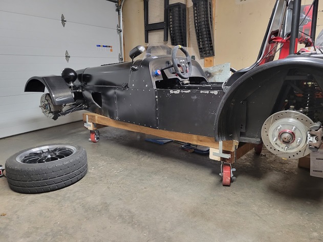

Got everything back together a few weeks ago and the car is running great. Johu's recent syncadv code update made the car drive better than ever and I'd say I'm ready to go to autocross.
Unfortunately that's where the good news ends, because EVs are still banned from all tracks in Alberta. I just heard back from the local governing body and they've made zero progress towards finding a solution. From the tone of the email it's pretty clear they don't have any interest in working on the problem. There are two clubs in BC that are a 4-6 hour drive away and in theory they do allow EVs, but when I contacted them to verify I'd be allowed to run, they said they need to discuss and get back to me. I haven't heard from them since. So, I'm feeling very discouraged. The only other option is to go to Montana, but with recent political tensions I'm not sure I want to try bringing the car across the border. Have heard several horror stories recently.

Anyway, in addition to feeling sorry for myself I also built a new set of loading ramps since the old ones were a bit flimsy and warped due to the way I welded them. Won't have that problem now! They are upside down in the photo, but the near end hooks onto the ramps inside the ambulance and the stitch welded flat bar along the sides keeps the car on the ramps.
And I posted this in the Foccci gallery, but here's my first DCFC session. It ran for about 10 minutes before cutting out, I believe it was because of interference from my isolation monitor. I did have it disabled, but the IMD also has internal relays that you can command open. I didn't have that function in place at the time but I've since added it. It snowed again today, so I may or may not be able to try another DCFC session this weekend. There's also a nearby EV awareness event happening on the weekend. It's geared towards educating people about EVs and convincing them to buy one, but I'd like to go anyway to check it out.
