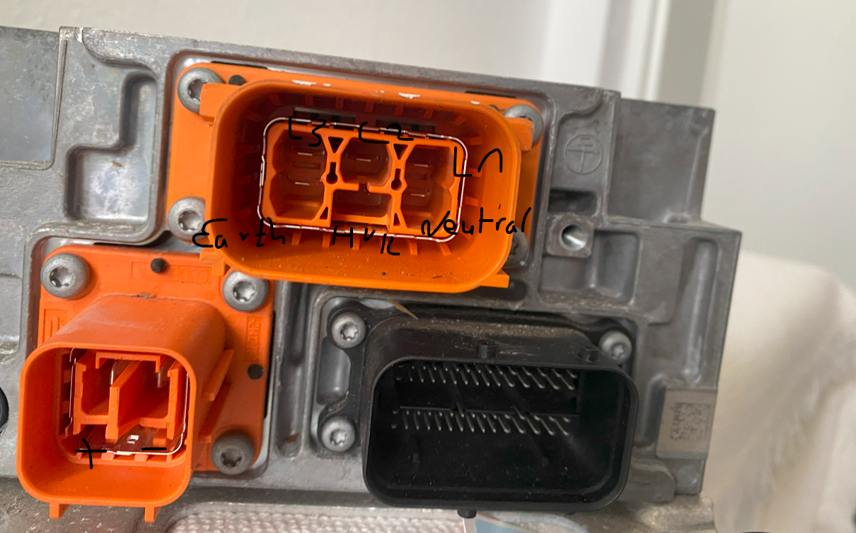

Can anybody confirm the pinout? I want to put it into the Wiki.

modellfan wrote: Wed Nov 06, 2024 9:10 pm Can anybody confirm the pinout? I want to put it into the Wiki.
Can't anybody pop out their mutlimeter and measure it? I unfortunatly don't have the original harness yet. Thank you ahead.

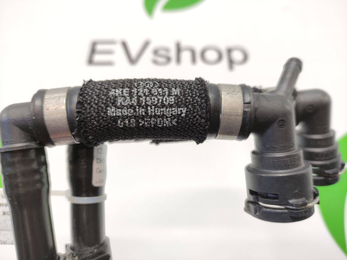

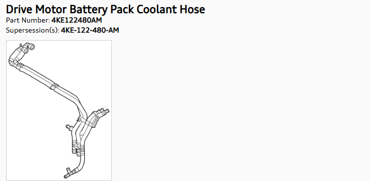

jrbe wrote: Mon Aug 12, 2024 11:18 am Reverse image search of a Normaquick NW12 image
with something like "vag coolant connector" finds a bunch.
I put some time into verfying this / finding the original Audi/VW part number. For Audi etron this is the coolant hose assembly: https://parts.audiusa.com/p/Audi__e-tro ... 480AM.html with part number: 4KE122480AM. One of the connectors is 90° bend, the other is 90° bend + bleed pipe connector. Searching the part number gives some detailed pictures like the one attached and I am pretty sure, I can read 4KE 122 298 as part number. But google doesn't find any parts for this. Any ideas ?

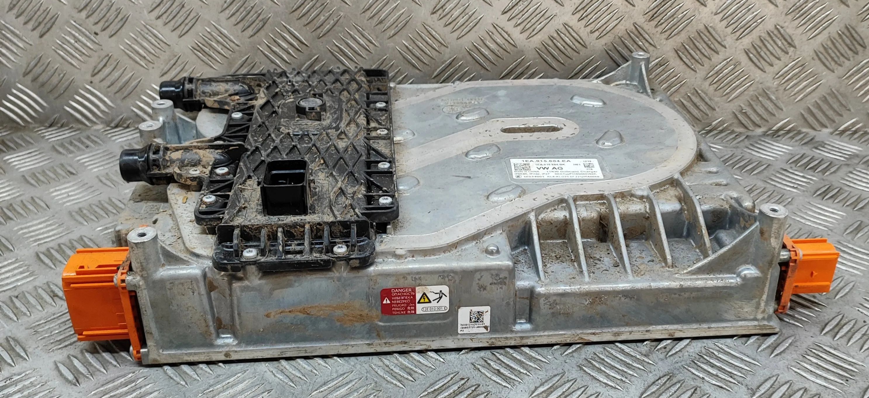

golfdubcrazy wrote: Wed Oct 26, 2022 8:03 pm looking good, are you planning on doing a teardown ?
Doh! Almost...
Hi all - looking for inside information about the 5QE915681 series of chargers; my B variant isn't lighting up. Details over in Ross-Tech thread (https://forums.ross-tech.com/index.php?threads/46318/)
If you or anyone on this forum has opened the inverter to probe around inside, please send hints/tips/tricks to keep from breaking the darned thing while trying to interrogate it. I have the 5-star security bit to open the cover, and even got to the point of peeling it up... but wimped out without a second charger in my hands to fit instead. And, no scope immediately in hand to make the most of the reveal.
Am I really the first to open one of these? A pointer to a teardown ... or anyone who wants to send me one to perform a teardown - it's time.
Thoughts?
Micah

Post by jrbe »
You unplugged the retract motor. I wonder if it lost it's position reference when it was unplugged or if it's limit switches? are faulty.
Sounds like it can't lock the cable / can't confirm it's locked and won't charge because of that from your description / info.
VCDS should have a way to test all of these io's.
But!!!! Someone on here activated a test in their egolf and heard a bang and now has battery issues. So try to find that post before doing any output tests.
