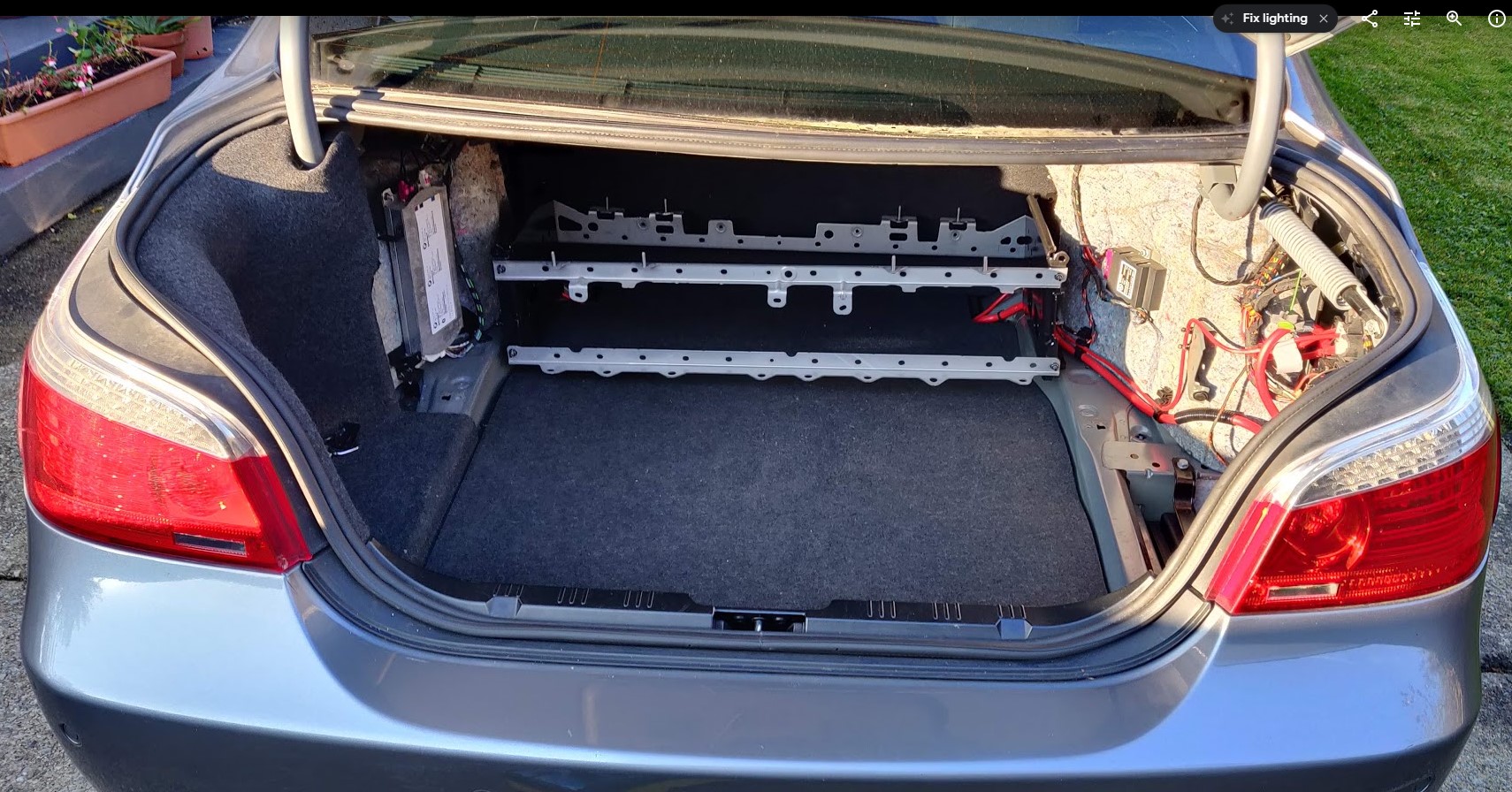

Hello,
I’d like to introduce my project. I’ve been watching Damian’s video’s for years now and decided it was time to have a go at a conversion. After attending the New Electric course in august I had the knowledge I needed to make a start. I bought the car with engine damage for €1,500 and since then I’ve been planning the build.

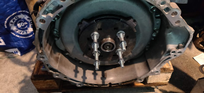

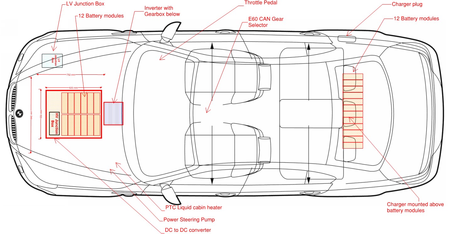

Spec
BMW E60 520d

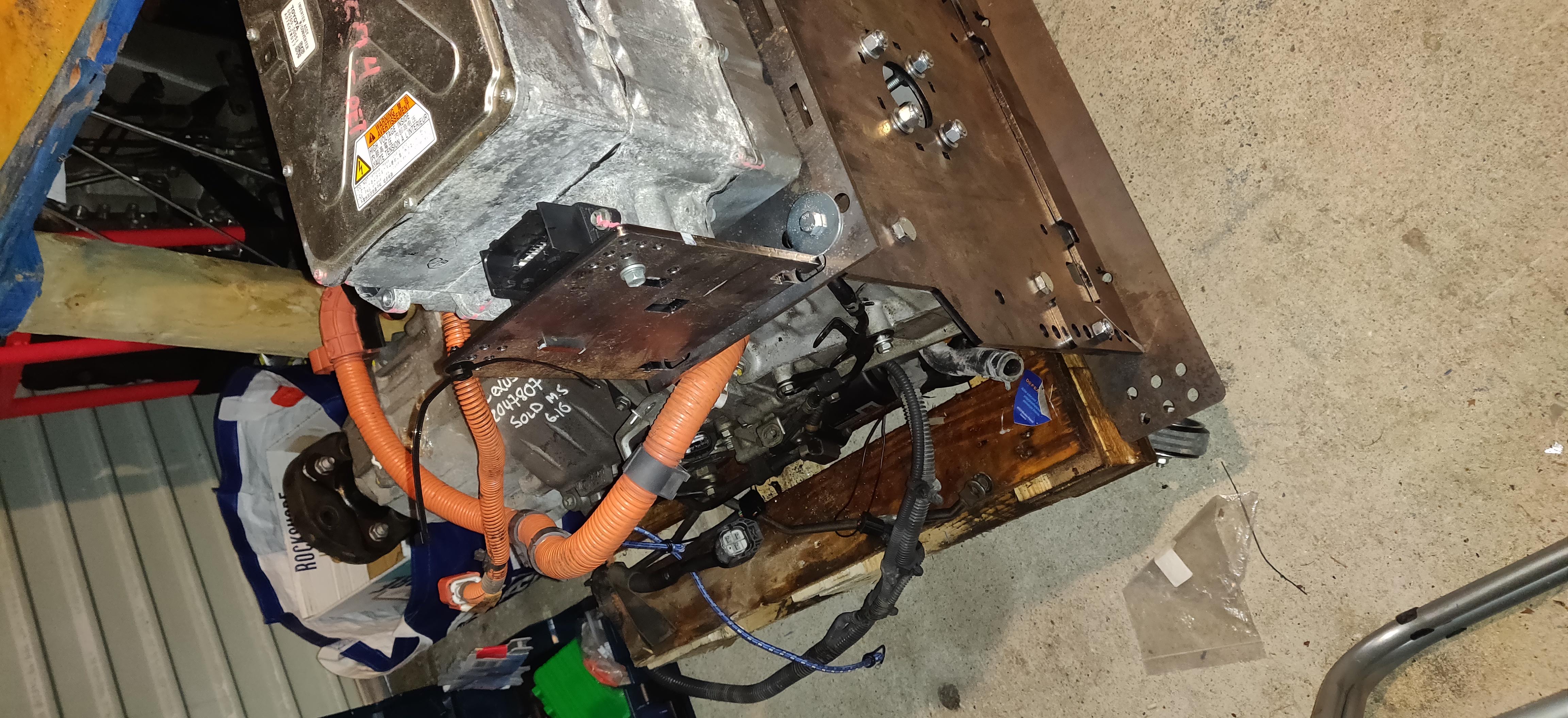

Lexus GS450H gearbox and inverter

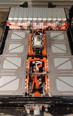

2019 40kWh Nissan Leaf battery
HV JB from the leaf
Opel/TRW electric power steering pump

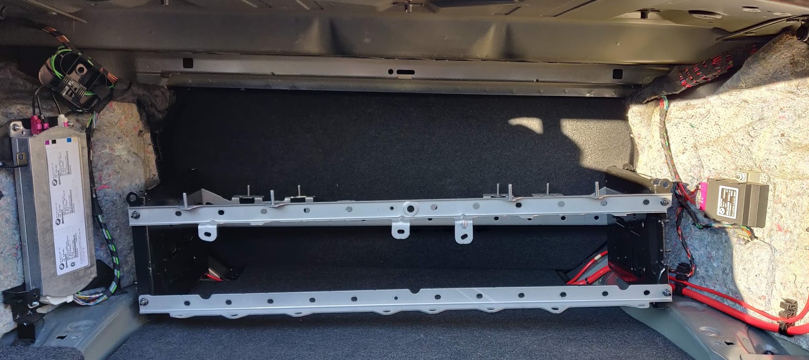

The 12 module rack from the leaf fits nicely within the boot. The seats don’t fold so nothing lost there. Should only loose 400mm depth from the boot. Need to decide is this needs to be in a box or to just fit some sort of plate to protect the batteries and cover over with boot lining material.
Work completed
Leaf battery disassembled.

Lexus GS450H gearbox bench tested and spinning with EVBMW VCU running V7 Software.
To do
CAN signal grab from car. If possible without engine running

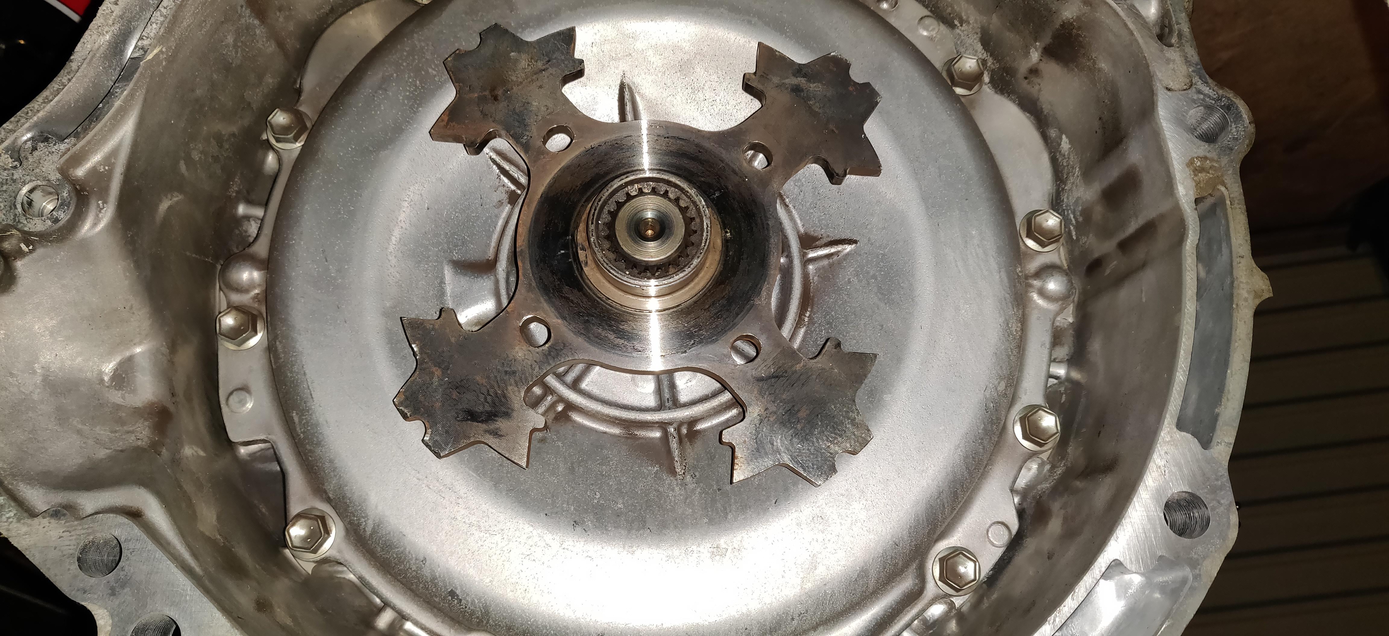

Fit locking plate to gearbox
Test gearbox oil pump and replace pump bearings
Design and build front battery box
Strip ICE components from car
Fit powering steering pump
Decide on charging, thinking about a tesla gen 2 with EVBMW ECU. Open to suggestions?
DC to DC converter?
Cooling pump and plumbing
Thinking about a electric cabin water heater from BMW hybrid, 330E or 530E, yet to be bought and tested.
Figure out CAN for E60 gear selector(Car is a manual but would like to add original E60 selector)
Battery box heating
Battery BMS
Weight
ICE Kerb Weight = 1585Kg
Ice removals = 286Kg ( Engine 161Kg, Fuel 60Kg, fuel tank 5Kg, Exhaust 10Kg, other Ice bits 50Kg,
Assume manual gearbox is similar to GS450H (E60 is probably lighter)
Leaf battery pack = 209Kg, say 250Kg with new battery boxes
Other EV parts 50Kg
New Car weight 1599Kg
Difference +14Kg

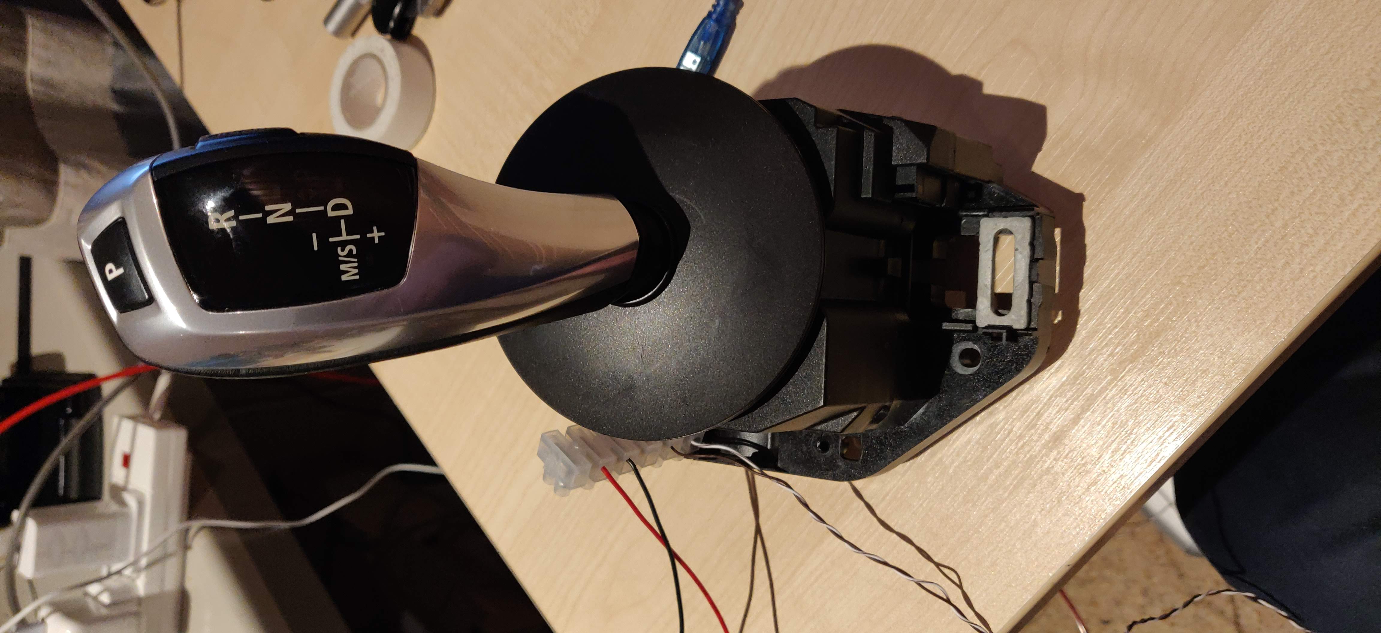

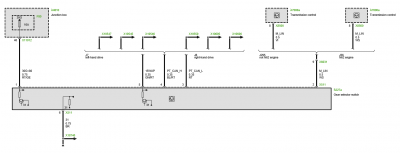

I've been playing with the E60 gear selector but not having much luck. Google doesn't throw up any useful info regarding wiring. I'm assuming the twisted red and blue are the CAN H and CAN L pins 3 and 4. Pin 1 red/yellow, pin 2 white, pin 5 red/green and pin 6 brown.
I've tried various wiring configurations but no luck getting it to light up. I was hoping that the T15 wake-up signal (sent from UNO CAN BUS shield) or RPM signal from the VCU might bring it to life but no such luck. I know that in my F10 with the same gear stick the park lights up when the start button is pressed to turn on ignition with engine off.
mdrobnak
Posts: 692
Re: Lexus GS450H Powered BMW E60
Post by mdrobnak »
Here you go. :)
Pin 1 is Terminal 30 - Always on.
Pin 5 is Terminal 15 / Wakeup
Pin 2 is LIN comms (probably not needed - diagnostics?)
Pin 3 is CAN Low
Pin 4 is CAN High
Likely 500K speed as it's Powertrain CAN.
-Matt

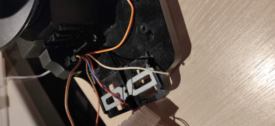

So I tried wiring it per the diagram. Pin 1 = 12V, pin 6 = Grd, Pin 5 to 12V to wakeup but nothing is lighting up. I'm thinking maybe the gear selector needs a LIN signal from gearbox to tell it its in park etc.

I got an E60 shifter working on the bench a while back. Hope you can make out my notes:)

Thanks, much appreciated. Looks like I need to send out 0x1D2 to light things up. I will try to get my head around all this CAN Stuff. I few youtube videos to be watched!

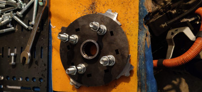

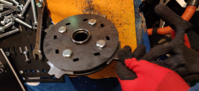

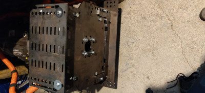

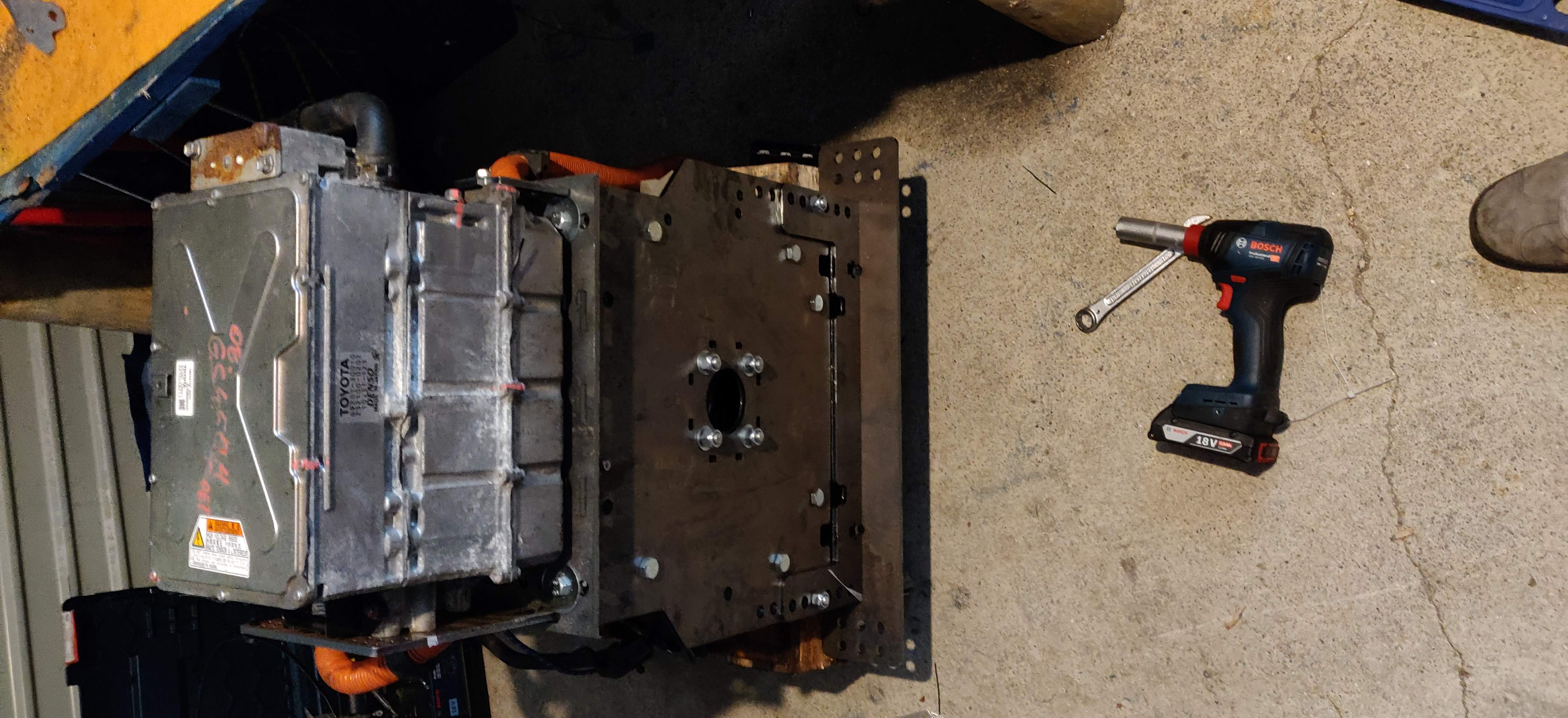

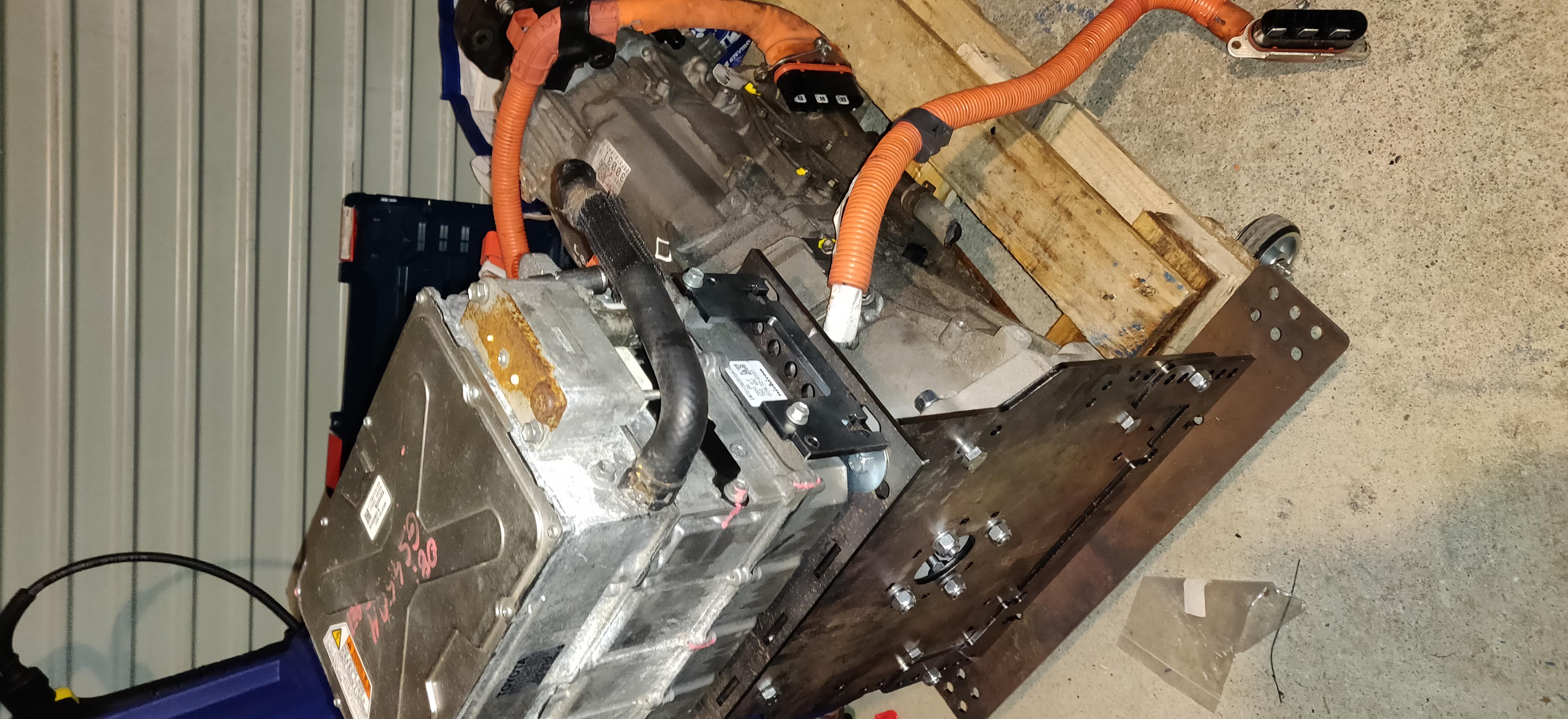

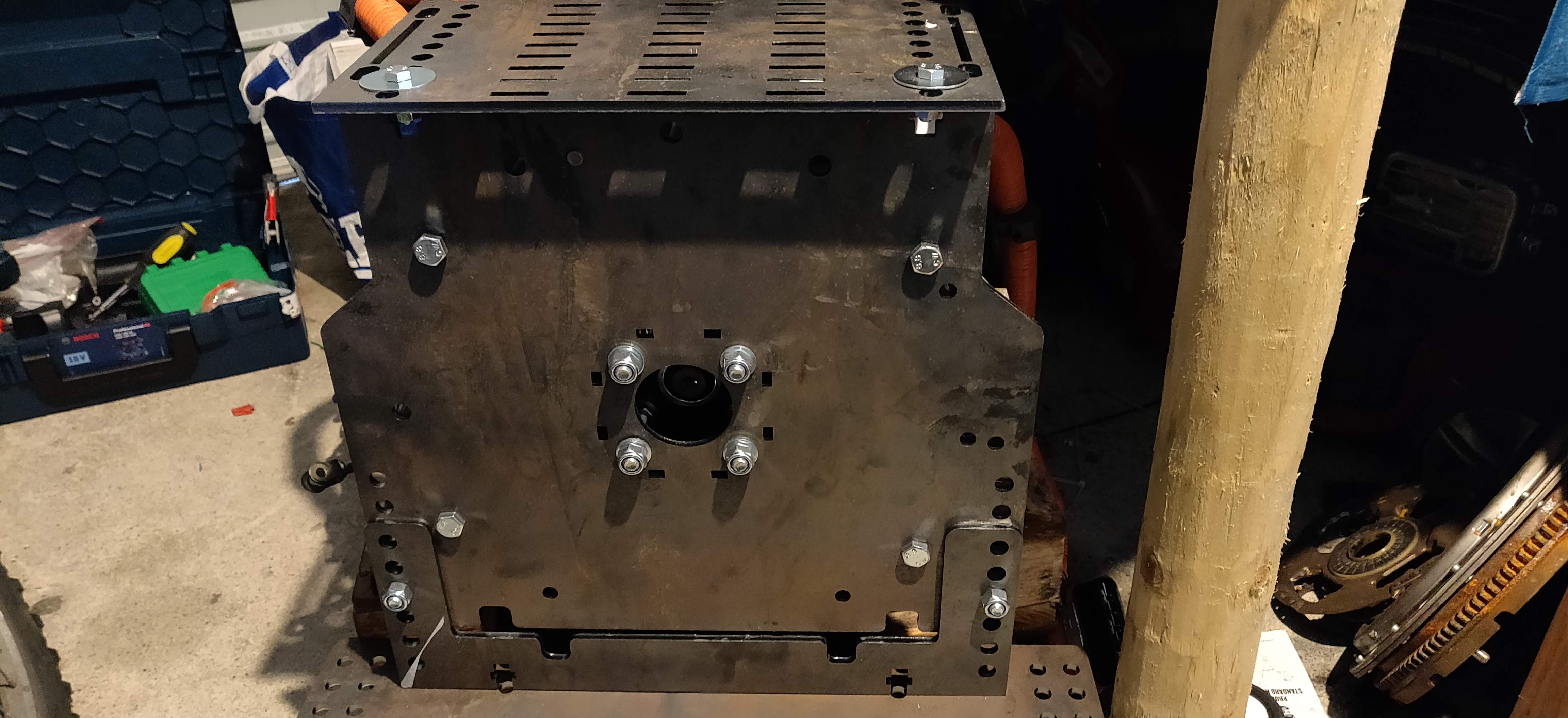

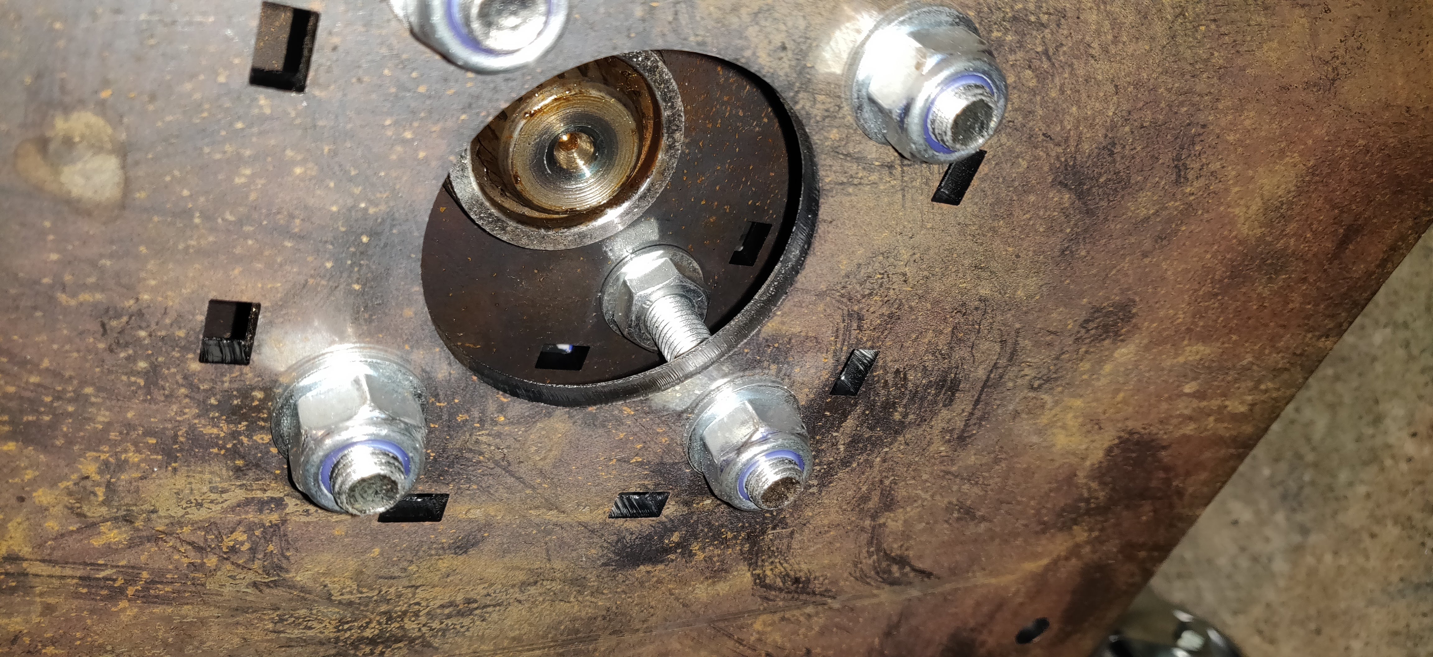

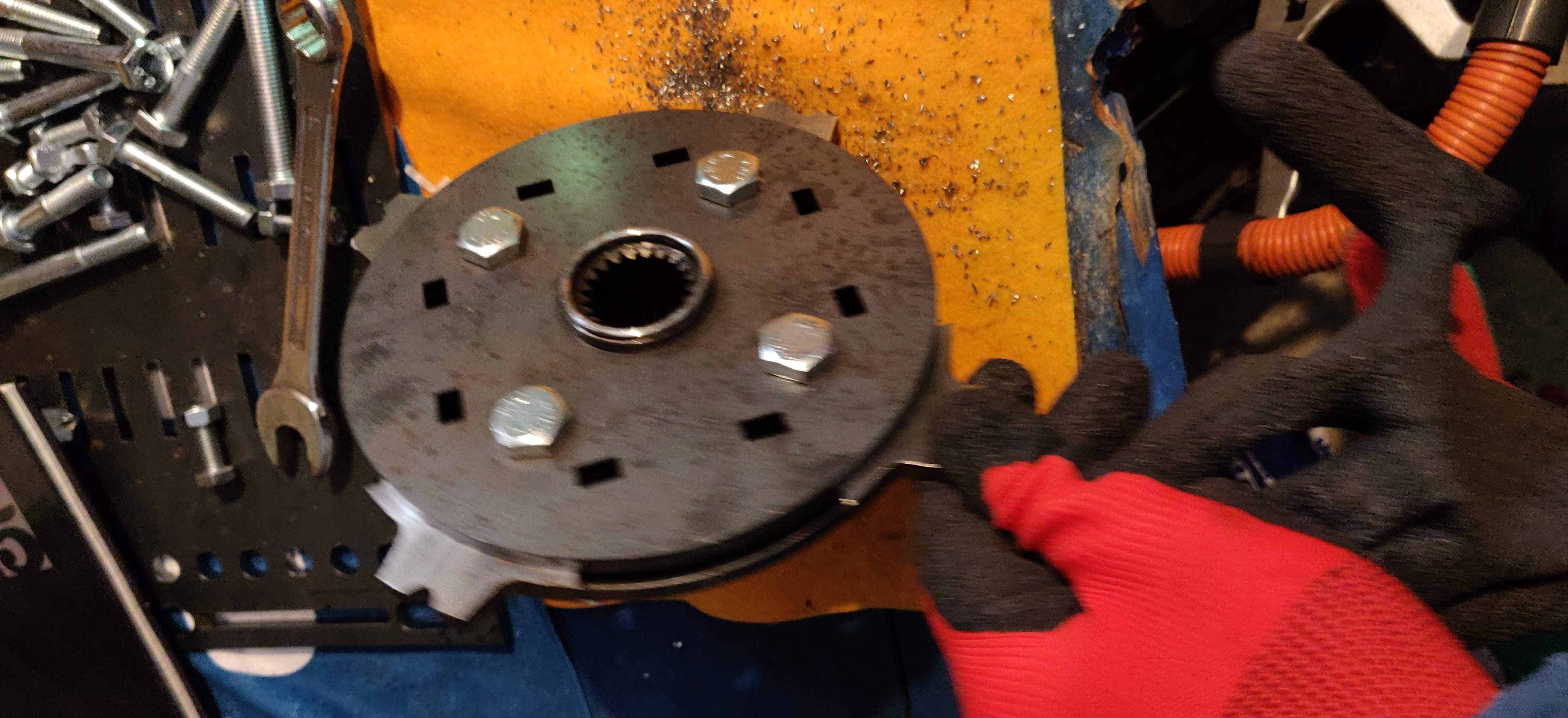

Some progress with the locking plate over the weekend. I got parts laser cut to reduce any welding. This will allow me to get everything in place and to test fitment before welding. The bracket that will sit on the sub-frame is also adjustable as I've yet to pull the engine. I got one of the inverter brackets wrong and I will need to redo it but everything else slotted together nicely.
I will share the CAD drawings if anyone wants them.

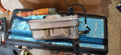

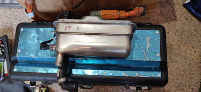

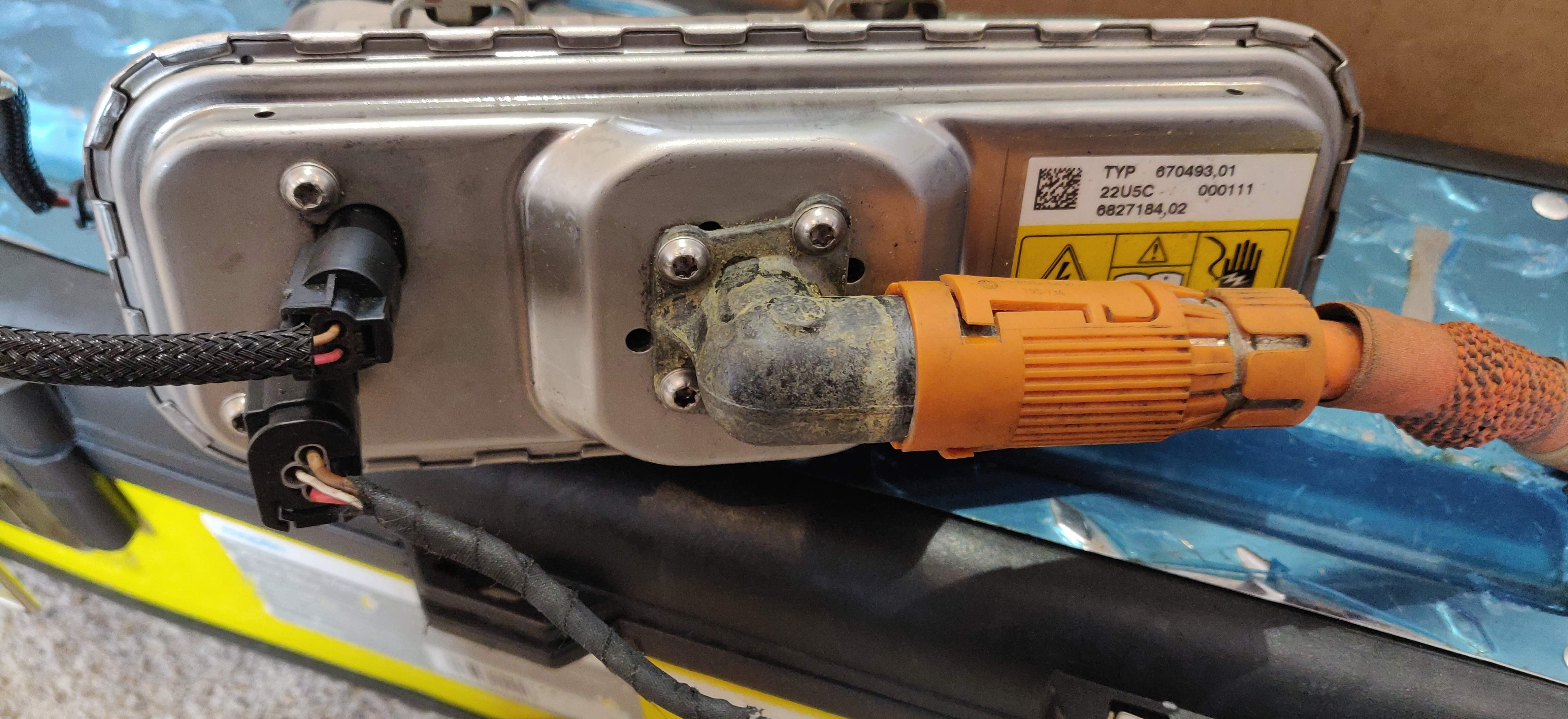

I got my hands on an electric liquid cabin heater from a BMW F30 330E. I think its around 5kW. No idea about wiring and control yet. HV positive and neutral are through the large orange cable. Its has a thermostat on the outlet pipe. A 3 cable (Brown, brown/red & brown/white) connector then on top which must be for control. Hoping it isn't CAN :lol: If the controls can be figured out then this should be a nice retrofit heater for conversions.

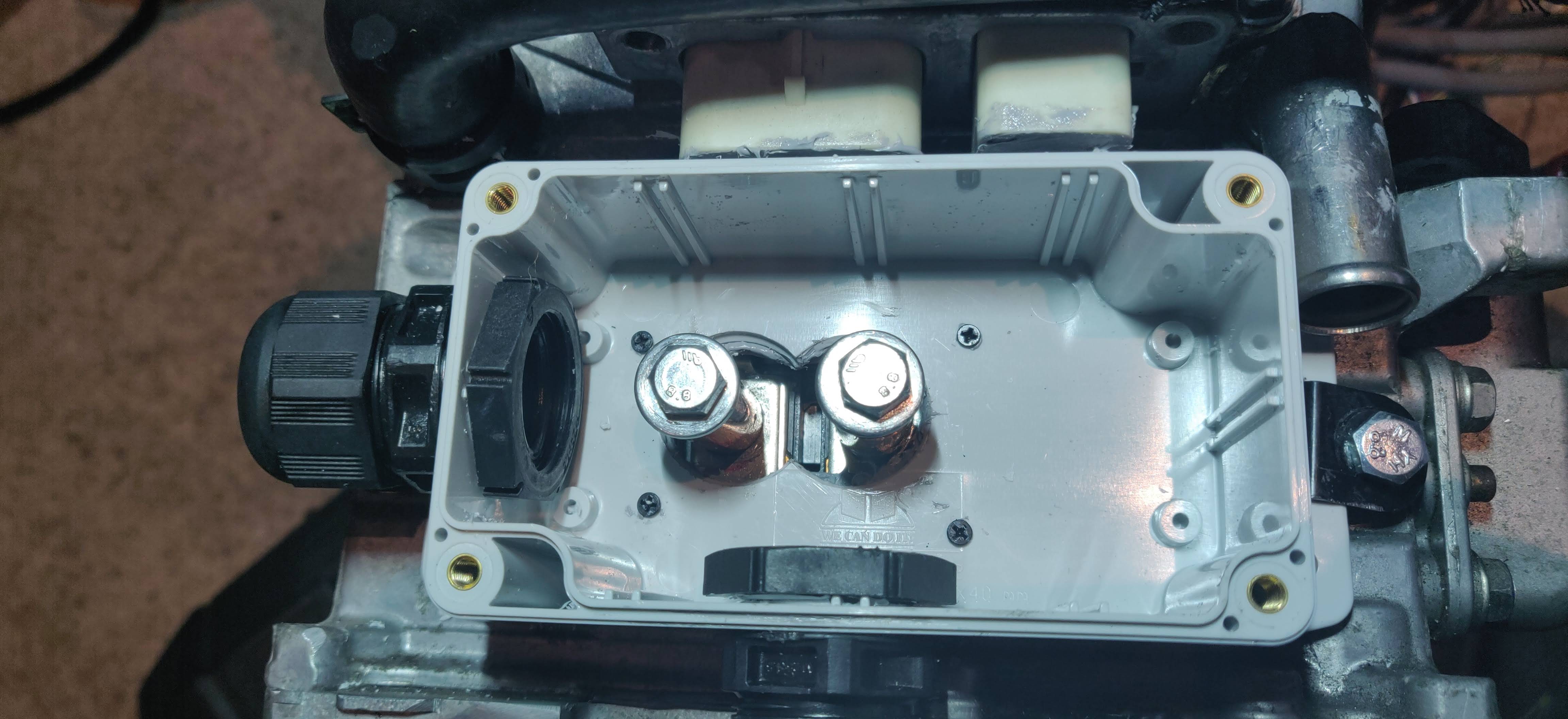

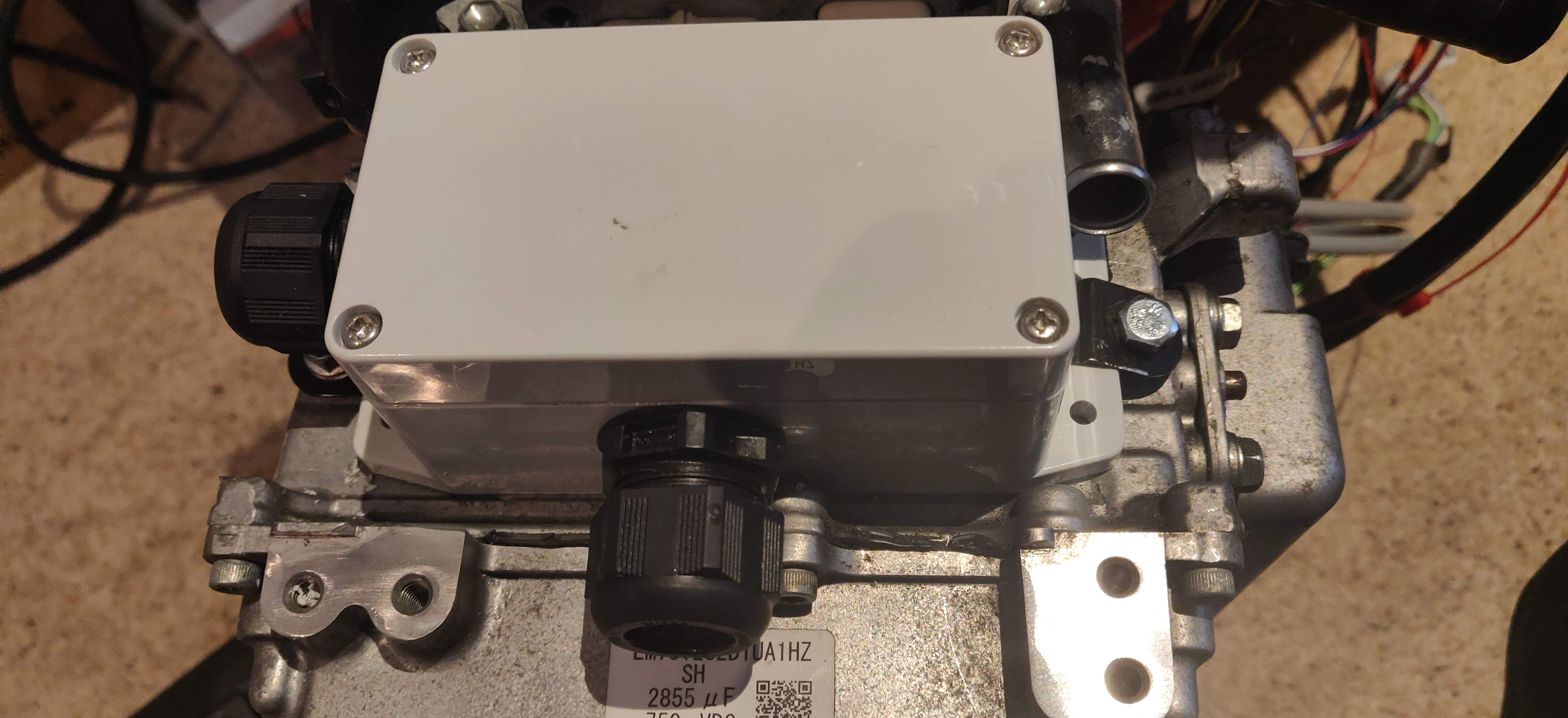

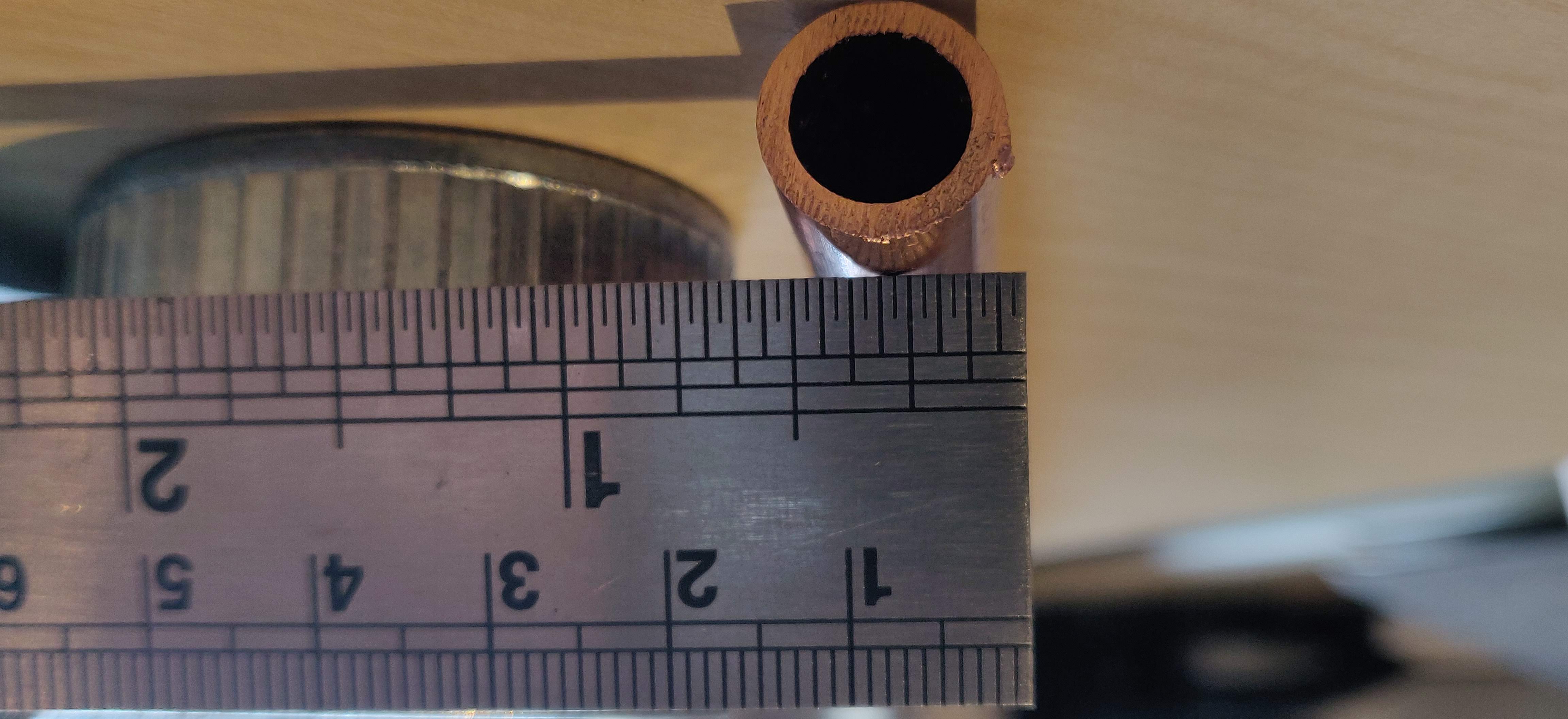

I manged to find an enclosure to fit over the HV connections. It a tight fit but the 50mm2 H07 cable/glands just fit. Sealed the box to inverter casing using Tec 7 sealer
I used thick wall copper boiler tube pipe as the standoffs. I did a quick CSA check and they should be sufficient.
Link to enclosure from Farnell , 55x115x65cm IP65 (before I drilled holes in it)

Clever HV connections scheme. Taking a note of this method!

I managed to figure out the selector if you still working on that, i can now wakeup, keep it stable and control which gear.
still got couple of hiccups to integrate with the main zombie code, slow but steady.

sheselectric wrote: Mon Mar 15, 2021 11:01 am I got my hands on an electric liquid cabin heater from a BMW F30 330E. I think its around 5kW. No idea about wiring and control yet. HV positive and neutral are through the large orange cable. Its has a thermostat on the outlet pipe. A 3 cable (Brown, brown/red & brown/white) connector then on top which must be for control. Hoping it isn't CAN :lol: If the controls can be figured out then this should be a nice retrofit heater for conversions.
nice find :) lucky for you its not canbus. but unlucky for you its linbus controlled :o iv got a bmw ac pump which also needs decoding so if you come across the lin data off a car with the heater or ac pump running would be very handy
