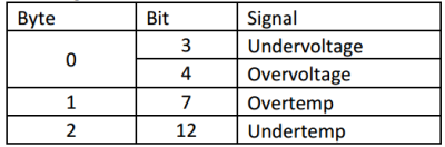

I'm interpreting CANbus data from my SimpBMS. The manual says that 0x35A Warning should send these Datas:
msg.id = 0x35A;
msg.len = 8;
msg.buf[0] = alarm[0];//High temp Low Voltage | High Voltage
msg.buf[1] = alarm[1]; // High Discharge Current | Low Temperature
msg.buf[2] = alarm[2]; //Internal Failure | High Charge current
msg.buf[3] = alarm[3];// Cell Imbalance
msg.buf[4] = warning[0];//High temp Low Voltage | High Voltage
msg.buf[5] = warning[1];// High Discharge Current | Low Temperature
msg.buf[6] = warning[2];//Internal Failure | High Charge current
msg.buf[7] = warning[3];// Cell Imbalance
Can0.write(msg);
What do I want to do? My Controller expects a LIMIT signal to reduce the output of the system if the BMS signals it has to reduce the discharge output.
My interpretation is that 'Undervoltage' and 'Overtemp' would be the correct Warning Signals to introduce a LIMIT mode of my motor controller. The difference between manual (0.29) and Code TESLABMSV2.ino makes me wonder if I'm correct. Can you answer this, please?
Best regards
Frank
PS: I wrote in another post that I want to rebuild the firmware for SimpBMS myself and modify the data send on Canbus. I skipped this idea and use the standard script for Tesla. A proxy Controller that I use to display information on the dashboard reads all information via Canbus from SimpBMS and finally send it in the required format to my Motor Controller.

Re: Simp BMS
Yes if you use the warning ones and not the alarm ones.
///warnings///
warning[0] = 0;
if (bms.getHighCellVolt() > (settings.OverVSetpoint - settings.WarnOff))
warning[0] = 0x04;
if (bms.getLowCellVolt() < (settings.UnderVSetpoint + settings.WarnOff))
warning[0] |= 0x10;
if (bms.getHighTemperature() > (settings.OverTSetpoint - settings.WarnToff))
warning[0] |= 0x40;
warning[1] = 0;
if (bms.getLowTemperature() < (settings.UnderTSetpoint + settings.WarnToff))
warning[1] = 0x01;
Re: Simp BMS
That was my approach. Maybe I should add LowTemperature for the Limit specification. But first: TEST.
Thank's a lot for your fast response, the complete definition for 0x35A and the corresponding code snippet.
Have a nice day!
Frank
