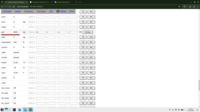

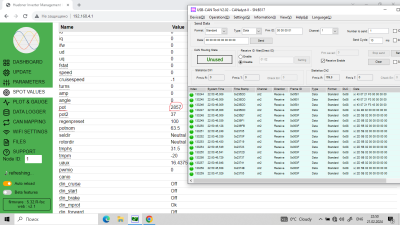

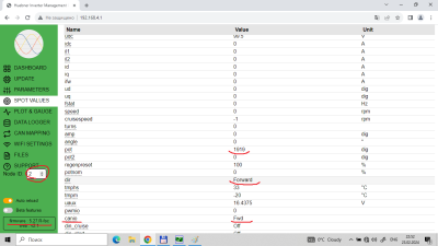

Re: Inverter Firmware 5.32.R
The "pot" and "pot2" parameters are not saved on both controllers (that is, Rx and Tx) after a power failure. Before the power is turned off, everything works and the slave controller receives messages identical to the master. Is this a feature of the firmware? Or am I doing something wrong? I haven't tried it since 27.
MG2
MG1
- Posts: 6759
- Has thanked: 383 times
- Been thanked: 1580 times
Indeed 5.32 removes any mapping from pot and pot2, even TX mapping. That should be changed. So 5.27 on both sides. You need to hit Save to Flash to make mappings permanent

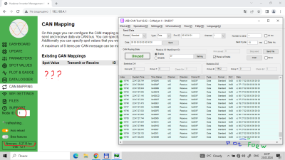

- Posts: 52
- Joined: Wed Feb 27, 2019 7:03 am
- Location: Belorussia. Borisov
- Has thanked: 16 times
Yes - everything works with the previous firmware. The settings are saved. MG 2 sends MG 1 receives But nothing is displayed in the CAN map. But this seems to be a problem in the web interface. In the old (gray) mode, all CAN data is visible.
