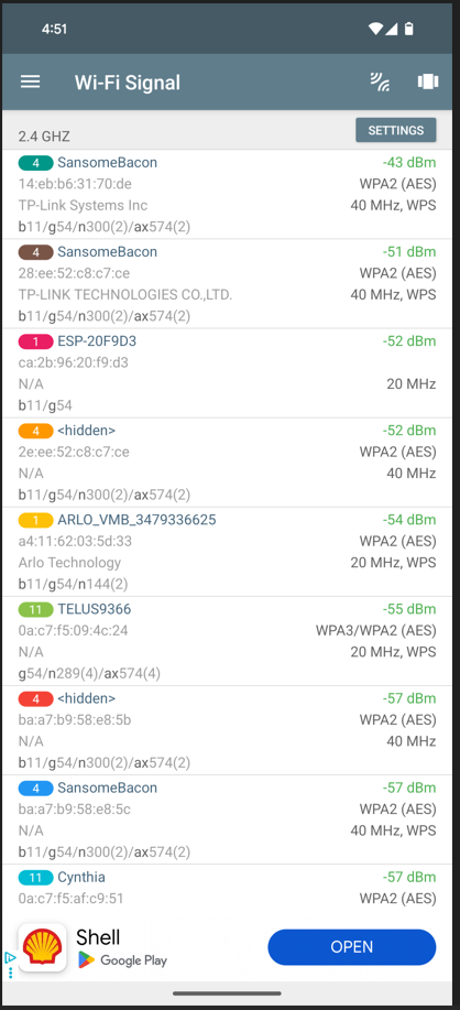

Issue:
After connecting to the ESP8266 through the web interface I get the error "Connection problem between ESP and STM".

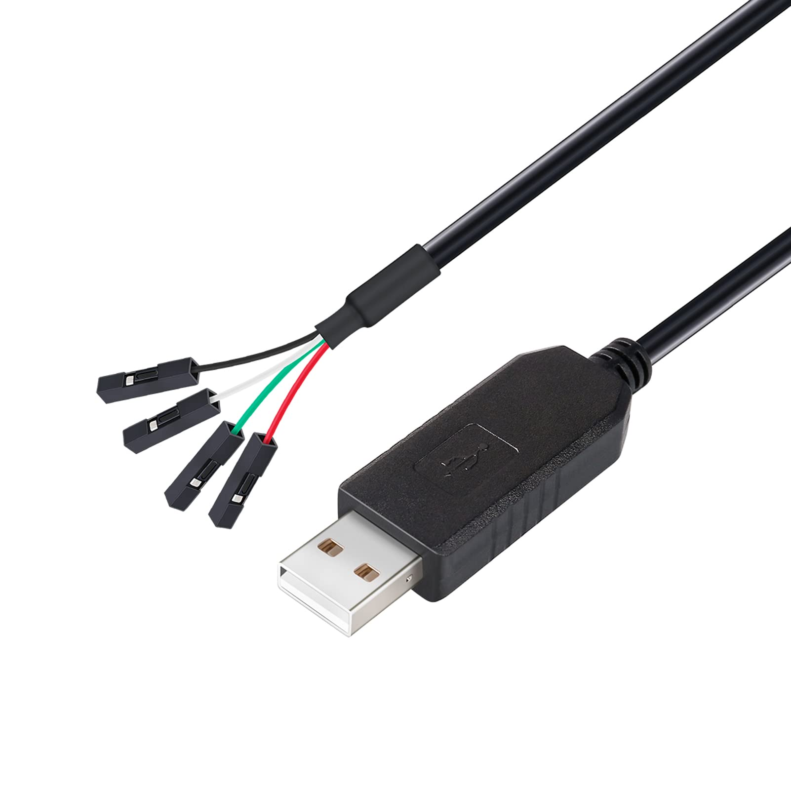

Have you got one of these?
Then open a terminal program on your computer with a speed of 115200 baud and at the prompt type
and enter.
What do you see?
Connect the black cable to GND, green and white to rx and tx (of course I don't know which way around).Then open a terminal program on your computer with a speed of 115200 baud and at the prompt type
json
What do you see?

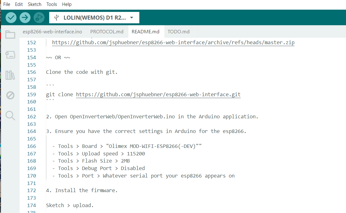

The new Wemos D1 Mini boards arrived. I uploaded the interface to one, soldered the pins on, and plugged it into the zombieverter. First try it connected and everything is up and running. Installed it into its enclosure and it's working great!
Solution: Buy and program a new wemos D1 mini because the original was being funky
Thank you very much for your help!
