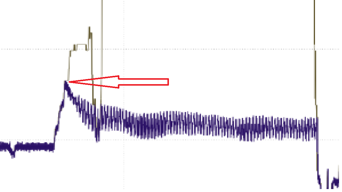

Re: Zombieverter Nissan Leaf 160kW
Reveiwing the CAN log with a Leaf ZE1 dbc.
You can see we request more torque yet the inverter refuses to give it to us.
The battery info reported during the run.
As you can see we are just maxing out the inverter. The average power of the two flat bits are 150-160kw give or take
One option to try, increase the power limit in message 0x1DC slightly if you are confident nothing in the battery setup gets hot.
It is possible the inverter will draw more, or it will also have its own internal limit.
