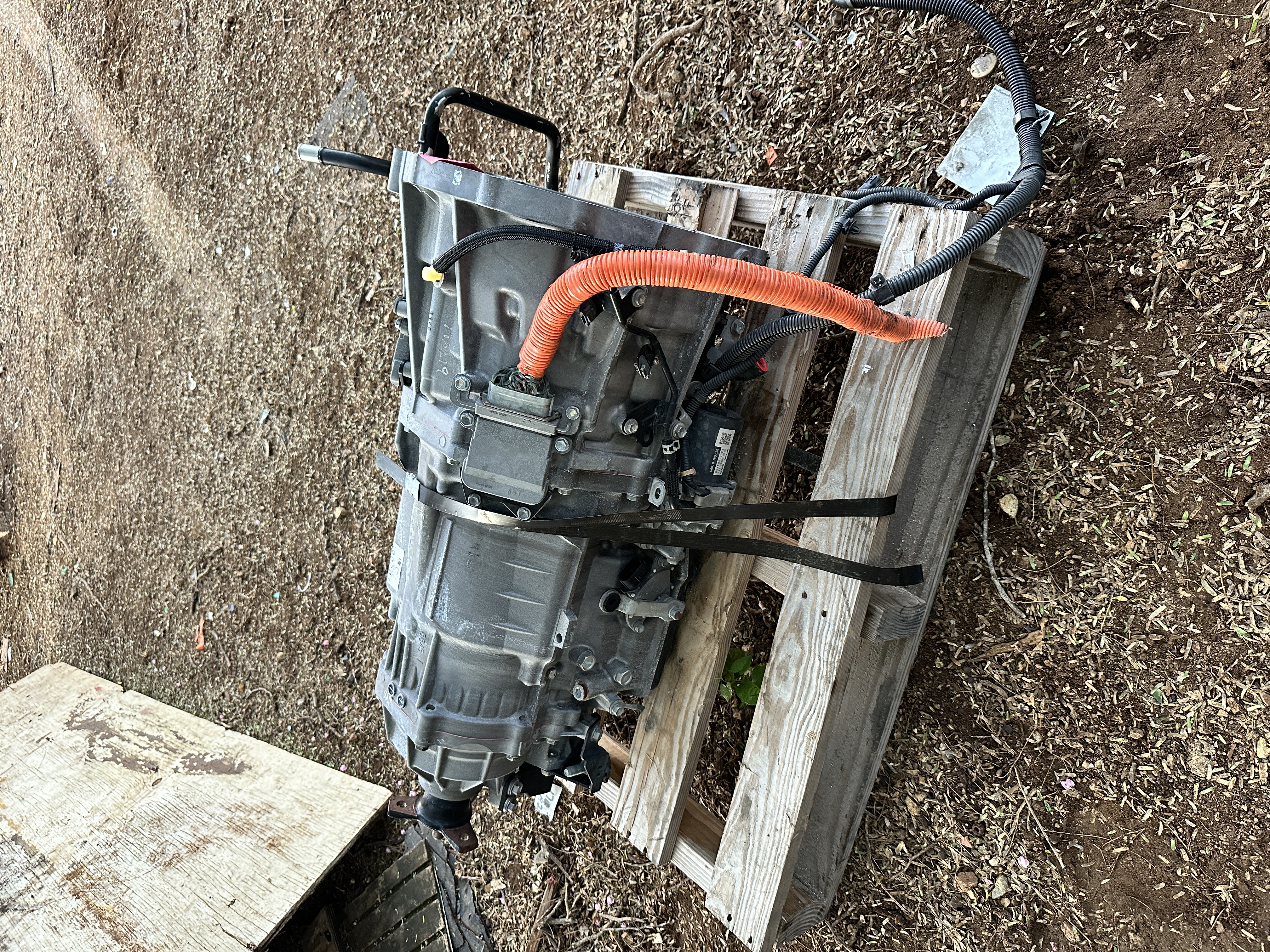

Finally received my GS450H.
came i good conditions. high voltage cables missing.
oil pump attached!!!!
now its time to find the low voltage connectors... then hook it up to my Camry inverter with fingers crossed.

I did some bench testing today (more like pallet and floor testing). at 130vdc
i got MG2 running with the camry inverter, runs good is in forward. but really slow i reserve. when i apply more throttle in reverse it stops/
when i tried MG1, it runs good in fwd and reverse but with the input shaft locked, the output spins in the opposite direction compared to MG2.
tmpm and tmphs never went above 35 degrees C while testing.
i notice when i run MG2 in forward direction the speed in the spot valus reads negative rpms ...like -800 rpm
after a while i hear weird "klonks" in the gearbox when i spin MG2.
also when i pulse the start pin on the zombie, i get inverter whining as it should. but then i press throttle, motor spins but keeps spinning even when i let go.
in the video below you can see my setup. 130vdc going to the inverter. VCU connected to the inverter via toyota CSI (htm mth rep clk).
temp sensors, prius throttle, d/r to the vcu
i did not connect the transmission solenoids while testing.
in the video below you can see the gs450h spinning but not stopping even with no throttle input. i had to remove T15 from 12V to make it stop. if i start the invertere before the gearbox spins down to a stop, it will keep on spinning again.

Hi there,
i need some advice according to the pictuer below.
i watched a couples videos on GS450H bench testing. in Drive mode, the all spin counter clockwise (looking a the output shaft, so POV is behing the transmission). but in my case, to drive the wheels forward, i need to spin the shaft the other way around.
can the GS450h be driven in either direction ?
any advice is appreciated. TIA
