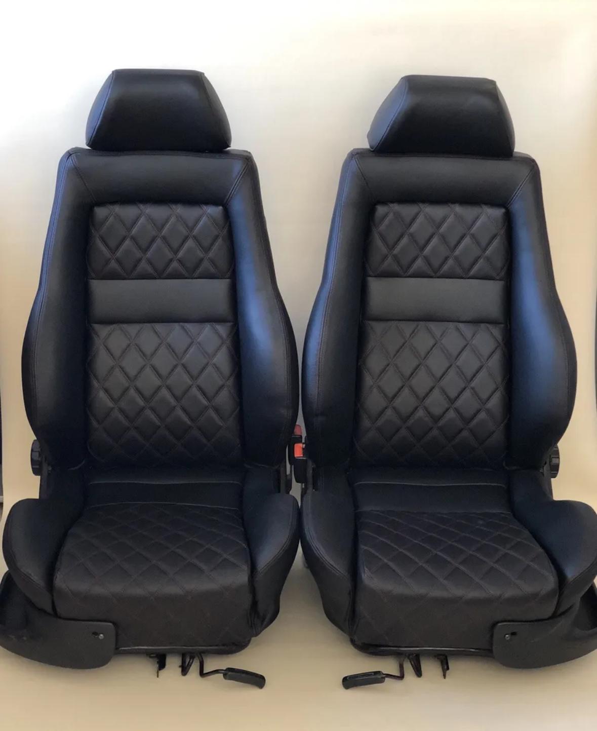

Desinged a frame for esp32 display (lvgl, can, esp, touch display) Original plan to have Golf GTI seats did not happen, as seller couldn't find the seats. So plan B, BMW 2-series (G42) alcantara sport seats. This simple seat replacement accumulated way bigger project, as original seats sit high on top of transmission tunnel but new seats need to go to bottom. So first the tunnel was cut a bit, then bit more.. until we realized that they don't sit straight in front of steering wheel.. So need to cut more.. and eventually, whole floor was completely removed and made a new one to make the seats align and sit low enough properly
