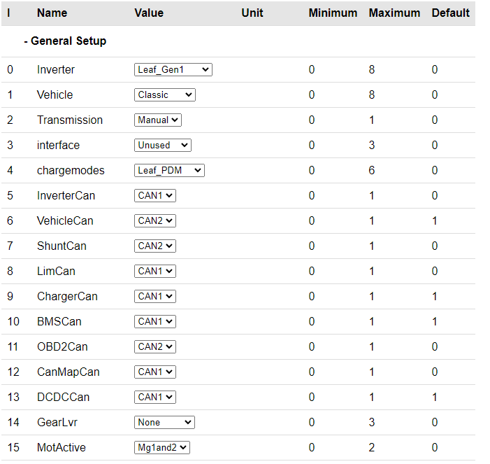

Sector7e wrote: Sat Aug 10, 2024 11:44 pm I have the Hardbody moving reliably, but I can't seem to get it to charge. The Zombieverter will show it is in charge mode, but doesn't start charging. I'm currently using a 24kwh leaf pack at 43% SOH.
I'm attaching the Zombieverter settings in a PDF to see if I have an incorrect setting that may be causing this: Huebner Inverter Management Console.pdf

Could you tell me how you exported a copy of your Zombie setpoints and spot values as a pdf please. I have looked every2here but cant find how to do it. I have tried hitting the “Submit parameters to openinverter” button, but it just sits there spinning its wheels and nothing seems to happen. I would
I would like to do the same so I can post a copy of my settings on my support request. I am talking to my Zombie with my ipad, so not sure if that affectsthe abilty to export to a pdf

Iceman96 wrote: Wed Aug 21, 2024 1:23 am I would like to do the same so I can post a copy of my settings on my support request. I am talking to my Zombie with my ipad, so not sure if that affectsthe abilty to export to a pdf
Cheers - Andrew
https://openinverter.org/wiki/Web_Interface
The heading Parameters in the wiki. It is as simple as clicking Download Parameter File on the web interface :) .

On my PC I highlighted the parameters in the browser, opened the print dialog, and printer only the selection to a PDF file. I'm not sure that will be easy on iOS.

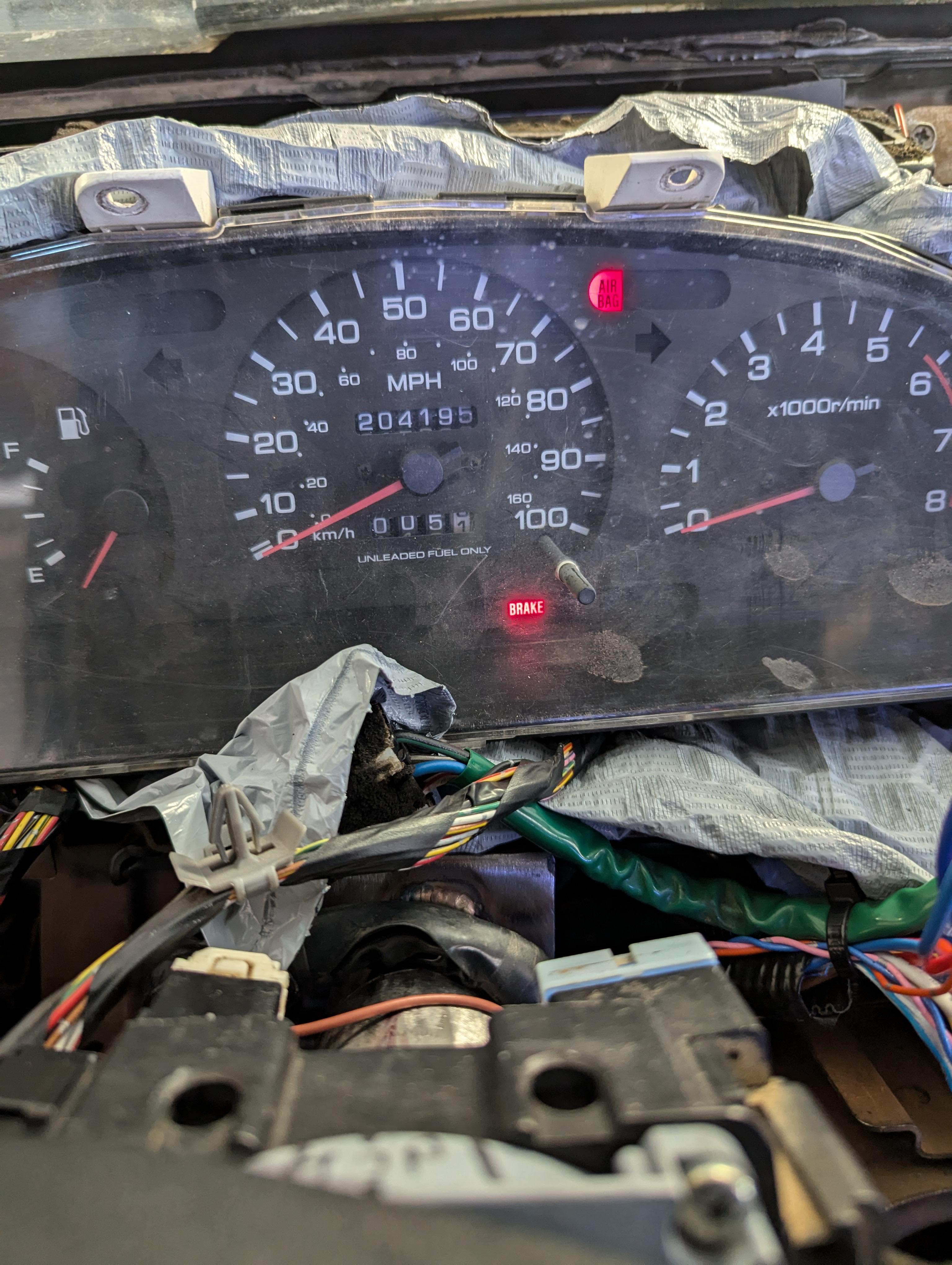

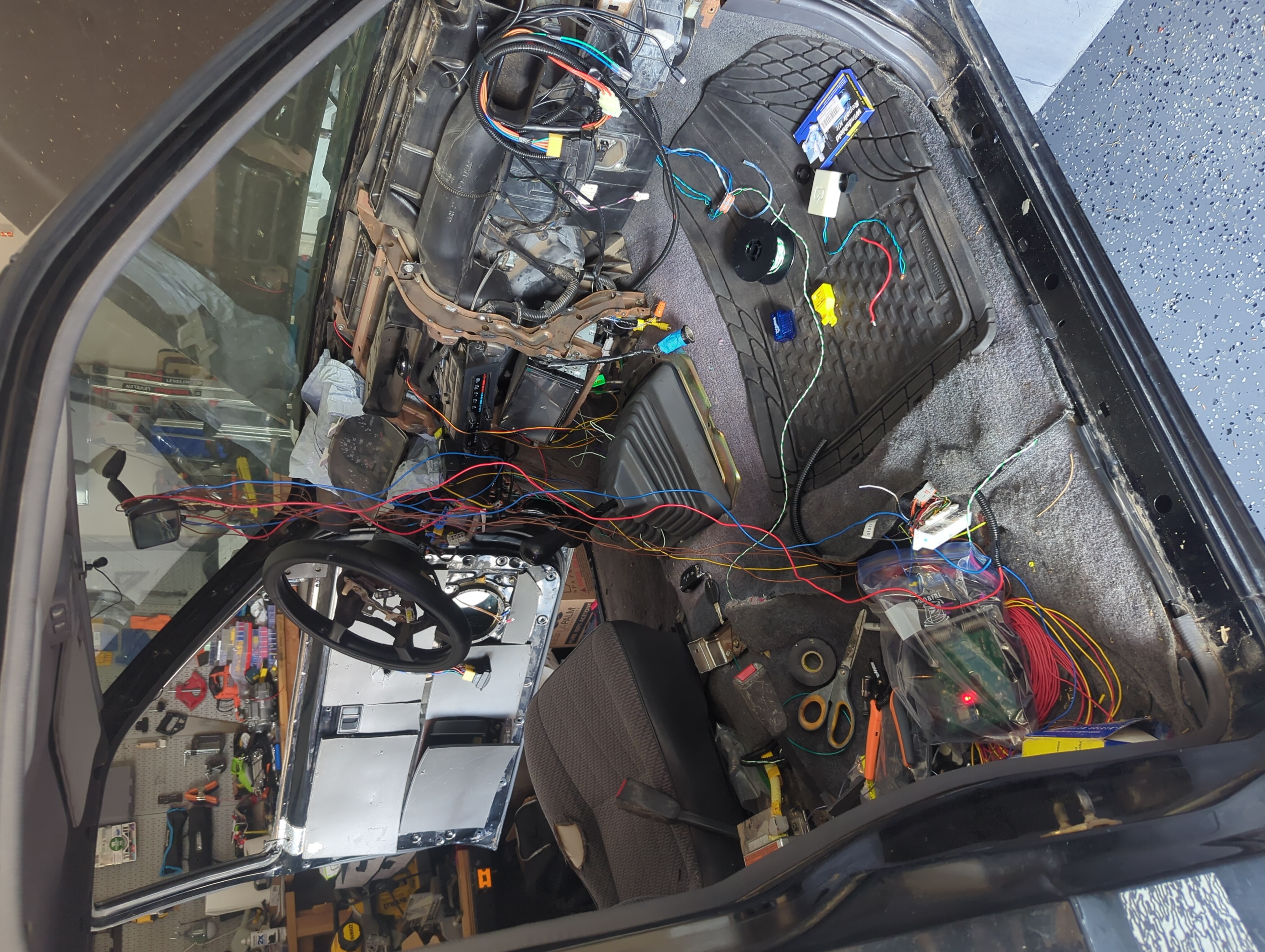

I finally got the Nissan to charge with the Leaf PDM with the help of J0hannes. He kindly provided me with his fork of the ZOmbieverter code for testing. I took the Nissan for a 5 mile trip to the gas station for snacks, and the only issue I noticed is a drive shaft vibration.
The speedo works!!! I added first 5 EV miles to the odometer. 🥳
Before I loomed the wires in the cabin
After looming most of the wires

"regenBrake": -10,
"regenramp": 100,
"potmode": 1,
"dirmode": 1,
"reversemotor": 0,
"throtramp": 100,
"throtramprpm": 20000,
"revlim": 8000,
"revRegen": 0,
"udcmin": 280,
"udclim": 403,
"idcmax": 200,
"idcmin": -100,
"tmphsmax": 85,
"tmpmmax": 300,
"throtmax": 100,
"throtmin": -100,
"throtmaxRev": 30,
"throtdead": 10,
"RegenBrakeLight": -15,
"throtrpmfilt": 15,
"Gear": 1,
"OilPump": 50,
"cruisestep": 200,
"cruiseramp": 20,
"regenlevel": 2,
"udcsw": 356,
"cruiselight": 0,
"errlights": 0,
"CAN3Speed": 0,
"BattCap": 24,
"Voltspnt": 403,
"Pwrspnt": 6600,
"IdcTerm": 0,
"CCS_ICmd": 0,
"CCS_ILim": 100,
"CCS_SOCLim": 100,
"SOCFC": 50,
"Chgctrl": 0,
"ChgAcVolt": 120,
"ChgEff": 90,
"ConfigFocci": 0,
"DCdc_Type": 0,
"DCSetPnt": 14,
"BMS_Timeout": 10,
"BMS_VminLimit": 3,
"BMS_VmaxLimit": 4.18,
"BMS_TminLimit": 5,
"BMS_TmaxLimit": 50,
"Heater": 0,
"Control": 0,
"HeatPwr": 0,
"HeatPercnt": 0,
"Set_Day": 0,
"Set_Hour": 0,
"Set_Min": 0,
"Set_Sec": 0,
"Chg_Hrs": 0,
"Chg_Min": 0,
"Chg_Dur": 0,
"Pre_Hrs": 0,
"Pre_Min": 0,
"Pre_Dur": 0,
"PumpPWM": 1,
"Out1Func": 6,
"Out2Func": 7,
"Out3Func": 3,
"SL1Func": 0,
"SL2Func": 0,
"PWM1Func": 0,
"PWM2Func": 4,
"PWM3Func": 2,
"GP12VInFunc": 12,
"HVReqFunc": 11,
"PB1InFunc": 12,
"PB2InFunc": 12,
"PB3InFunc": 12,
"GPA1Func": 0,
"GPA2Func": 0,
"ppthresh": 2500,
"BrkVacThresh": 2500,
"BrkVacHyst": 2500,
"DigiPot1Step": 0,
"DigiPot2Step": 0,
"FanTemp": 40,
"TachoPPR": 2,
"IsaInit": 0,
"Tim3_Presc": 719,
"Tim3_Period": 7200,
"Tim3_1_OC": 3600,
"Tim3_2_OC": 3600,
"Tim3_3_OC": 3600,
"CP_PWM": 10

Re: [Driving] 1996 Nissan D21 Hardbody 4x4 Leaf Swap
Sector7e wrote: Sat Dec 07, 2024 7:08 pm I'm only revving it in neutral to show the issue in a safe way. The vehicle does the same thing in gear, but violently shakes the truck.
You should have made that clear. So when driving it slows to near zero the it shakes violently?
Change the "regenramp": 100 this is very high. same goes for your throtramp.
You can also try increasing regenendrpm to 200 or higher.
Sector7e
Posts: 49
Joined: Sat May 20, 2023 3:09 am
Has thanked: 47 times
Been thanked: 25 times
Post by Sector7e »
tom91 wrote: Sat Dec 07, 2024 7:09 pm You should have made that clear. So when driving it slows to near zero the it shakes violently?
Tom,
So I was able to make it stop. It seems like the FS5W71C 5 speed transmission is causing some sort of confusion with the regen with the slack that exists within the transmission. Maybe the input shaft of the transmission is bouncing back and forth with the Leaf output shaft causing the regen to think the Leaf motor is still accelerating, and tries to kick in the regen? I tried the following and the bouncing(is this what you would call it? Or maybe osculation?) still continued:
regenramp: 80,40, 20, 1
regenendrpm 200, 300, 600
The bouncing immediately stopped when I changed regenbrake and regenmax to 0.
Tom, are there any parameters you would like me to try or anything that would help in finding the reason my vehicle configuration is causing this problem?
Posts: 2460
Location: Bristol
Has thanked: 216 times
Been thanked: 606 times
https://github.com/damienmaguire/Stm32- ... _220a.json
Here are damiens params. Damien does not run any pedal regen on his leaf setup in his BMW E46
https://github.com/damienmaguire/Stm32- ... k220a.json
Here are the truck params
