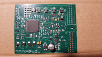

New batch of V2 controllers has arrived from JLCPCB. This batch have the SAM3 processor fitted:)
Jack Bauer wrote: ↑Wed Mar 04, 2020 5:56 pm New batch of V2 controllers has arrived from JLCPCB. This batch have the SAM3 processor fitted:)
Looks like my wallet is about to get a little bit lighter.
How are you selling these new ones? Partially assembled or fully tested?

I purchased and built a v2 vcu for the GS450h inverter. Could someone please tell me whether I need to provide 12v constant power to the board when flashing firmware to it? Or do I just simply connect the board to my pc via the onboard usb jack? If someone could provide instructions for flashing firmware to a new vcu, I would appreciate it. Thanks!

Looking at the schematic, the USB port provides +5v to the circuit, so you should be fine with that.
