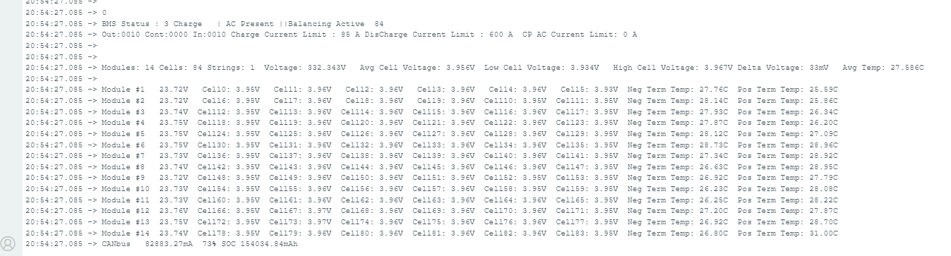

As I continue my fast charging tests, would you say it is expected for the most positive module to be the hottest?
All in series. 1 most negative, 14 most positive.
After charging from 53% to 73%, starting at 125A, but gradually reduced to 85A by the BMS.

alexbeatle wrote: Mon Nov 04, 2024 5:26 am As I continue my fast charging tests, would you say it is expected for the most positive module to be the hottest?
There is some thing strange going on, on your final module the delta across the module is the largest. Is the cable used there properly fastened?
Due to the way the ribbons run and where the temp sensors are, the temperatures are quite effected by the HV connection to the modules busbars.

tom91 wrote: Mon Nov 04, 2024 2:30 pm There is some thing strange going on, on your final module the delta across the module is the largest. Is the cable used there properly fastened?
Thank you. I'd say the connection looks good. That was my first check.
As part of this fast charging test I was aiming for 80% SOC, so this is the first time I've reached balancing levels >3.9V/cell with higher charging current.
So balancing was activated as seen on the snapshot. 14 Tesla 5.3kWh modules (74p6s) = 84 series strings, also seen on the snapshot - so all discovered. Unfortunately, I lost the logs this time, but I do recall my dashboard display reading cellbal.val=82 from bms.
Does that mean we're balancing all but last 2 strings of cells, which incidentally fall into the last module?
I assume, Tesla modules passively balance, by wasting the charging/discharging current via balance resistors (heat) on the cells that need no balancing.

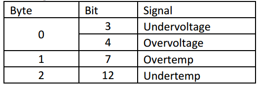

I'm interpreting CANbus data from my SimpBMS. The manual says that 0x35A Warning should send these Datas:
But in the TESLABMSV2.ino project I found a more complex definition, that maybe is related to a Victron system I didn't use:
msg.id = 0x35A;
msg.len = 8;
msg.buf[0] = alarm[0];//High temp Low Voltage | High Voltage
msg.buf[1] = alarm[1]; // High Discharge Current | Low Temperature
msg.buf[2] = alarm[2]; //Internal Failure | High Charge current
msg.buf[3] = alarm[3];// Cell Imbalance
msg.buf[4] = warning[0];//High temp Low Voltage | High Voltage
msg.buf[5] = warning[1];// High Discharge Current | Low Temperature
msg.buf[6] = warning[2];//Internal Failure | High Charge current
msg.buf[7] = warning[3];// Cell Imbalance
Can0.write(msg);
What do I want to do? My Controller expects a LIMIT signal to reduce the output of the system if the BMS signals it has to reduce the discharge output.
My interpretation is that 'Undervoltage' and 'Overtemp' would be the correct Warning Signals to introduce a LIMIT mode of my motor controller. The difference between manual (0.29) and Code TESLABMSV2.ino makes me wonder if I'm correct. Can you answer this, please?
Best regards
Frank

X19e wrote: Tue Feb 25, 2025 9:53 am My interpretation is that 'Undervoltage' and 'Overtemp' would be the correct Warning Signals
Yes if you use the warning ones and not the alarm ones.
///warnings///
  warning[0] = 0;
  if (bms.getHighCellVolt() > (settings.OverVSetpoint - settings.WarnOff))
    warning[0] = 0x04;
  if (bms.getLowCellVolt() < (settings.UnderVSetpoint + settings.WarnOff))
    warning[0] |= 0x10;
  if (bms.getHighTemperature() > (settings.OverTSetpoint - settings.WarnToff))
    warning[0] |= 0x40;
  warning[1] = 0;
  if (bms.getLowTemperature() < (settings.UnderTSetpoint + settings.WarnToff))
    warning[1] = 0x01;

tom91 wrote: Tue Feb 25, 2025 11:34 am Yes if you use the warning ones and not the alarm ones.
That was my approach. Maybe I should add LowTemperature for the Limit specification. But first: TEST.
Thank's a lot for your fast response, the complete definition for 0x35A and the corresponding code snippet.
Have a nice day!
