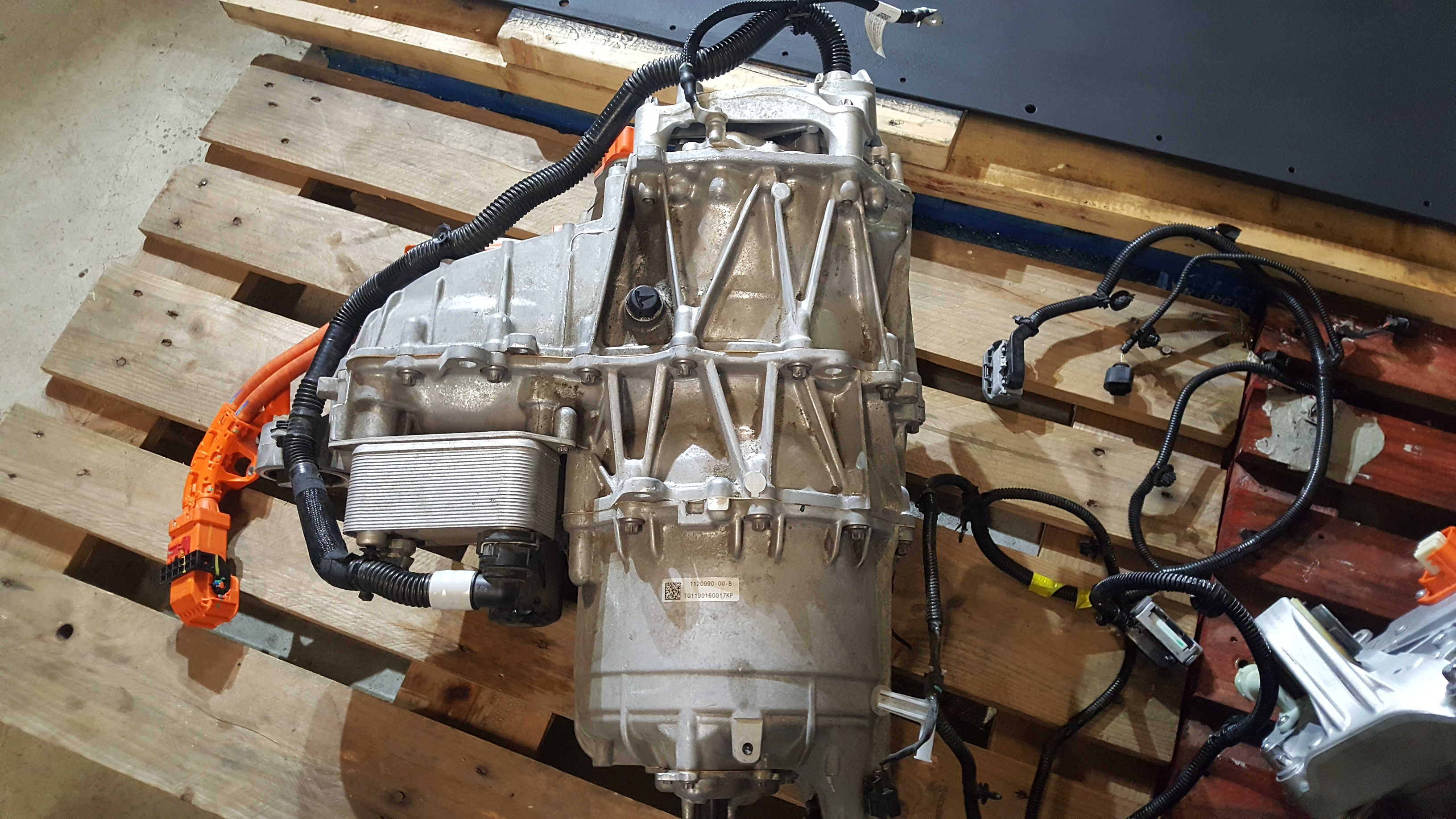

Setting up a thread to document the reverse engineering of the Model 3 rear drive unit. The specimen is from a European 2019 car with just over 20k km on the clock.
Initial observation is the motor exhibits cogging on initial turn but very little while turning via the drive shafts. The plan will be in two parts :
1)Remove inverter and run the motor with a prius inverter so we can learn how to control it with the Openinverter system.
2)Reverse engineering the Tesla inverter to allow use with an open source logic board.

Weigh in for the rear drive unit.

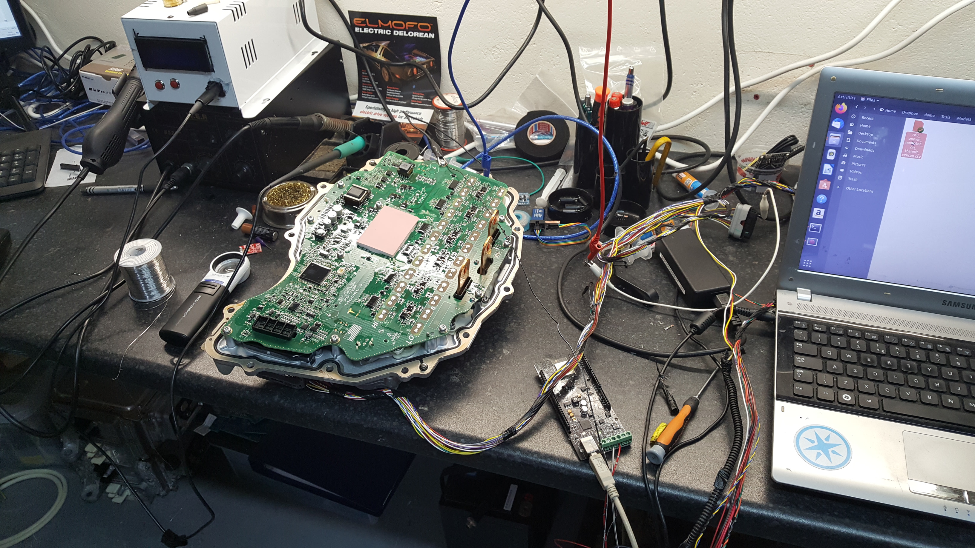

So, first power up of the M3 rdu inverter on the bench. Elon flashed some nice coloured leds at me and pumped out massive amounts of CAN on TWO busses. I took a sample for posterity. Up on the github repo for the can hackers :)
https://github.com/damienmaguire/Tesla- ... Drive-Unit

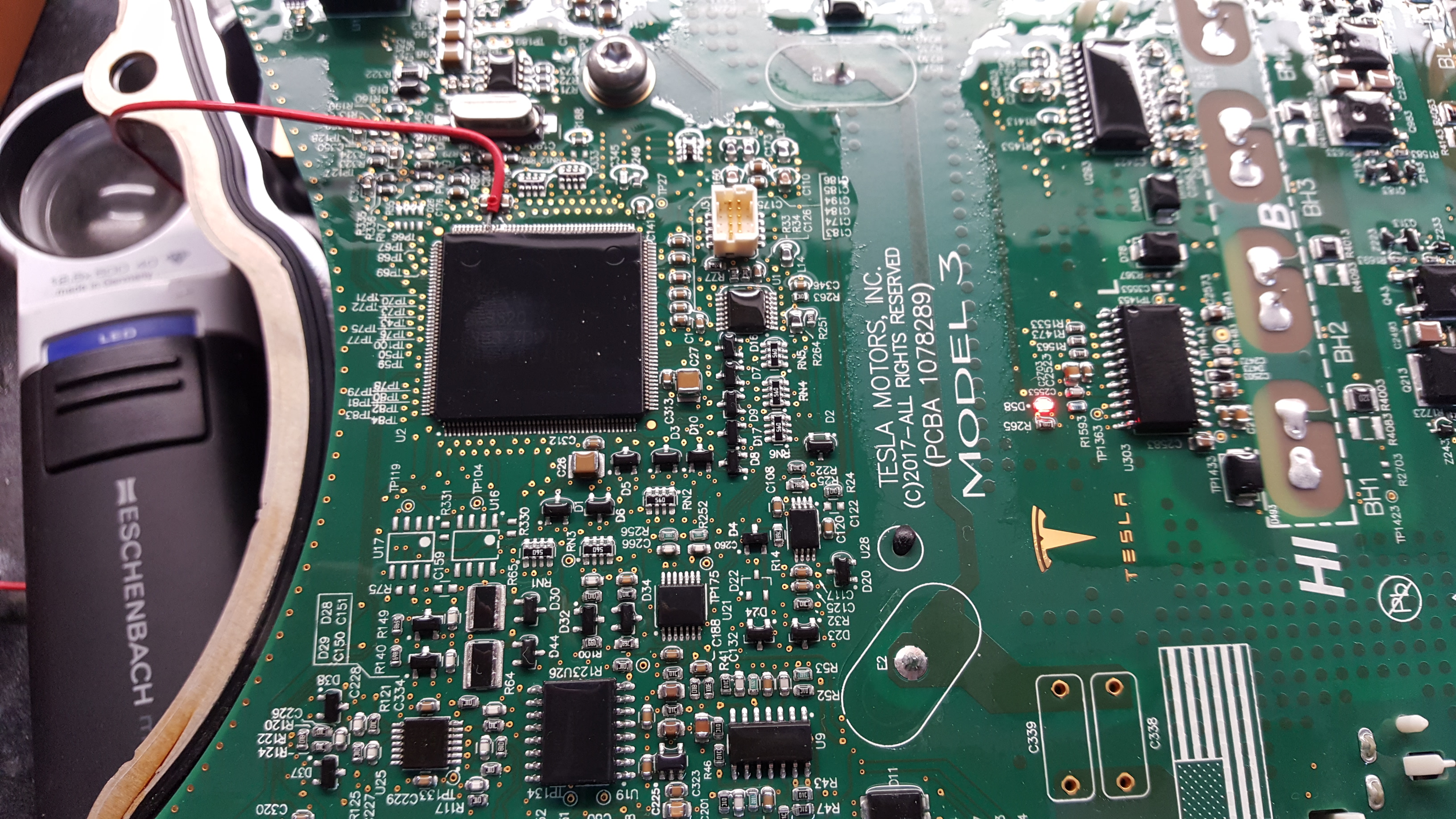

Now we can start the real hacking. Phase one : eliminate the musk, eliminate the problem.
Pin 124 of the TMS main processor is the reset pin called XRS. Pulling that to ground puts Elon asleep and leaves everything else up and running. Easy pickings for the upcoming HubenAtor XM-3000 modchip:)

Anyone find a high res shot of the rear of the board? I'm getting a feeling old Elon is using bootstrap gate drivers:)
Posts: 3663
Has thanked: 11 times
Been thanked: 344 times
Yep. D421,D422and D423. High side bootstrap diodes:)
