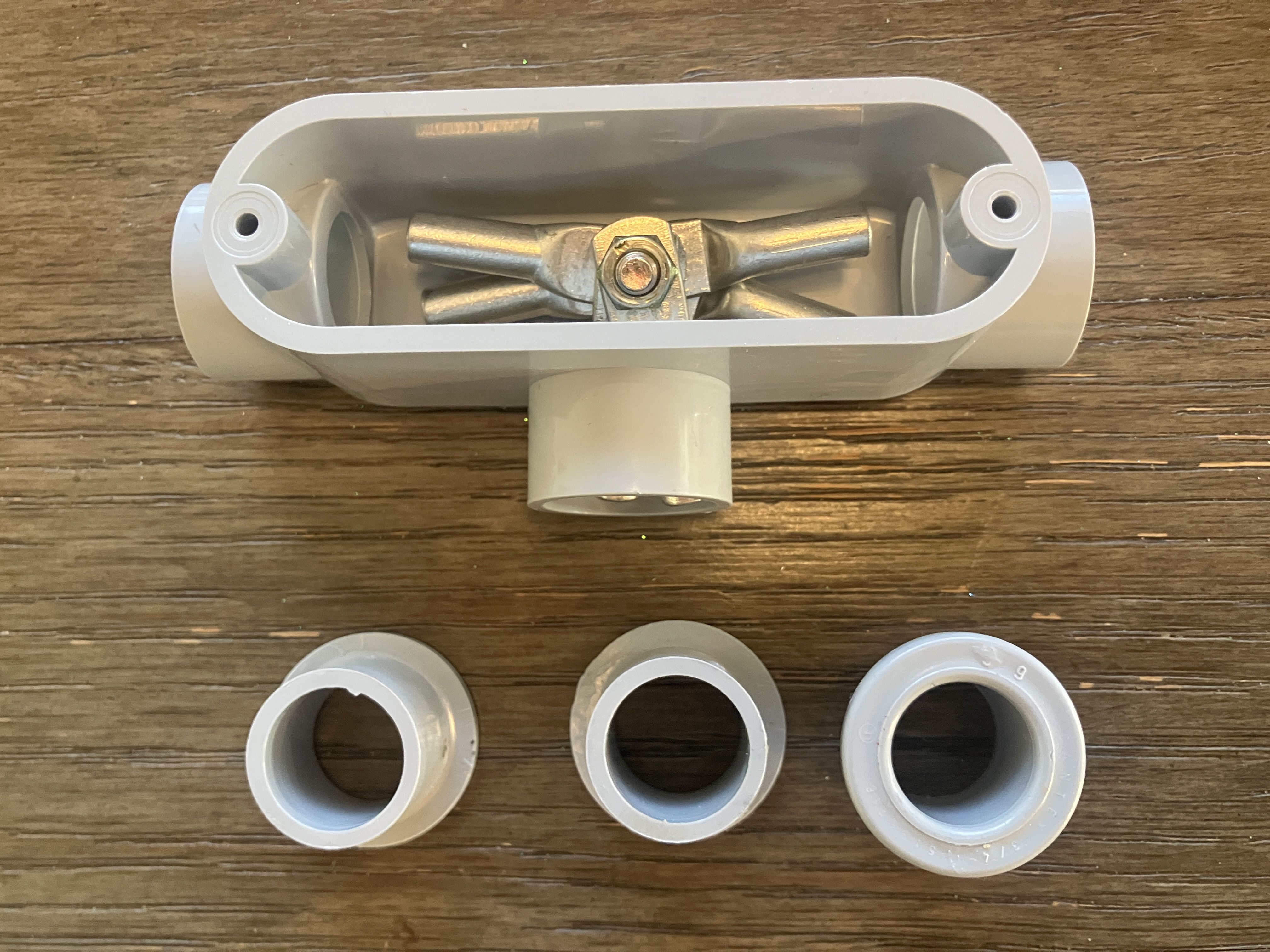

then it was off to Home Depot to think on how I was going to connect the two negative battery pack cables into one input terminal on the BMW Safety Box
hmmm I wonder if these T Type Conduit can do it (see what I did there?)
not knowing which one would be more better I procured them both and proceeded to the Goldilocks phase of the project

things escalated quickly as they often do
Gregski
Posts: 3158
Has thanked: 630 times
Been thanked: 1607 times
Post by Gregski »
but soon order was restored, and here's the general idea
these be just reducers to make for a tighter hole opening for the orange cables to fit snugger and maybe even water tight, I plan to glue them in with the special rubber cement for gray plastics
Gregski
Posts: 3158
Post by Gregski »
I stir up some controversy and prove it takes a village to help this fool with a tool get through the next phase of this project in this video...
gentlemen I am extremely proud of this Negative Lead T Connection so please precipitate on my parade lightly
