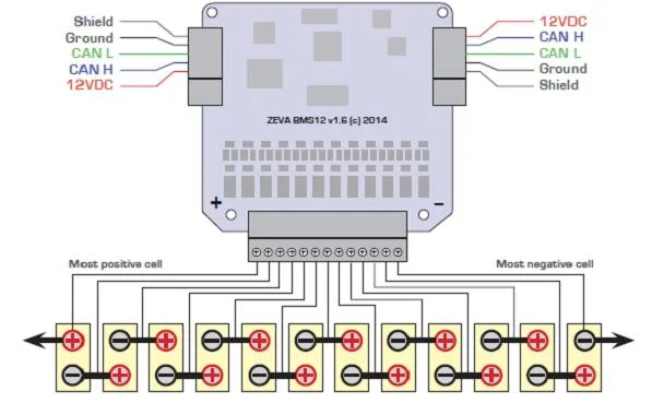

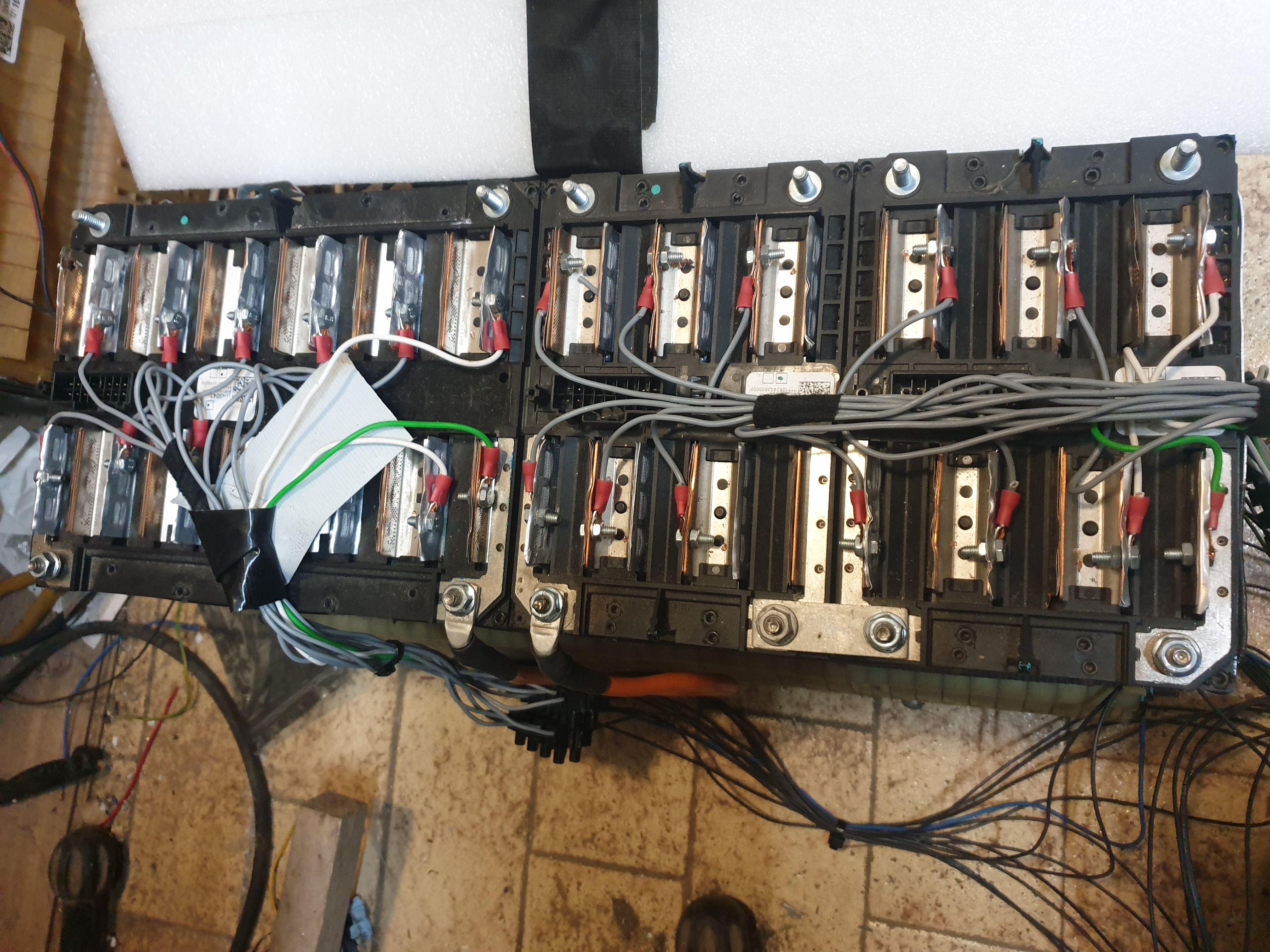

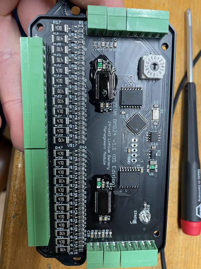

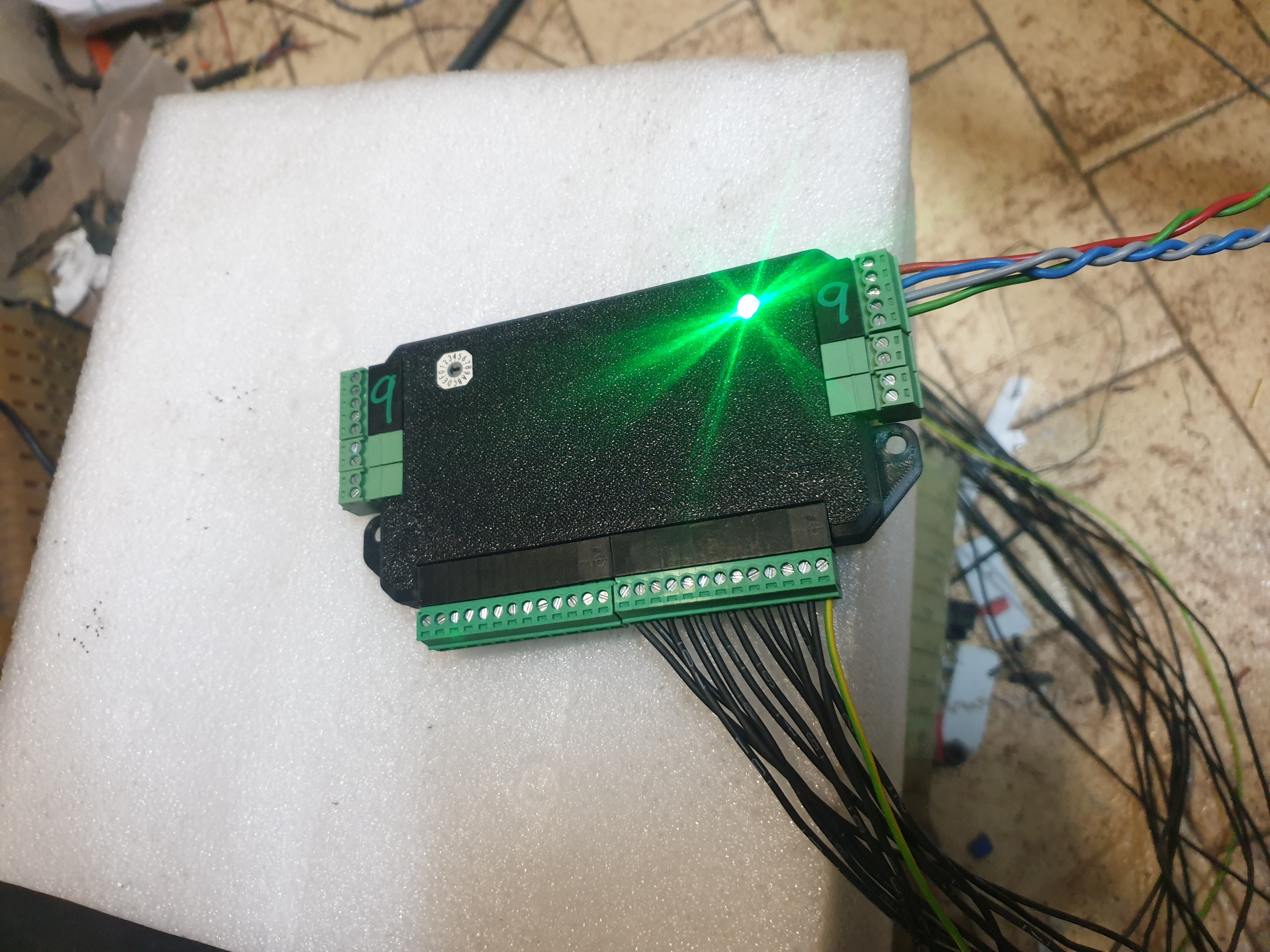

I got several 24S ZEVA BMS modules here and i decided to make modular battery 96S out of 4x 24S boxes. This ZEVA BMS will lend itself nicely to such use. https://www.zeva.com.au/index.php?product=143
I will document assembly and integration in this thread.
Not to be confused those modules are primarily used for data gathering. Their mode of operation is for master VCU to send data request on the line and each module would respond with several packets where cell data will be stored. Temperature as well...
Balancing mode and cell level is commanded by master request in 2 byte telegram.
CAN bus instructions are in this manual which is made for 12S version BMS

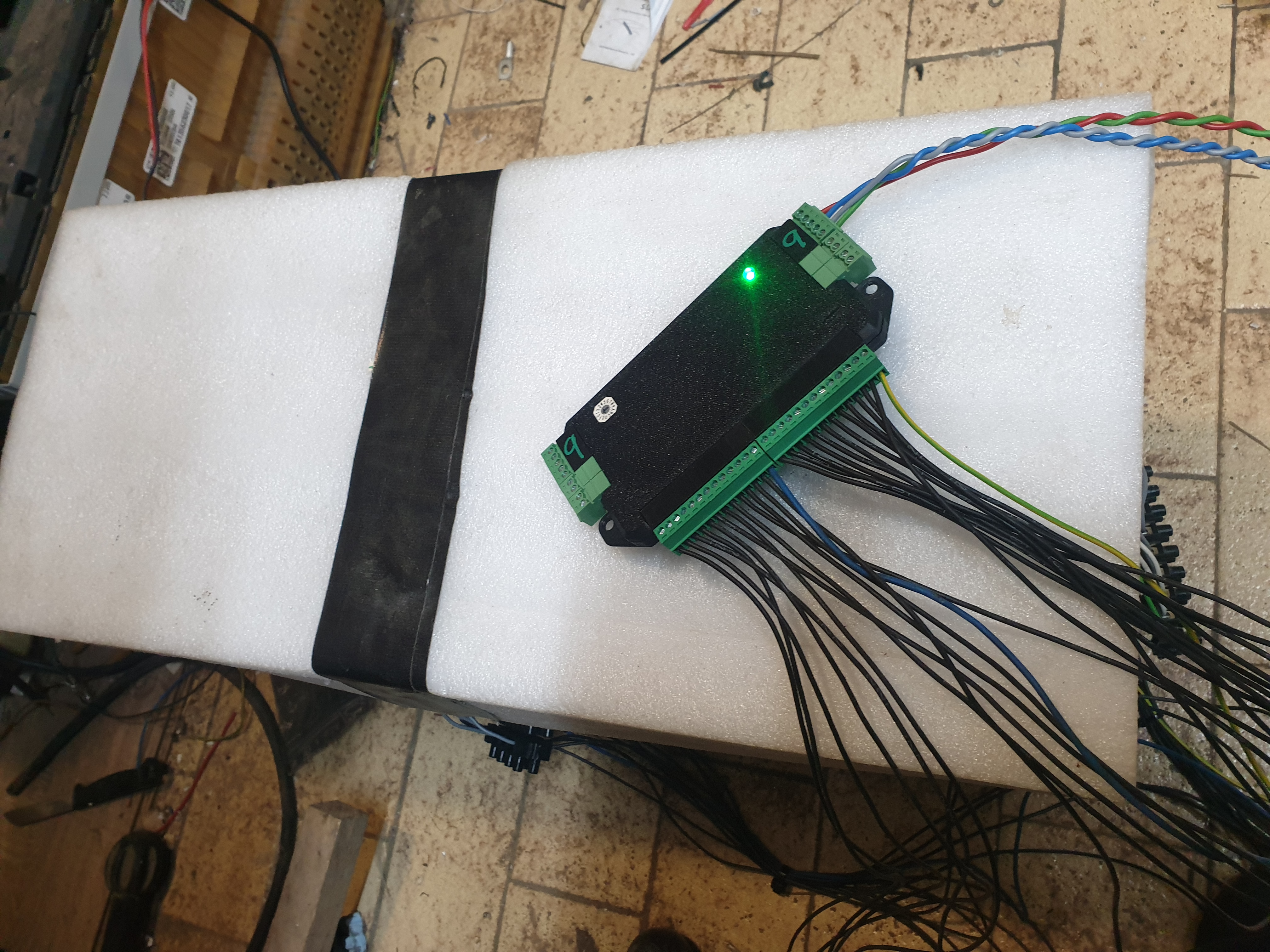

First i connected the cell connector for 12S, that is 13 positiuons to the battery... This battery was assembeled from 2x section of 12S Volt gen1 cells connected in parallel. I even connected each cell in parallel using 0.75mm2 cables. I will have to separate those paralleled cells.
Later on this will let me test full 24S BMS capability later.
I then connected the 13s connector to my ZEVA BMS
Check this manual before connecting...
BMS24_Manual.pdf
(551.41 KiB) Downloaded 1135 times
When i also connected the CAN and 12V power supply connector from the left side as on the upper photo system would not respond to IDx300 which it needs to get response from BMS modules. The error was two part.
First of course i needed to change the CAN input connector from master side to the right side
Secondly IDx300 is not valid command. At least not in hex. 300 is the sum of ID number in hex, so IDx12C then...

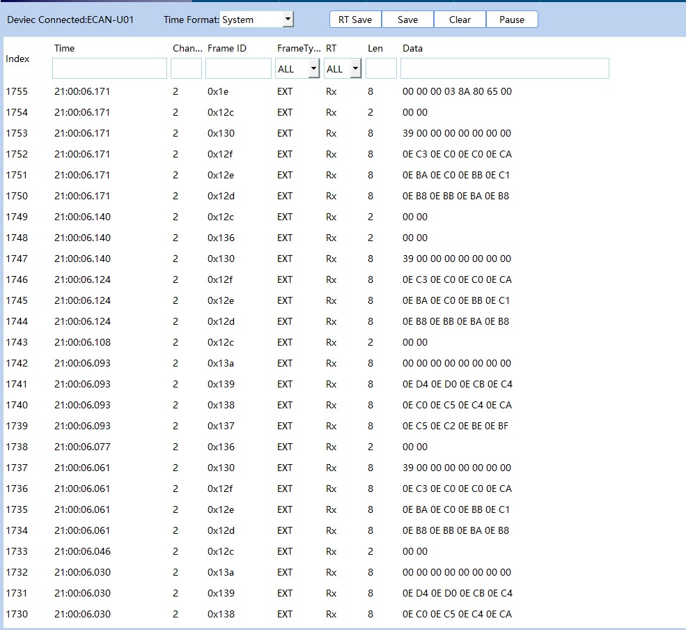

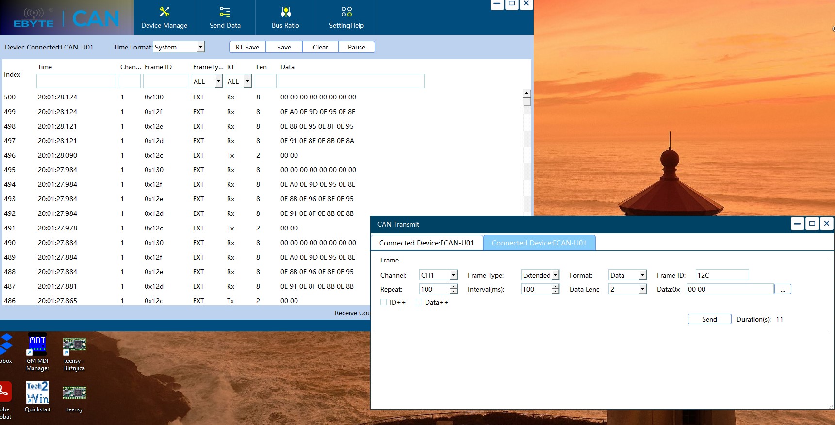

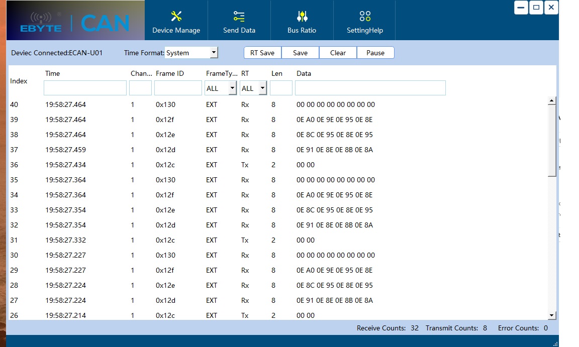

I send IDx12C "extended" address with data in 2 bytes which should mean command for cell balancing value. For now i only send 00 00.
And CAN bus came to life!
I used 250kbps signal with "extended" ID repeating at 100ms interval.
Later on i tested the CAN lines from left to right connection to my CAN reader from CH1 and CH2.

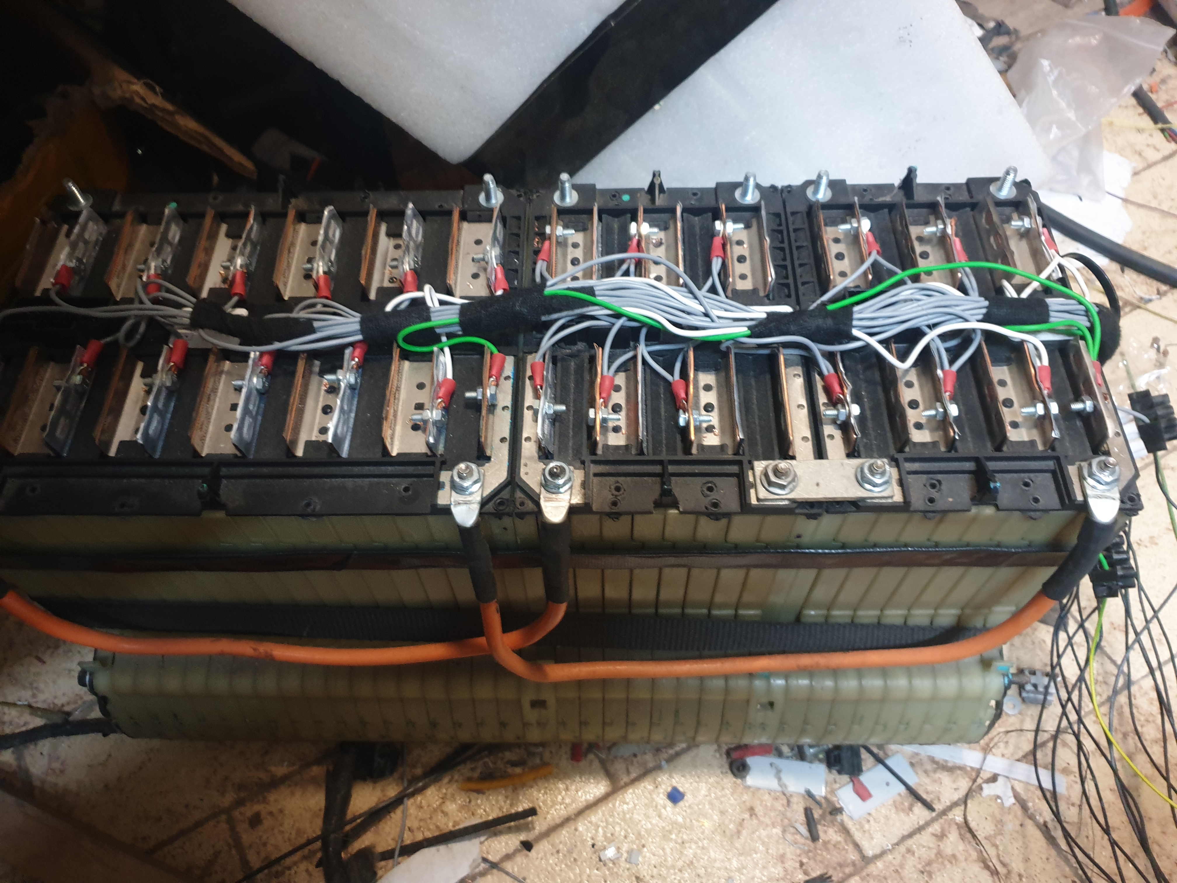

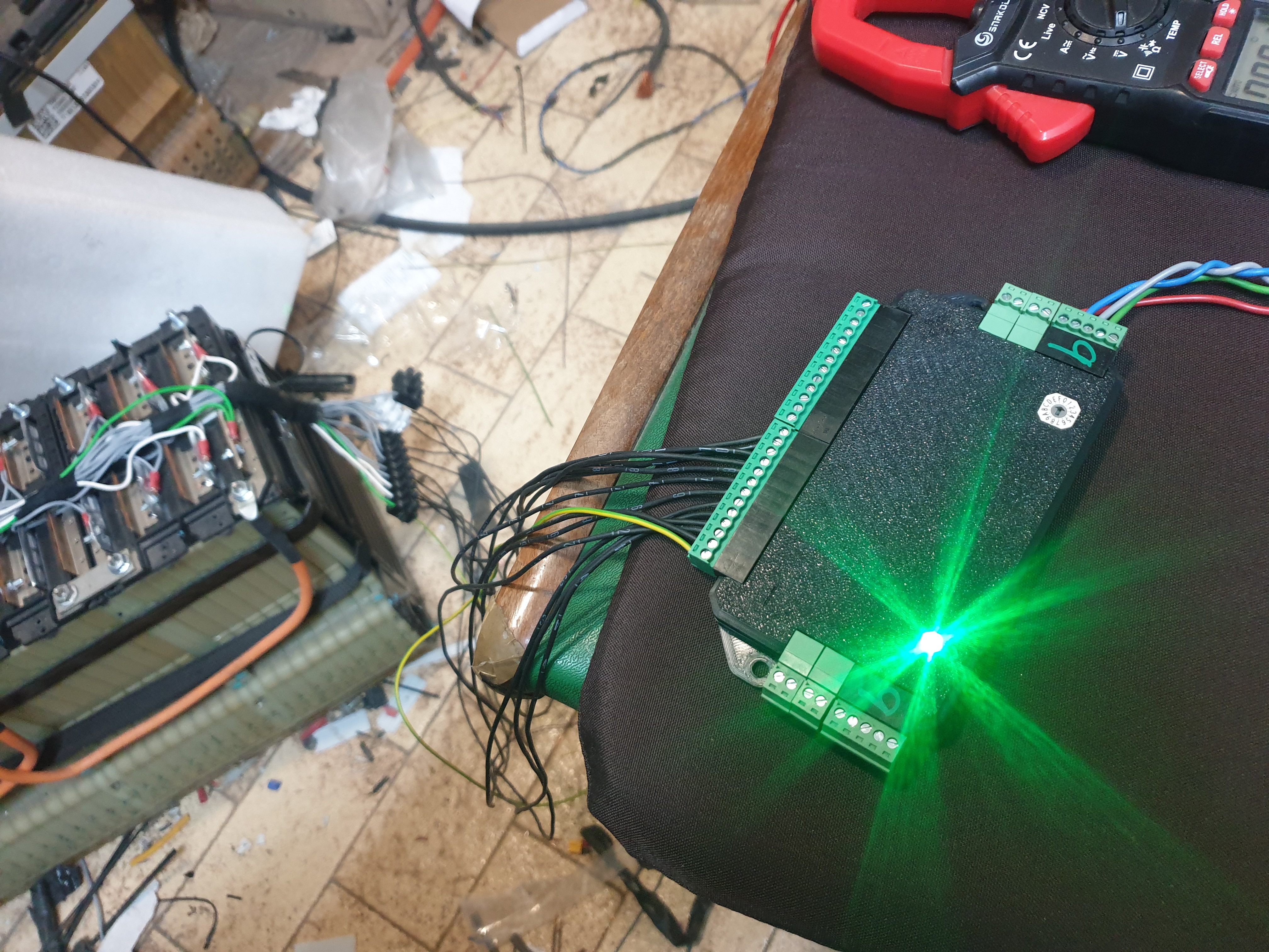

I have now separated two 12S cell packs and made 24S connections for BMS.
I connected them in series for 24S.
BMS connected for 24S cells. Communicating with CAN bus.
Each halfh of 12S of BMS module has a different address that is set by the selector on the top left on the module.
For position 0 the both adresses are 0x12c for the first 12S (rightmost) and 0x136 for the second 12S (leftmost).
When requesting cell report the 2byte content of the telegram refers to module balancing threshold in mV.
Commands to extract report from 24S module and impose 4.10V threshold for balancing are therefore:
0x12C 10 04
Reports returned:
0x12d x0 x0 x0 x0 x0 x0 x0 x0
0x12e x0 x0 x0 x0 x0 x0 x0 x0
0x12f x0 x0 x0 x0 x0 x0 x0 x0
0x130 x0 x0 x0 x0 x0 x0 x0 x0
0x136 10 04
Reports returned:
0x137 x0 x0 x0 x0 x0 x0 x0 x0
0x138 x0 x0 x0 x0 x0 x0 x0 x0
0x139 x0 x0 x0 x0 x0 x0 x0 x0
0x13a x0 x0 x0 x0 x0 x0 x0 x0
telegrams 0x130 and 0x13a contain thermistor values for each side of the module. If connected to 100K NTC they give cell temperature, see example at 0x130 byte0 value is 39. That is 39hex = 57dec and according to design temp info is xx - 40 = 17deg C.

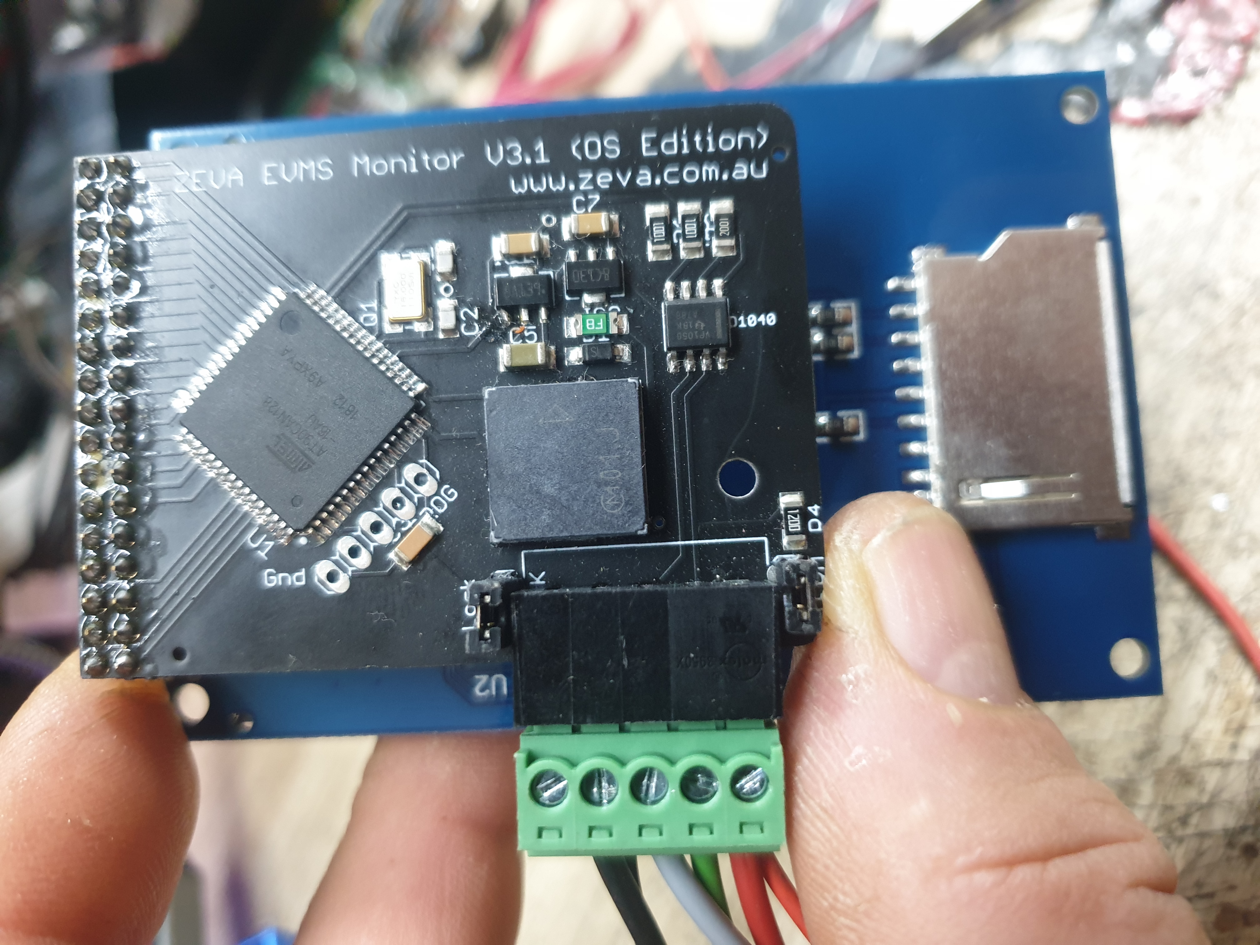

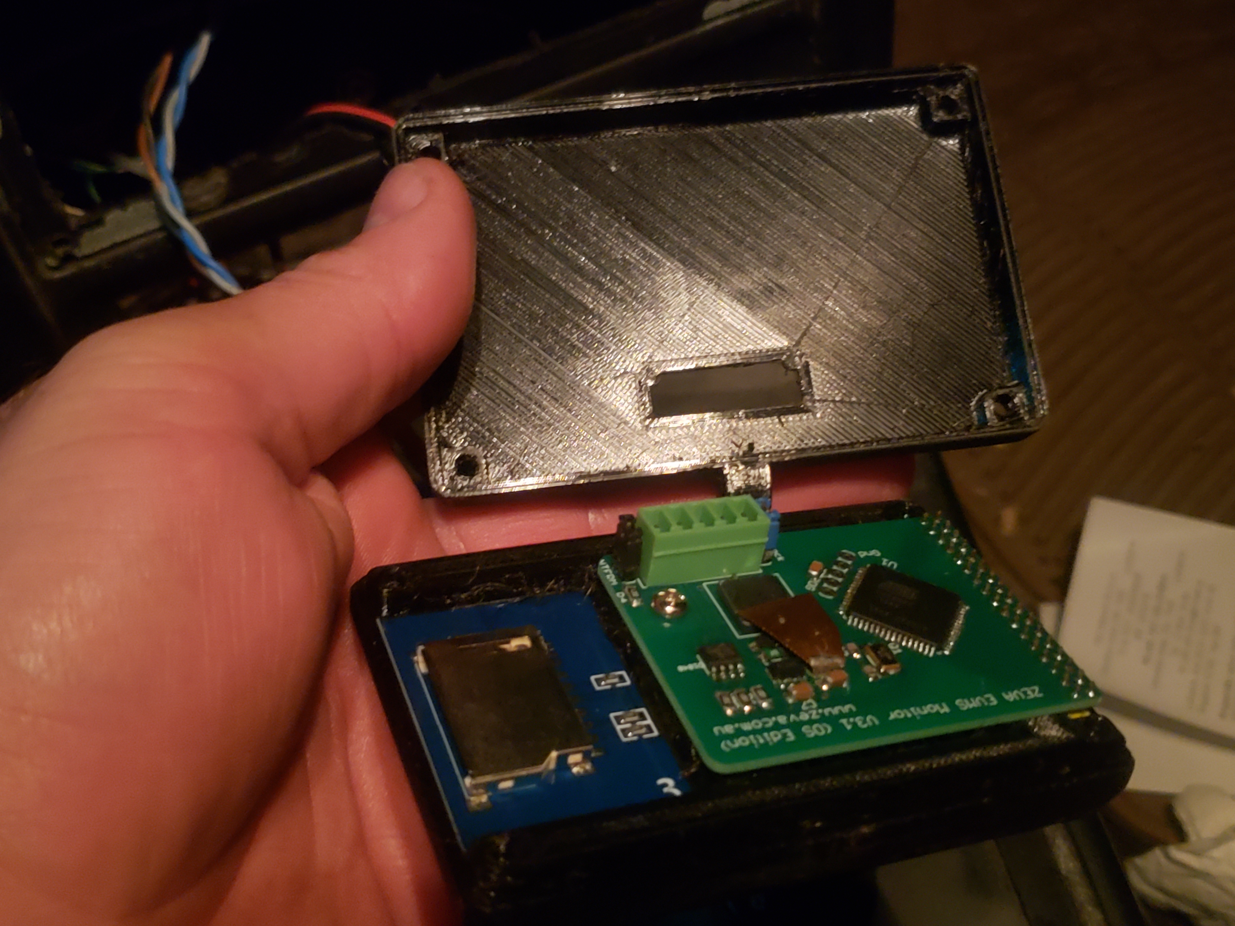

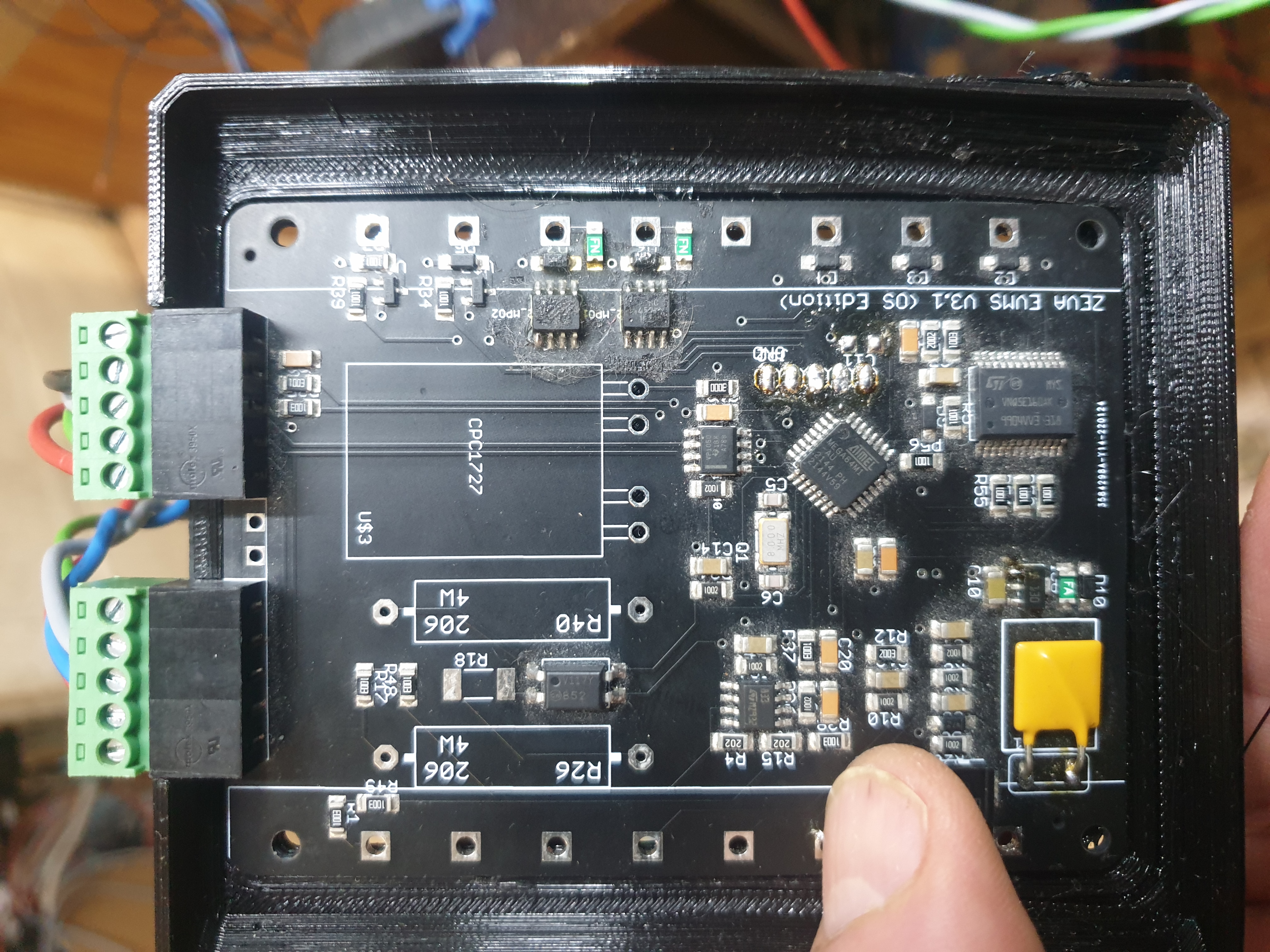

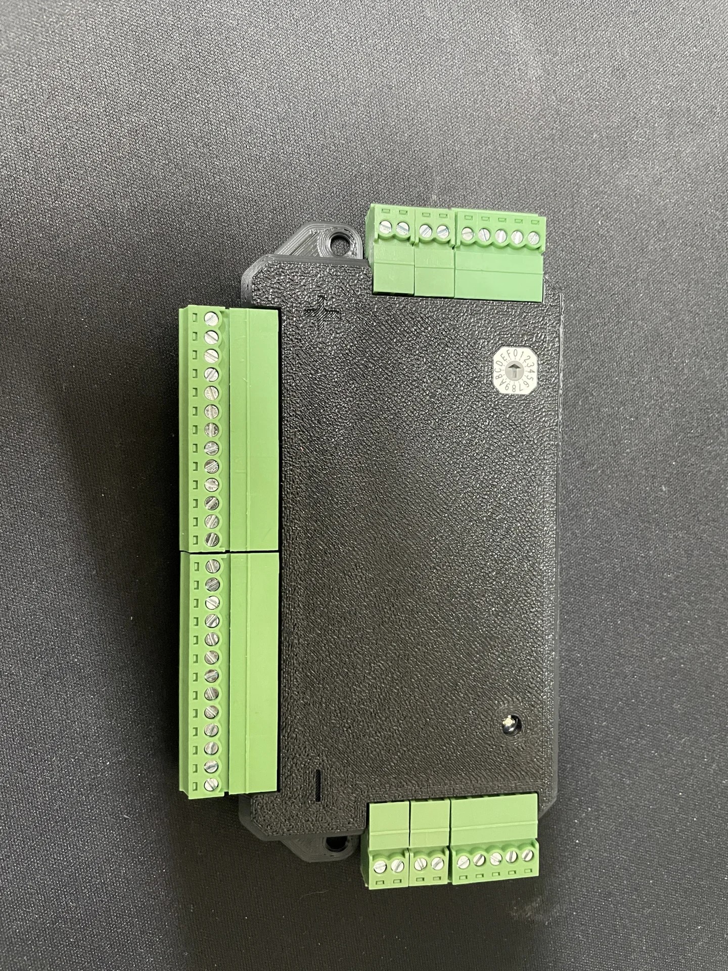

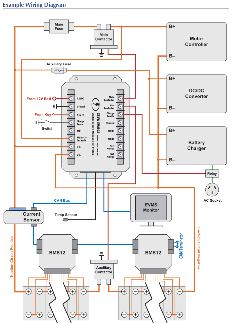

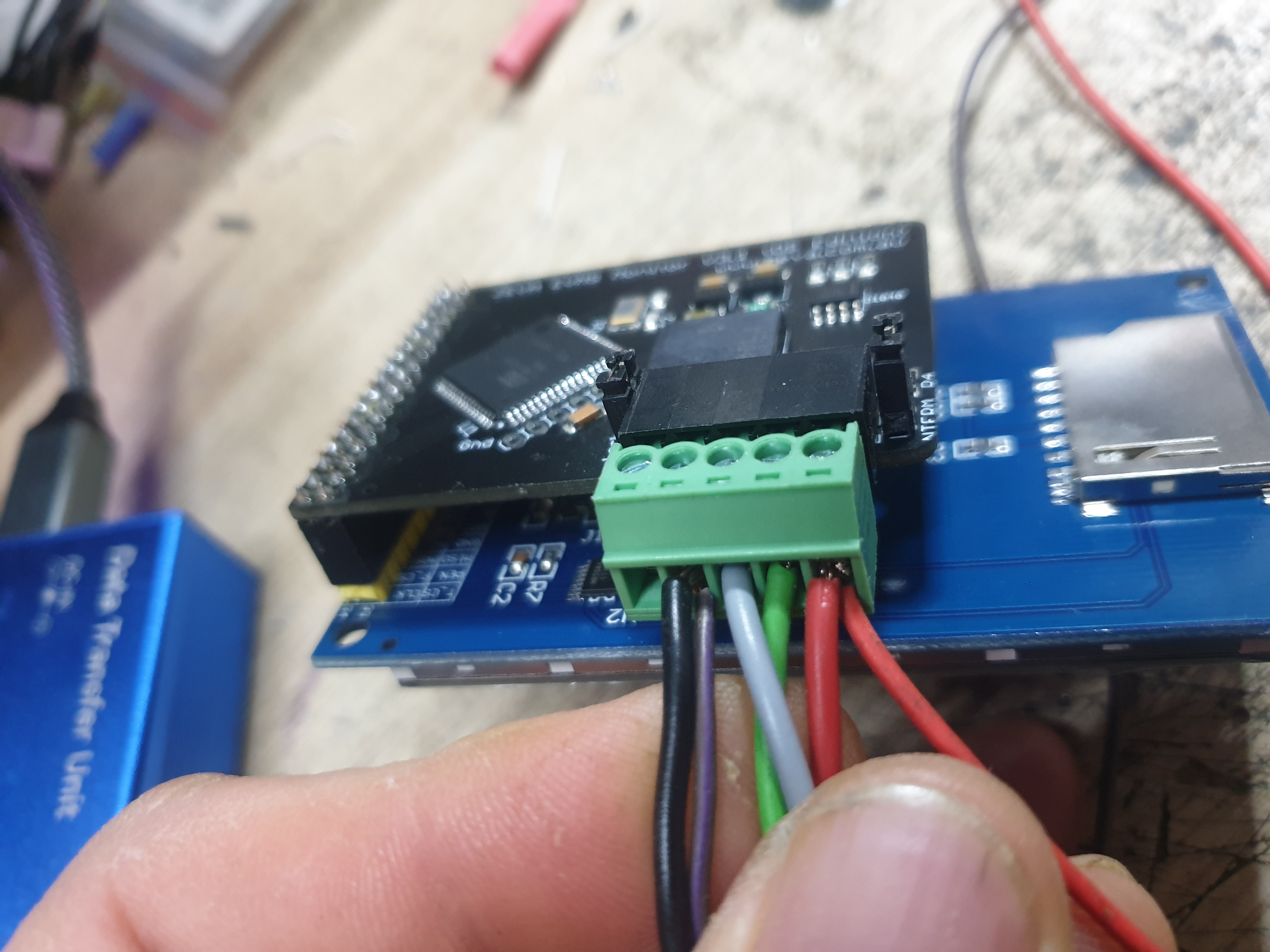

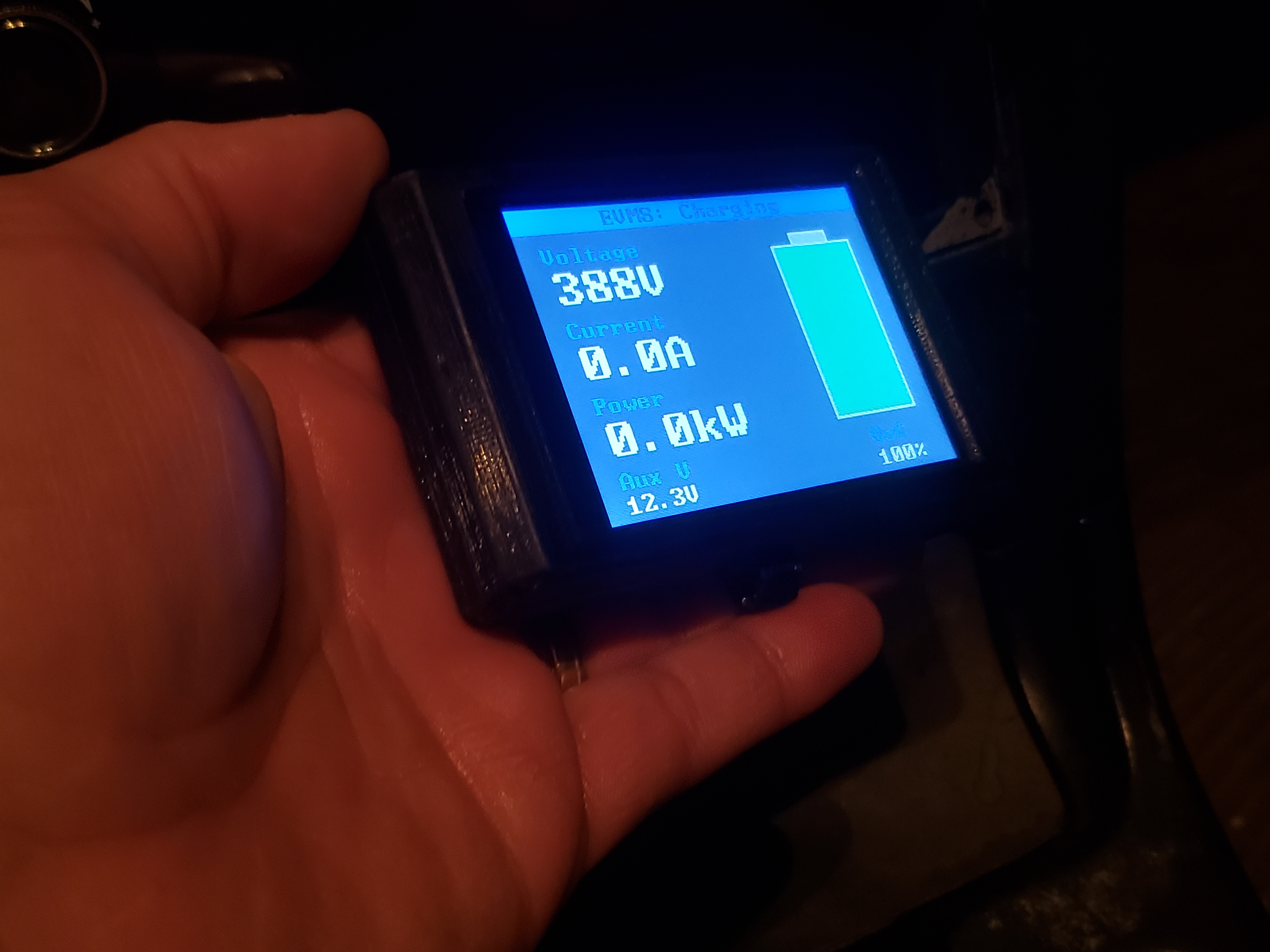

Next i connected the control board which is called EVMS V3.1
This controler is innitiating CAN transmission and provides 12V power for BMS 24S modules.
Later on when i will wire this EVMS into the car i will try to make more detailed post

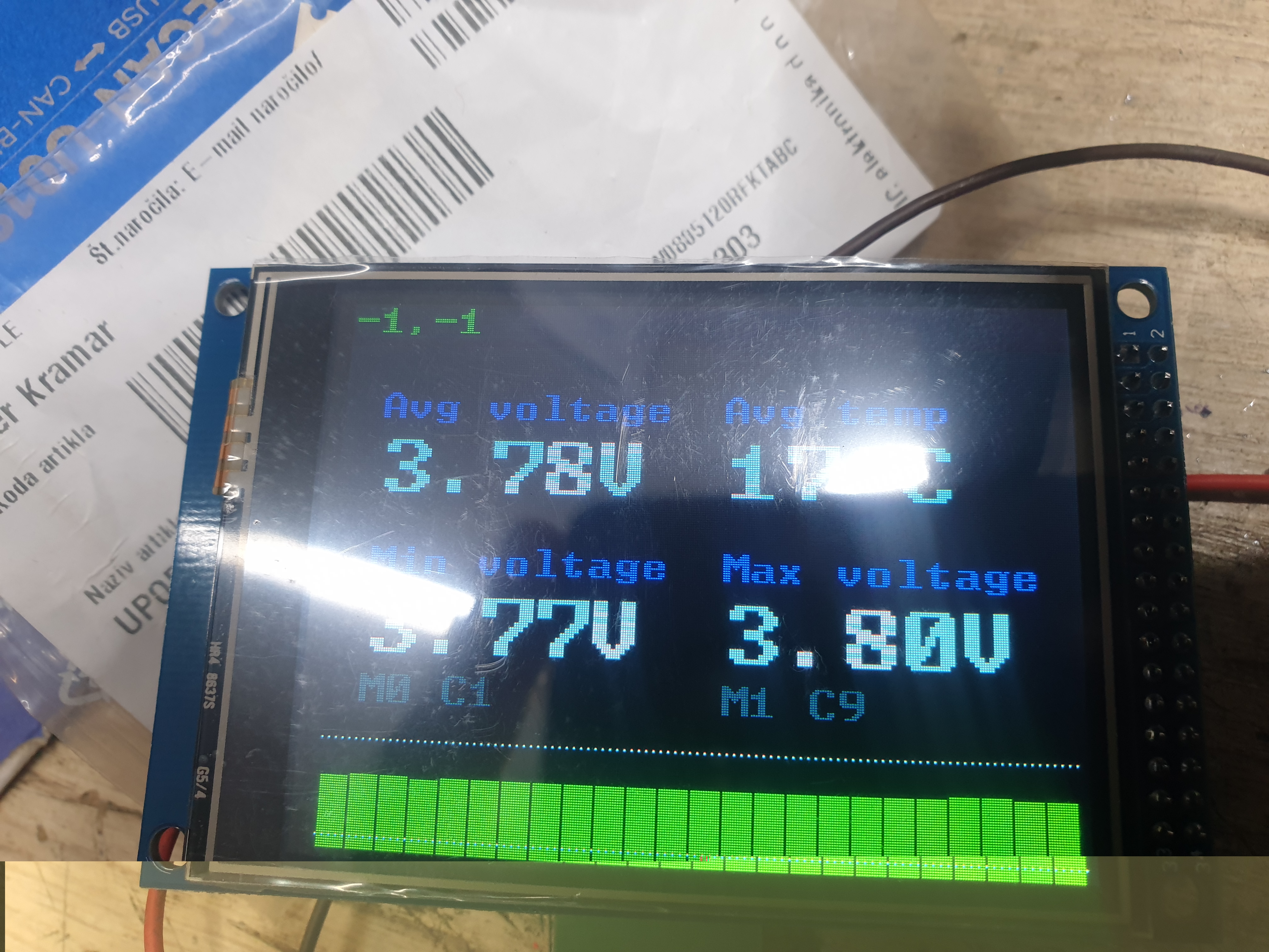

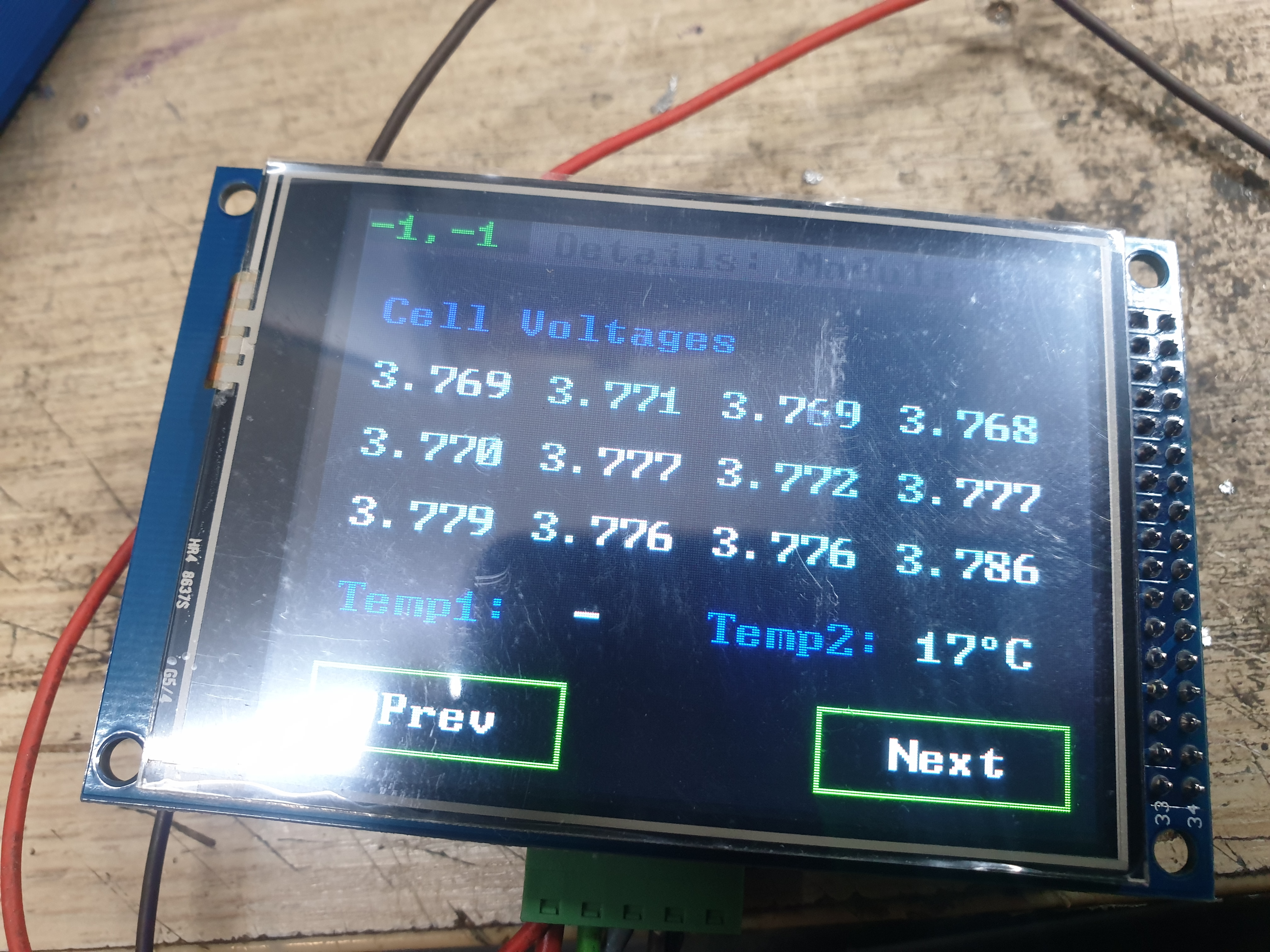

Next was the LCD. This LCD is touchscreen that can be obtained on Aliexpress
https://www.aliexpress.com/item/3288298 ... 1802JTpgQ3
Surprisingly when i connected CAN bus and power to LCD it immediately started and got the first module cells.
Since 24S module is made from two 12S parts i needed to enable number of modules and cells inside LCD. When i corrected settings i got good account of all cells.
EDIT: I am really surprised how easy it was to connect everything together on CAN bus and LCD and it worked the first time!
I have to hand it to Ian he really made a good system. Next i will try to connect sevaral 24S modules together.

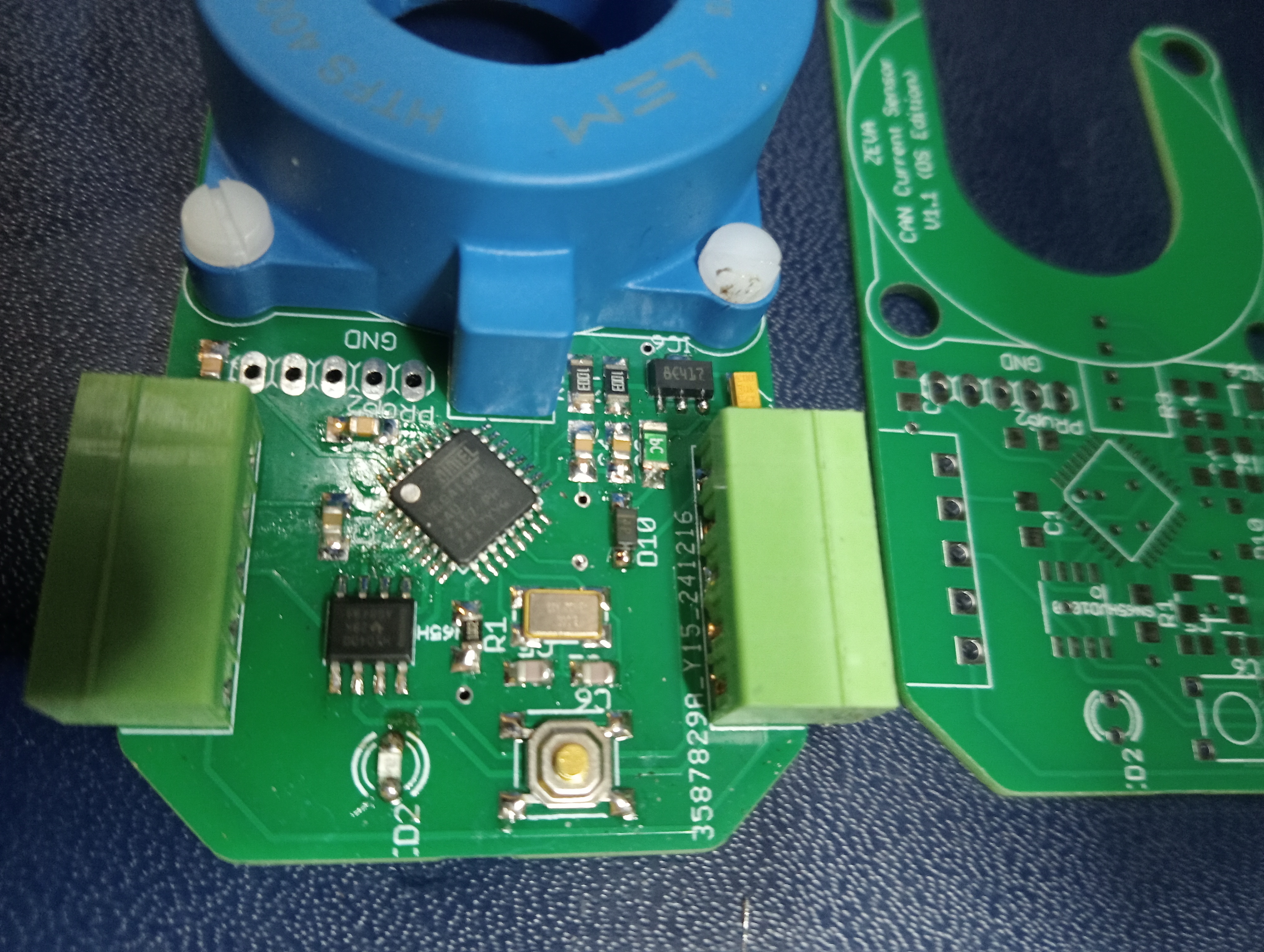

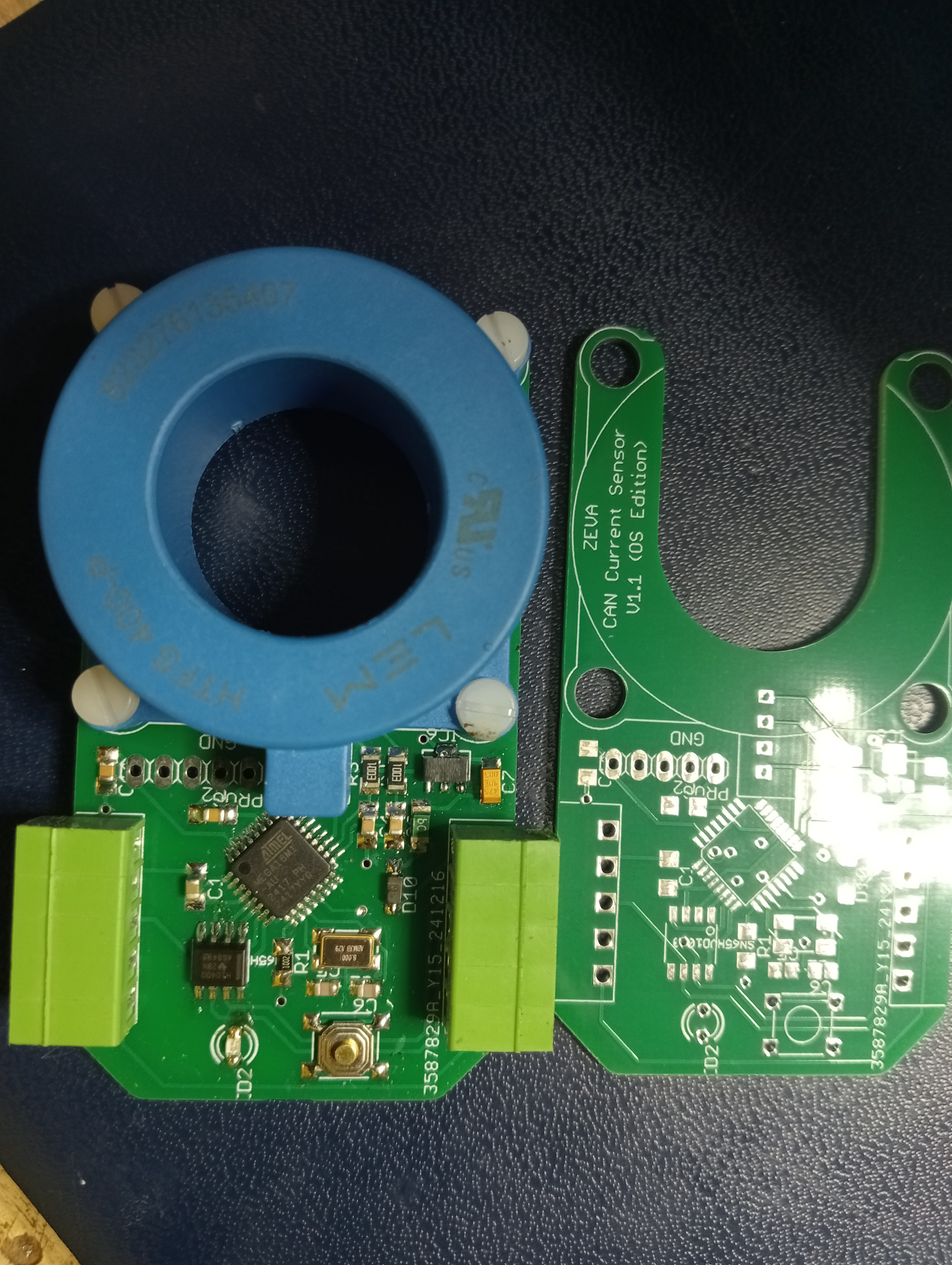

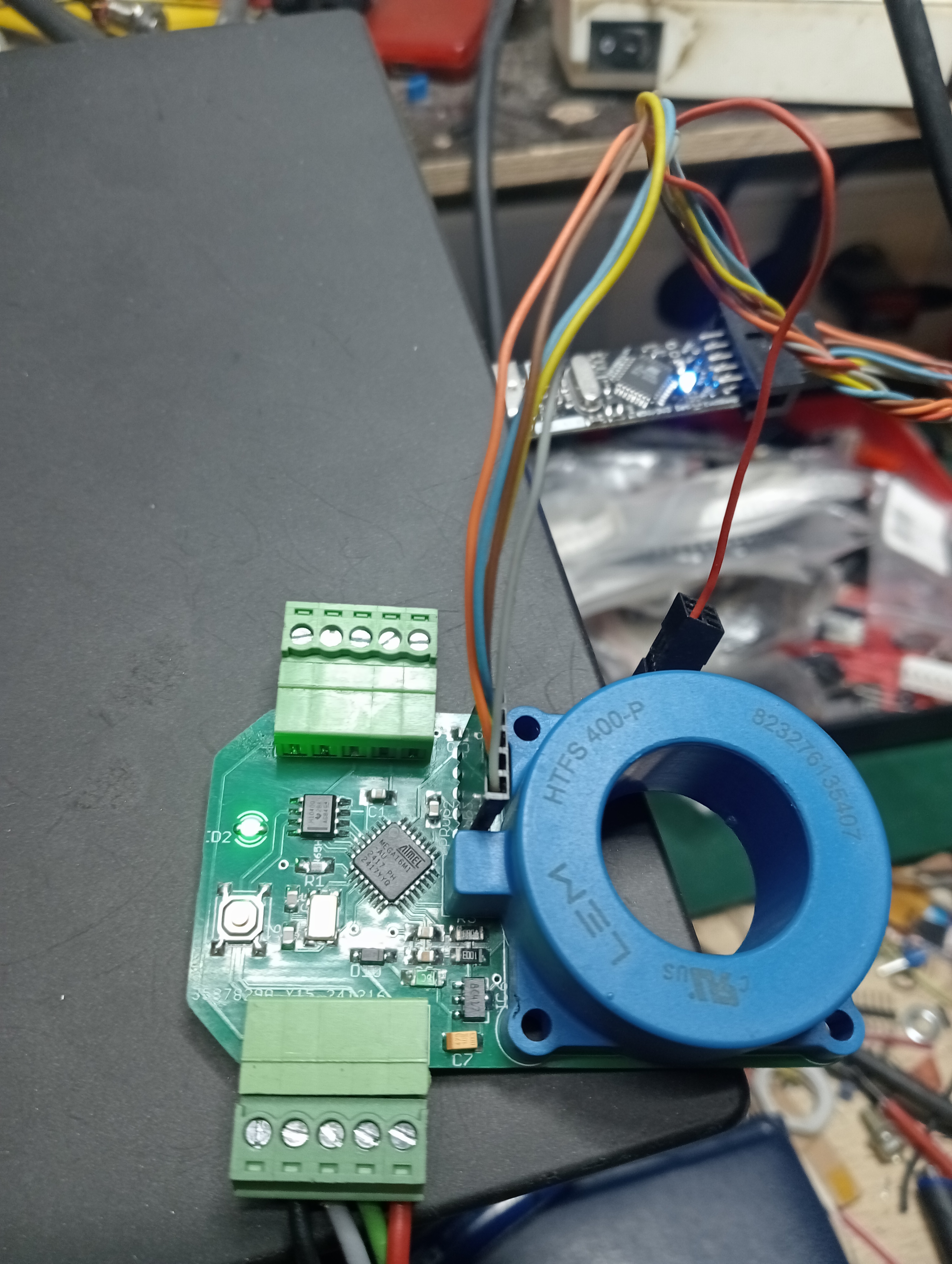

From JLPCB i got ZEVA Current sensor boards I ordered.

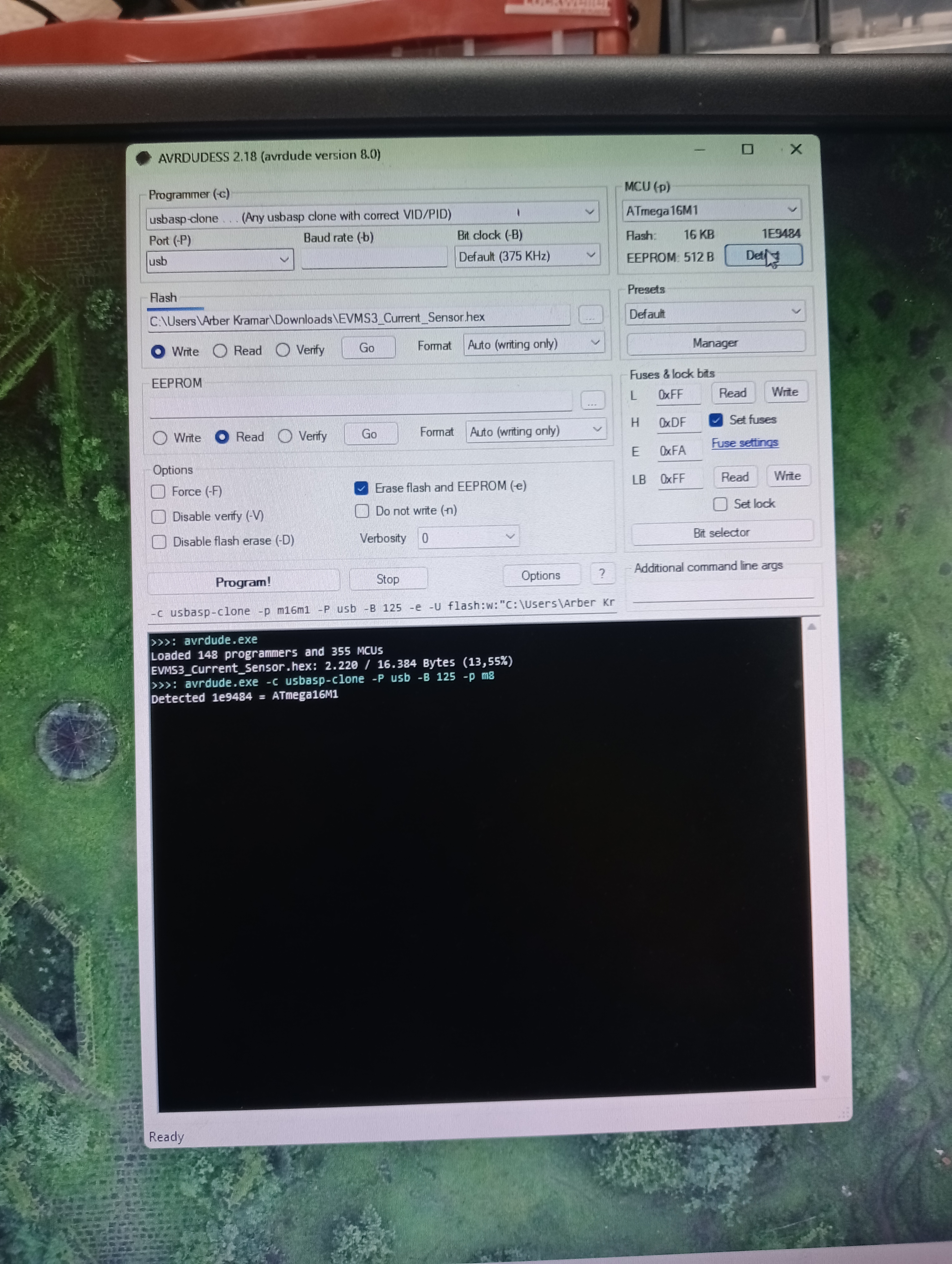

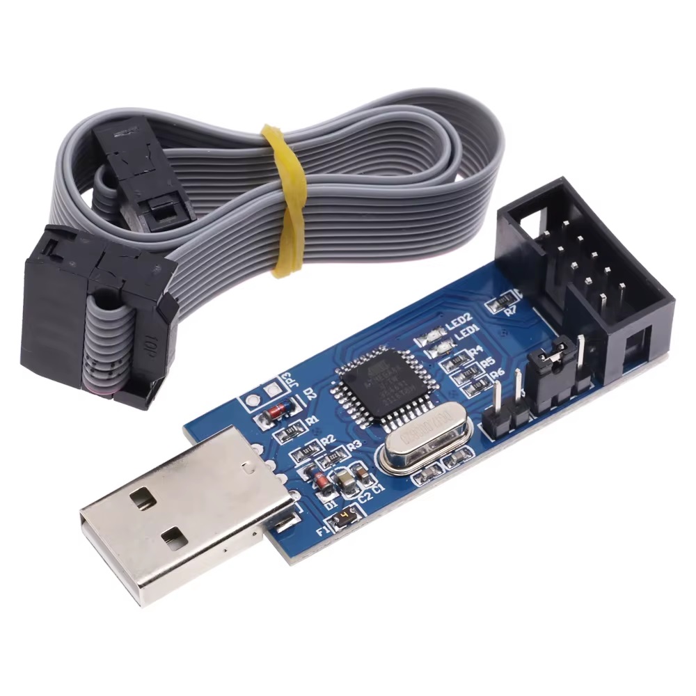

I soldered main chip ATMega16M and support components. For sensor i used LEM HTFS400 sensor.

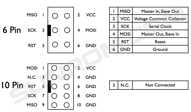

When i got it together i used my AT programmer.
For this i use just a simple AVR USBasp programmer with custom built cable.
https://hobbycomponents.com/usb-interfa ... er-adaptor
Program of choice is avrdude
https://github.com/mariusgreuel/avrdude ... me-ov-file
Because i struggle with using command line i found this GUI interface AVRdudess, it makes my life so much easier
https://blog.zakkemble.net/avrdudess-a-gui-for-avrdude/
Boards must be connected to 12V supply, just because wiring is done that way. If not programmer will not detect the chip.
I connected the board by hand and kept pins pressed together. Then i set the speed of communication to 8bit and tried to autodetect the chip.
I selected my hex file and set the fuses for programming.
When i finished the LED lit up!
As hall sensor has trouble with centering i pressed the button and when LED stopped blinking sensor is centered.

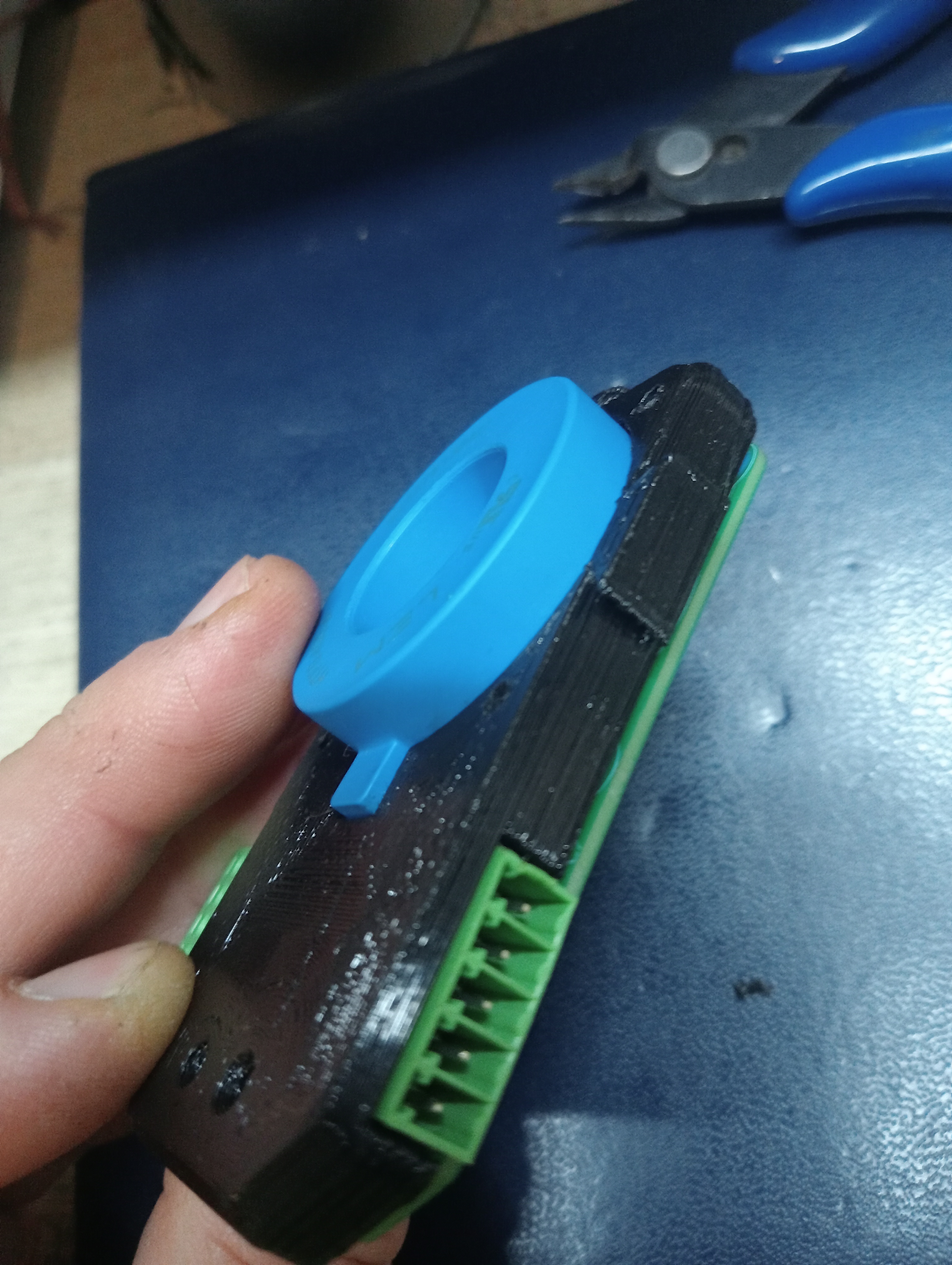

I made 3d printed casing for this sensor so circuit is protected.
Stil have to connect this sensor to CAN lines, but i think it will not be a problem as it is a through connector.
Will report back with some photos...

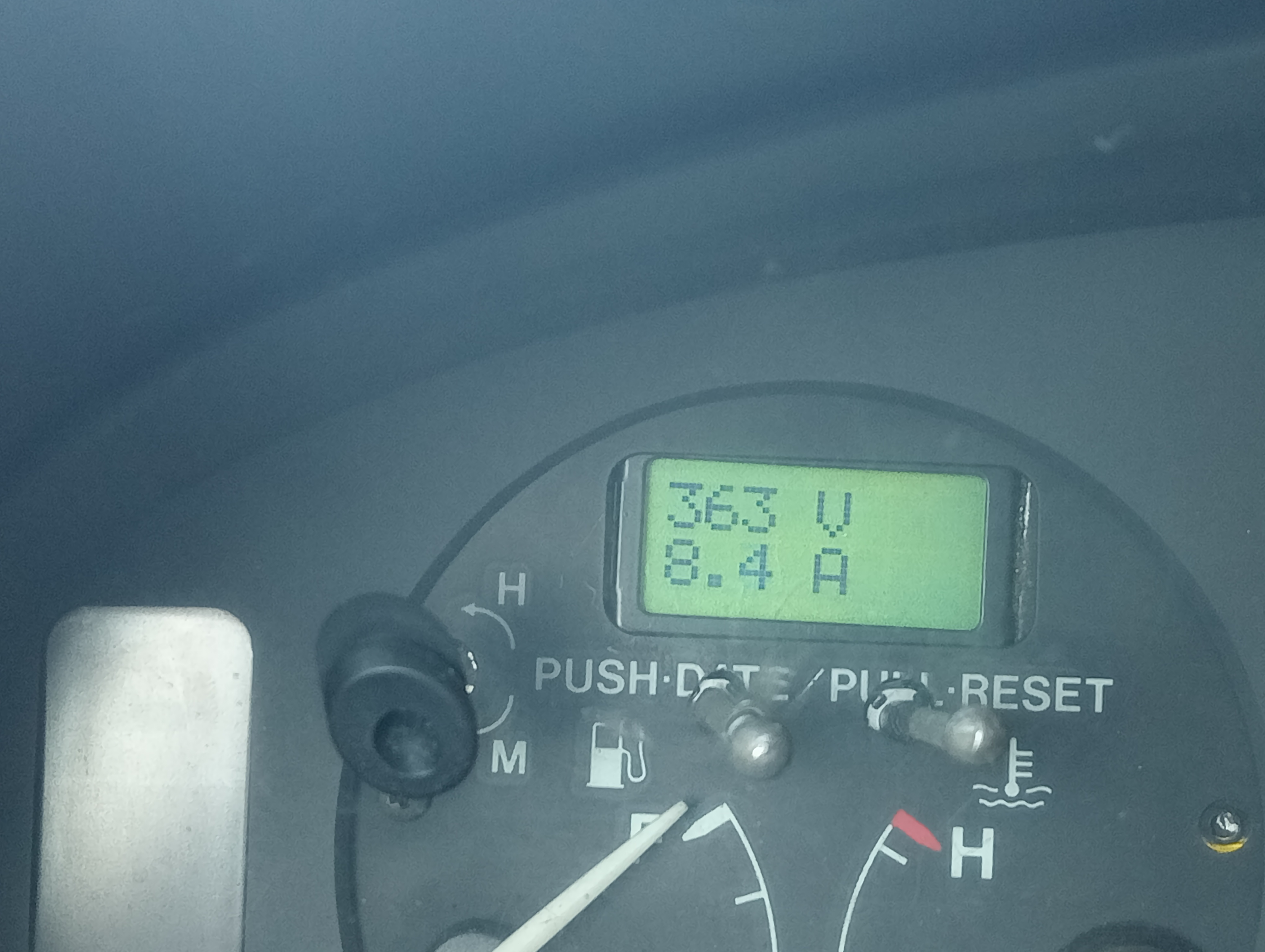

Ya...
I connected current sensor module and put one side of the DC rail through it to sense current.
Idea is to put sensor on the line between BMS modules and keep communication in one line.
I used LCD to enter setup and prepared some parameters like max current and cell levels.
It seems i programmed that chip with 300A parameters code! That is starting sensor value.
My sensor is actually 400A. There is a multiplier parameter which takes care of larger sensors for the same code.

When i first connected current sensor LCD changed first page to show SOC%.
The reading error is shown in sensor reporting less current. You can see the difference in sensor from my EVdisplay.
It seems sensor reads like 1/2 times so i think i will need to use multiplier 2L....
Also voltage reading is confused. While it reads battery values and makes the addition it also requires direct HV connection to main board. Later on i will make a secure fused connection for HV sensing.

Yes i have sensor for 600A so i need sensitivity 2L then.
But compiling the code correctly is a pain...
Also i use sensor LEM sensor for 400A and yet Ian set it up as 600A sensor probably because of range...

Balancing is actually going on with both "Running" and "Charging" modes, its just needs to see high enough cell voltages to start balancing.
I find it quite good and effective process.
But all the time that 123V is interfeering into comms. Sometimes it will stay at 123V for 1s but other times it will flick at 4Hz. Why is this significant? Well CAN communication runs at 4Hz. This means something is probably out of sync...
I dont know from where it originates but i will try to read the code and see if i can change that...

the total voltage shown in the screen is the summatory of all the cells calculated individually.
So, what I would try is to isolate which bms slave is provoking this flicking voltage reading. Mounting each cell block and testing when appear the flicking.
If I had to bet, I would say that it is logical that it fails between cells 30s/31s or 66s/67s.
Once identified the failed one, probably you could find in the electronic a not reliable component or soldering. But You probably know much more than me about this.
going to idle state, is probably that 123v is less than the minimum voltage required in the setup so it can not be in running mode.

Hm... so this would mean system is loosing comms in the time it takes to show the next message?
I will try to unplug all modules and test one by one like you said.
However i see the same thing if i only use one 12S module on my workbench. This first led me to belive it is something software related...

How do you make your cables?
I make a pair of twisted cables out of two 0,5mm2 blue and white ordinary soft wires twisted in a right hand way using my battery drill.
Then i make 12v power supply pair out of red and black 0.5mm2 and twist them in the same way (to help with any EMI). I dont use any shield wire.
Do you use shield wire? If so, how do you implement this? I mean do you just use one wire along with the rest or do you use anything special?

in the stationary battery i am using cabling recycled from ethernet cable unshielded. my battery is about 342v (85s actually) , maximum of 15A but normally with very low amps so no problem with EMI.
in the car, still in construction and never run more than 200m around my home, have shielded ethernet cable comunicating the battery boxes(one pair for data other pair for 12v), but inside the batteries unshield ethernet cable for the cells. the slave BMS24 are inside the battery boxes

ZEVA BMS programming
LC-01 USBASP AVR download cable / AVR programmer / 51 ISP the downline lines programming /AVR ISP / / USB ISP - AliExpress 502
AVR ISP 10 pin for programming : Sunrom Electronics
https://github.com/mariusgreuel/avrdude … me-ov-file
I connected the board by hand and kept pins pressed together. Then i set the speed of communication to 8bit and tried to autodetect the chip. It seems like some chips cant talk really fast, but some can...
I just got the other LCD monitor circuit from Chentron and i tested it it worked perfectly the first time. I found out my firmware obviously didnt have the correct switches set. I corrected that and voila! It works now seamlesly.
Fuses that need to be selected…
LOW HIGH EXTENDED FUSES:
BMS24 ff df fa ff
CAN Shunt Interface ff df fa ff
EVMS monitor: ce d9 ff ff
EVMS3: df df fa ff
