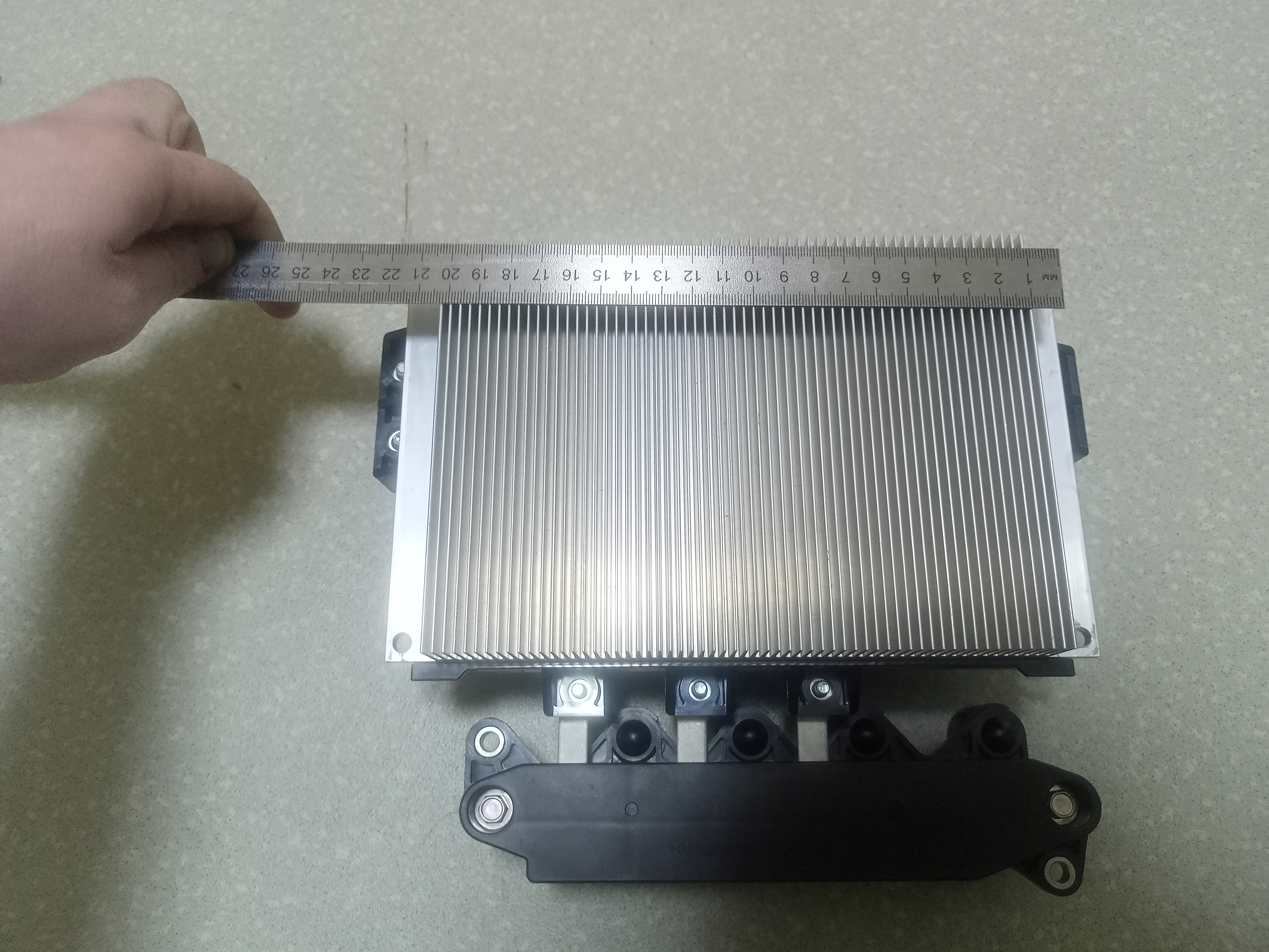

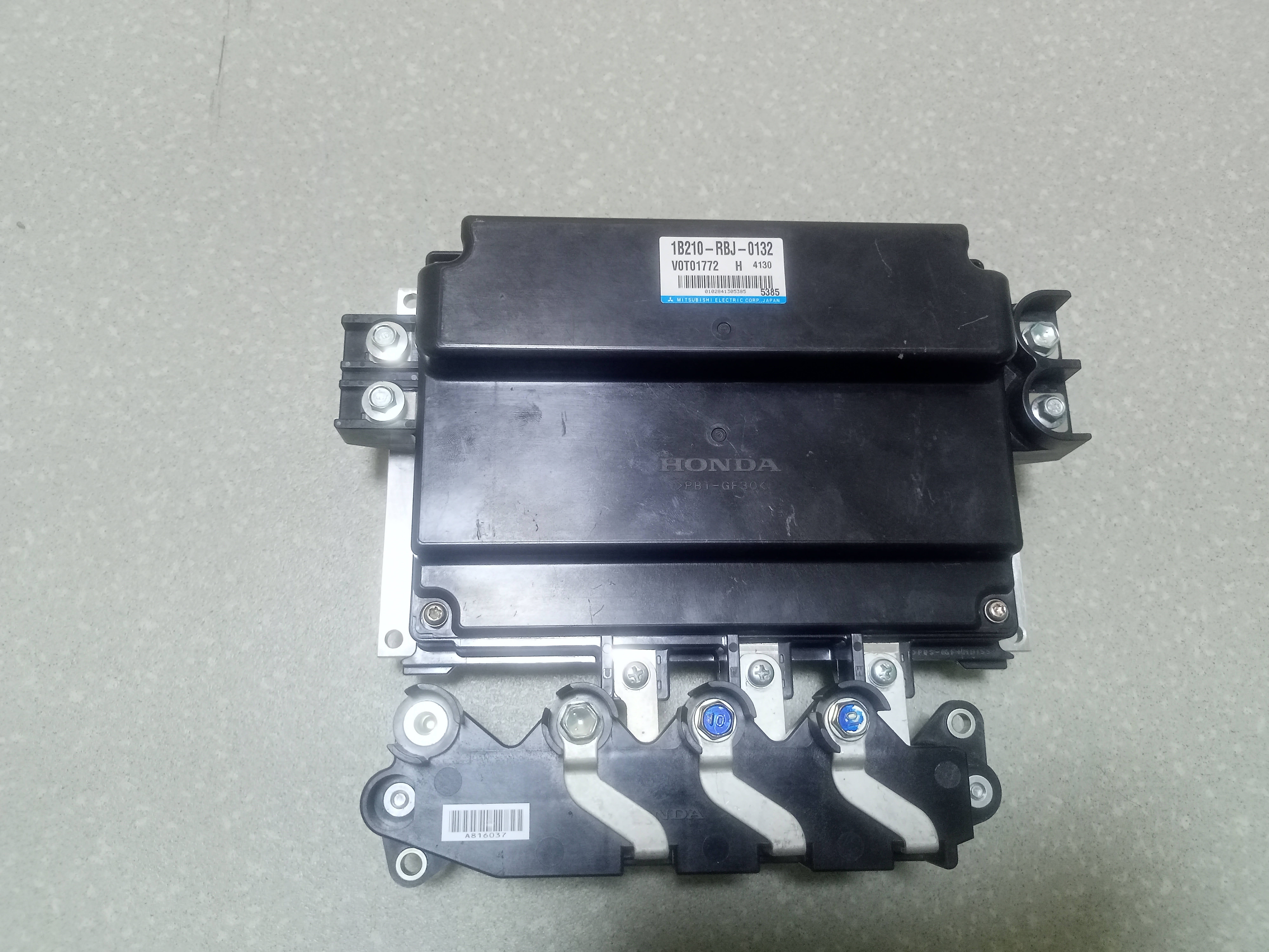

We continue disassembling the inverter, the top cover is held on by 4 bolts , Also disassembling current sensors

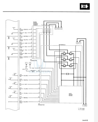

tom91 wrote: Fri Jan 31, 2025 11:42 am Thats how Toyota done the early priaiii (plural of prius) too so it seems very possible. I would mean getting control over the inverter power stage should be "relatively" straight forward once signals are identified and mapped.
Yes, I am working on it, for now we have a diagram like this, a little later, after some time I will make inscriptions based on the photo, more detailed instructions, as I understand it, the inverter is from a Honda Civic, the capacitors are designed For voltages up to 600 В , but Honda insight has 450 volt capacitors , I couldn't find more detailed information on the capacities
Special thanks to a good friend for providing the photo.
Module IGBT For voltages of 600 and 300 А

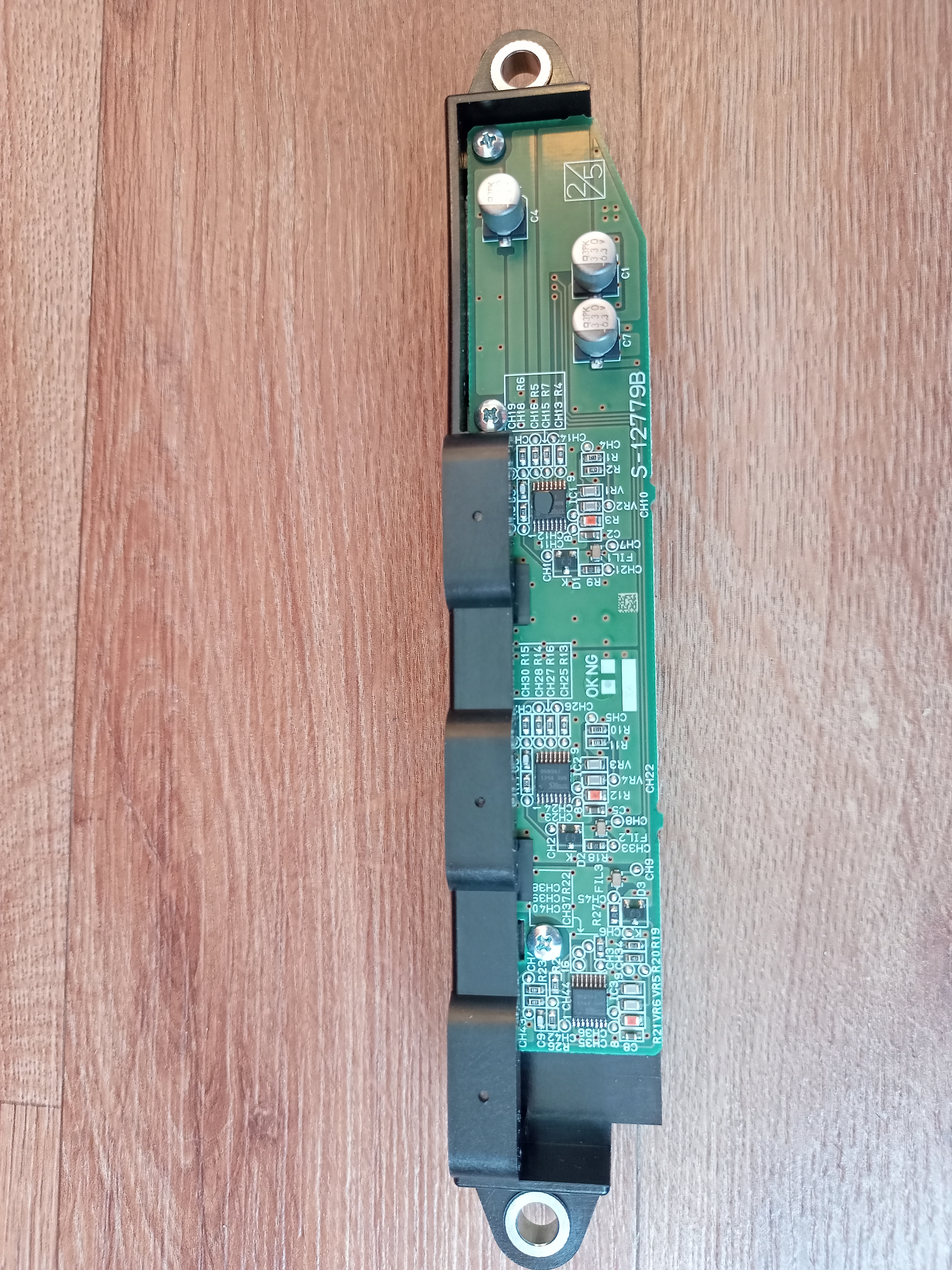

The pinout of the current sensors is ready, let's move on along the path

Hi i have one such inverter here and i would like to make it run OI. Can you elaborate on the signals that you determined pins with?
VCC - how much voltage? Is that 12V or 5V?
PWM are open collector signals (pulled up) or true voltage signals? Which level are they, 12V, 5V or 3V3?
What is IPUA signal?
Any idea on side connector P/N
EDIT: I see connector here, but rows are squed.... https://connector.pinoutguide.com/12_pi ... _Unit_MIC/
This one looks like the real thing:
https://www.aliexpress.com/item/1005009 ... in_prod%3A
I will use my own current sensors for this...
tnx
Arber

VCC This voltage is 12 volts, powered by a battery, Ipua This is an error signal

Upua is the TX UART contact; the inverter communicates with the native control unit through it. The inverter operates and starts without it, with operating voltage up to 240 V, then it shuts off. Some guys have removed the overvoltage protection, but then the capacitor voltage limit will reach 450 V. If you're on Telegram and ready to talk, you can find me at ex400rus. IMA inverters for motorcycles and ATVs (Honda Insight 2nd generation, Honda Fit, Honda CRZ, Honda Jazz, Honda Civic, Honda Freed)

Ryclanmoto wrote: Mon Jan 19, 2026 7:44 am .... The inverter operates and starts without it, with operating voltage up to 240 V, then it shuts off. Some guys have removed the overvoltage protection, but then the capacitor voltage limit will reach 450 V. .....
Ok you peaked my interest now. I have some questions...
1. Does this particular inverter stop by itself at voltage more than 240Vdc?
2. Cap limit is 450Vdc? How did they remove overvoltage protection?
3. What would be the current limit? What is limit on current sensors?
I see Mitsu ct300djg060 IGBTs can carry 300A at 600V. I would assume 250A at some 400Vdc?
0212-c.pdf
(364.79 KiB) Downloaded 17 times
Yes, it stops, there is voltage protection for the Honda Insight inverter, there is no protection for the Honda Civic inverter, and it can operate up to 550 volts
I can 't tell you , but rather by soldering
400 V 220 A

Does anyone know a good 300A triple sensors replacement with 0 - 5V signal?
