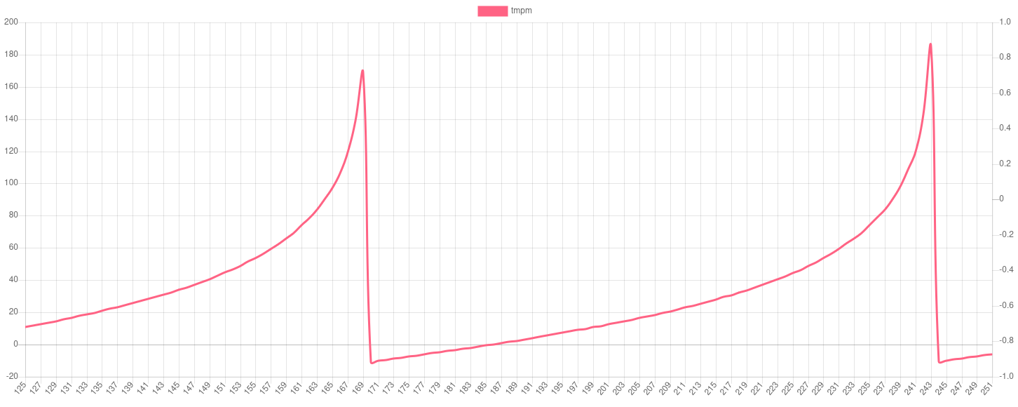

Finally got around to testing the motor temp sensor inputs. I either fixed one input at a fixed low temperature voltage or sweeped them both simultaneously. The result is as expected though:
The °C/mV ratio becomes pretty high at high temperatures, I wonder if that might cause issues. But apart from that the lookup table works and temperature saturates at 190°C
Understood with the regen. Sounds like the default 0.9 Hz is indeed too low. Not sure where it comes from.
EDIT: bug!
This line
isLdu = tmpmi > 50
is the culprit. If the second motor temperature drop below 140°C it changes over to SDU code
So you were right:

To split the search range I propose to make a test software which provides the ADC value AnaIn::tmpm.Get() to a spot value, and log this value.
If it does not have the step, the issue is in the software behind. If it has the step, the issue is electrical.
Some ideas:
- ground shift of the sensor ground due to a high current on/off load.
- analog crosstalk from an digital signal to the sensor signal
- multiplexer timing
A second point for measuring would be a multimeter on the sensor wires. This would distinguish a real voltage jump from a processing issue.

Maybe I got the point. Correct me if I'm wrong.
There are two temperature sensors. The value of one is shown in the diagrams above, and is calculated by a lookup table. Depending on LDU/SDU, different lookup tables are used, because of different sensor characteristics. The second sensor is compared with 50, to decide whether we are on LDU or SDU. This decision is made cyclically, thats why we see multiple jumps during one driving cycle, in both directions.
The two sensors have similar but not exactly the same temperatures, that's why the "jump points" are varying by some degrees.
The fix with the new threshold makes sense. If the threshold is chosen in a way that a real sensor never will hit this new limit.
Still open is from my understanding, why the measured value is in general different to the expected value. Is there a data sheet available? Or did somebody measure the characteristics?

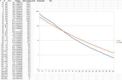

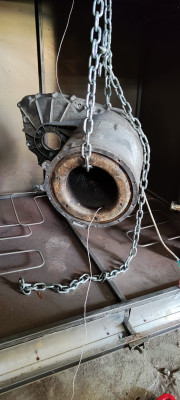

I did the oven test, here is the setup, an old Stator from a LDU sport, extended wires for the temps sensors and a thermo couple hoked up to my multi meter to have the actual temperature and an other multi meter to measure the resistance of the two stator thermistors.
The thermo couple was wedged in a crack of the resin of the stator.
a few pics attached
And the most important, the Look up table, where i have the thermo couple temp, the oven temp (inacurate), and the resistances.
I will be able to test new software version to confirm that it works well.

Thanks, quite different to the old table. Almost looks like the old one was generated from a polynomial, because it's so smooth
I fudged the new one to look sort of smooth in the lower temps
Edit: more fudging with logarithmic scale
