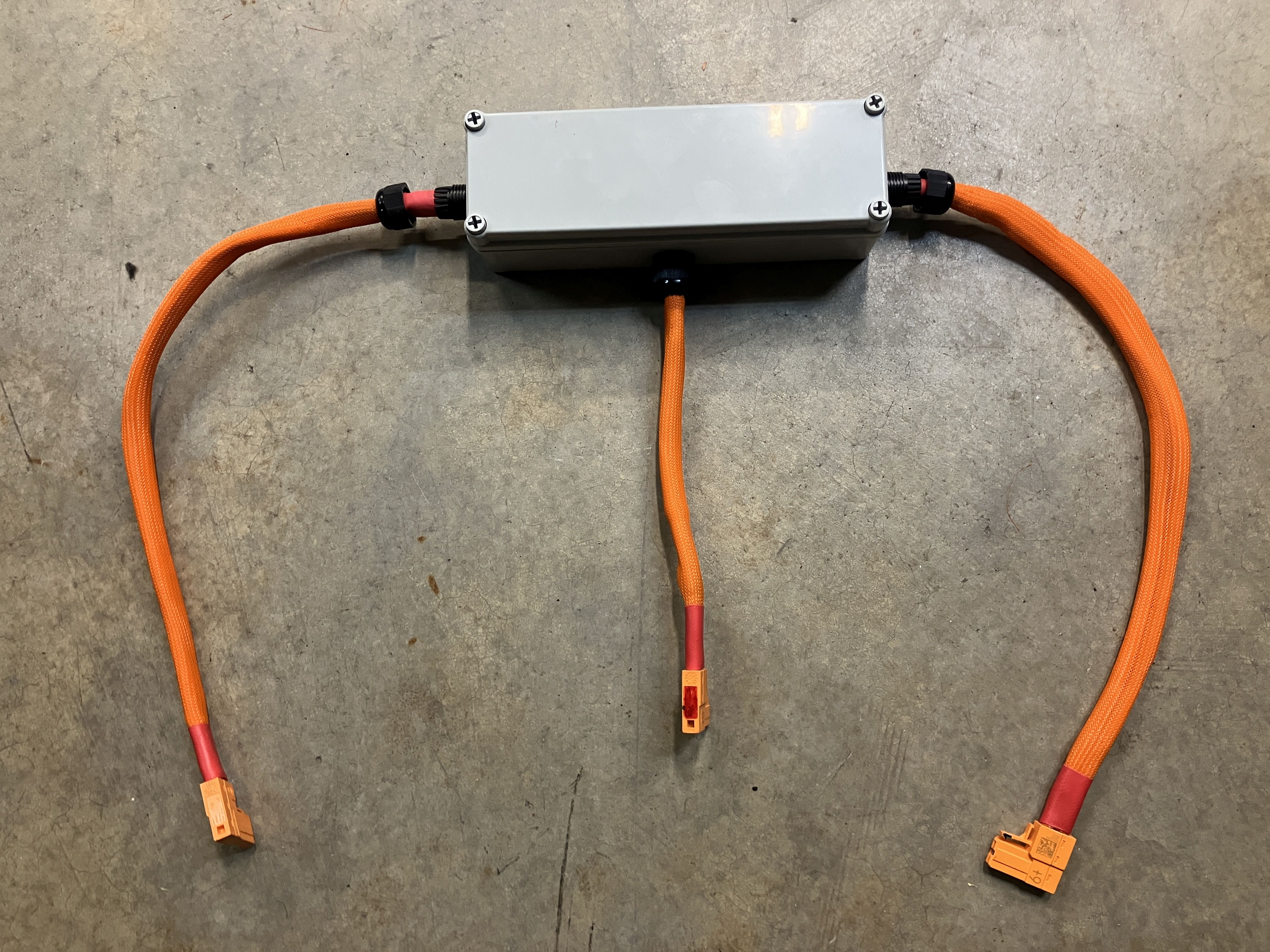

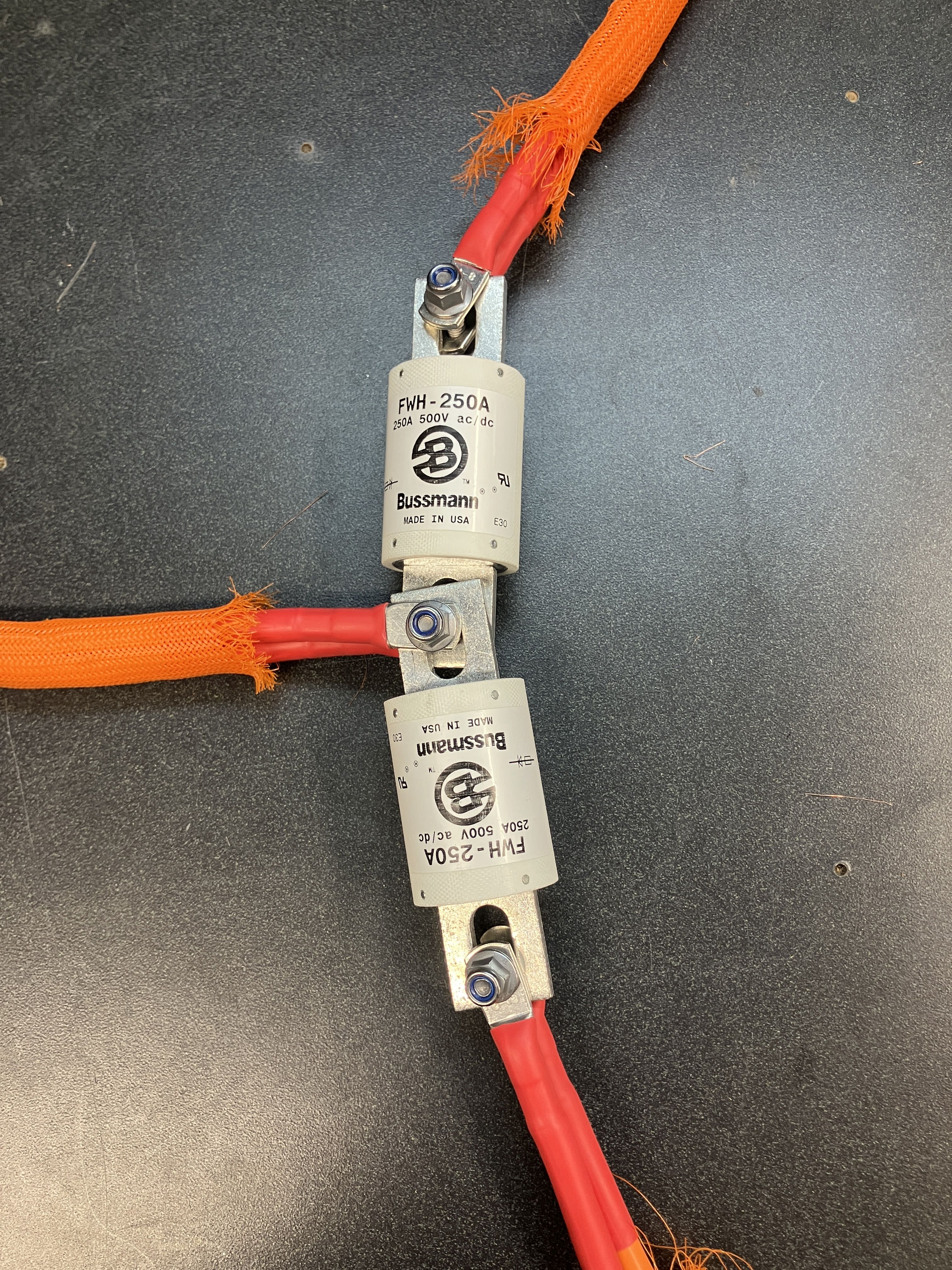

then it was time to move on to the Positive Lead
so this is the general idea, yes another T, however this time with fuses
these are the OEM 350 amp 450 volt fuses
Question: I am planning on downgrading the OEM 350 amp fuses to only 250 amp fuses to protect the parallel connection to the two 12 kWh battery packs, do you agree with this idea?

My understanding is that putting batteries in parallel increases overall current. So if your motor draws 1 amp with a 100a/h battery, it will take 100 hours to drain the battery (with 1 ampere).
Add a 2nd 100a/h battery in parallel, and you now take 200 hours to drain the packs with the same load.
However, your overall current difference has also doubled ( on paper). If your 1 pack was fused at 350Amps and you add a 2nd identical pack in parallel, you require 700 amps before any fuse blows as the packs will "share" the load.
I understand your additional pack is to provide more range - that is have a higher capacity ( like a larger fuel tank), but still keep to the same load.
So you want to protect your circuit from more than the initial 350 amps right? That would mean 2 X 175 amp fuses.......Or have I got it wrong?
I would say you need to monitor each pack individually and have extra HV relays between them that can be disconnected if large differences are detected....

If is total of 350A fuse required for load, put extra 350A fuse on third wire.. otherwise you will have 500A or 700A output current
