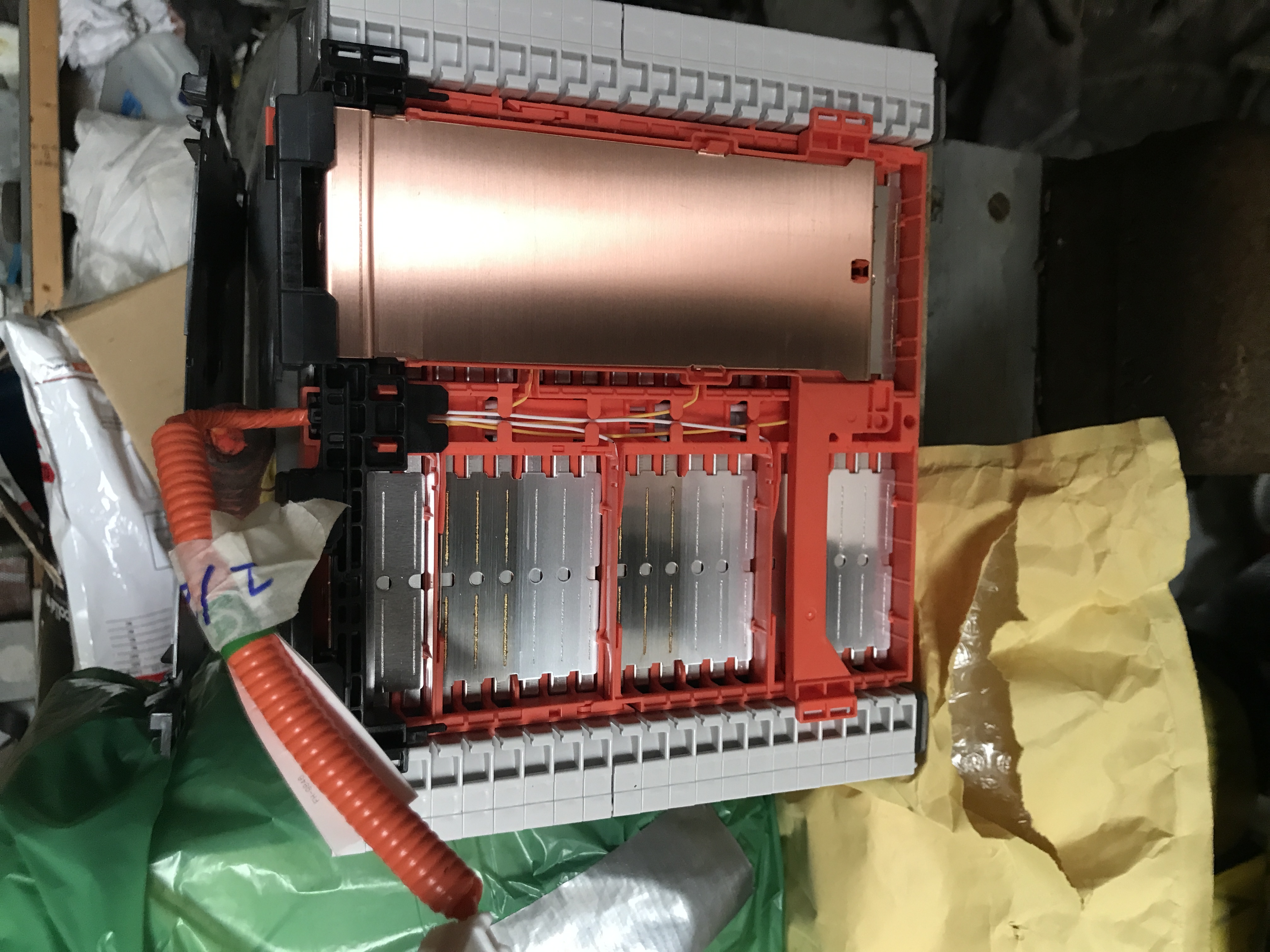

ianlighting wrote: Sun Apr 06, 2025 11:48 am What are you seeing?
Burn marks on the input/filtering/balancing circuits on one place, so the last connector in this case
BMS is always connected last and disconnected first. The pack is split in two as you mention, so is the BMS circuity in terms of protections for over voltages, thus no electrical references between the halves.

The Service Disconnect has NO influence on the BMS.
The BMS is electrically divided in two, the two halves are coupled in their communication by an opto-coupler (galvanic isolation). The is specifically so you can pull the Service Disconnect while there still is some load on the battery output, because at that instant, the full pack voltage will be across the service disconnect *in reverse*.
The BMS consists of a processor with a UART I/O and 24 ASICs that each handle 4 cells, the processor UART output connects to the first ASIC input through an opto-coupler, from there a simple level shifter connects every next ASIC to the previous one. Between ASIC 12 and 13 is the mid-pack Opto coupler (just like the Service Disconnect is in the middle of the pack), then again at the end of the chain ASIC 24 output connects via an opto coupler to the processor UART input. The processor addresses each of the 24 ASICS and each ASIC inspects the serial message if it has their address, if not they simply repeat the message on their output. If the address matches, they decode the message and send a reply, which will ripple further through the chain until it reaches the processor.
The important part is that each ASIC is connected to 4 cells, so it is *powered* from the 10-16V that the 4 series cells carry and the ASIC can also measure and balance the cells under control of the processor by applying a 430 Ohm resistor across any cell to slowly bleed off some energy and lower the State of Charge when necessary due to good cells having lower self discharge than marginal cells. Or temperature difference or ....
If the 4 cells are not connected in the order expected, the ASIC may see a negative voltage or a too high voltage and since there is no protection in the cell connections, that will burn a small crater in the ASIC(s).
Most common mistake is to use a wiring harness from a different generation than the BMS, because the connectors are physically compatible but the cell connections to the connector pins is different between generations. Poof.
Also if you have modified the bus bars and the cells are not connected in the same order in the string as original, then the BMS wiring will connect cells NOT in the same order as the BMS has the ASICs connected to each other: POOF. Lastly, if the cells are in the correct order, but you modified the BMS harness because you re-distributed the modules (I changed the pack for my truck into 3 stacks of 4 plus 4 stacks of 9 modules, so I had to modify the BMS wiring a LOT!) then your best bet before you plug in the BMS is to grab a DVM and a thin solid core wire or thin sewing needle that you clip into your Voltmeter clips and you *measure* *every* pin in the 4 connectors that plug the 96 cells into the BMS, so you can be *sure* that every cell is connected correctly. The Service manual has a nice schematic for the LBC connections, so use the tools and take the time to avoid letting the smoke out, I have never blown a BMS myself and I completely rewired several packs.

Nice detailed explanation, thanks @CorW.
I believe I’m in a good place, although I remain a bag of nerves (probably healthy way to be). Modules are in original order. Original BMS loom. 10 out of 16 BMS module connections are original, unmodified. Final 6 are extended (thicker wire). Irrespective if changes or not, pins on all connectors tested yesterday are as expected and match with the complete module voltages.
I expect I will stare very hard at it again and try to uncover some other cock up, but basically next step is a new BMS… :)
Assuming all that is good, I guess the only potential slight unknown is whether a 5 series BMS for a 62kWh is fine to swap for my sizzled 6 series 60kWh.

Bratitude wrote: Mon Apr 28, 2025 2:45 pm If it holds it holds. Better off temporarily balanced than how you are currently using it
Bit concerned that due to the construction of these modules from the 60/62kwh version of leaf, you can’t access individual cells. The BMS cable breaks out to 9 pins in this case (27 cells for a tall module) the module itself is 3p. So when leaf spy says ‘cell 55’, that’s the best granularity it can provide, but I actually have 3 cells that are ‘55’, and no way of knowing which of the 3 is suspect. If I was to directly charge using the relevant BMS pin, I can’t actually be sure how each of the 3 are performing.
And I need to buy a charger / power supply…
Example image of a medium size module with the front plastic removed. This example has 7 pins in the BMS wiring, for its 21 cells.

If you have cell taps, you can trickle charge the cell back up. A multi meter is all you need to find said cell.
