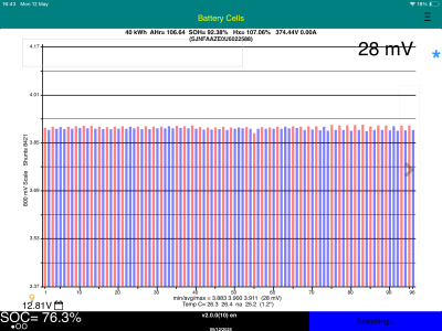

Manually charging / balancing.
Went ahead and bought a small battery charger / balancer for £30 - the ‘imax B6’. Only wanted to charge up the single weak cell, but thought maybe it’s other balancing features might be useful in the future.
So veeery slowly brought it up to match the rest over a few hours. Actually did it in 2 goes on 2 separate days as I didn’t want to leave it unattended.
Once it was matched, put things back together again and did a few goes around the block. That means 20 - 30mph, just to check everything still worked.
I could see the suspect cell was starting to drop a little compared to the others on Leaf Spy (range shown as 36mV) Nothing dramatic, but noticeable. So assumed this was an indication that the balancing was not going to work long term, which was kind of what I was expecting anyway.
But I’ve actually been pleasantly surprised since then. After some wiring tidying to get the 12V lights etc working with the VCU instead of the OEM mechanicals, went for a faster drive on a nearby main road. Variance dropped to 26mV…
Best I’ve seen it is 20mV, which is pretty amazing.
Following that, doing a slow AC charge, the spread has extended to 38mV, with the weak one lagging behind the others. But once driving, they equalise as the capacity is reduced.

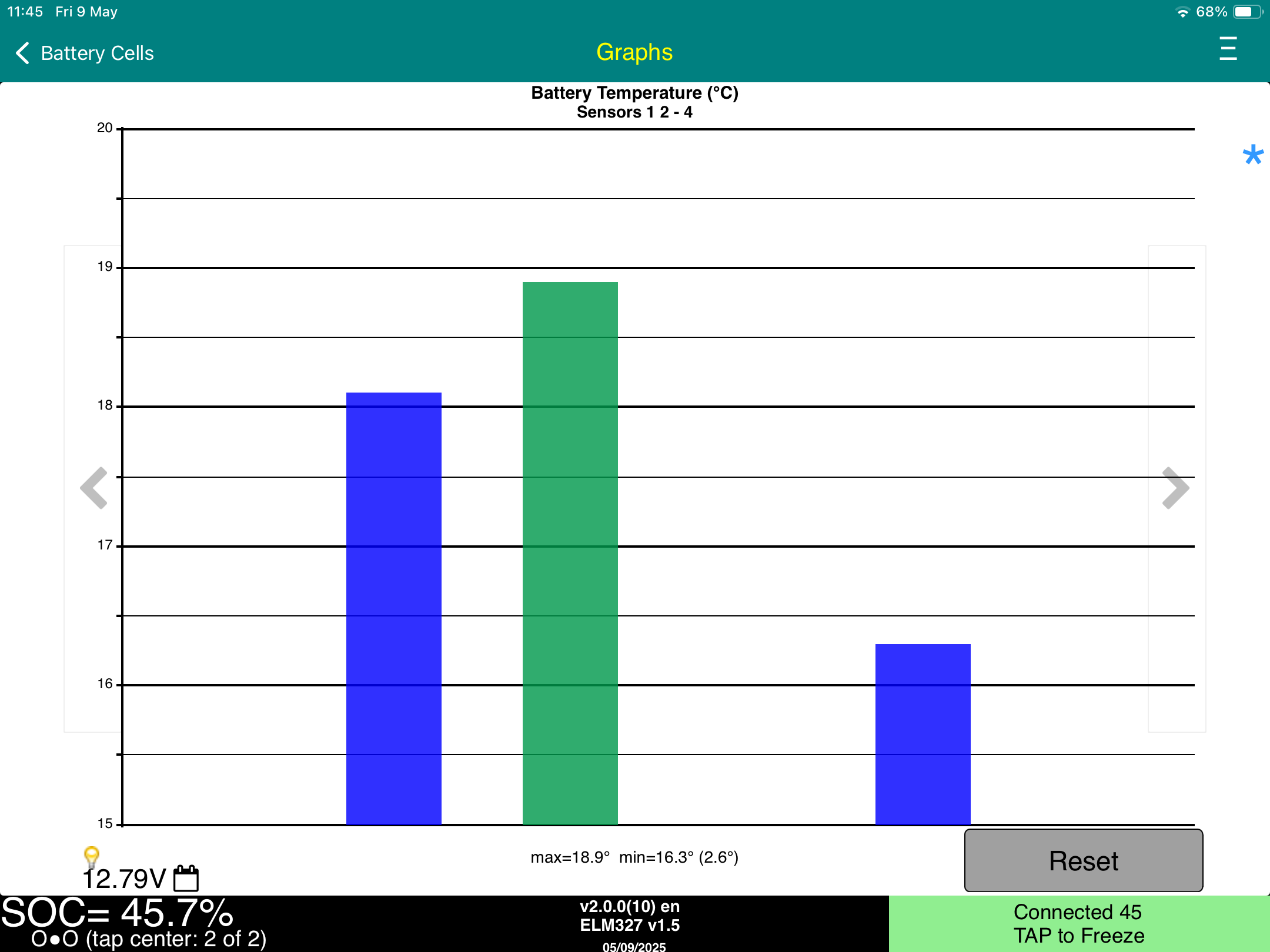

I’ve just done a 30mile round trip, and this is how the battery is looking, according to Leaf Spy now…
And battery temp while I’m at it…
What does it mean long term? Who knows! I don’t intend to be delving into the battery to manually charge up every few weeks, so will have to see if the BMS can stay on top of this for me, but looks kind of promising so far.

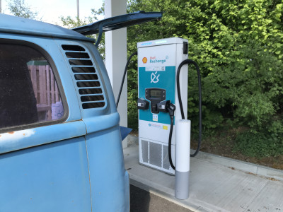

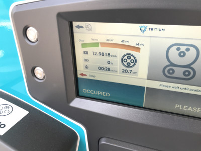

…so then I couldn’t resist when I realised a quiet local hotel had a Chademo, had to try it!
First attempt failed. Think it was because I plugged in with the car ignition off. At home with AC charging this works. It wakes the car up and charging commences. But with public Chademo, at least in this case, whatever handshaking goes on required the car to be ‘on’.
I managed to make the screen go to a black screen of death with a big Red Cross, with some message about voltage too low. It then went through a 5 minute reboot cycle, before letting me try again, which then worked.
You have to wonder if there can’t be a more elegant failure mode that doesn’t require a reboot of the charger. But then I’m not the software engineer.
I had my perverse fun of spending a few £££ for something I can get for free at home with sun and solar PV, and then drove home to use up some of what I’d just purchased.
In terms of Leaf Spy, mid charge, there’s 1 cell (67) that seems eager to charge up more quickly than the others. This peak disappears after the charge ends…
Warmest battery temperature was 23.5deg.
It was a pretty short charge, only 10 mins. But another useful step.

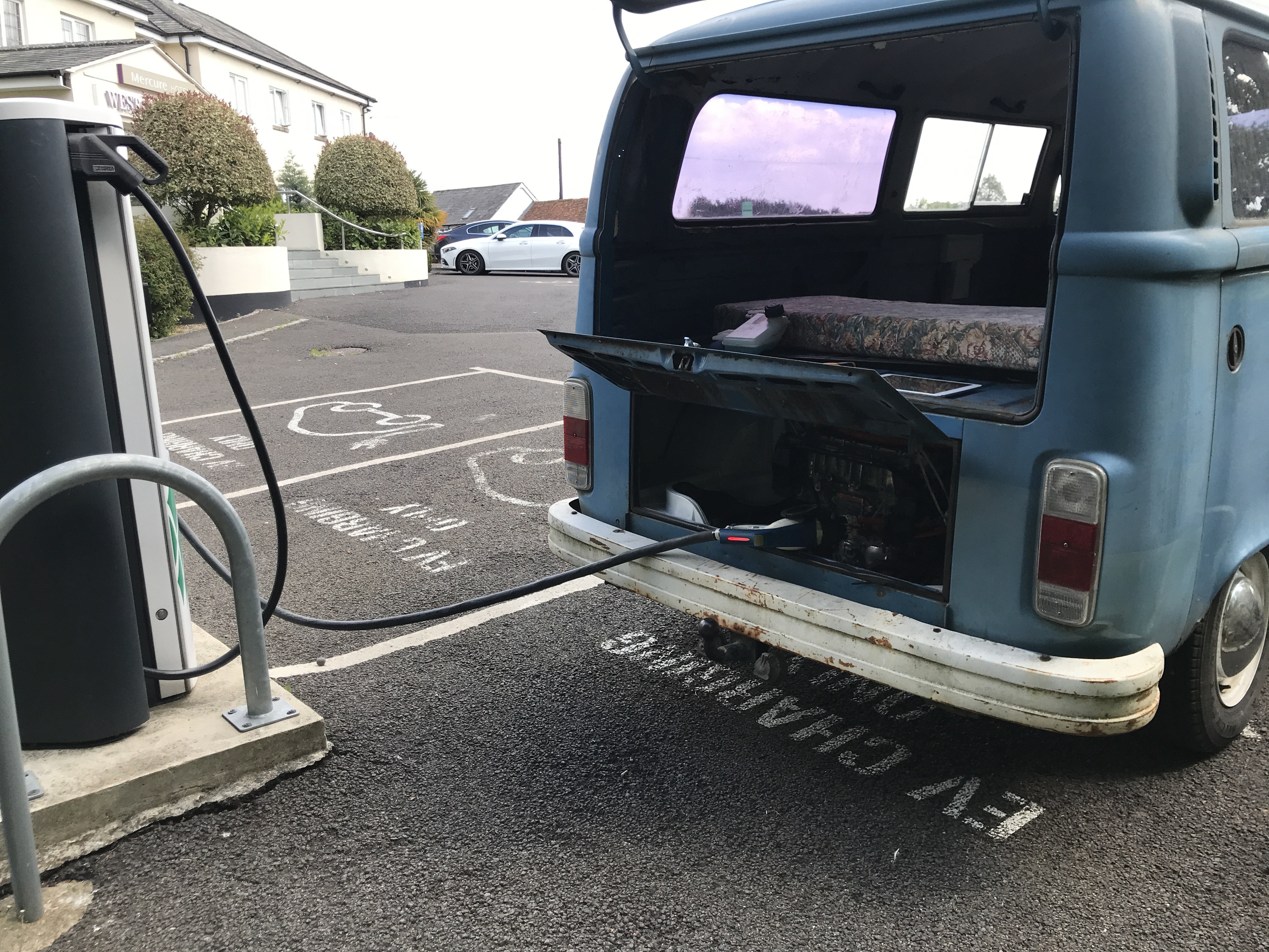

Decided for my next test that if I was going to burn somewhere down with a battery fire I’d rather do the Shell garage than the local hotel (dear lawyers, this is just a poor taste joke and not a statement of intent).
All went ok.
I’ve moved on from focussing on my weak cell 55 as he doesn’t seem to be much of a problem. Still a slacker, but nothing serious.
All the attention now is cell 67. As mentioned this is the first cell of module 11 on a 2meter HV extension and the first of 30 cell tap extensions.
Just to be sure, Ive remade the BMS connections to all the cells in module 11. Rechecked the HV for a tight connection and retested around the block and then on to the Shell.
So this is what I get to watch when Chademo charging. Playing chicken with battery cell! That 99mV can bounce around of course, think up to 150 at one point.
I called it quits at 85% SOC and with cell 67 reaching about 4.08. That’s an upper limit I’m happy with. I’d prefer not to experiment with that cell hitting 4.10 and higher, although happy to hear anyone’s thoughts on safe voltages for a leaf 60kWh battery cell.
Edit - this is only a rapid charging problem as far as I know so far. Should I have the need, I ought to be able to go higher on my home 2kW charging.
Battery temp got up to 26.5deg
Chademo charging started at 30-something kW, but then was down in the 20s. Did about 30minutes.
Once I was done charging cell 67 rejoins the rest of the pack. Then 15 min drive home and final LeafSpy when at rest.
