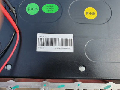

I'm sharing information about the MG5 LR battery I used in energy storage projects.
The 61kWh battery has a 96S1P configuration and uses giant 174Ah NMC cells from CATL.
The cells are arranged into six modules with two 8S groups.
Marking on the battery module:

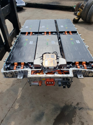

Arrangement on the cell's group:

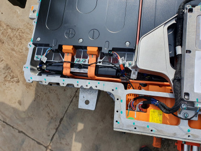

Each block has a BMS module:

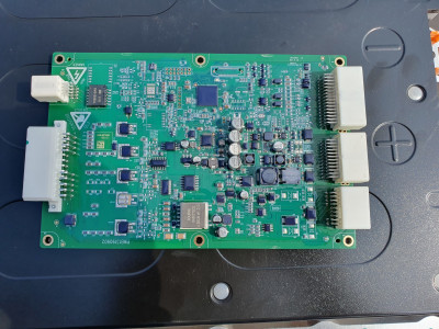

Inside BMS module:
The BMS has two sections for monitoring each 8S cell. It's based on ADBMS6815, a new-generation BMS chip from ADI. It can monitor up to 12S cells.
Unfortunately, it is under NDA, and the full datasheet isn't available to the public. I think this chip is the successor to the popular LTC6811.
A picture of the primary BMS:
It uses LTC6820 for ISO-SPI communication with slave BMSs.
I was able to reuse the slave BMS modules; more on that in the following posts.

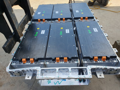

And finally, here is a picture of the battery without electronics and cables:

Hi Jamsen,
I have used the slave BMS modules and can help in this direction. But this will require some programming.
The ADBMS6815 is under NDA, which complicates the situation. Unfortunately, I cannot share the full datasheet.
My approach was to start with the code for LTC6811 and modify the code to work with ADBMS6815:
https://github.com/analogdevicesinc/Lin ... es/LTC6811
I'm using custom hardware based on STM32G491 MCU.
Also, I've searched the Github and found this:
https://github.com/526766987/Battery_Ma ... tem_36cell
It's based on STM32F407 + ADBMS6815 - I didn't test this, but it looks like a good starting point.
So, what hardware platform are you planning to use? You will need a LTC6820 for iso-spi communication.
