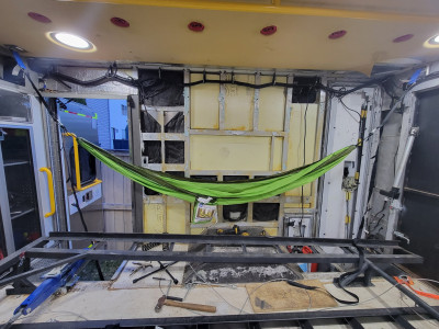

So my wife talked me out of the platform idea because she wants a hammock for the yard. I couldn't figure out a good way to span the back bay so I was about to buy some hinges and make a folding table that would work as a bed, but I guess the hammock is less work. I didn't realize you're supposed to lay in them diagonally though. Not sure that's going to work since it's necessarily so close to the wall. Feels comfortable enough to lay straight in it though...
Since I had already dug out the bits of e-track I saved, I just used them as anchor points for the hammock. Glad I kept the d-loops too because they are perfect for this.

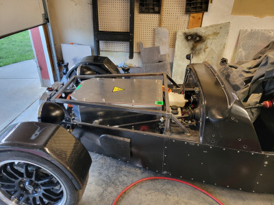

There's a line in the rule book that states the battery must be within the structure of the car (I heard elsewhere it was mostly there to make sure people don't put batteries in the side pods of a formula car without some kind of structure around them). I was a bit worried someone would complain about the battery being above the level of the chassis, so I built this just in case.

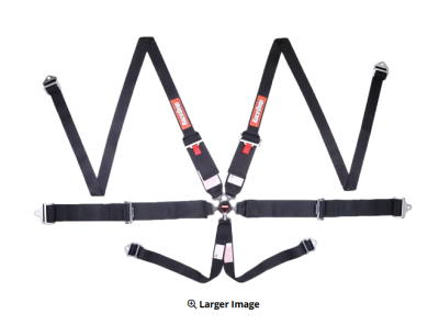

Turns out finding a 6 point harness in town is a little less easy than I thought, but I found a place that could bring one in. It's HANS compatible if I ever want to do road racing or something. I do need to verify it's not REQUIRED that you use the harness with a HANS device though. Apparently some are like that. Need to phone the manufacturer on Monday. It also has to be a 6 point and not 5 because when I built the car, I welded two anchor points below the seat.
The 6pt: https://www.holley.com/products/safety_ ... /747007RQP

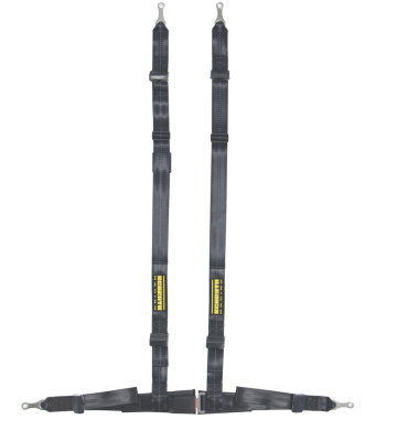

And what I currently have: https://www.schrothracing.com/item/rallye-cross/
Yes it's only 4pt, but one of the shoulder belts has a section that stretches in a crash and lets your torso turn slightly, like a standard 3pt harness. It's also DOT legal and easy to use, which is why I bought it. I may stop driving the car on the street though, so at that point it wouldn't matter. Especially if I also need to add the roll cage to run in BC. Still haven't heard back from them. I got a heads up they were going to discuss it yesterday and haven't heard anything since, so I'm thinking it might not be good news.

A hammock is definitely less work. Less stuff and weight to store too
6 point is definitely more comfortable, especially when you tighten it up.
Is this your only seatbelt? Do you need a DOT (not sure what Canada uses) seatbelt for driving on the street?
My caged car has the original seatbelts installed if I drive it on the street because my 6 point harness isn't DOT. You can find everything but availability / manufacturers who offered them was pretty limited last I looked 12 years ago or so. It's definitely nice to be able to drive on the street to check things before a race. Did I get all the air or of the brakes, coolant system running properly, etc.
Does your current harness have provisions for the anti-submarine straps? Some do, those might be easier to find. And if you're driving on the street you can leave those disconnected.

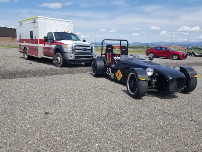

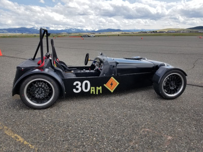

Just got back from an event in Montana. Had to move quickly to get ready and didn't have enough time to get everything 100%, but I made it work!
I found a 6pt harness locally that I was able to install. It's not DOT, but I'm leaning towards not driving the car on the street anymore anyways. Before I started this conversion, I asked my insurance company if there were any issues with it being converted and they said no. Two weeks ago I got the car appraised again since you have to do that after any substantial changes. The insurance company said "hold on, it's not powered by flammable liquid anymore? Now we won't cover any loss or damage". I called around a bit and got the same story from every other company. Hagerty told me they have an agreement with the province that restricts them from insuring EV conversions of any kind. Are you KIDDING ME?! I guess if I stop driving on the street, I can replace my tires with slicks and add some aerodynamics without worrying about range.

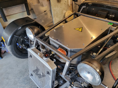

Anyway, back to the trip. The car did amazingly, drivetrain-wise. Drove nice and smooth. Everyone thought it was really cool, and most had never seen anything like it before. I was having a lot of trouble with losing the rear end going into corners. I kept adjusting the brake balance forward, but in small increments it wasn't doing much. Finally I made a big change (15 clicks instead of 2 at a time) and that finally got me into the right ballpark. I had expected to have to shift it forward a bit and started out maybe 5-10 clicks ahead of where it was with the bike engine, but obviously that was nowhere near enough.
I also had to turn regen way down. Right at the limit of braking, any amount of regen seemed to cause a rear wheel to lock up. I never really thought about it this way, but because it's an open differential I think the regen torque can get sent to one wheel and cause it to lock? Just like how one wheel will spin when accelerating. At least, that's my best guess about what's going on. Turning regen way down made the problem mostly go away, so I think I should try turning it off completely.
I wondered if there would be any trouble with cooling, but with the big radiator it was perfectly fine. The batteries stayed around 25c which wasn't too much above ambient temperature.
And speaking of temperature, the extra weight and improved balance helped me get the tires up to operating temperature, which is something that I had struggled with in the past. I was hoping that would happen!
This venue was pretty cool. It's also used as a police training track so they have a big skid pad and a small road course. My runs were 80-some seconds long, and we got 12 runs through the car. Each run used about 0.8kWh of energy. It would have been good to charge at lunch because the drop in power was noticeable, but I did manage to get through the day. There's probably 3 hours or so between morning and afternoon runs. I could probably get by with a 2000w inverter and 5kWh of storage in the ambulance, or a 2000w pure sine generator so I could charge anywhere on site.
So, things to do for next time (or some point in the future):
-Consider buying a set of slicks
-Add rear downforce
-Get a generator
-Consider adding a front swaybar?
-Consider buying the Nismo LSD?
-Replace hammock with a fold-down sleeping shelf
-Add insulation to the rear door of the ambulance (5*c overnight temp, 1500w space heater couldn't keep up)
-Figure out why the ambulance has soot in the coolant/low coolant level (Please oh please let it be a failed EGR cooler and not a cracked cylinder head)
Pics:
Video (Sorry about the quality here, somehow my camera reverted back to a different mode and I didn't notice):

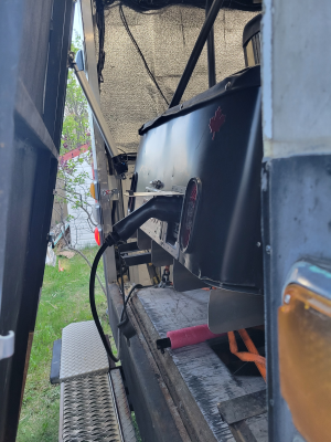

Also, one thing I did not consider when choosing the location for my new charge port, is that there isn't enough room to plug it in while it's in the ambulance. However, Foccci also isn't configured to shut off the EVSE when charging is finished, so I may reinstall the other charge port for L1/L2 charging. Oops.

Did you try raising the front end / lowering the rear? I'm guessing from your video, especially the end that your roll axis is off. Did you get to try the skidpad at all? I'm guessing the rear will let go first. You also need a bunch of extra rear roll axis bias because it's rwd. Are you able to throttle steer or does it just come right around?
Anti lift geometry / more of it very likely would help too but somewhat depends on what's going on.
It's looking like you have more front grip vs the rear as your main struggle after maybe too much rear braking. But if the roll axis favors one end too much this will also mess with your brake bias.
You may also find that a more progressive throttle ramp helps mid corner drivability. And if your throttle foot is bouncing during the video some more throttle smoothing would likely help too.
Regen is like slowing down with a parking brake in your case. You had a bike engine previously so not much decel as a comparison / reference.

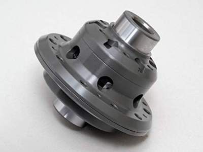

This makes a lot of sense. I have been researching lsd options, and the Nissan h233 has a clutch pack type, which means I can rebuild and adjust lockup/break away torque. Which for a daily driver, is going to be important.
From my understanding the nissmo diff is from quafie, meaning it’s an atb.

I have a theory about that too. When braking near the limit and the regen torque locks a wheel, it's going to be the wheel with less grip. In a straight line it might just be the one with less weight on it, and very likely the same one that would spin when accelerating in a straight line. The instant that wheel locks up, the regen torque has to go to the other wheel, adding to its net braking torque and possibly locking it as well. Maybe it wouldn't lock if you are already turning and there's a bunch of weight transfer already on that wheel? I wonder if I could somehow add wheel speed sensors that would alter the regen if a wheel stops?
Is the Nismo diff the only option for the Leaf reducer box? It's the only option I can find anyway. I think it would be fine for my application (at least from my other experiences with a torque sensing diff). Just have to actually get my hands on it.

Not sure you could adjust a helical diff at all, unless you got creative with shims maybe.
Doing some digging and apparently Cusco makes an LSD for the note e-power. Now the Nismo catalog seems to indicate the Nismo LSD is the same between the Note/Leaf and just the seals are different. I wonder if this Cusco would fit a Leaf reducer box? It's a clutch type, and they say it's a 1-way but the RS series also appears to have the ability to function as a 1, 1.5 or 2 way. Now since my motor is mounted backwards a 1-way would be more like a negative-1-way. The chart they have shows the 2-way configuration functioning the same in both directions but from the shape of the cross shaft I'm not so sure about that. At least it looks reversible from the exploded view.
Damn, that's kind of tempting. I can only find the Nismo on ebay for like $3k CAD, but the Cusco... https://atomic-shop.eu/products/cusco-l ... -note-he12

I don't know the fitment answer. Nissan may have used the same diff in the note/ leaf but a replacement diff may have clearance issues based on it's shape / size.
Most diffs won't be reversible but the cusco diff looks modular and may be able to be put together backwards. They will likely have at least a pin to prevent installing it backwards. It's definitely worth digging deeper into. You may also be able to buy the inner cross / cam to adjust the lockup profile - if they're willing to sell parts. But for the price you could buy a second unit and mix and match.
Helical diffs have different designs. From driving a few some do a little in decel and some seen to have no real effect in decel.

Post by Zieg »
Okay, haven't had much time to work on the car this past week but I have been able to do some research.
Update on the Cusco diff, I spoke with Cusco USA and they told me this diff only functions as a 1-way (no cams for 1.5- or 2-way). However, they did say they confirmed it will fit the Leaf reducer box (which I expected) and they think it should be fine to flip the internals so that it at least functions as a 1-way in the correct direction for my application. Should be getting a shipping quote soon and we'll see what that comes out to. I also want to do a bit more research to satisfy myself that a 1-way is worth the cost and effort.
Found a picture on the Japanese Amazon listing which might show the actual diff rather than a generic photo of a RWD diff.
Also working on a front swaybar design. It's going to be a little tight fitting it around the rest of the suspension but I think I have a plan. I'm going to go with 3/4" OD tube and get several different wall thicknesses. Then two holes on the ends for the endlinks so I can make lots of adjustments to dial it in. That should be easy enough to achieve this season, then over winter I can look at adjusting my suspension geometry.
And I'm looking at trackside charging options. Looking at the timestamps from my videos I had almost 3 hours elapse between the end of my morning runs and the beginning of my afternoon runs. I used about 5kWh in the morning so if I can get most of that back into the battery in 3 hours that would be great. Getting a 240v system seems difficult/expensive, but even L1 charging at 1500w would be pretty helpful. I've been advised by Thunderstruck that I really do need a pure sine wave fed to my charger, so that rules out conventional generators and MSW inverters. Trying to see what I can find on the used market in terms of inverters and batteries, or a portable generator. Looks like I want something rated for at least 1800w continuous if charging at 120v.

Do you have room on the ambulance roof for solar? There are some cheaper inverters that should be able to give you the 220v like a Deye. You could add batteries to the system too.

Ah, admittedly I don't really understand how the OI charging works, but the rulebook also has a few things to say about charging - including something about using common charge ports with an EVSE and the BMS has to control charging and all that. I'll double check though, and maybe I can add some code to my Arduino that's already on the CAN. Thanks for the idea!
I do have room on the roof for solar, yeah. Eventually it would be awesome to have some panels on there charging a bank of batteries. Maybe like a 230v/50hz inverter if I can find one cheaper than a 240/60 unit? One with a 12v input might be handy because I could start with smaller batteries and supplement by running the engine if need be, but that's a lot of current - even for my dual alternators.
