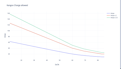

I've now got CCS charging with FOCCCI on the BMW (viewtopic.php?p=78345#p78345) but it uses the max charge rate from the BMS, which is pretty slow as the Kangoo ZE never had rapid charging.
As you can see at: 11% SoC the max charge rate is 63A battery was at 14 degrees C.
So I put it on charge (3kW) and took a look at the derating:
11% -> 63A
60% -> 20A
69% -> 15A
83% -> 10A
Batteries at min: 12oC max: 15oC
I'm thinking I want to implement my own offset to raise this, based on temperature, so maybe if min cell over 10 and max cell under 30 and charge limit > 10 then either 2 or 2.5 multiplier.
What's peoples thoughts on this? Should temperature have some affect on the multiplier?
Been thanked: 1918 times
Re: [Driving] BMW E91 320d 2006
Yes it should. All OEMs derate at low and high temp. I tried to replicate what VW does:
https://github.com/jsphuebner/stm32-car ... mebbms.cpp
Posts: 1884
Has thanked: 91 times
Been thanked: 517 times
Yes, I was thinking of sticking to the BMS limits outside of a specific temperature range. Within 10 to 30 degrees just multiply by 2.5 the BMS given limit.
Or.do you think that I should also modify the multiplier within this range also, based on temperature?

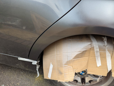

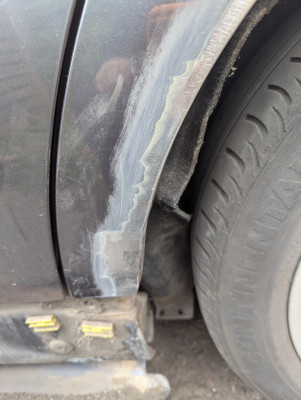

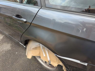

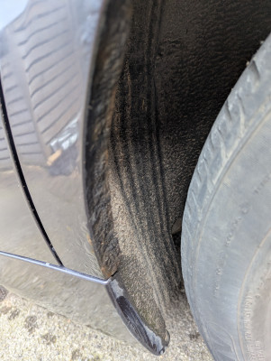

So, the first year is almost over and renewal time for the insurance, looks likes it's going to be £1000 again.
Over last few days I've been tackling the rust on one of the rear arches.
Thankfully it was just surface rust.
Not perfect, but a lot better.
Next I'm working on mounting the AC compressor...
