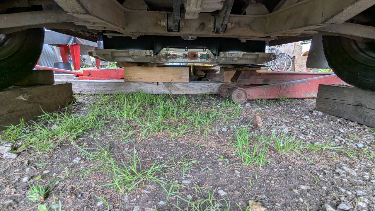

Opening the battery means dropping the battery first. That's easy enough with a lift, but I don't have one. And renting a trailer is expensive, so I had to make do with what I had - three shunting jacks, some wood and 6-Ton car stands. This was my procedure, which worked well:
  • Jack up the car and put it on the stands (doesn't need to be too high)
  • Remove the 12V battery and wait 10 minutes! The HV battery is not safe otherwise!
  • Remove the 2 nuts and 3 screws (10mm spanner) holding the protective plate in the middle at the front of the battery (it has a high voltage sign on it), then remove the plate
  • Disconnect the tool-less HV and auxiliary connectors, don't forget the grounding cable (10mm spanner). Especially don't forget it on reassembly!
  • Put tape over the receptacles and the plugs to avoid dust entering them.
  • Put two long wood bars under the battery as rails to drag it out sideways (you have the most clearance between the jacks there)
  • Support the battery with one jack in the front and two in the back (one in each corner)
  • Build three wooden cross stacks symmetrically to the points where the jacks are on the battery
  • Ensure that the jacks are still solidly supporting the battery, then loosen the screws (13mm hex head) fixing the battery to the frame. Don't put your head beneath the battery!
  • Slowly let the battery sink down using the jacks. Remove wood from the cross stacks as you do it.
  • When you are almost done, put round wood bars (like broom sticks) beneath the battery so you can roll it like the Egyptians did (dragging it was way harder than anticipated)
  • Roll it out and you are done!
How will I get it back in? No idea, that's a problem for future me.

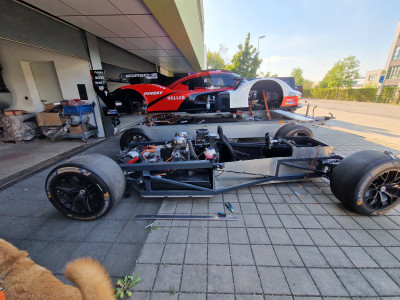

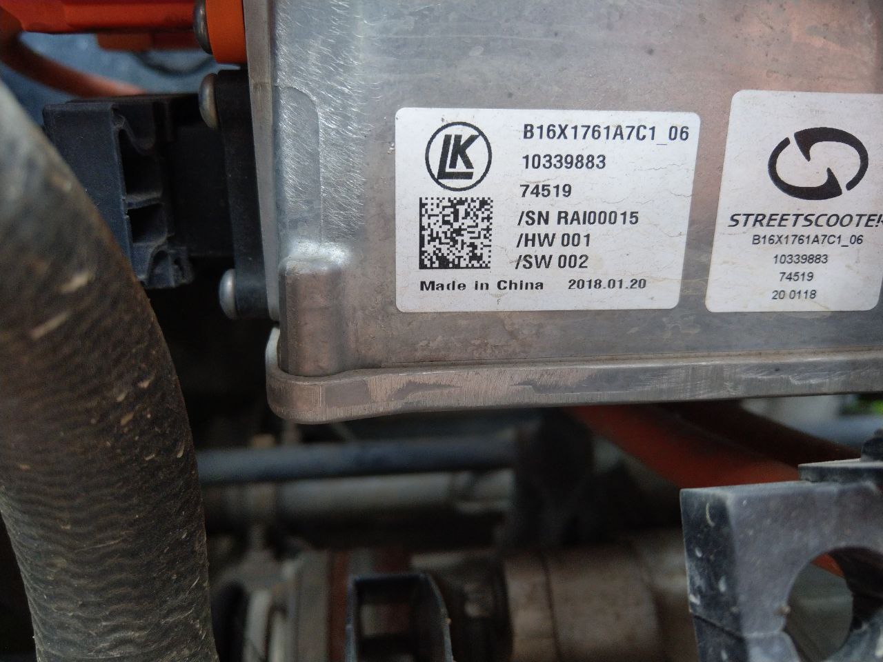

I have dismantled an older one and used the technology for a show vehicle. Many of the CAN messages are the same. It no longer looks like a Street Scooter. ;)

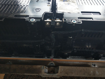

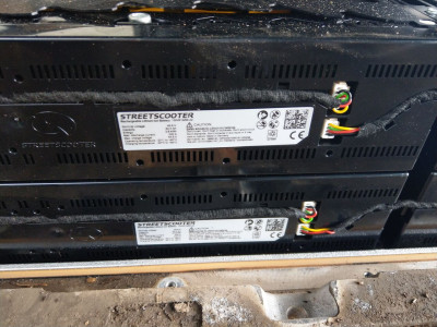

I opened up the pack today with appropriate gear and was greeted by a few surprises. First of all, I was completely wrong in my assumption about what type of modules I would find inside. The type V6-16M does not contain prismatic cells, but 18650 cells! There doesn't seem to be any relation to BMW, but the actual manufacturer of the battery modules (maybe not of the BMS, more on that later) has a similar name: "BMZ". Searching the web, there are mentions that StreetScooter had batteries produced by BMZ, so that checks out.
The battery and its modules.

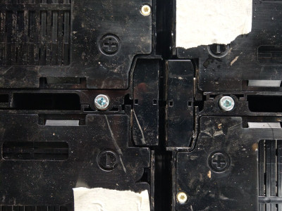

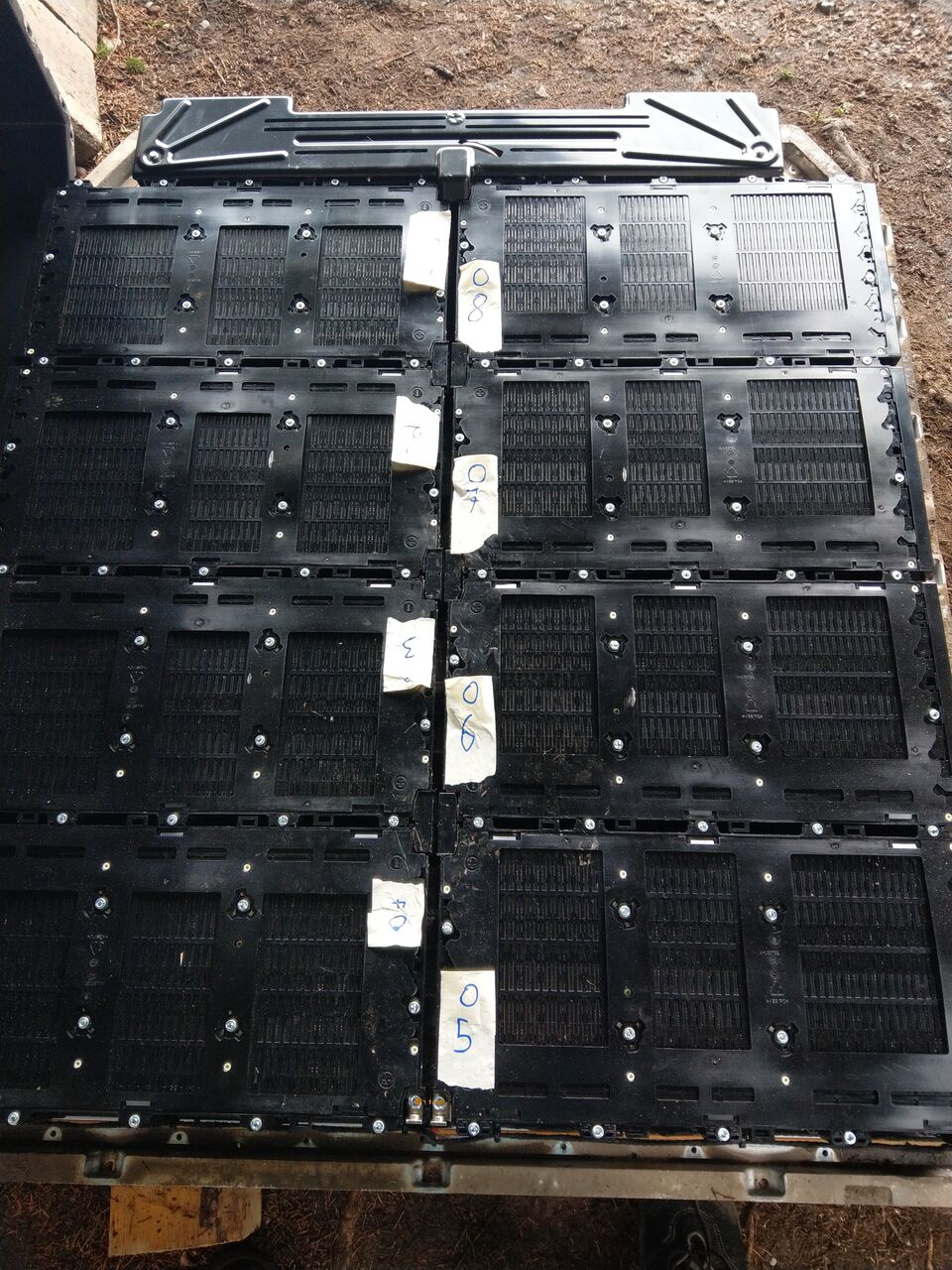

Working with these modules was not as easy as expected. They are nice and symmetrical, but stacked two layers high, which has some downsides. More on that later. Here is how I dismantled the battery, with some added optimizations (note that I did all of this with appropriate rubber gloves, thick protective clothing and an appropriate faceshield):
  • Remove the bolts that hold down the plastic battery cover and remove the cover. A rattle gun is really nice for this.
  • Label the modules on top and take a photograph so you can put them in the same order on reassembly. I don't know if the order actually matters, but I would assume so until proven otherwise.
  • Remove all of the visible long metal bolts holding the modules down. There is a lot of them.
  • From every balancing cable, remove one plug. I always removed the short side and left the long side in place. You need to push in the latch and don't yank on the cable! Image
  • Now, to split the first string into two parts with 200V each, remove the bridge cover opposite of the HV plugs (don't remove the HV box cover until later!)
    You will notice that you can only do this for the upper string, the lower bridge cover is blocked by the upper modules. In my opinion, this is a stupid and service-unfriendly design. Removing the covers is needlessly difficult. You need a tool for this that is strong enough to bend the hook, but is either non-conductive or well insulated. I used a ground down glas fibre reinforced plastic rod. The hooks are really fragile, I broke a few while removing them. I will see whether I can 3D print replacements. Again, not very service-friendly.
  • Remove the bolts holding the bridge down and then the bridge.
  • With the added safety, now remove the bridges one step closer to the HV plugs.
  • Now you can remove the first module (labeled 5 in the image above).
  • You will see that you can't remove the other module (labeled 4), because it is held down by module 3. But you can lift it up a bit to remove the cover of the middle bridge of the lower string. Split that string now, for added safety.
  • Remove all bridges from the top string
  • Open the cover of the HV box containing the contactors and the BMS coordinator (I sadly don't have a great picture of this as my phone battery died before I could take one)
  • Carefully remove the busbars connecting the upper string to the HV fuse and the ground contactor. You will see that you can't remove the lower busbars yet. Great design, striking again.
  • Replace the HV box cover, but don't screw down the bolts
  • Remove all modules from the top string
  • Label the lower string and remove all bridges
  • Remove the lower busbars, then you can also remove the modules of the lower string

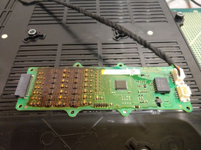

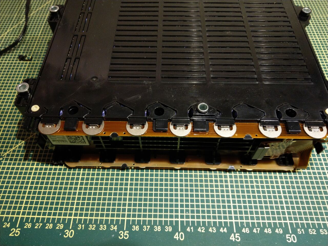

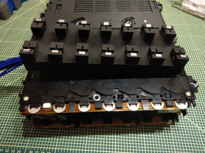

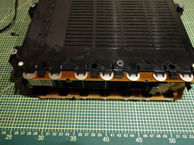

With one of the modules at my workbench, I started dismantling it. I found out that you don't need to (and also shouldn't) remove the plastic bolts holding the top and bottom module covers. The threads strip extremely easily. Instead, you can access the BMS board by pressing in one of the plastic clips on the side:
The BMS "slave" board itself is quite an interesting (cost optimized?) design. There are no components on the bottom side and I can't see any transistors, which I would usually expect. But there are some big resistors, so maybe the single chip does all the balancing itself?
This is the text on the chip:
AA1N14T2A
MC35771ATA1
CTAL1820D
I wasn't able to find a Datasheet for the chip. Volkswagen was mentioned in the search results, so that might be a clue.
That's it for now! At some point, I might post about the insides of the HV box, but for now I want to focus on charging and balancing the modules. Tomorrow, I will start designing a safe connector.

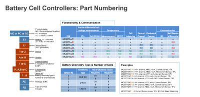

my googling has led me to this link.https://tr.aliexpress.com/item/1005008459058700.html. The MC33771ata is sold there, the photo shows a MC35771ata. Further googling shows that it is a BMS chip from NXP. The datasheet at mouser https://www.mouser.de/datasheet/2/302/M ... 517286.pdf. I think the two are at least very similar.

This description states that the “33” only describes the destination market. The entire type designation is also explained there.
AMF-AUT-T2812.pdf

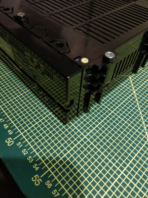

Jacobsmess, I took these measurements. Are they sufficient?
523mm (including the terminal protrusions) x 282mm (including the side
protrusions) x 76mm (excluding stacking protrusions).
The width between the case sides without the protrusions containing the bolt holes is 257mm.
On the bottom of the module, there are stacking protrusions that increase the
height by 6mm. The distance between the outside of the module case and the
center of the bolt holes is around 6.5mm on both sides.
I can't take very precise measurements right now, so all these numbers are +/-
1mm.

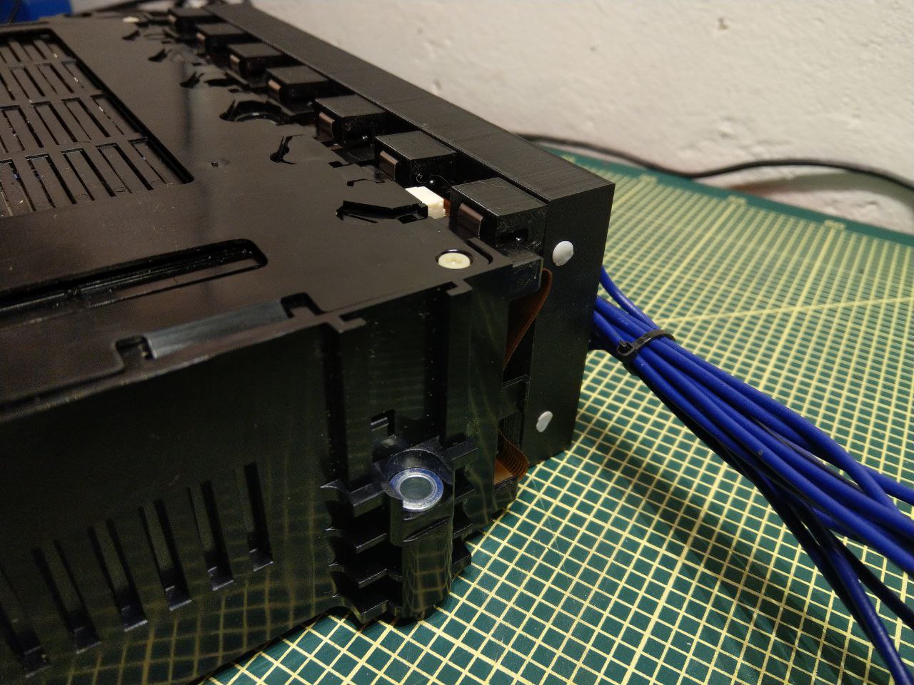

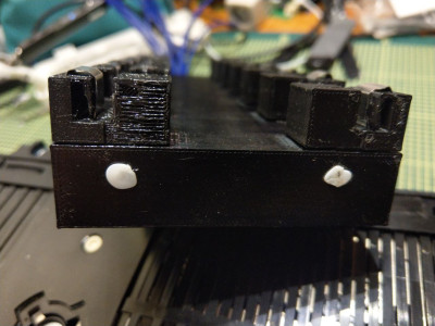

Current progress: I made a plug that connects to the side of the battery so I don't have to get 14 connections right 16 times but only once.
You can find the CAD files on Thingiverse: https://www.thingiverse.com/thing:7060814
An active balancer and a BMS should arrive this week and with those I should be able to get these modules charged. My most capable power supply can go up to 50V, so with around 3.84V per cell it should be enough to charge and balance them for now, even if I can't charge them up completely and do a perfect top balance.

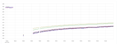

Time for another update (and the next one probably won't come earlier than in about a month).
I'm currently charging and balancing the modules one after another. This works fine, but takes lots and lots of time (at least I don't have to actively do anything). I am using these components:
  • Two 140W Lenovo laptop PSUs in series. This works fine if you use a plugs without an earth connector (IEC 60320-1 C8) and modify the receptacle (IEC 60320-1 C5) inside the PSUs to accept them
  • Ruideng DPH5005 Buck-/Boost module. Usually, this is my lab bench power supply. Now it's being used as a charger at its maximum settings. It's limited to 5.1A, but that's fine. If the whole pack were to be charged with a current of 5.1A, it would consume around 3.8kW, which is the power a normal European circuit can provide. 50V is slightly below the theoretical module voltage of 54.6V, so I can only charge each cell to 3.85V.
  • No-name Amazon BMS. I rely on this to stop the charge if any cell reaches 4.2V so the balancer has time to pull it down again. I don't expect that to ever be the case though because I only charge each cell to 3.8V so there is a lot of wiggle room. I'm also monitoring the voltages myself.
  • Daly Smart Active Balancer. (1A, the one with the two UART ports. Daly doesn't seem to have real type numbers.) I bought this, because it is relatively cheap, balances much faster than the resistive balancers on most BMS and allows me to read out the voltages using Bluetooth. The Android app (you do need it for setting up the balancer) is utter crap. I have a hard time understanding how you can fail so hard at building a simple app. I didn't manage to get it to run on Lineage OS. The voltage readouts don't always seem quite right, but they move in unison so maybe an internal voltage reference is bad? Anyways, it does the job but buyer beware.
  • Raspberry Pi B+ with a Bluetooth dongle
The Pi is the fun part! Standing on the shoulders of giants, I cobbled together a proof of concept Prometheus exporter that reads the cell voltages over Bluetooth. It doesn't work very well, but work it does! Now I can monitor and graph the voltages without the crappy app. Here you can find it: https://github.com/hamadmad/python-daly ... xporter.py
This is one of the better modules beginning to charge (and you can see a finished module that took three whole days to balance).
It's quite interesting to see that on some modules the 5th cell is low, while cell 1 and 13 are usually high. On the previous BMS child-boards, the area around the bleeding resistors showed brown discoloration, while the conformal coating on this board is completely clear. I think it's possible that this is not only due to unmatched cells but also due to bugs in the BMS software.

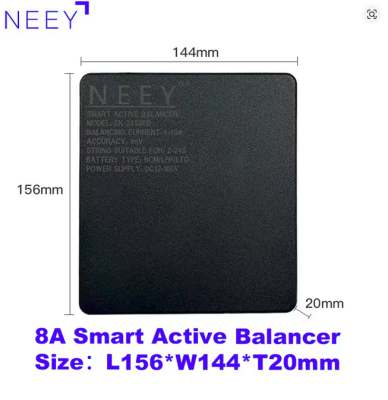

Finally, a question to you all: Can anybody recommend a better active balancer (or an alternative fully automated and remotely observable solution) that doesn't break the bank? Currently, this is my main bottleneck because I can charge a lot faster than I can balance. I would be fine with paying around 50€ for anything significantly better than what I currently have (and I know that's very little money, I would just like to know whether I missed any much better option).
Posts: 6769
Has thanked: 384 times
Been thanked: 1589 times
Re: [WIP] StreetScooter Repair and Reverse Engineering
There's this https://openinverter.org/wiki/16-cell_BMS but it balances very slow. Merely meant to keep cells balanced not to balance a very uneven pack
Proton
Posts: 327
Location: Georgia/US
Has thanked: 191 times
Been thanked: 49 times
Post by Proton »
This is what I used to balance one pack at the time. balances with 4Ah. It is very fast.
Same balancer I use on my battery for my solar system. I do not use a BMS but just this balancer and my solar inverter starts and stops the charge based on the pack voltage.
This is the latest 8amp version but the 4 Amp version is cheaper.
https://www.aliexpress.us/item/32568029 ... pt=glo2usa
I would have used this on my car because is very very reliable but you need 6 and they do not communicate together. Also it is bluetooth and no can messages. I have 2 running on 2 different batteries and they are solid as a rock.
