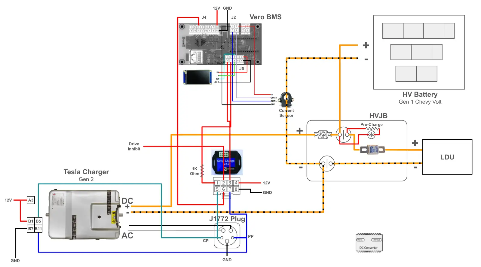

Here's my setup:
Tesla EVSE with adapter to J1772 plug.
Plug is wired to SimpCharge and then to VeroBMS (similar to Simp BMS) for CP and PP.
I have the 12V charge enable signal from the BMS/SimpCharge wired to the 2 Tesla Charger 12V in connections (A3, B1)
Power wires from plug go to charger via fuses
For testing, I've also spliced the PP and CP to go from the plug directly to the Tesla Charger connections (B5, B11) and given the Charger 12V directly (not from BMS). So I can see the wifi go on, but nothing else happens.
Currently, when the plug is connected and the EVSE thinks it's on, the PP to ground measures 0 resistance.

Re: Tesla Gen 2 Charger configuration help
Not possible, you cannot splice charge point signals.
Please provide the parameters of your charger settings.
Please provide pictures of your setup.

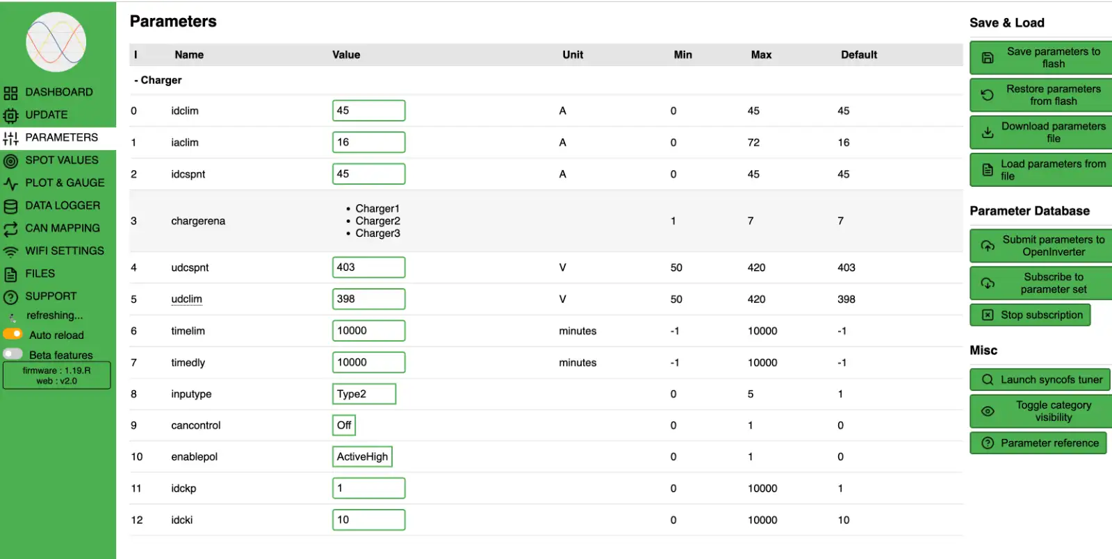

Here's my charger settings:
Here's the charger related items of my setup. If I can't splice the CP and PP signals, what is the easiest way to connect the simpcharge to the Tesla Charger connections B5 and B11?
Not. The Tesla charger needs to be permanently powered B1.
The BMS can be used to prevent charging starting by not providing 12V to A3.
The Charger will request HV by grounding pin A6 HV Enable - this is required for timing reasons, I do not believe you can have HV permanently connected, but it has been over 8 years since I wrote the original Tesla Charger control code.
https://openinverter.org/wiki/Tesla_Mod ... N2_Charger
Also add a ground to the charger case.
PARAMS
They do not look right to me, have a review of the wiki and change them to suit your setup https://openinverter.org/wiki/Tesla_Mod ... 5_Software

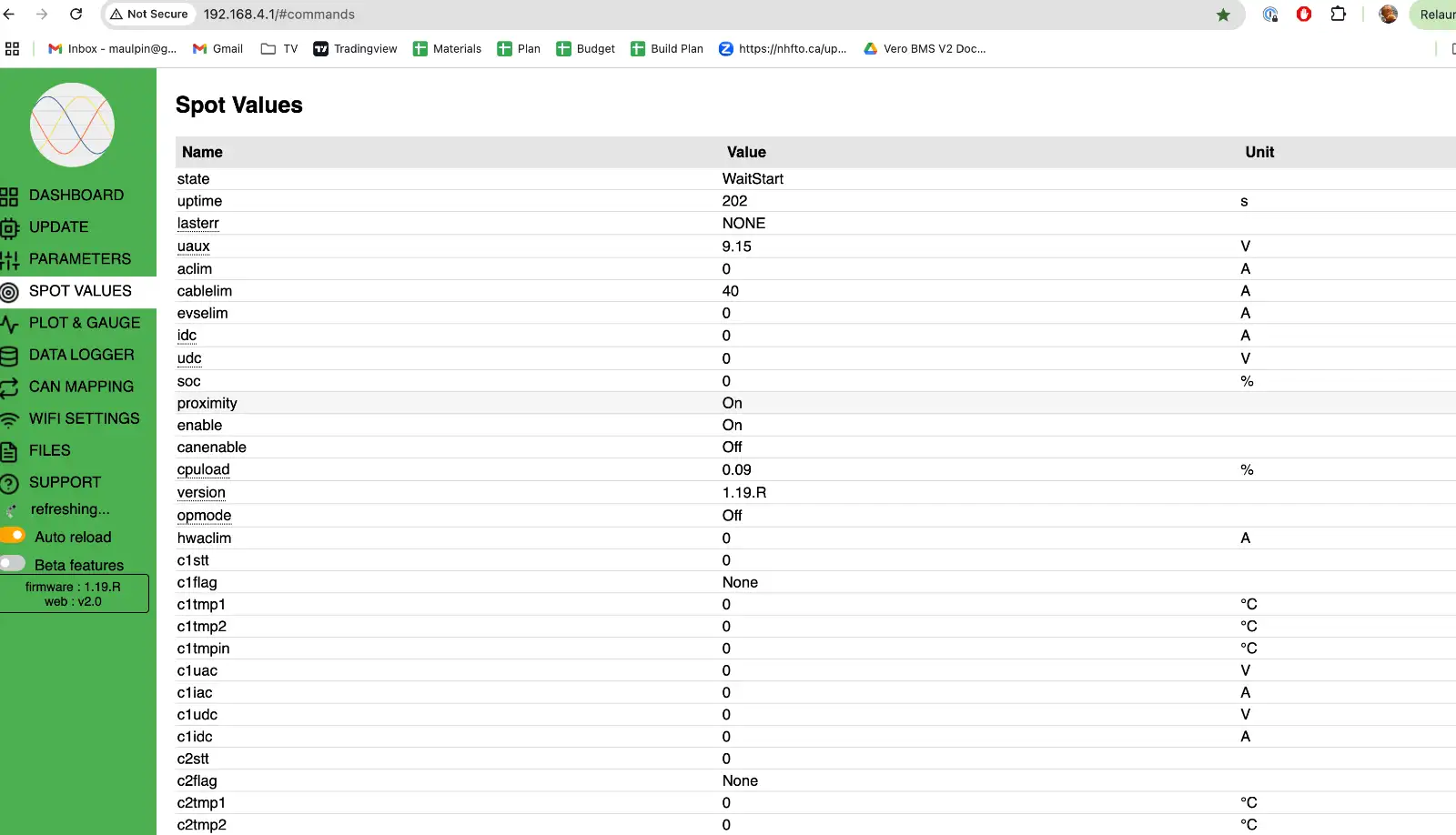

So here's what I did:
- Connected pin A6 on the charger to ground
- Connected the CP directly to B6 and PP to B11 (no longer spliced)
- Changed input type on the charger config to Type 1
Then I connected AC and DC voltage to the charger and then plugged in the EVSE. Unforunately, the power module LEDs still remain unlit and my spot values are the following:
Is my charger bad after all of this?

I do not know how the latest verson works it is still in wait state for some reason. and in op mode off. There are also more spotvalues than just those you show.
Your EVSE Lim shows 0, do you have a dumb EVSE and not a Tesla one? Or can you set your eve to a dumb version as the Tesla EVSE does not talk "type 1" pwm but a digital tesla protocol.
Fact EVSE Lim or AC Lim is 0 leads me to believe there are issues with your EVSE or charge port wiring.
Did you ground your charge port to the charger?
