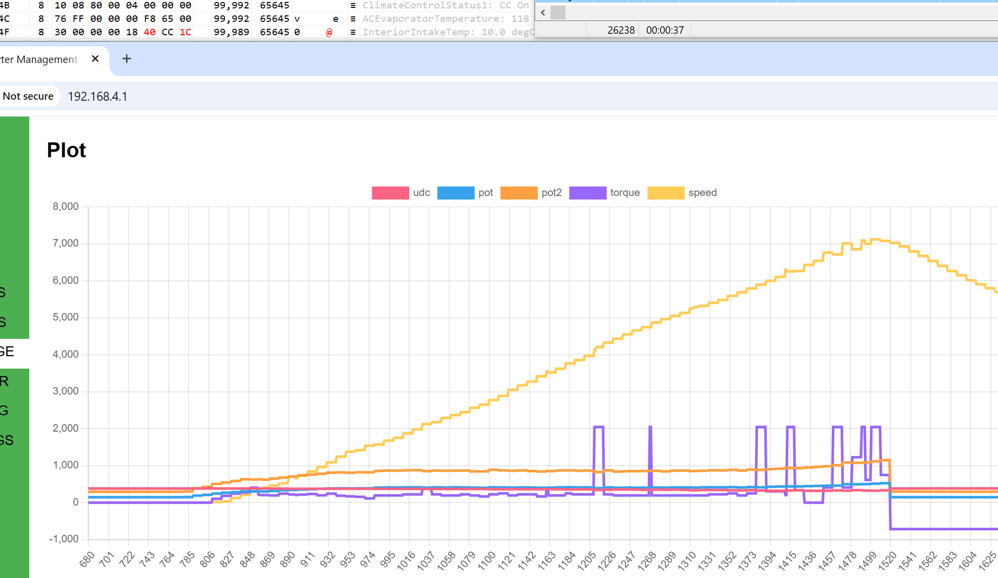

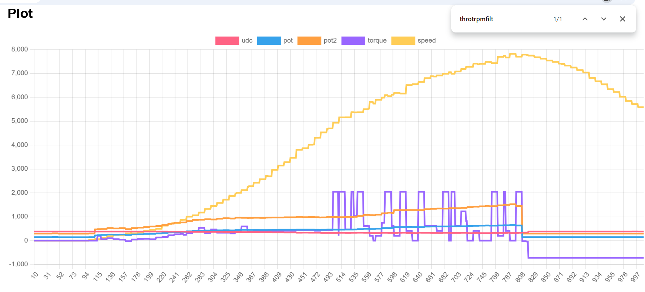

larsrengersen wrote: Mon Jul 14, 2025 12:05 pmSmoothly
It is just my feeling, the car didn't shake
My problems with Verter are : the car shakes, and not getting revs. The original assembly is just for reference, to be clear whether it is software or hardware. If the same setup is going smoothly with Leaf SW, then it is Verter SW or the settings.
Referring to the last logs, Verter is actually getting 6800 revs, but wobbling.
My current question, why Verter can drop the torque request? Why is it not linear?

vitecd wrote: Tue Jul 15, 2025 1:52 amthe settings
Zombie is designed to work with 100s if not 1000s of combinations so it needs tuning for every setup.
vitecd wrote: Tue Jul 15, 2025 1:52 am why Verter can drop the torque request
UDCmin is being approached so it drops the torque requests. The fact the battery caves so hard and goes widely out of of balance on the cells means the pack is done for and not suited for your application. I am suprised the "leaf hardware" accepts this shitty of a battery.

tom91 wrote: Tue Jul 15, 2025 7:39 am it drops the torque requests
Well, but why is it not limiting? I mean, after drops, it rises immediately, and fluctuates up and down continuously.
I've charged the Leaf and am going to explore some ideas. The battery is just for "bench" testing; I've another one on the shelf in cells that I can put together after I understand what to do in general.
Can anyone advise me on the base setting and something to play with, please?

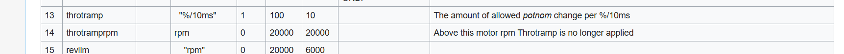

On your vehicle, the battery IS toast as previously mentioned. If you want to keep testing Zombieverter regardless, you need to adjust params to keep the setup happy, meaning you need ways to limit the max current draw to mitigate the voltage sag to levels the battery can handle.
My experience is on Zombieverter 2.22A official and 2.23 testing, just to tag this bit of information for anyone finding this post with search
Unlike the Leaf VCU, Zombieverter DOES NOT adjust the max torque request based on what Leaf BMS tells is allowed, so that's probably one of the reasons you can have a smooth accel and drive with Leaf VCU but not with Zombieverter.
On the latest params you uploaded, try to reduce throtramp (1 or lower) and put the throtramprpm to something close to or above the max rpm limit.
You can see on the plot that at 1800rpm, throtramp stops and then torque/speed spikes
Also test what adjusting throtmax between for example 50-70% does to the feel.

J0hannes wrote: Wed Jul 16, 2025 8:56 am On the latest params you uploaded, try to reduce throtramp (1 or lower) and put the throtramprpm to something close to or above the max rpm limit.
I had not spotted this yet, indeed this will cause very erratic behavior. Changing throtramprpm to lets say 12000 should dampen the shuddering ALOT.
@vitecd take your time to study the parameters of the zombie and when testing only change one thing at a time.

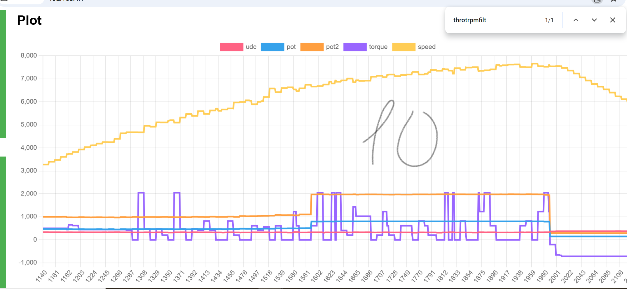

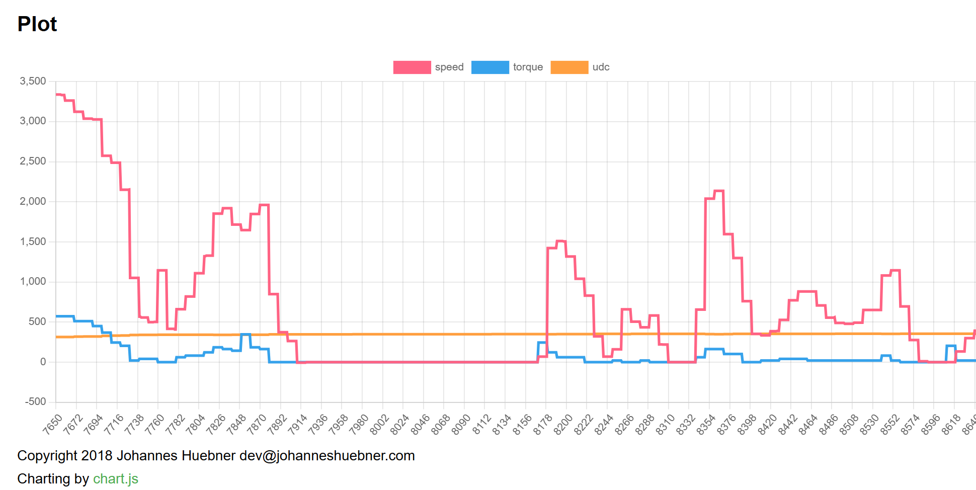

Spent some time to play on the road.
Picture and a CAN from the same ride attached
for screenshot.trc.7z
(96.31 KiB) Downloaded 65 times
vitecd
Posts: 29
Joined: Thu Jul 18, 2024 1:42 am
Location: NZ
Has thanked: 15 times
Re: Nissan Leaf Stack not getting revs underload
Post by vitecd »

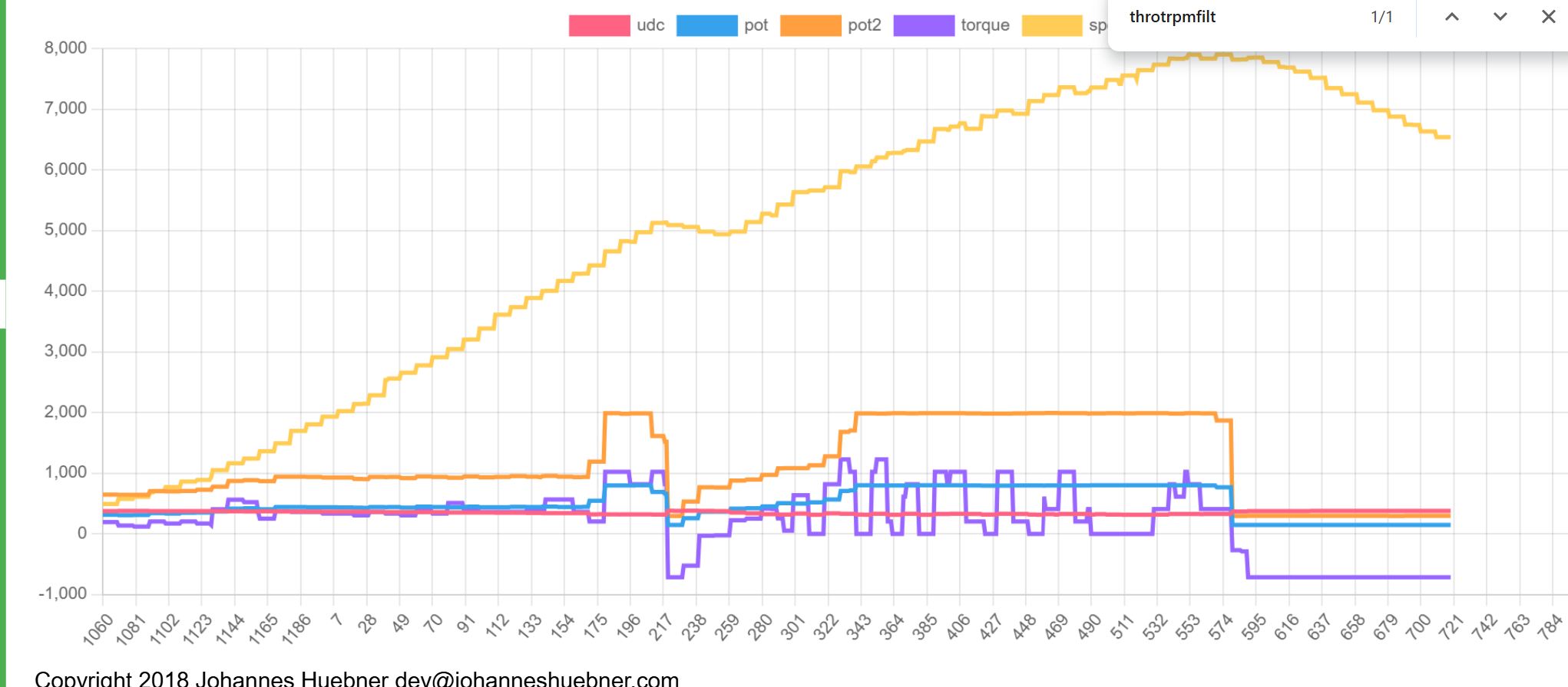

Few more scans adding.
I'll check the can logs, but looks like torq drops to 0 after some voltage decrees. Some more files attached.
slow_gas.trc.7z
(165.37 KiB) Downloaded 61 times

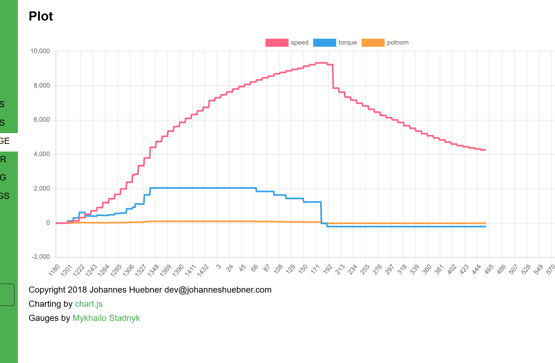

Another update.
I've matched parameters to Damien's "truck", and now it smoothed.
Going to check how is the weather on the river.
So, battery is not so bad for this subject.
Need to learn a lot.
If tonight, tomorrow no rain, will go to check the boat.
params (7).json
(2.14 KiB) Downloaded 52 times

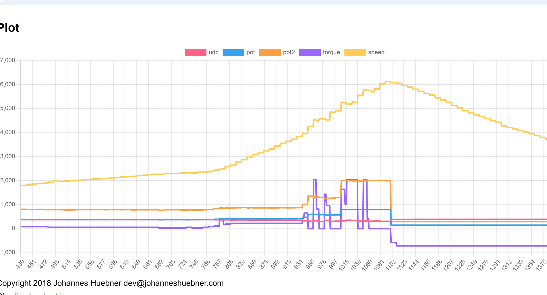

Significant changes on the boat.
And... I'm 99% sure, all the problems related to the UDC, we've started today with about 76% SOC, and everything was great, but started vobbling in a few minutes, 1st thing I've tested the voltage and it was around 340, checked SOC 36%. Going back to the land.
The plan for tomorrow is to charge 100% and measure the lifetime on the water. Today, we achieved 50km/h on the water.
Screenshot from landing.
Video just before turning over for landing. SORRY for the video orientation. :ugeek:
In the first clip, you can hear it losing power and start jumping.
Going to learn the source code in depth.
