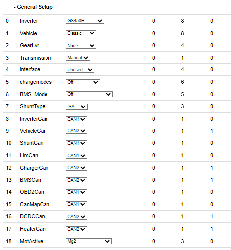

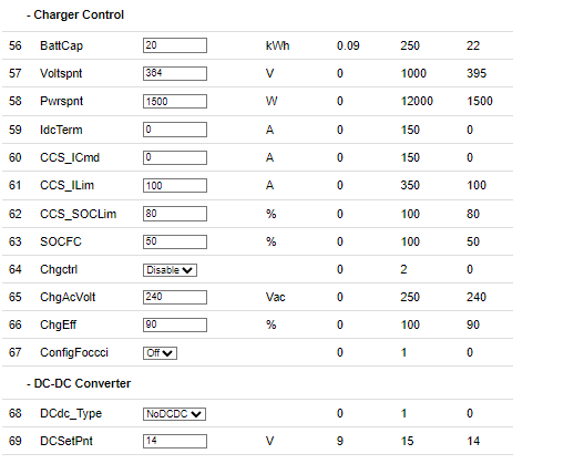

I have 2 issues.
1, its incredibly jerky but I still gotta play around with throttle parameters.

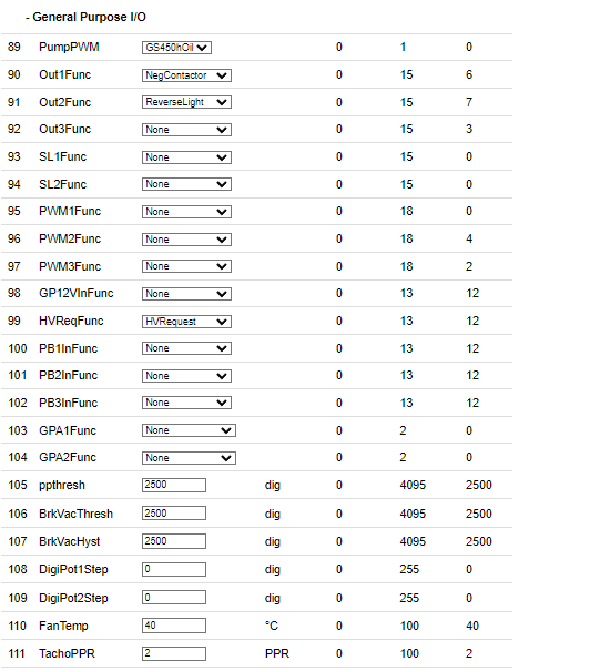

2, the HVreq doesn't work when it receives 12v, so I cant charge. It should simply go through the sequence of initiating precharge and close all the contactors? Is there some parameter that might be inhibiting the HVreq from activating.
Or is there another way to get the contactors to close to allow charging?

Re: WIP 1974 Ford Capri + GS450H
post Params if you want help also post what firmware version you are on.

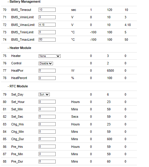

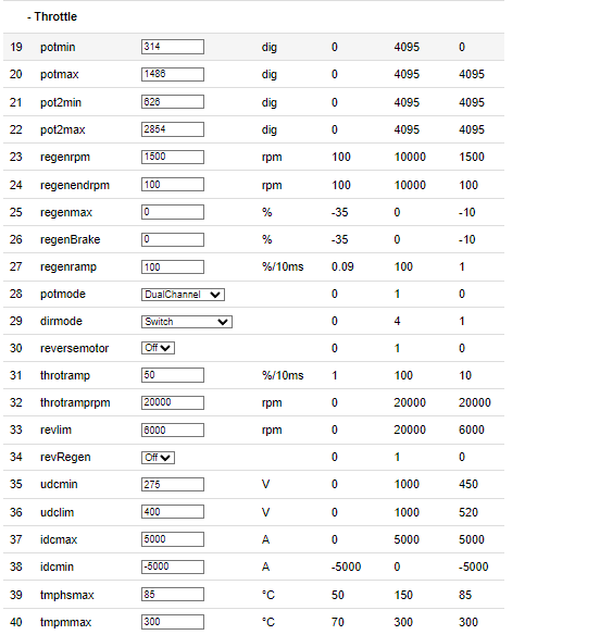

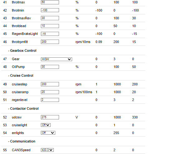

Hi. Got the low speed judder sorted out. I was going the wrong way with some parameters.
Only way to get it to charge is to put it in run mode and plug in the charger.
Screen grabs of parameters
zv 7.png (11.42 KiB) Viewed 2966 times
Software version?
Posts: 2962
Has thanked: 330 times
Been thanked: 848 times
CapriV wrote: Tue Aug 12, 2025 12:05 am Only way to get it to charge is to put it in run mode and plug in the charger.
No shit sherlock. You did not configure any charging interface or charger.
Post by CapriV »
2.20a
Haha, ya, so the zombie has little to do with controlling charging.
The Thunderstuck MCU looks after charging via CAN
I just need the HVreq to work to close contactors for charging.
Totally under the impression I just have to send 12v to the hvreq pin.
Sorry for the dumb query.
Posts: 2962
CapriV wrote: Tue Aug 12, 2025 11:49 am Totally under the impression I just have to send 12v to the hvreq pin.
If you configure the zombie to utilize that kind of charging and assign that function to the pin.
Post by CapriV »
Ok. Its working now. Thanks

This setting will slow down the rate at which potnom can ramp up... ?
So if you floor it , it will get to the actual throttle position slower?
1 being a slow ramp rate and 100 being fastest?
What exactly does this setting do?
I'm not understanding the description... sorry...

Re: [FIRST DRIVE] 1974 Ford Capri + GS450H
CapriV wrote: Mon Aug 18, 2025 5:40 pm This setting will slow down the rate at which potnom can ramp up... ?
Yes, it is a floating value so you can have it from 0.1 to 100. Currently a fix in the pipeline to improve throttle smoothness more.
CapriV wrote: Mon Aug 18, 2025 5:40 pm What exactly does this setting do?
Limit the speed change allowed for the throttle position mapping (regen is speed dependent under a certain rpm, this again is a param you can change). Filters out massive speed influxes caused by faulty comms. The GS450h has erratic speed reporting for some users.

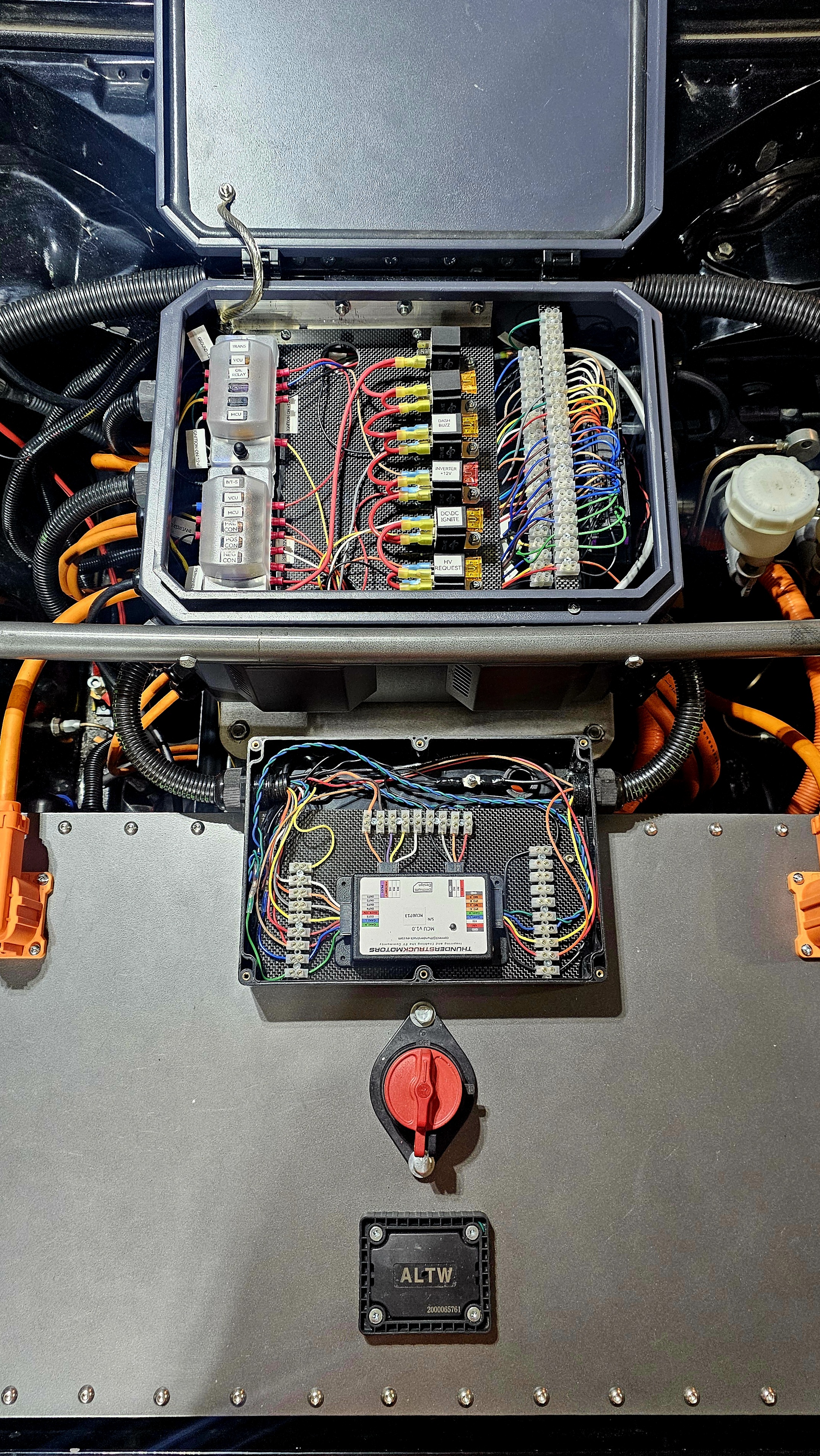

I have 4 a123 modules in 2 pairs. One up front and one in the back.
Wiring was quite simple. I don't know a massive amount about electrics so ive done what I feel is acceptable but not posting specs about wire gauge etc incase folks copy my ignorance. I have contactors and fuses in both boxes. I feel its a safe setup.

My battery setup all hinged around the Thunderstuck MCU.
Their system was incredibly easy to implement and make work with those a123 batts.
