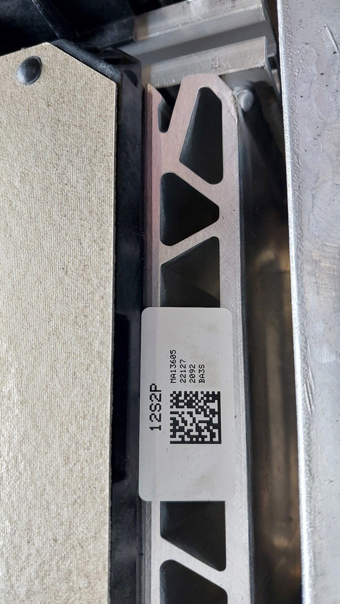

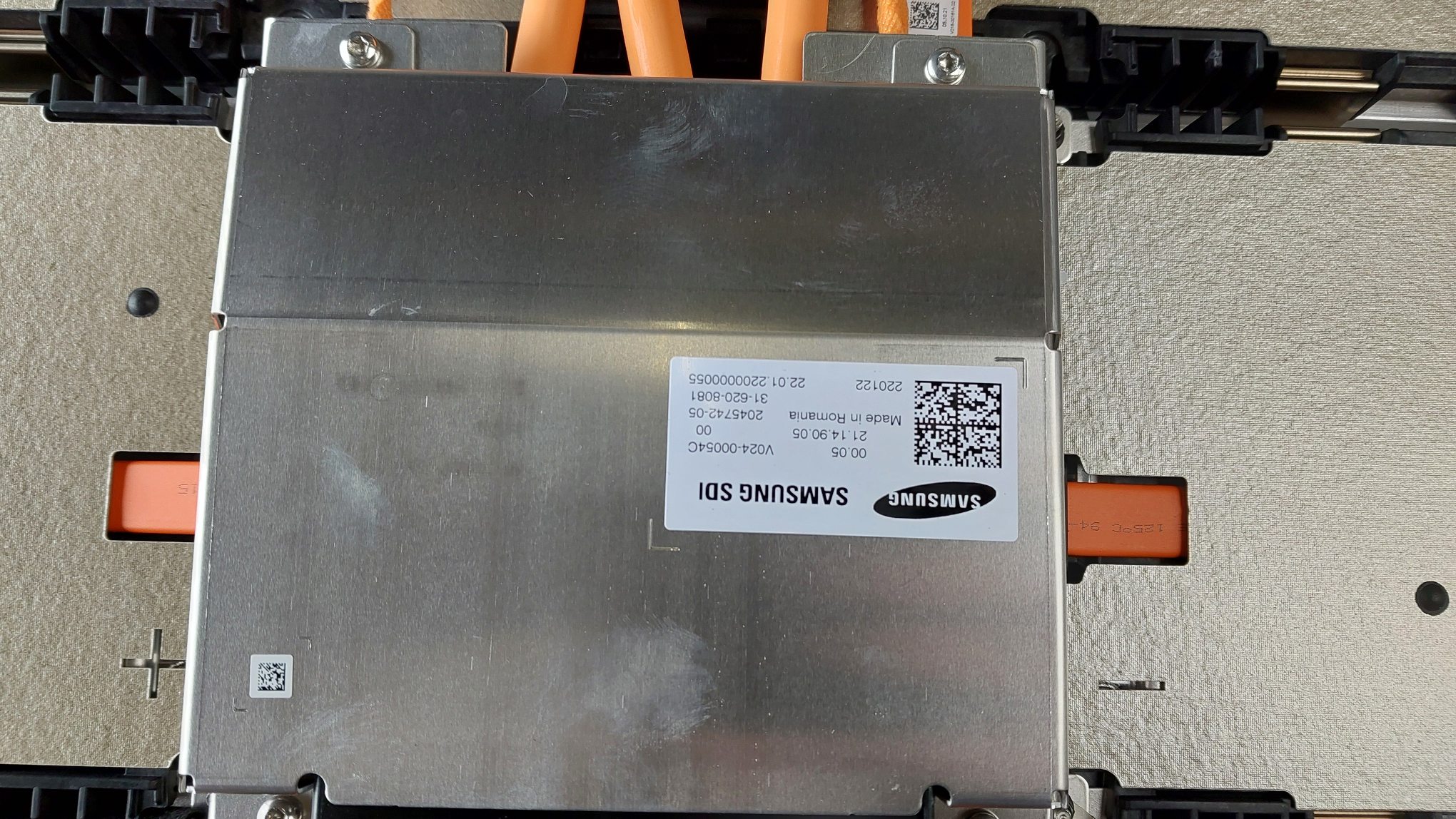

I read here and there it would be LFP, but the numbers don't add up...I think it's normal NMC (Samsung)
12s and 8s modules, works with:
https://wdrautomatisering.nl/product/cm ... 1-gateway/

(still have to dismantle the pack further)

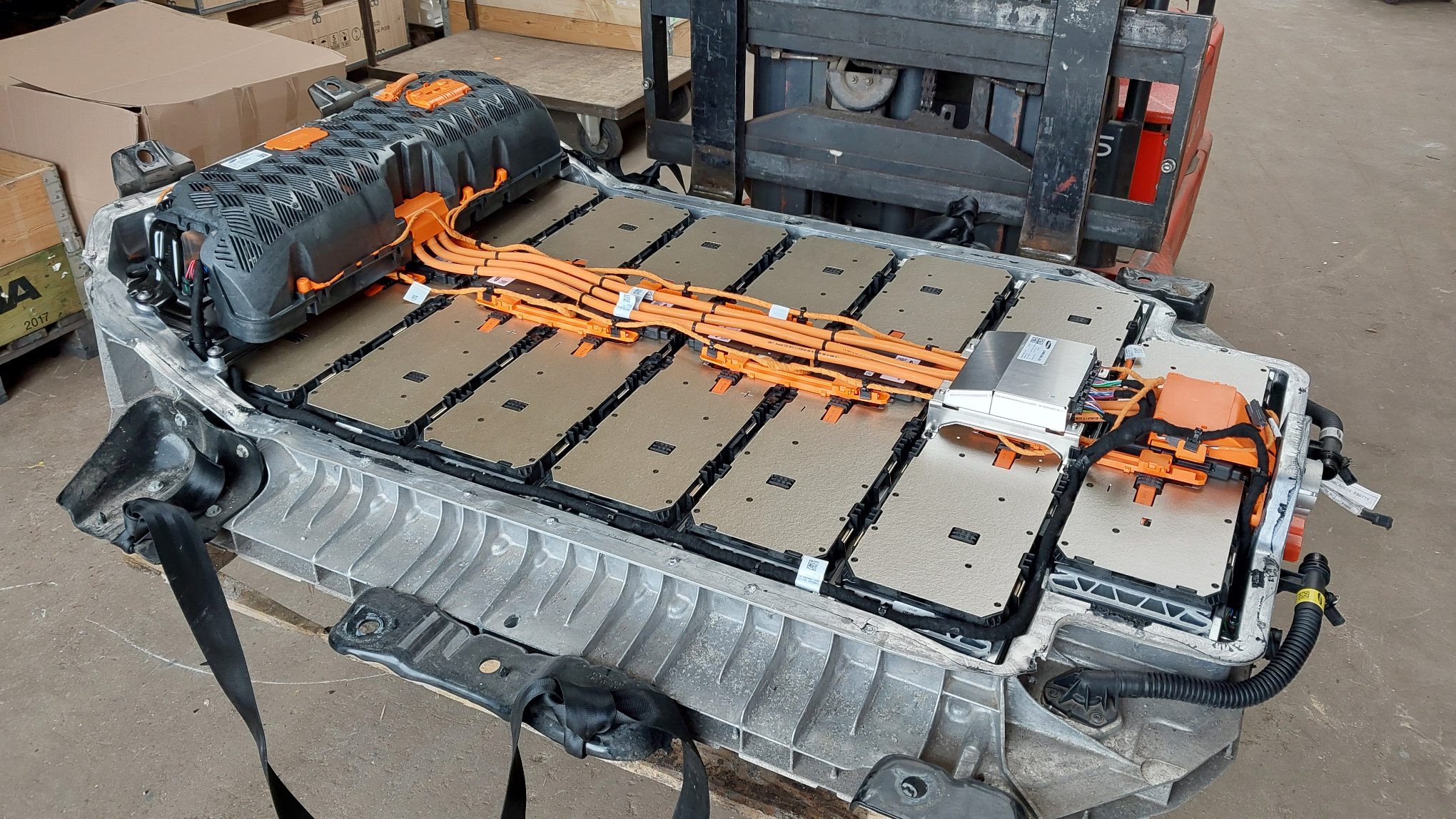

Look like a nice size and with cooling

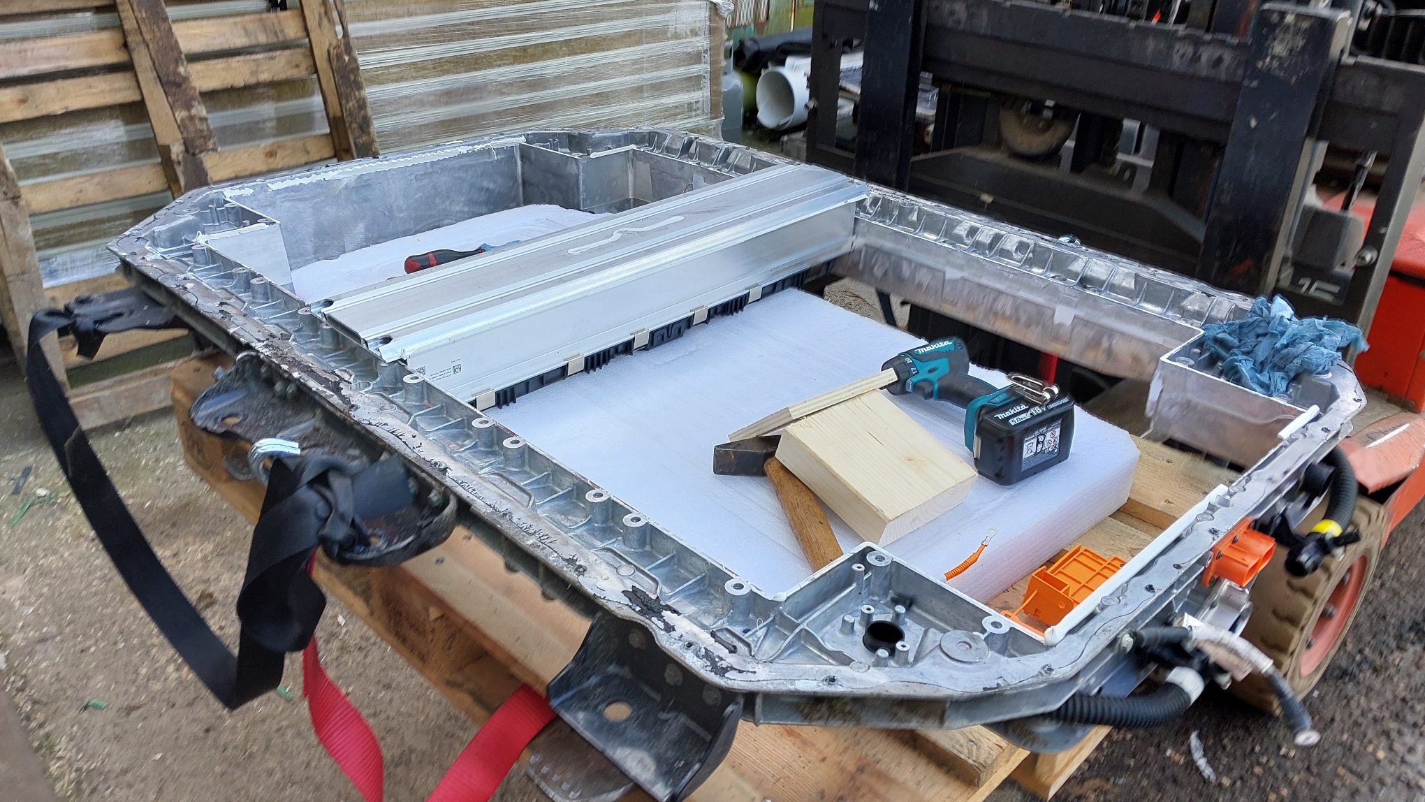

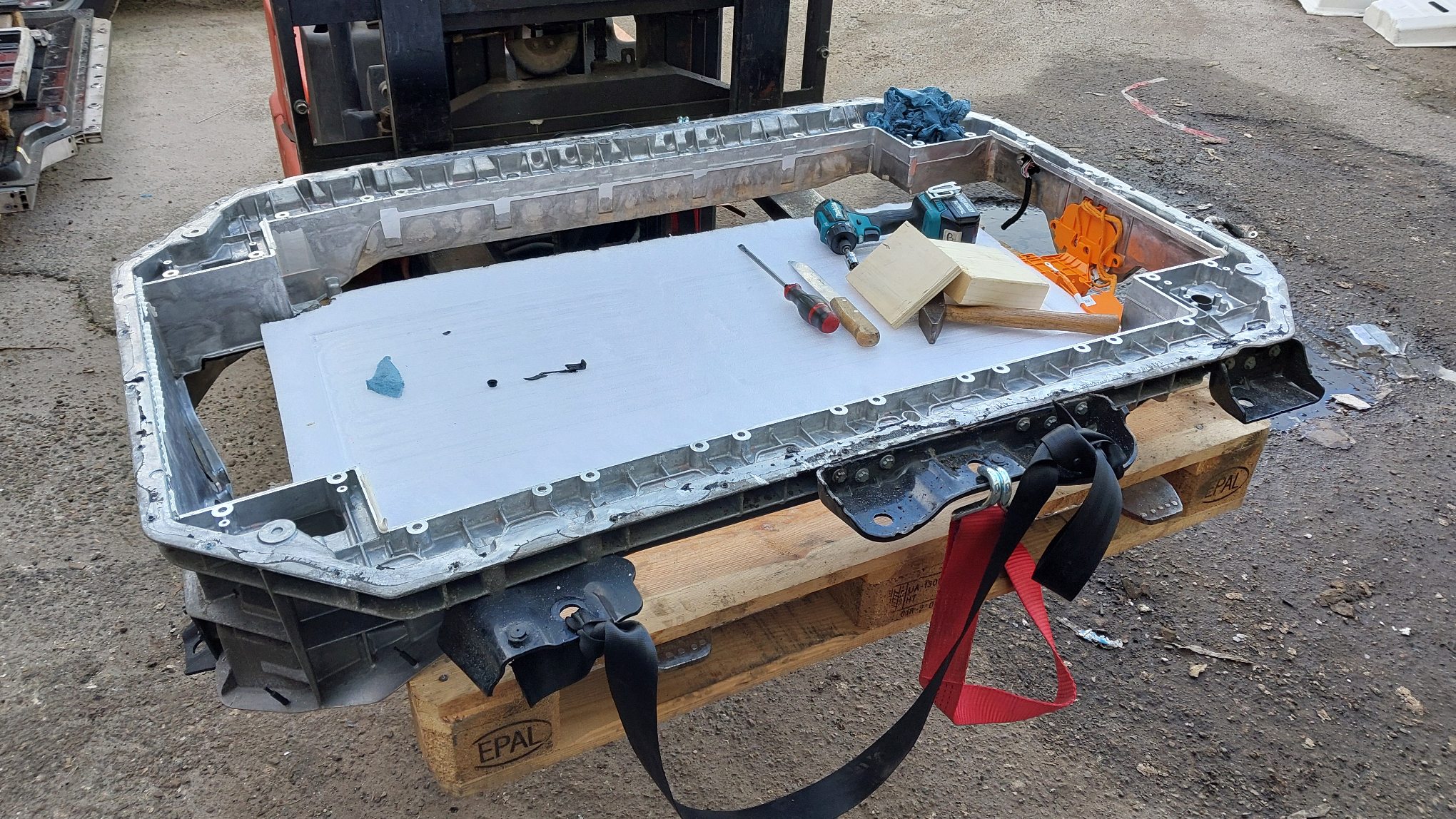

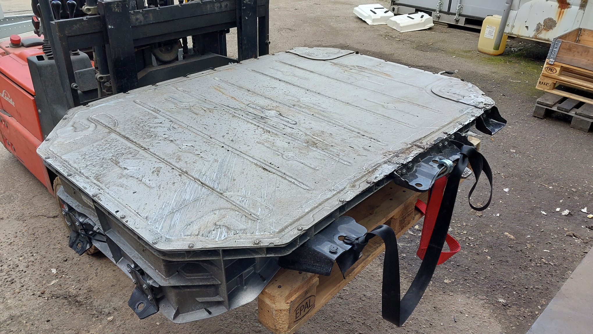

Ok some disappointment...
The modules are glued into the battery housing!
hoping for some safe way to dismount them..
(or someone that can use it as is)
boekel
Posts: 135
Been thanked: 30 times
Re: Fiat 500e - 42 kWh (LFP) NMC pack
Post by boekel »

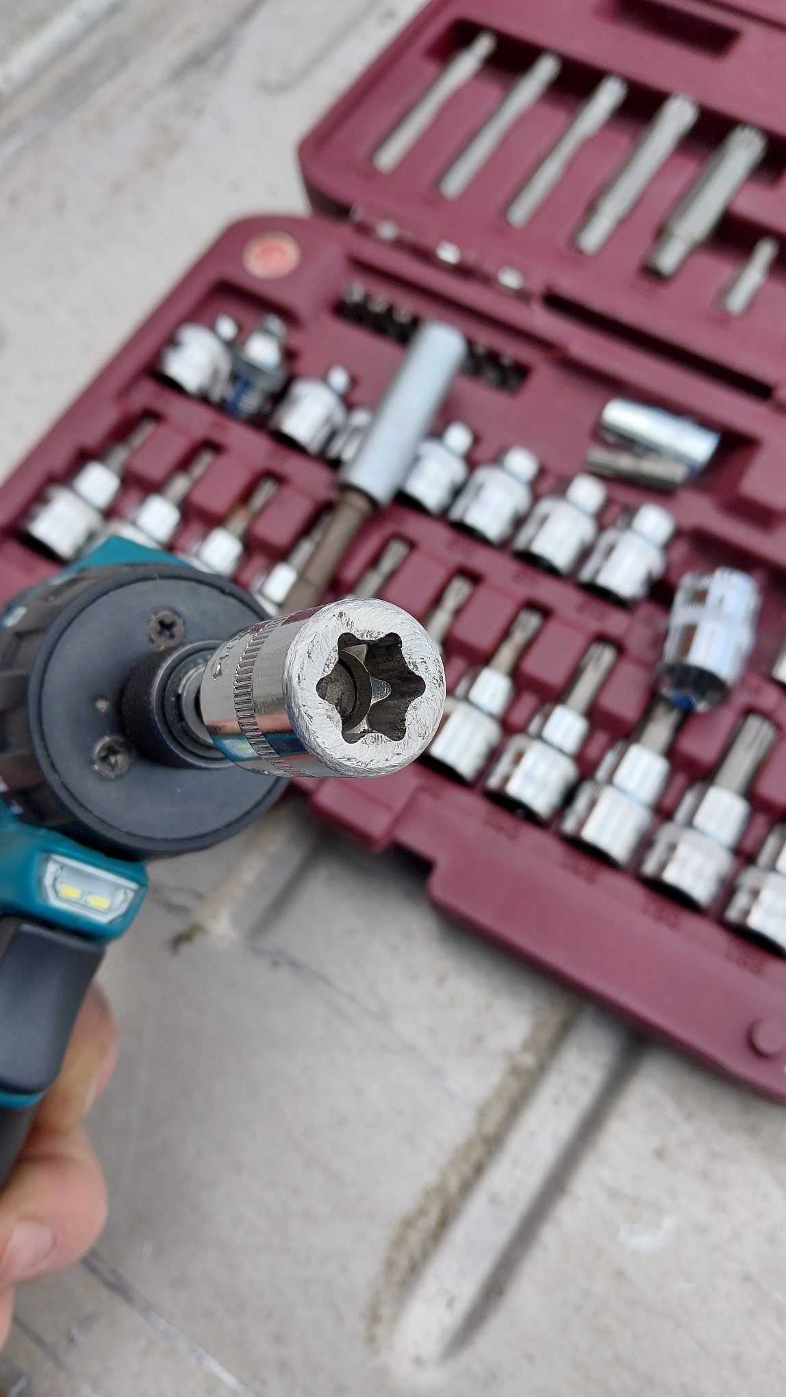

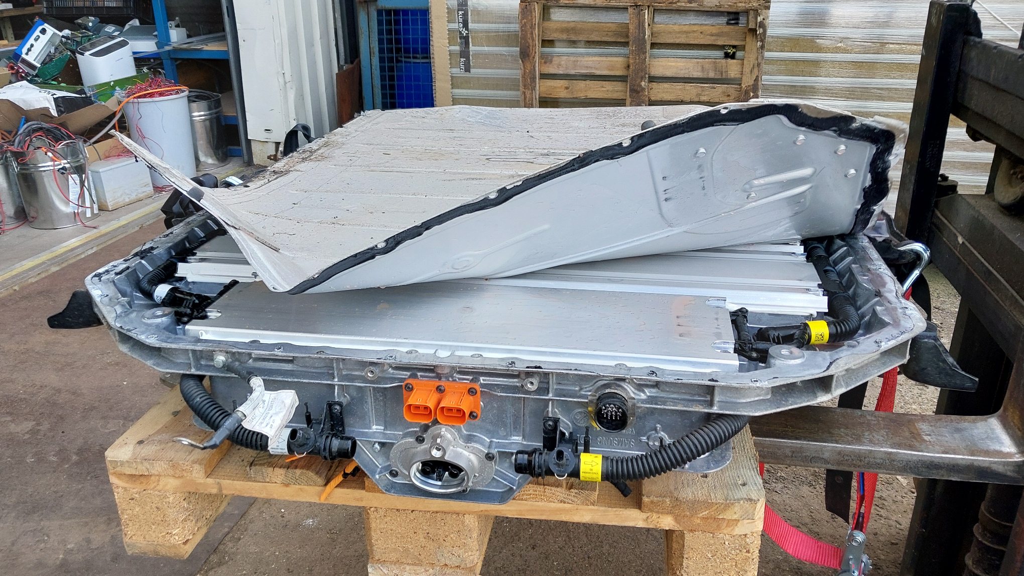

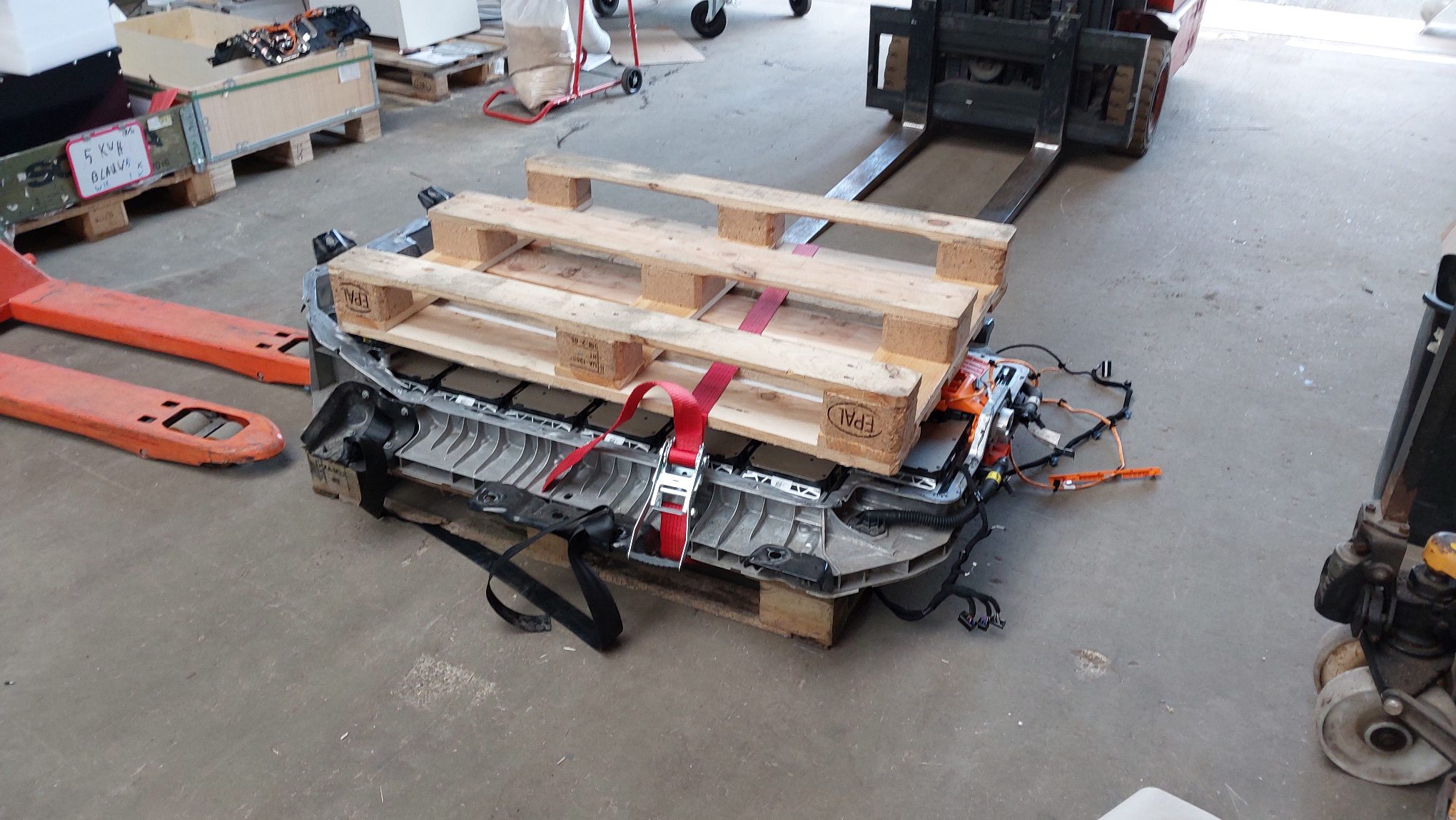

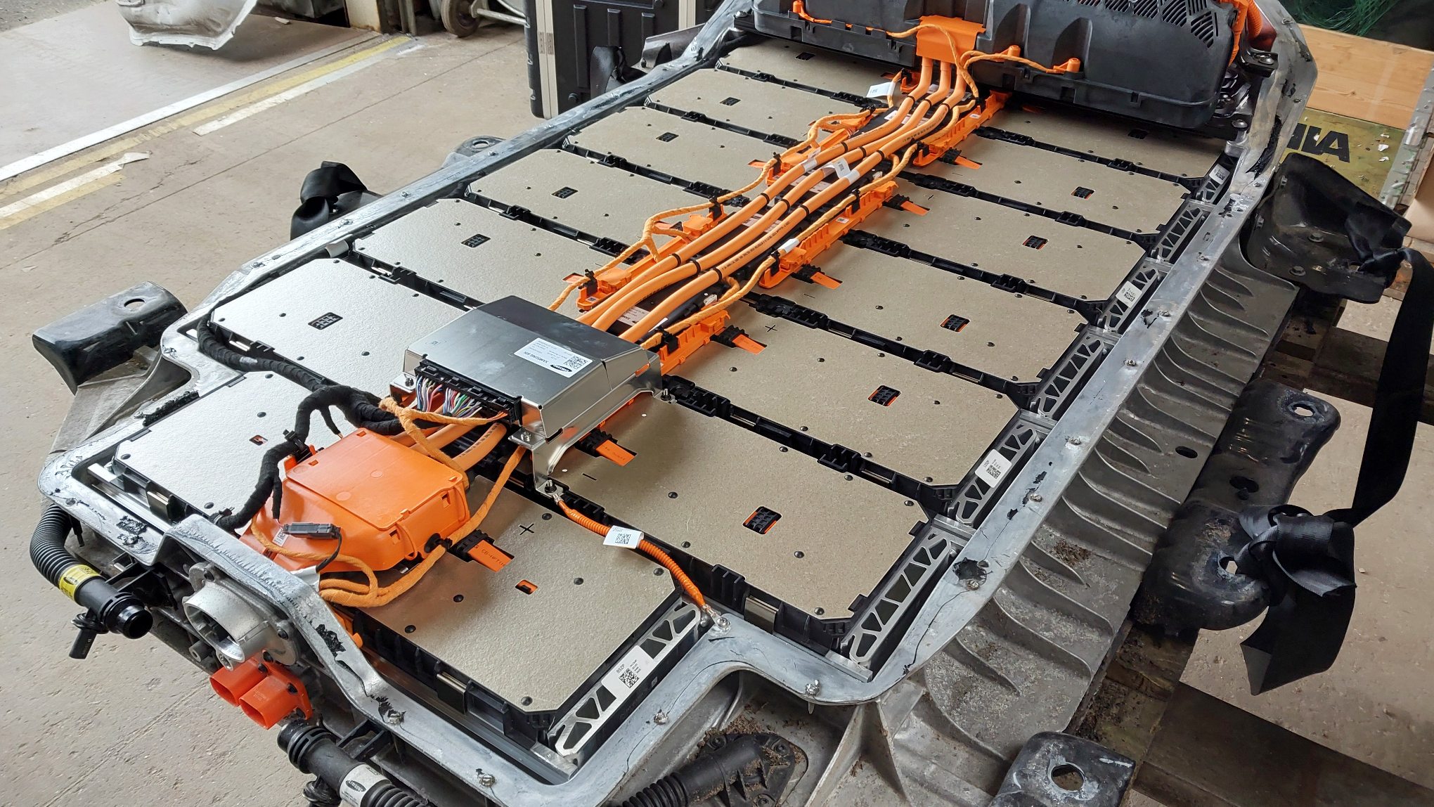

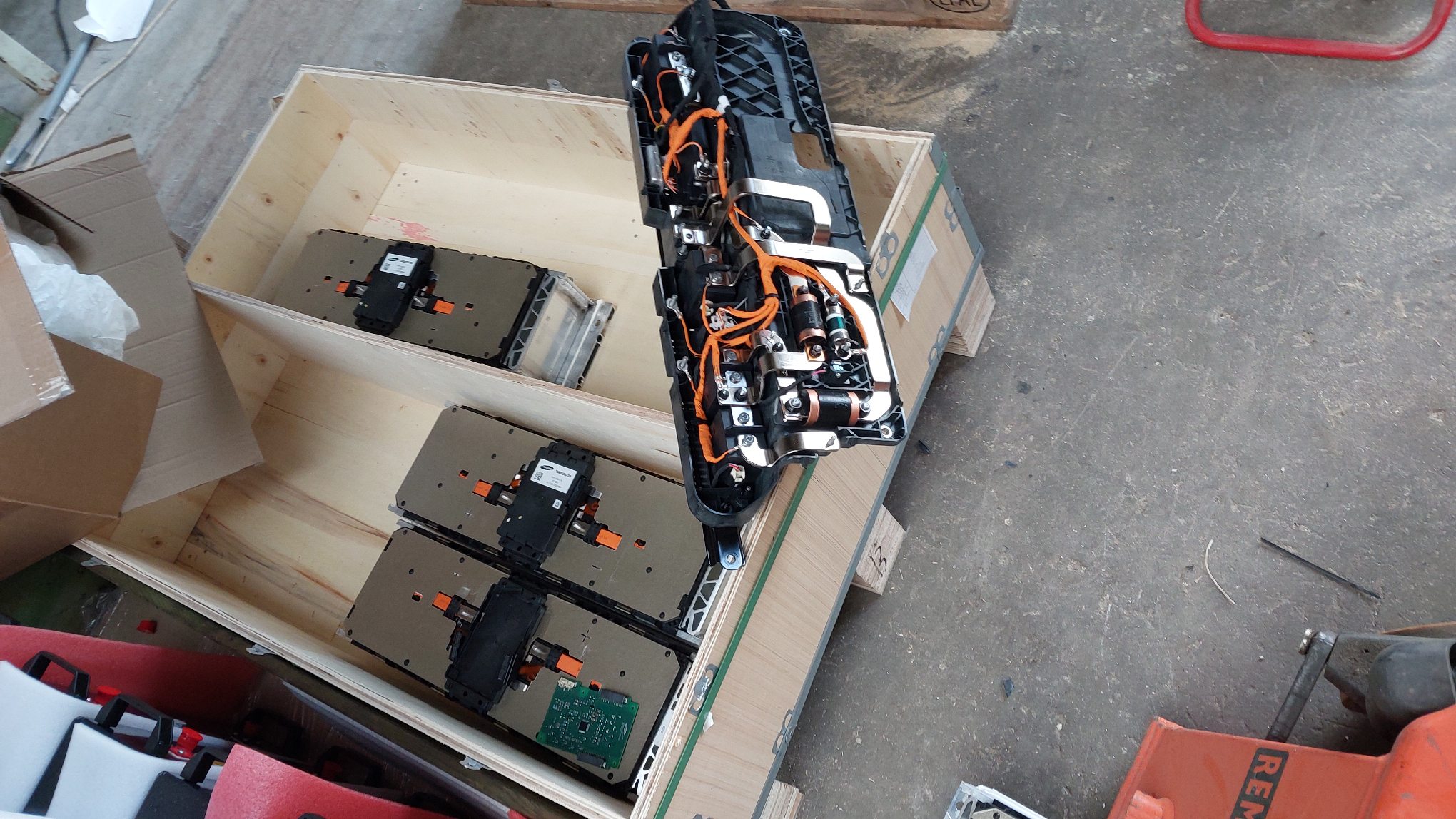

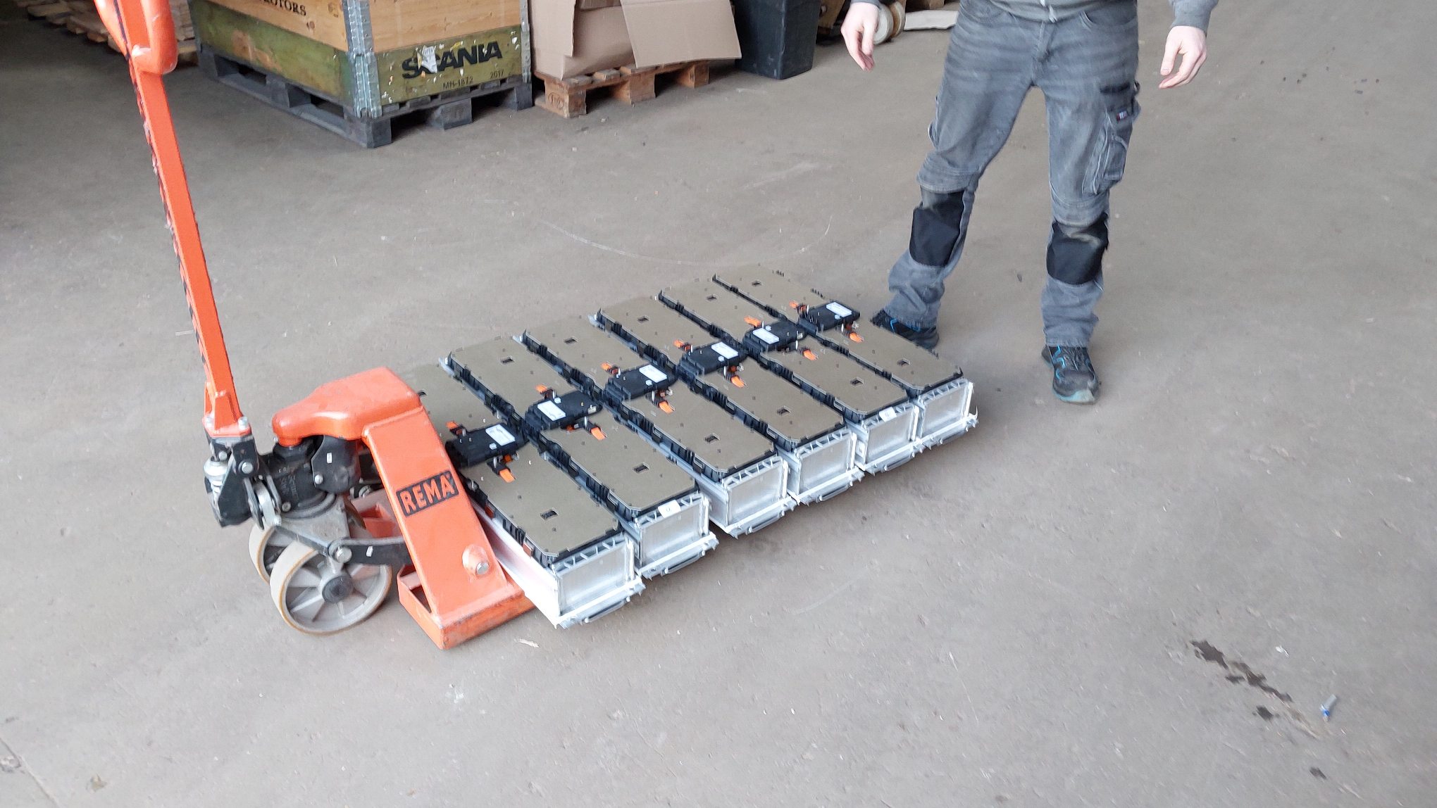

Taking it further apart: you actually need to be on the underside!
So I made a sandwich and flipped the battery, first there is a cover plate, with a 'sharpened' E16 bit I was able to remove the security / one way screws.
the cover plate is also glued quite well to the modules, putting pulling force on it and cutting the glue was the way. (Also for freeing the modules from each other)

Also opening 42 kWh battery pack. What Voltages you have got when inspecting the modules ? Our first (opens from upper side before turning the thing upside down) was 28,4 V and the rest of modules were together 318 V.
