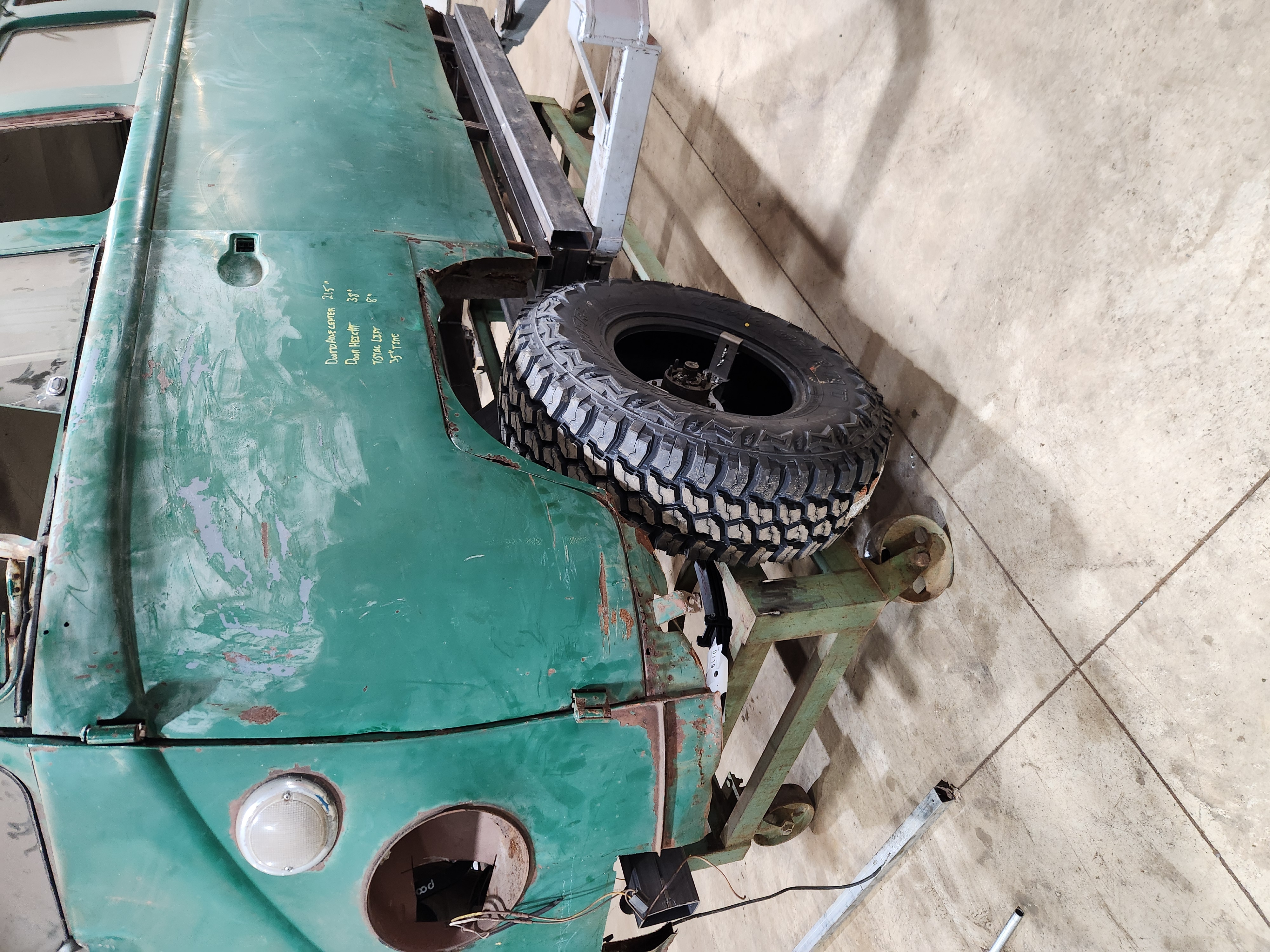

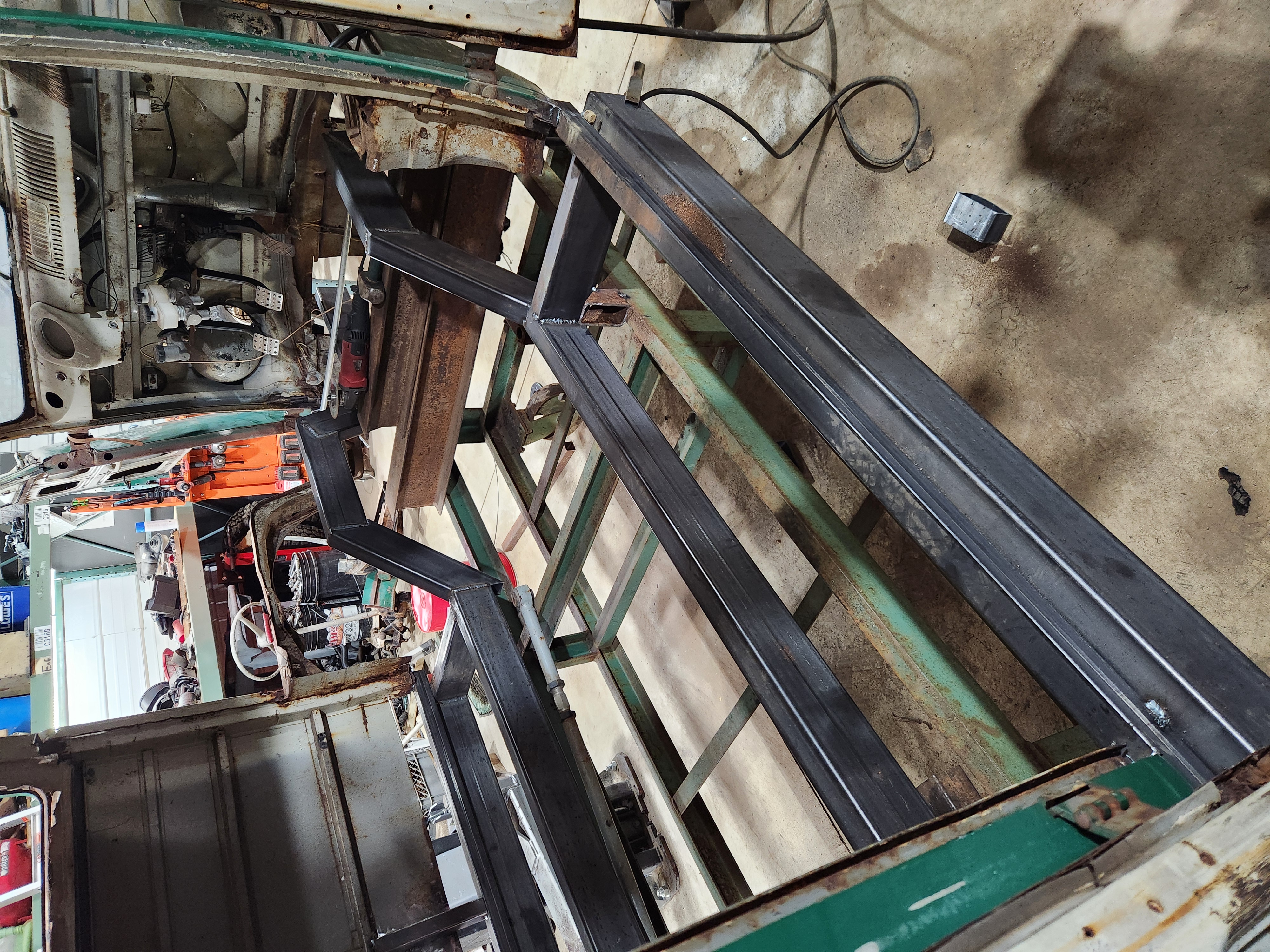

Well, I'm a goof. I looked closer and found the attachments tab.
The sideways bus with the toy axle mocked up when it will still going to be diesel powered The chassis under it. And for good measure, another one of my VW's doing some yardwork yesterday.
As a sidenote I found your build a while back, and it was one of the ones that gave me a gentle nudge this direction, so thank you.\
Edit: have you found a way to make the photos oriented correctly? The sideways images really bug me.

Impressive work on the chassis! And very nice picture postcard image of a VW at work. Could have been from VW themselves 60 years ago.
I’m not aware of any way to make the images show the right way up when shown on a post. My guess is if you hold the phone in portrait mode, this site will rotate it for you, assuming all photos should be landscape. You just have to click them to see them the right way round when full size. I agree it’s annoying.
